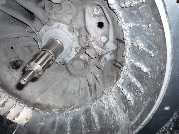

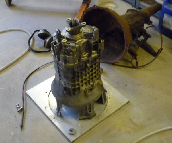

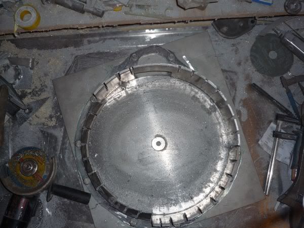

    I belelve that some is intresed in how i made the gearbox to the flathead
    I made a fixture for the flathead bellhausing pattern and put the bmw box inside
    I cut the bellhausing that were outside the flathead patten
    I made a ring in 6mm aluminium with flathead bolt pattern
    I welded a ring of 6mm alu plate rond the ringand made cuts in it
    I put in the gearbox and bein to weld it togher with the new bellhausing
    i cut out on peice in time and weld a that so wen i were ready the old bellhausing parts were laying inside
    it comes more about the gearbox later
    /Stefan

    With the bell housing welded, are the internals of the transmission still serviceable for a rebuild later if needed?

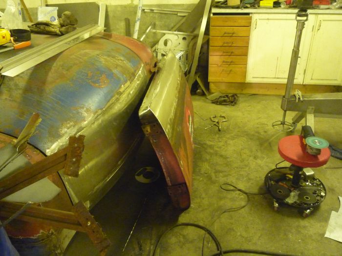

  12. Stefan T
    Joined: Sep 15, 2008
    Posts: 2,165
    Stefan T
    from Sweden
    Thanks for your coments
    The intermals parts of the gearbox are still accesseble as before the rewelding of the bellhausing
    i have hide nothing of screws, lids and like that.

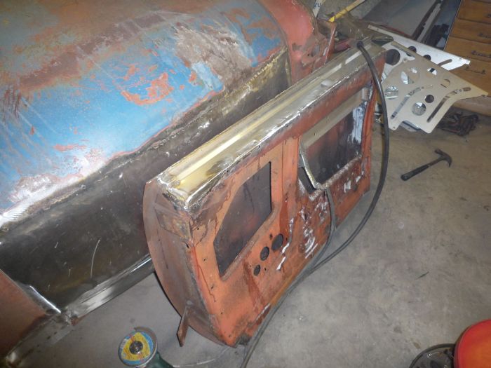

    I were out in the shop before non and worked little on the doors
    I have begin to weld the drivers doors bottom
    I think i must change the lower part of the door skin on the right door
    I have repared to big holes in it but ther is more on it so it maybe better to change it
    /Stefan

  13. Stefan T
    Posts: 2,165
    Stefan T
    from Sweden
    I were out in my shop today and it were dam cold
    I worked on the drivers door and made the bottom ready exept for the drian holes
    /Stefan

    How much of the skin are you going to replace? Looks like the top half is savable, or is it hiding the rust underneath the old paint?

  16. Stefan T
    Posts: 2,165
    Stefan T
    from Sweden
    I will replace aprox. 6 to 8" of the lower part of the door skin on the left door
    And today is 1 year since a put in the car in the shop.
    and it was not so cold last year and no snow
    /Stefan

  17. Stefan T
    Posts: 2,165
    Stefan T
    from Sweden

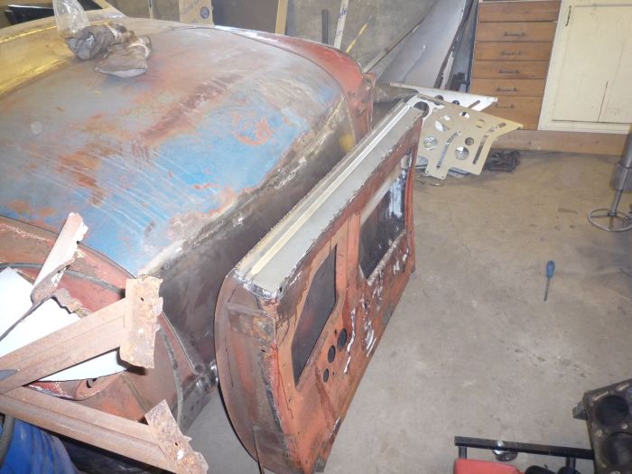

    I have begin on the right door
    I shall change the lower part of the door skin
    /Stefan

    I have made the lower door skin part
    I shall weld it next time i are in the shop
    /Stefan

  22. Stefan T
    Posts: 2,165
    Stefan T
    from Sweden
    I have cut out the old lower part of the door skin
    And begin to set up the new one
    And now is it ready to weld
    /Stefan
  23. Stefan T
    Posts: 2,165
    Stefan T
    from Sweden
    I have made the door skin repair ready
    now is the bottom and the lower part of the dooe skin changed
    /Stefan

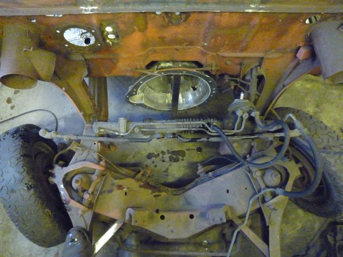

    I have made the cover over the bmw gearbox
    It need some more grinding of the welds but one of my grinders stoped to work
    I have begin to think of the r&p steering from a saab 900 i will use
    I most begin to remove the old one first i shall test it with the original suppention
    than shall we see how it fitts togther with my jamco ball joints converation set with granda spindels and discs
    /Stefan
