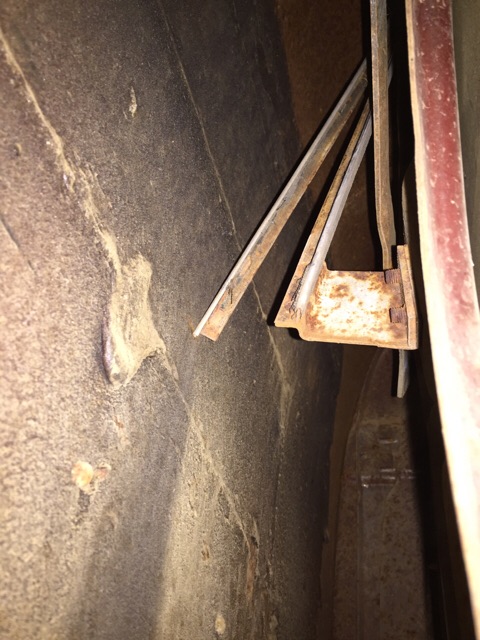

    Having a blast driving it around town but I'm officially sick of my door latches and having to slam the door several times to shut them properly. Anyone have a suggestion on a source for non-bearclaw latches? I'm not ready to shave the handles, nor am I ready to start cutting to install the bear claws. I'll call shoebox-central in a bit, but the site didn't have any...
    The door gaps seem to be acceptable when they're shut, but I'm sure my hinges are some percentage of shot just like everyone elses... I suppose I should to both hinge and latch at the same time, I'll dig up the old threads on hinge replacement today... I'm liking this fix, should be pretty quick: http://www.how-to-build-hotrods.com/hinge-rebuild.html
  25. Brentphx
    Joined: Aug 12, 2014
    Posts: 256
    Brentphx
    Had a bit to troubleshoot the doors, last time I shut the drivers door there was a really bad rattle... That made me a bit nervous so I took the door panel off this am. Good news is nothing came off the latch, bad news is that I need a new channel for the glass.
