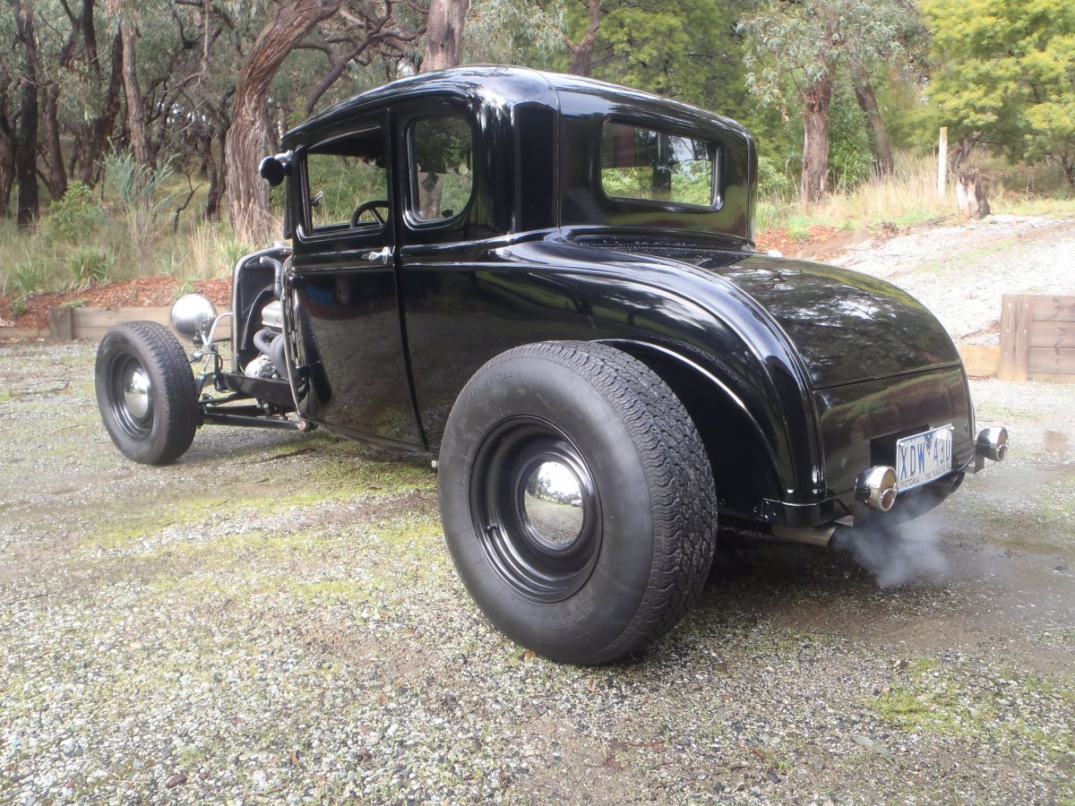

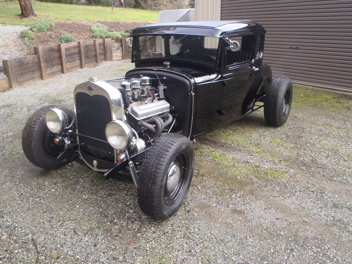

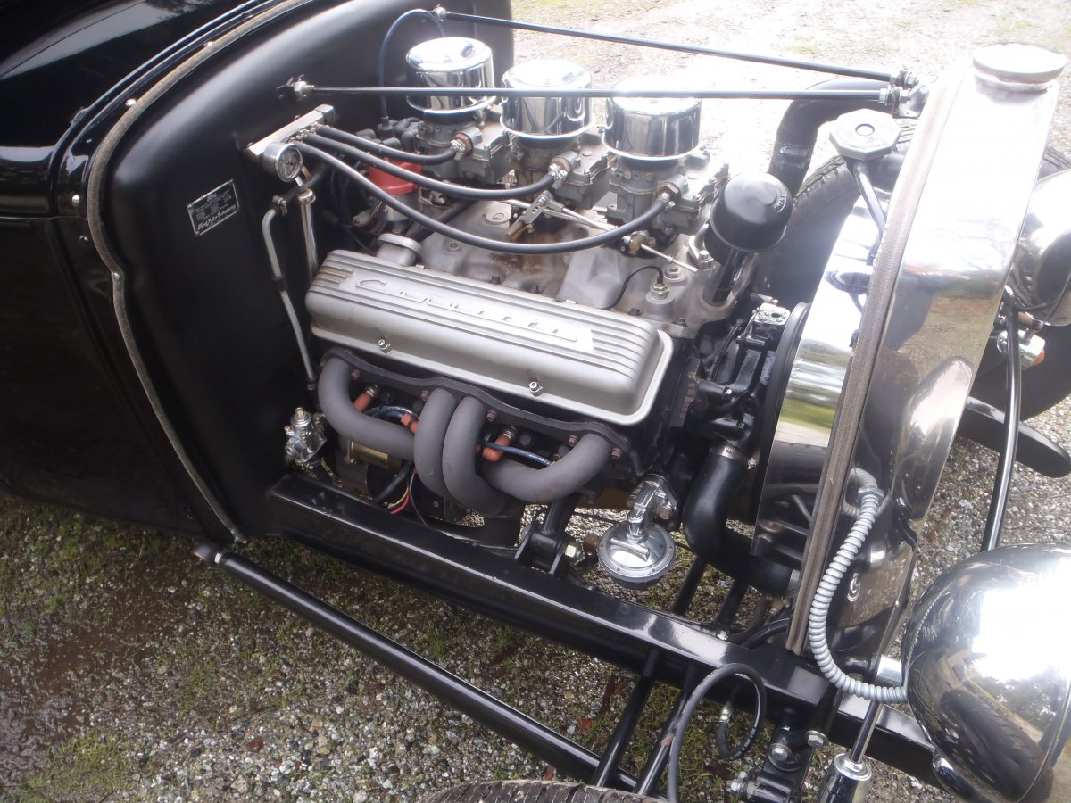

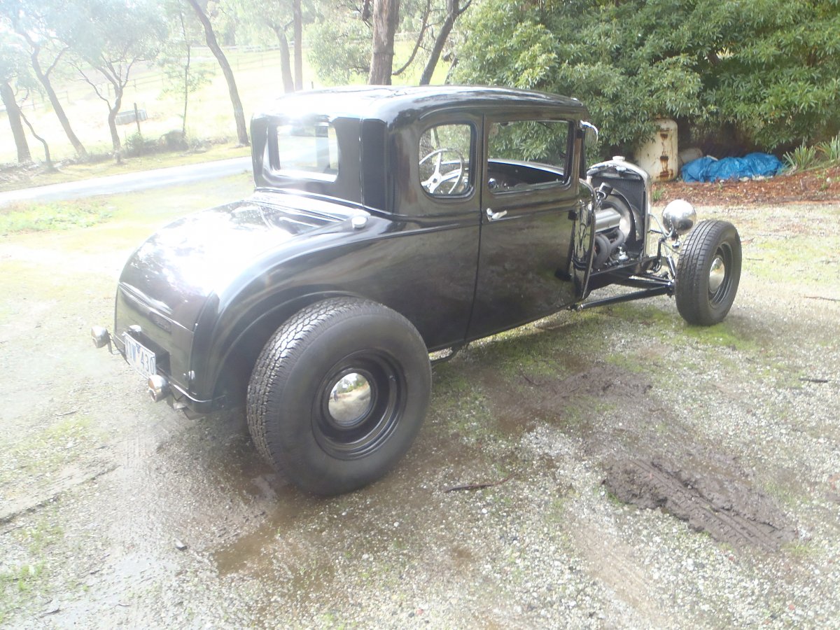

    I have just purchased this 5 window coupe here in Aus and will be re engineering to suit Aust street rod regulations for registration. Just wondering if anyone knows anything about this car. The chap I purchased it from new nothing of its history. Has SBC, 3 speed auto, 9inch rear, any info / history would be greatly appreciated. Glen P2200271.JPG P2200277.JPG P2200273.JPG P2200280.JPG P2200283.JPG P2200282.JPG

    Looks like a basic honest Hot Rod. Not a lot of bling but a fun ride. The smoke out of the exhaust is probably the typical SBC valve stem seals. Run a compression check and they are easy to change especially on a roadster.
    I read an old copy of the Australian rules book and it seemed like everything done from stock had to be signed off by a licensed Engineer.
    deadbeat and lothiandon1940 like this.
  3. That smoke might just be from the cold morning weather. Aren't those guys in Winter now down-under?

    That's correct just started car on cold day, but there was a smell of oil in the air. No smoke or vapor once warm. A licenced engineer has to sign off on the build, regulations are quite strict. I plan to convert to RHD, have to use a collapsible steering column, strengthen chassis as no K member, plate chassis over rear, strengthen all suspension mount points, burst proof door locks, intrusion bars in doors, retractable seat belts, cycle guards, window glass etc etc. The list goes on, but I have downloaded all regulations / guidelines and will build to suit. I plan to keep the car basically the same style, I'm not a fan of bling. I also plan to build a killer engine / trans combo to install for some drag racing duties then return to street trim for cruising. Watch this space for the build. Glen

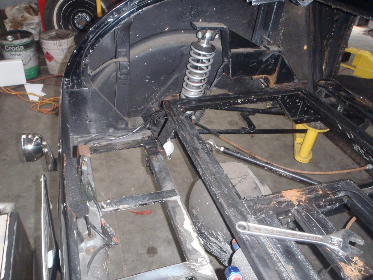

    Started build now, I have purchased new RHD vega steering box, collapsible steering column, new steering wheel, mini starter and a 32 grille shell so far. Also have ordered a so-cal deluxe front disc brake kit and new steering arms. Started stripping car, will convert to RHD first, set up steering etc. Will need to pull body off later to strengthen chassis and I will re-mount the 9 inch rear with a triangle 4 link setup and add disc brakes. Check out pics, more to come, Glen P3020289.JPG P3020293.JPG P3020294.JPG P3020290.JPG

    Some more pics, started mounting column, will purchase a new brake booster and move to right side, will make trans mount removable once I strengthen chassis, removed exhaust and will need to fabricate a new system when 4 link completed. Also started removing interior etc as I will take body of soon. Will make a bolt in roll bar / hoop to mount seat belts and also make a small hoop under dash to mount steering column. Glen P3030297.JPG P3040301.JPG P3040303.JPG P3040306.JPG P3030299.JPG P3030300.JPG

    I had a engineer look at car before purchase, he stated that if chassis could be proven to be original, car could obtain full Vic rego. If I cannot prove chassis is original and is a reproduction then it must go on street rod limited rego. How can I determine if chassis is original, what do I look for, there is a chassis number on chassis Left side on bottom of rail between engine mount and A pillar..Engineer stated it is possibly a reproduction chassis. I will go with a HQ steering box as per recent advice but will ask those who sold me the vega box why they are selling inferior steering boxes to Aust market and ask them to explain there rational. Thanks for all comments, negative or otherwise, I am willing to listen to others as long as there is a rational behind advice. I plan to make chassis comply with street rod guidelines and be safe to drive for all my family members to use on a daily basis ( wife and 2 adult children ). I appreciate all comments / advice - either positive or negative. Glen
