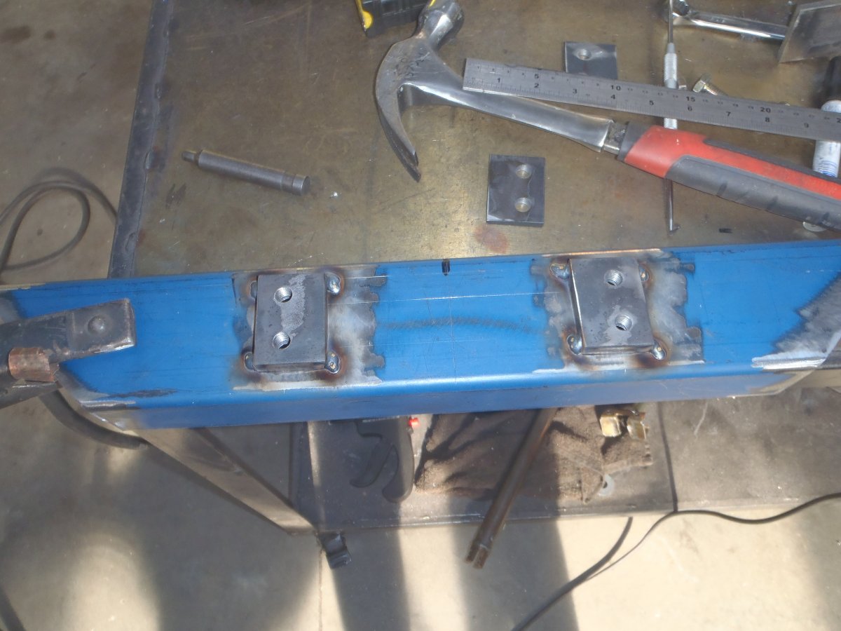

  4. grdra1
    Joined: May 20, 2013
    Posts: 627

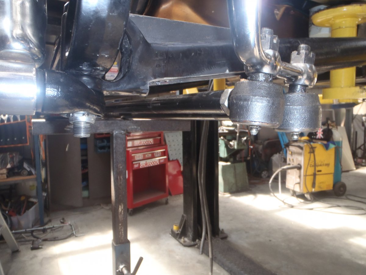

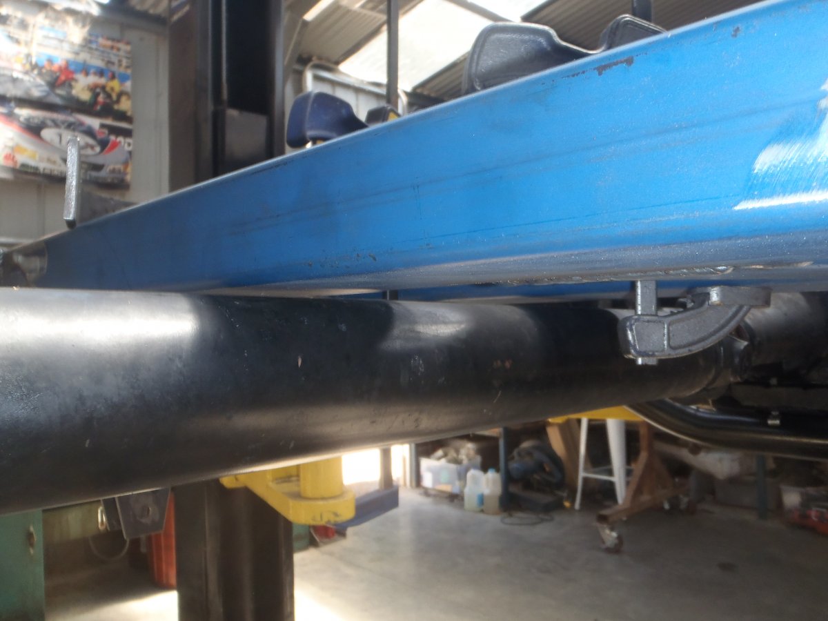

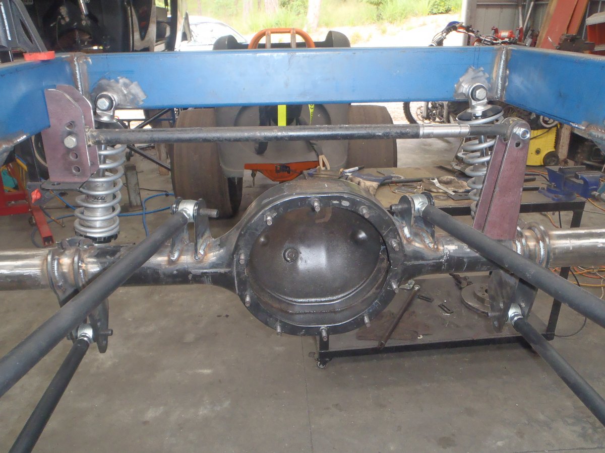

    grdra1
    Made new panhard mounts today, I have made it fully adjustable for different ride heights, a few pics. Glen P8030583.JPG P8030584.JPG P8030585.JPG

  7. 3banjos
    Joined: May 24, 2008
    Posts: 480
    3banjos
    from NZ
    Mike. I’m sure your well aware there will always be a certain amount of bind with any 4-bar rear. But mostlydoing as you suggested. My only concern for Glen at this point would be how high he has his panhard mounted, and drive-shaft clearance. In hindsight I would of liked to see him flip that rear k-member. He’ll sort it.

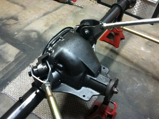

  8. grdra1
    Posts: 627
    grdra1
    Pulled springs of rear shocks and checked tailshaft clearance today, I have three possible rear end height settings to choose from, ( all one inch apart ) on lowest setting shocks compressed 3 1/4 inch before shaft touched crossmember ( shocks have 4 inch stroke ), see pics. I will put body back on to determine which setting I use for correct ride height and then decide if I need to modify crossmember, will only need to if using lowest setting, this will also determine correct panhard bar mounts / height. I have also sectioned my front wish bones for tie rod clearance, I did not want to use dropped ends as I wanted to keep it all above or the same as front axle height. Not finished yet, plate is 3/16 or 5mm thick - any advice before I weld, thanks in advance, Glen P8160613.JPG P8150605.JPG P8150607.JPG P8160608.JPG P8160609.JPG

  9. AmishMike
    Joined: Mar 27, 2014
    Posts: 1,328
    AmishMike
    Angled 4 bar rear makes no sense to me. As they move ends on rear get further apart only if rear steel stretch’s. Raced late model GM with that suspension & stock huge rubber bushings that gave soft quiet ride. To race we stiffed them up & locked up rear suspension. Parallel 4 bar + panhard make lot more sense

  10. grdra1
    Posts: 627
    grdra1
    This car will be mainly street driven with occasional drag racing duties. From what I have been reading triangled 4 link is more user friendly for street cars, parallel 4 link is better suited for drag racing but cornering can place more stress on link ends. A few pics of todays progress, made some 5/8 thick plates for wishbones. Glen P8170617.JPG P8170616.JPG P8170619.JPG P8070587.JPG P8160609.JPG

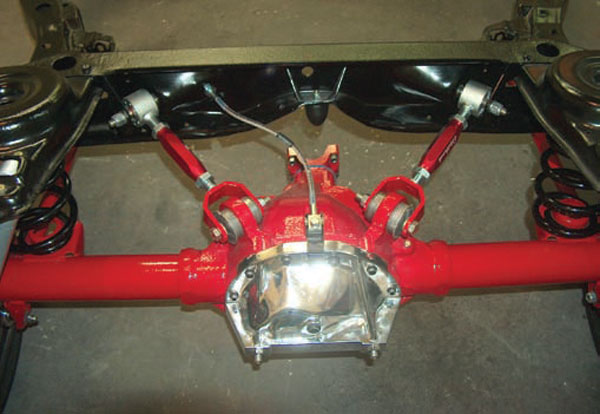

  11. Dirk35
    Joined: Mar 8, 2001
    Posts: 2,067
    Dirk35
    You're doing really good work. Thank you for taking to time to share.
    I see its too late for this suggestion, but Ill throw it up here just as a thought in case your not dead set on keeping the panhard bar. For what its worth, (had I seen this post before you got along as far as you are) my suggestion would be to eliminate the panhard bar because many people desire to run the exhaust all the way out the back of the car, running it up and over the rear end. Doesn't seem to apply to your plan since you are doing your exhaust differently , but it might help someone else that reads this thread and does something similar.
    Anyway, I think you could have gained that additional 5 degrees on each upper 4 link bar (for the additional 10 degrees you needed) by moving the upper 4 link brackets more inward on the rear end like a lot of factory triangulated 4 link set-ups are. I'm pretty sure that most of the 8.8 Fox Bodied Mustangs had them cast in the housing at the upper top section of the pumpkin.
    Here are a few pic to see what I'm trying to convey.
    I doubt this will help you, but it might help someone in the future that reads your post and follows this thread.
    Outback and loudbang like this.
  12. grdra1
    Posts: 627
    grdra1
    Thanks for reply, I should have researched the upper 4 link angle a bit better but thought that it would be ok as 4 link kit was a heavy duty unit and car is small and light. Unable to go further up the pumpkin due to ride height issues ( having upper bars level at ride height ) but could have gone out wider at other end if I shortend the bars. Anyway its done now and I dont mind the panhard bar for added insurance. I would like the exhaust out the back, I will be putting the body back on soon for trial fit and to determine final ride height and suspension settings. I will leave panhard off for now and decide the best way forward when body back on - panhard can be redesigned to suit and who know's I may even redesign the upper 4 link mounts as its only a few days with the angle grinder. Ive come this far so I may as well do it right. Glen
  13. Vic Walter
    Joined: Jan 21, 2018
    Posts: 172
    Vic Walter
    Looks to me that you have built a triangulated 4 bar rear suspension, as such you do not want to add a panhard bar doing so will introduce more bind between the 5 bars during compression and extension
  14. grdra1
    Posts: 627
    grdra1
    I plan to remount my upper 4 link bars and forget about the panhard bar. I will move mounts up the pumpkin about 1/4 inch and shorten bars about 1 1/2 inch and use a threaded bung similar to what is already there but recessed into the chassis, this will give me the extra 5 degree's needed. Will post pics soon on how I will achieve this. Put body back on today to determine suspension settings and ride height and to make new mounts for body, also plan to mount brake booster and exhaust while body on. Pics show how low car can go before tail shaft touches cross member. Current setting on rear is on middle setting which is the one I will be using - so no tail shaft issues. Glen P8200620.JPG P8200621.JPG P8200626.JPG P8200622.JPG P8200624.JPG P8200625.JPG P8200628.JPG P8200629.JPG P8200630.JPG

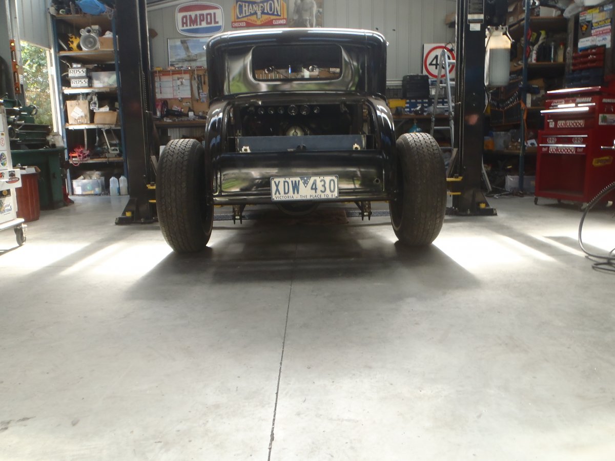

    grdra1
    A few pics of today's progress, setting potential ride height, before and after pics will be more noticeable when I have new front tyre;s and can push outside, also check out fuel cap. Glen P2200282.JPG P2200271.JPG P8210631.JPG P8210632.JPG P8210635.JPG P8210636.JPG P8210641.JPG P8210640.JPG P8210639.JPG P8210637.JPG

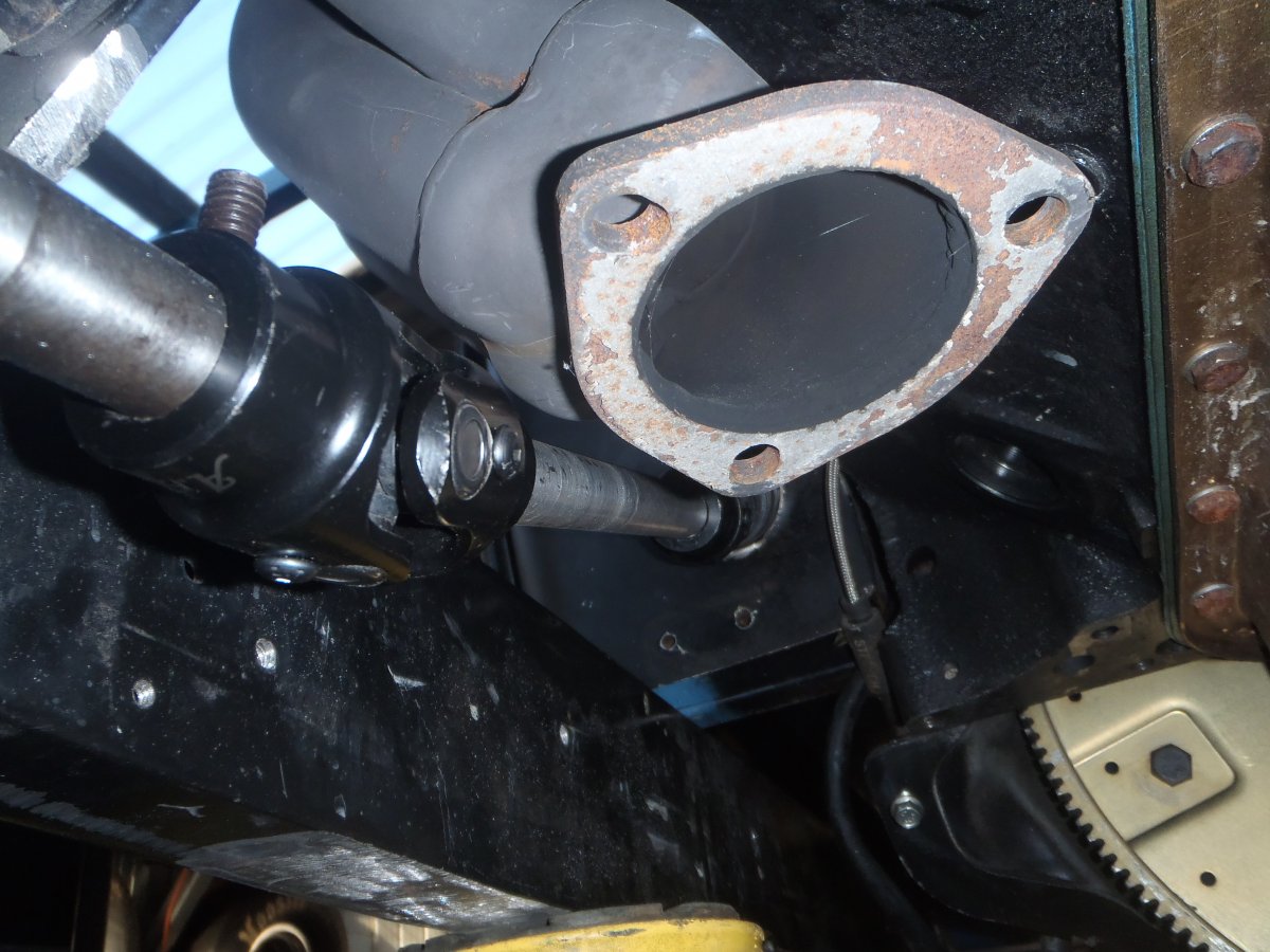

    grdra1
    A few pics of todays progress, tacked steering box in place, nearly finished maching DD shaft. Glen P8230650.JPG P8230649.JPG P8230648.JPG P8230645.JPG P8230651.JPG
  20. grdra1
    Posts: 627

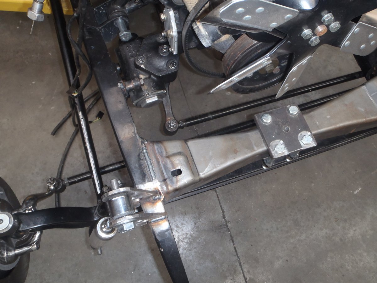

    grdra1
    Finished steering shaft today, only had 4130 bar stock so nice and strong, now car is officially RHD, also working on front panhard bar - reusing the one I made for the rear, pics soon. Glen P8250652.JPG P8250653.JPG P8250654.JPG
  21. 3banjos
    Posts: 480
    3banjos
    from NZ
    Glen, throw your wheels at full lock, which obviously pushes the drag link forward. Now you can check for clearances to add a panhard. Bracket from bottom of right rail, all the way over to your split bone, and level.

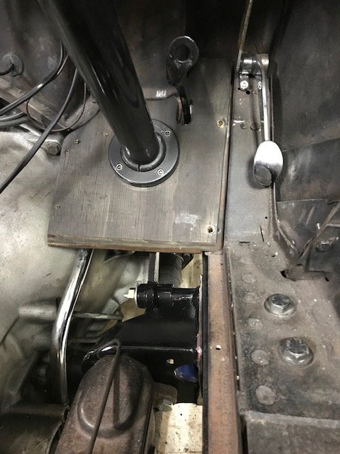

  22. grdra1
    Posts: 627
    grdra1
    Thats excatly how I have been going about it, nearly finished chassis mount and about to fabricate mount for the bone. I have purchased a new underfloor booster unit similar to what was already in the car when I purchased and I plan to modify the pedal assembly to suit. I was even thinking of mounting it under dash as there is heaps of room but would have to design a new pedal setup, so I may just go underneath - what would you reccomend and why. Glen
    catdad49 and loudbang like this.
  23. 3banjos
    Posts: 480
    3banjos
    from NZ
    Zero experience with under dash type. Under floor works fine, been done a million times, just requires a clever design to fit in that tight space. As long as you can depress brake without kicking the column and gas pedal, all good.
  24. grdra1
    Posts: 627
    grdra1
    Column will be an issue due to so little room as you said, I am unsure of best way to go about this. If going under floor I would need to locate pedal on left side of column and left foot brake to avoid kicking the column if using right foot to brake. They both could be on the right but it would be a very tight fit. I also plan to have seat as far back as possible so that maybe I can mount pedals further away from column if you no what I mean. My wife and I are not that tall so this could be an option - leg room in this car is so limited, I would hate to be any taller than the five foot five that I am. I feel that a under dash unit may give me more options for pedal location but it has its own issues with clever design and mount strength. Any pics or info / tips on brake and gas pedal design would be greatly appreciated. Thanks Glen
  25. 3banjos
    Posts: 480
    3banjos
    from NZ
    Definitely not an option going on left. That will fail compliance. Snap a pic, maybe mount the pedal to exit almost below column. But in saying that, you won't want the master and booster hanging too far below rails.
  26. 3banjos
    Posts: 480
    3banjos
    from NZ
    Pic of my brothers 28/29 we swapped to right. It can be done with the right manipulation. Heated and slight bend to get around column.
