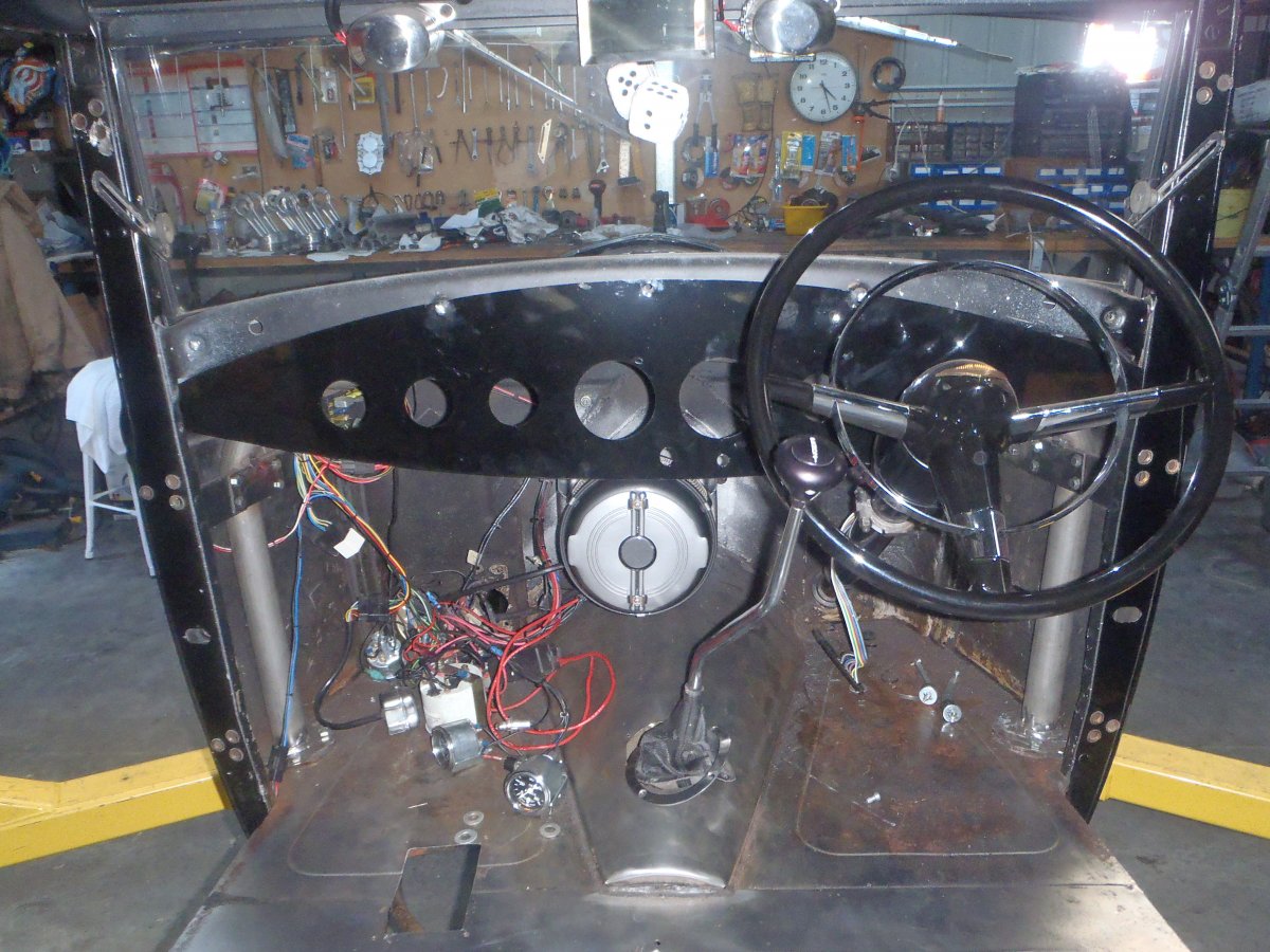

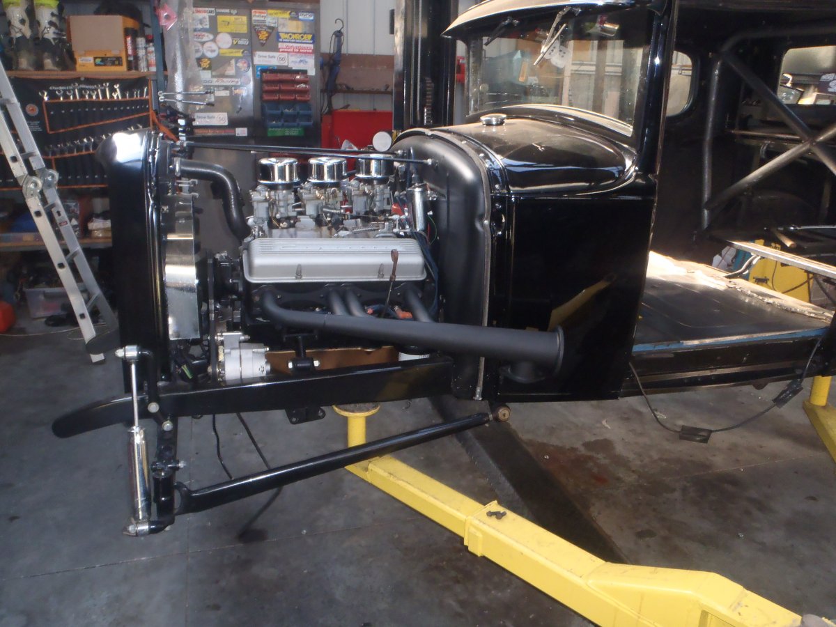

    Only drove car approx 5 miles after purchase, not interested in how it went as I planned to change it heaps, but it did drive like a tractor, although the SBC appeared strong.. latest pics / info, rear end 61 inch wide, I plan to shorten to 58 - 59 inch with 31 spline axles ( currently 28 spline) and Detroit locker to enhance looks and be more suitable for drag racing. Rear appears to be mounted about 1/2 to 1 inch towards left side or panhard could be adjusted improper. Removed dash today and I will start bending some tube tomorrow for under dash. Supercharged 392 hemi is me just thinking out loud, I plan a 400 - 600 hp SBC for this car. Glen P3140325.JPG P3140327.JPG P3160330.JPG P3160334.JPG P3160335.JPG P3160336.JPG P3160337.JPG P3140328.JPG

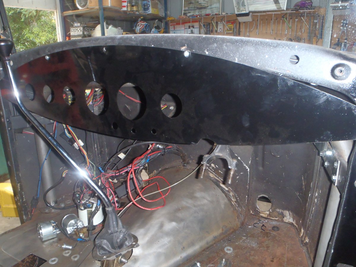

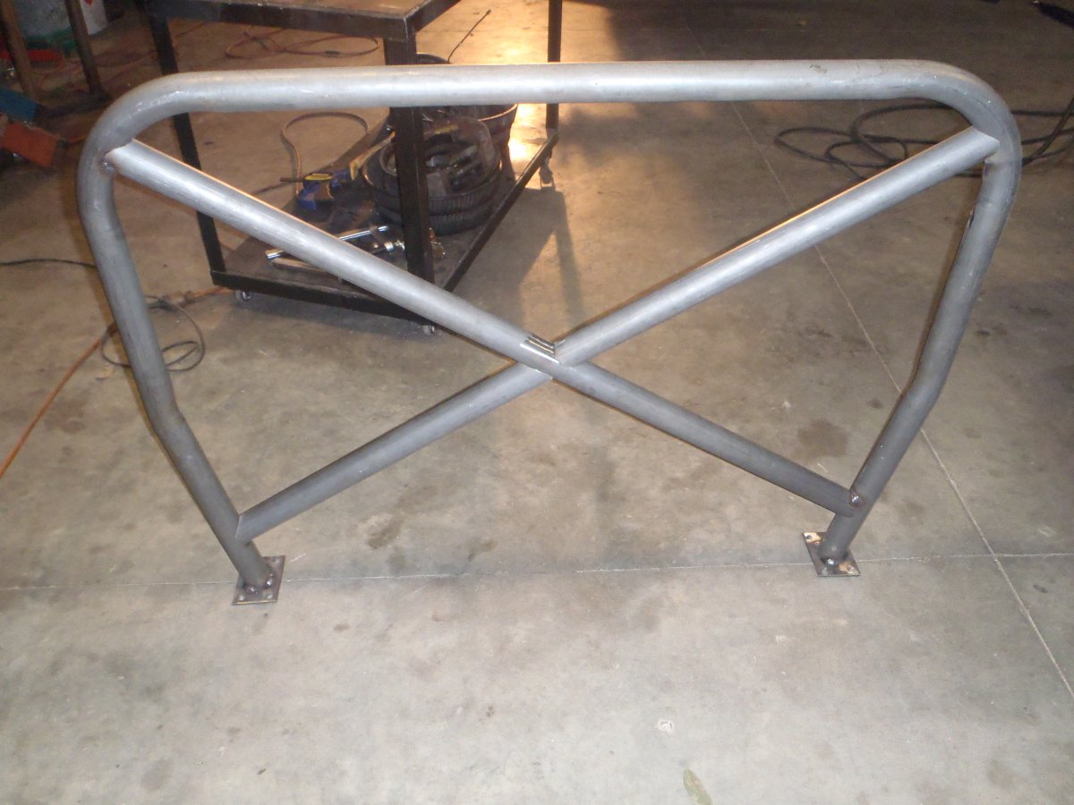

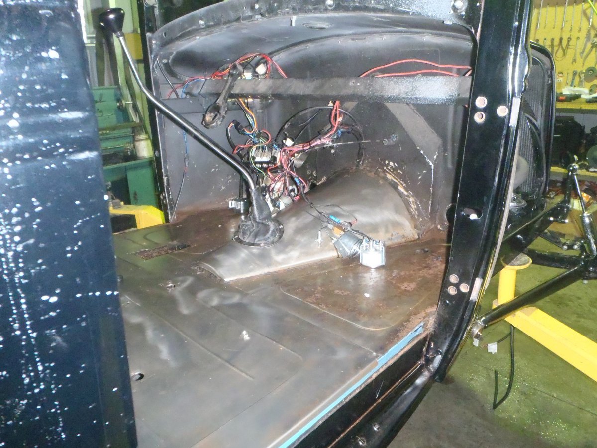

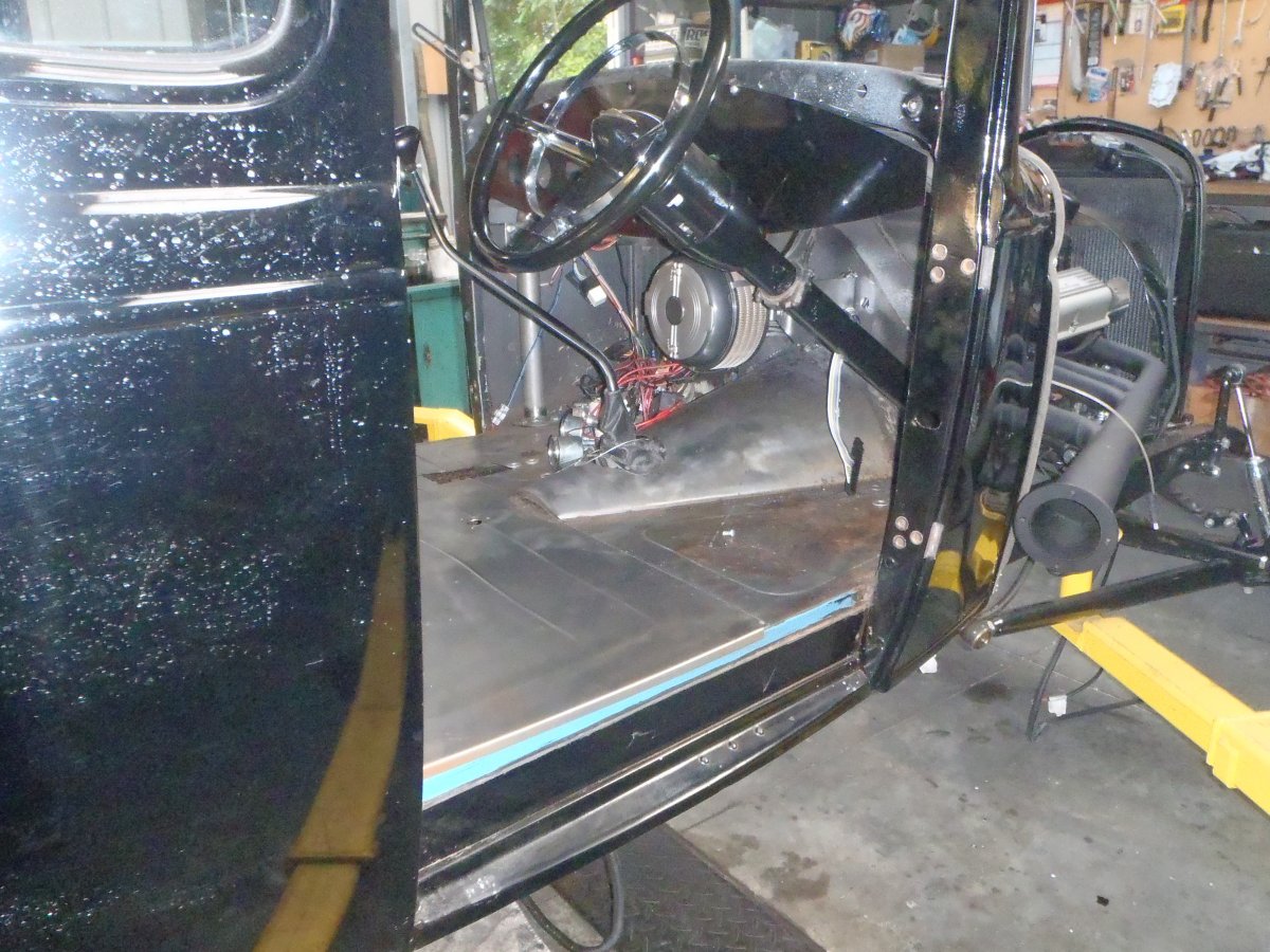

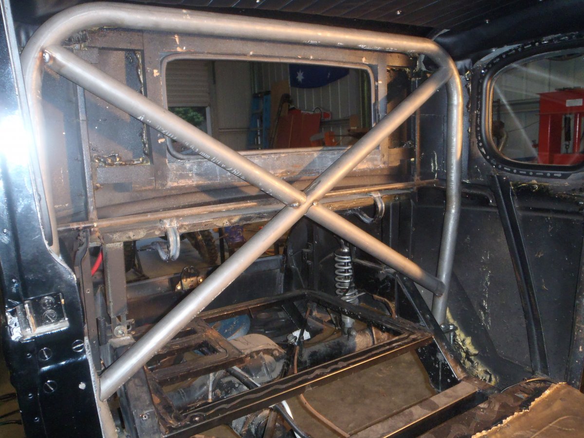

    Started fabricating bars under dash area today, had to make in 3 sections and will bolt together. Glen P3170338.JPG P3170339.JPG P3170341.JPG

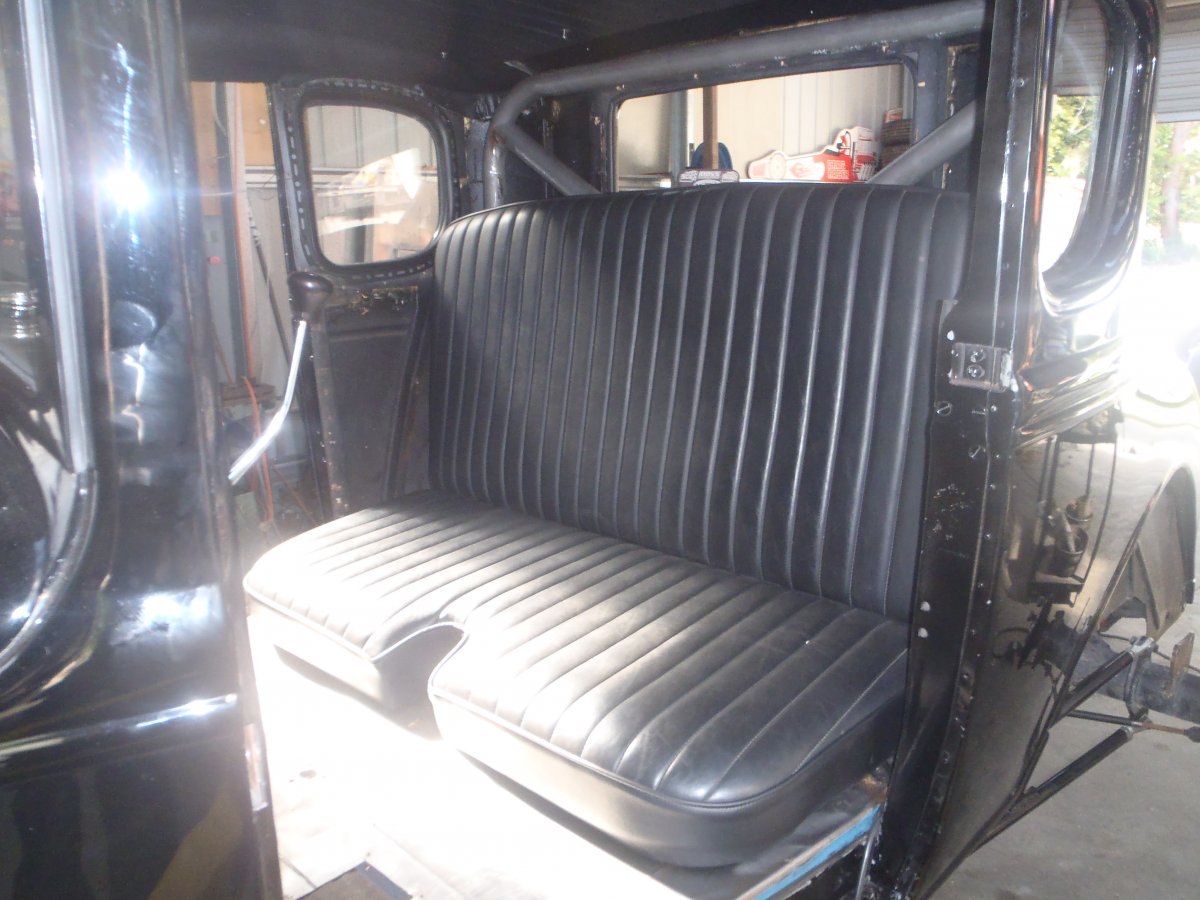

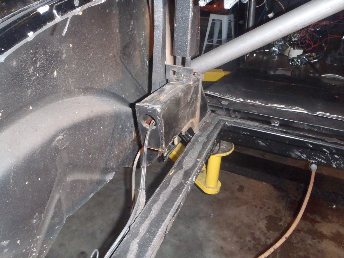

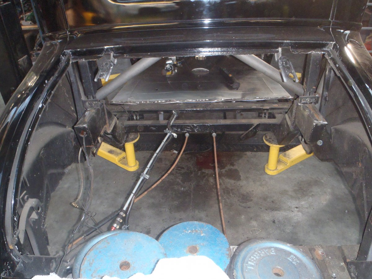

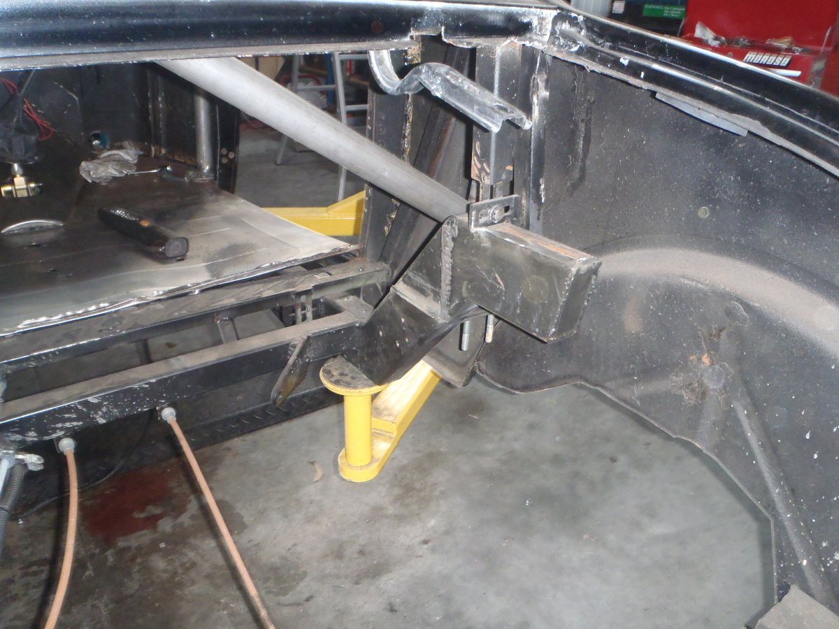

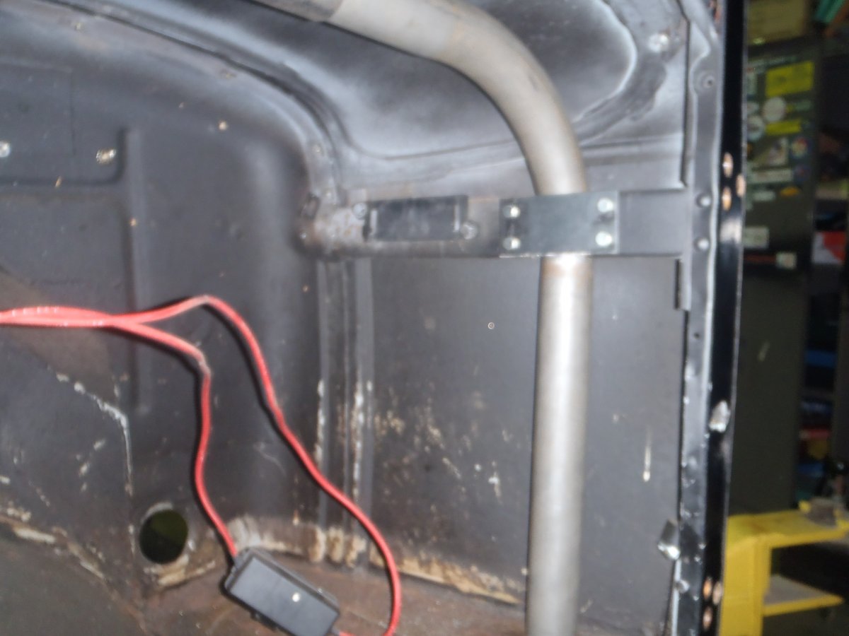

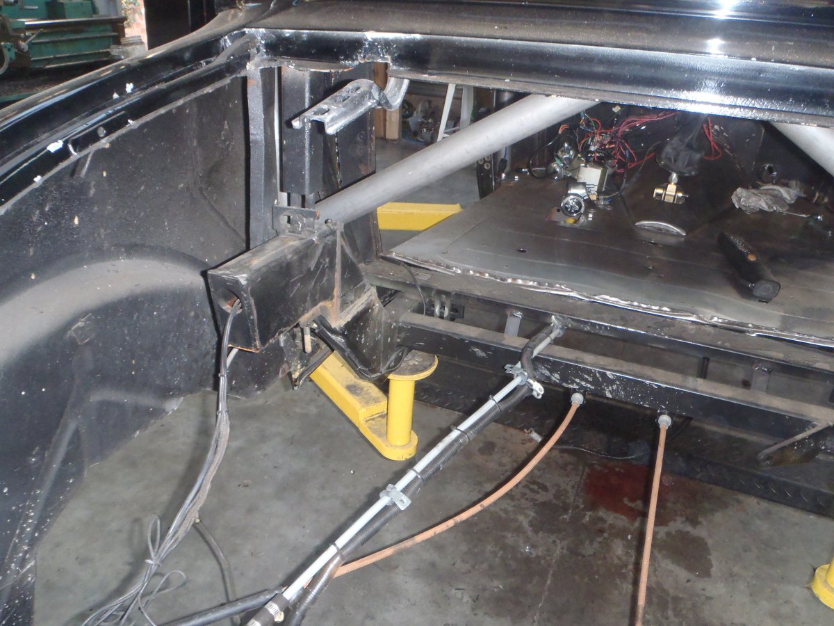

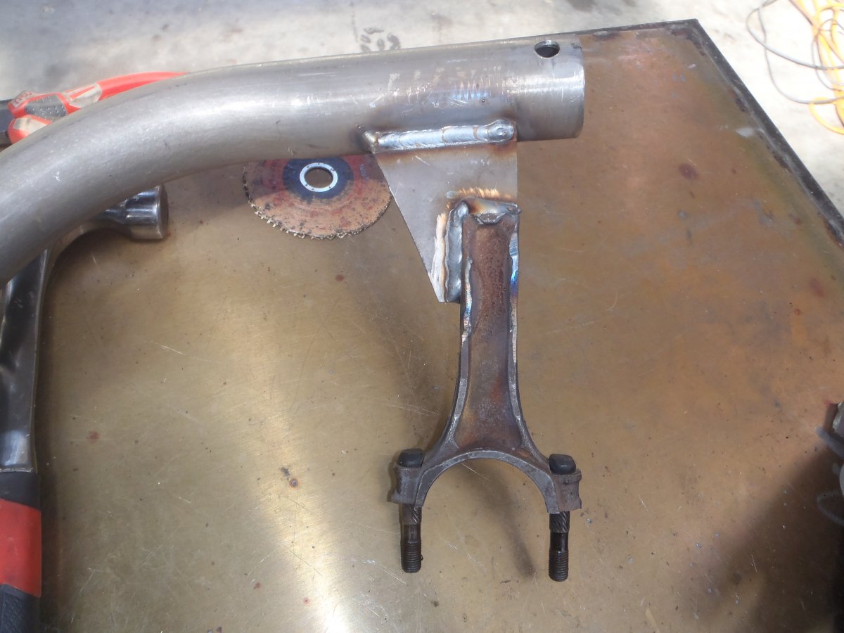

    A few pics of latest progress, decided to make cage bolt in as it would be easier for now, may weld in later, unsure at present. Glen P3280345.JPG P3290355.JPG P3290356.JPG P3290357.JPG P3280354.JPG P3280349.JPG P3280350.JPG

    Man the way those coil overs are mounted on what amounts to a flimsy tab makes me cringe.
    Glad to see you beefing it up!

  9. Nice looking car, are you going to run the rear down bars outside the body ?
  10. grdra1
    Joined: May 20, 2013
    Posts: 627
    grdra1
    I plan to keep the nostalgia look for this car, I have very limited space for the rear bars and will keep them inside. I plan to make them as high up the main hoop as I can and to attach onto top of shock mount. Now that I making it bolt in (plan was for weld in) i have to re think how its going to attach. Glen
  11. My friend couldn't get the required NHRA 30 degree keeping them inside the body.

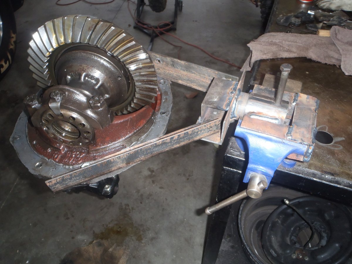

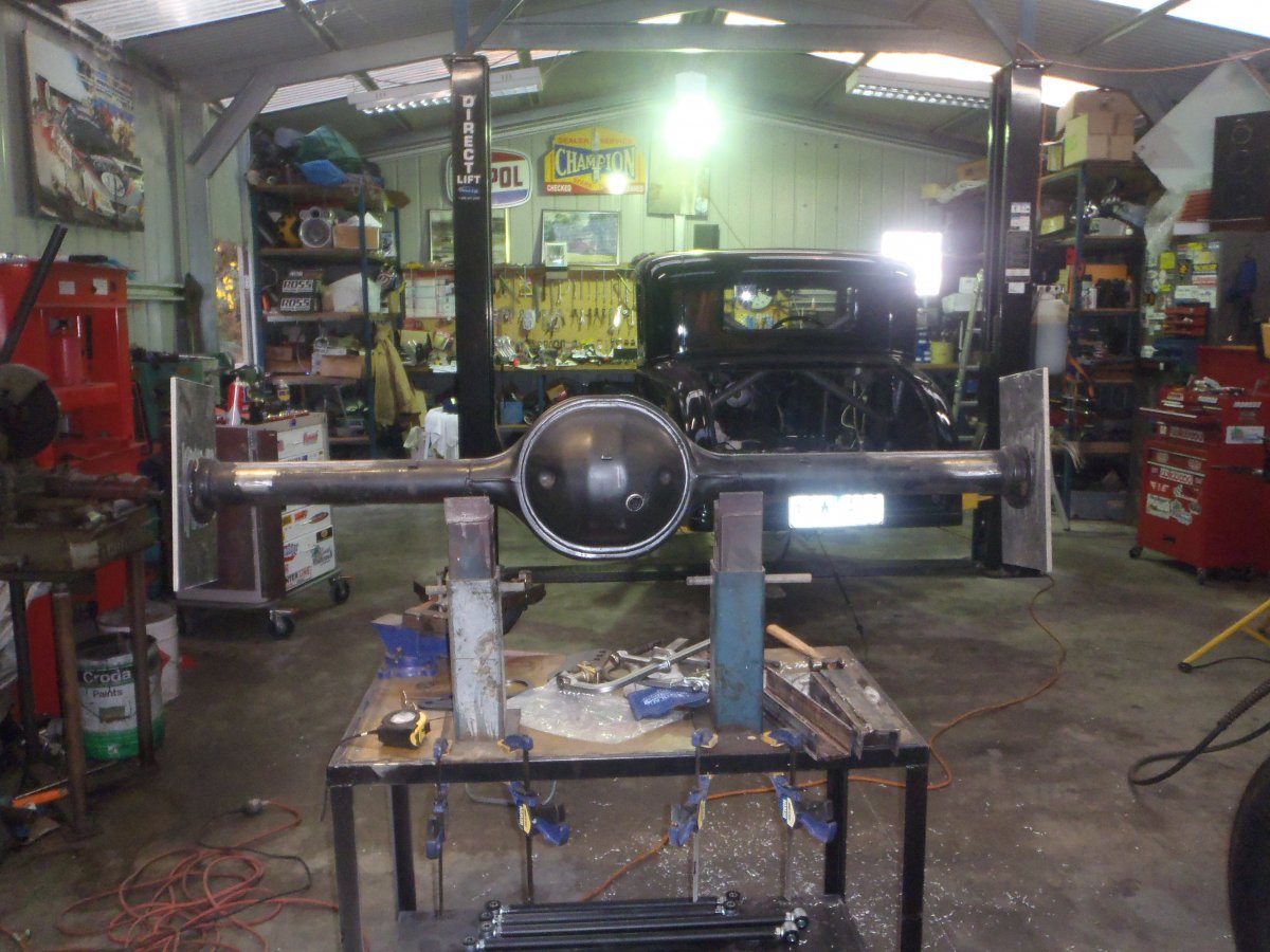

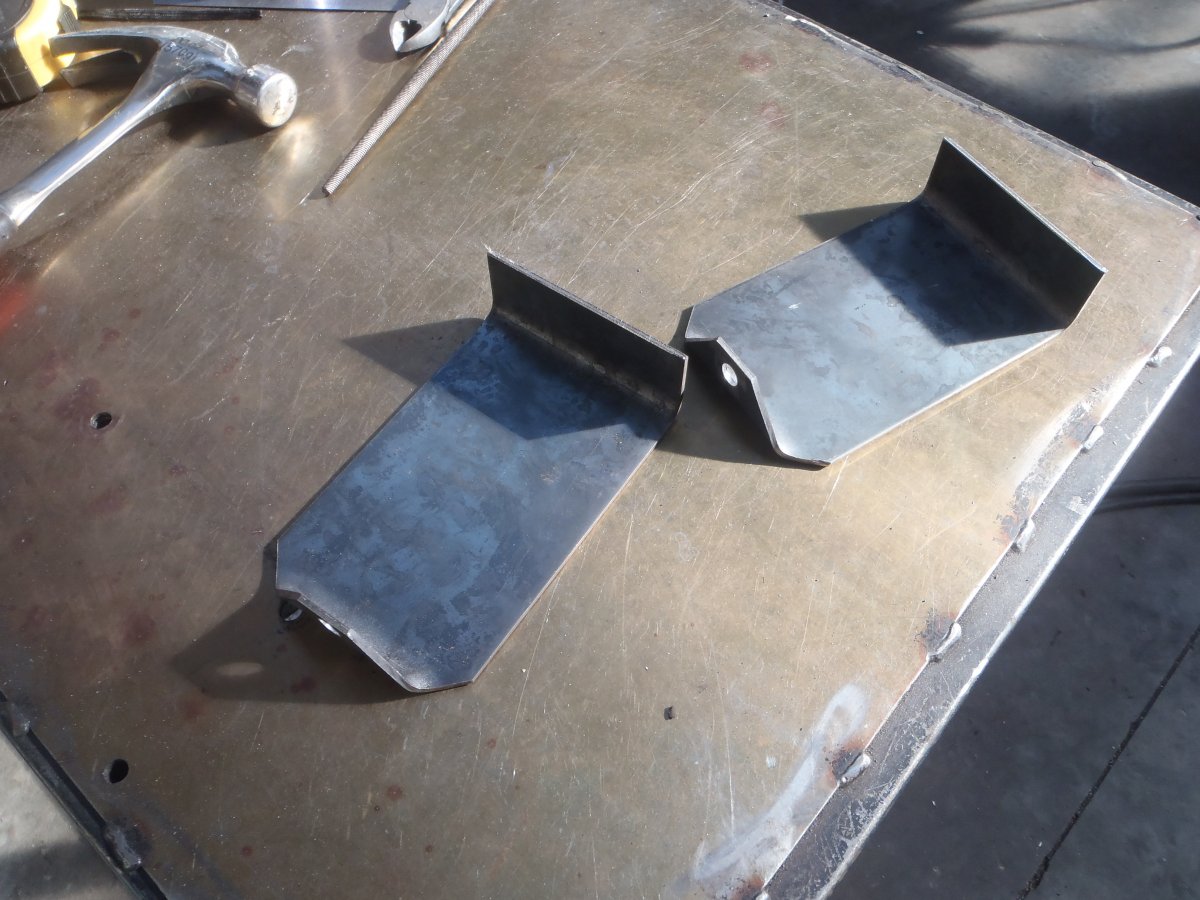

    A few pics of recent progress, pulled out rear and cut off all brackets / tabs etc getting ready to shorten. I have a pair of 31 spline axles coming (the ones with extra spline to cut to desired length), Im unsure of exact length but it will be around 56 - 58 inch wide when finished. Also have an eaton tru trac centre as well as 3.50 ratio gears on order to complete the rear. I cut off shock mounts today and will relocate them about one or two inch lower down to raise the rear of car - I feel this will get the tyre more inline with the wheel arch and also create a little more boot space. What do others think ? I also made this neat little diff centre holder to make it easier to pull down the centre - works a treat. Glen P4010358.JPG P4070371.JPG P4070370.JPG P4070368.JPG P4060359.JPG P4060360.JPG P4060361.JPG

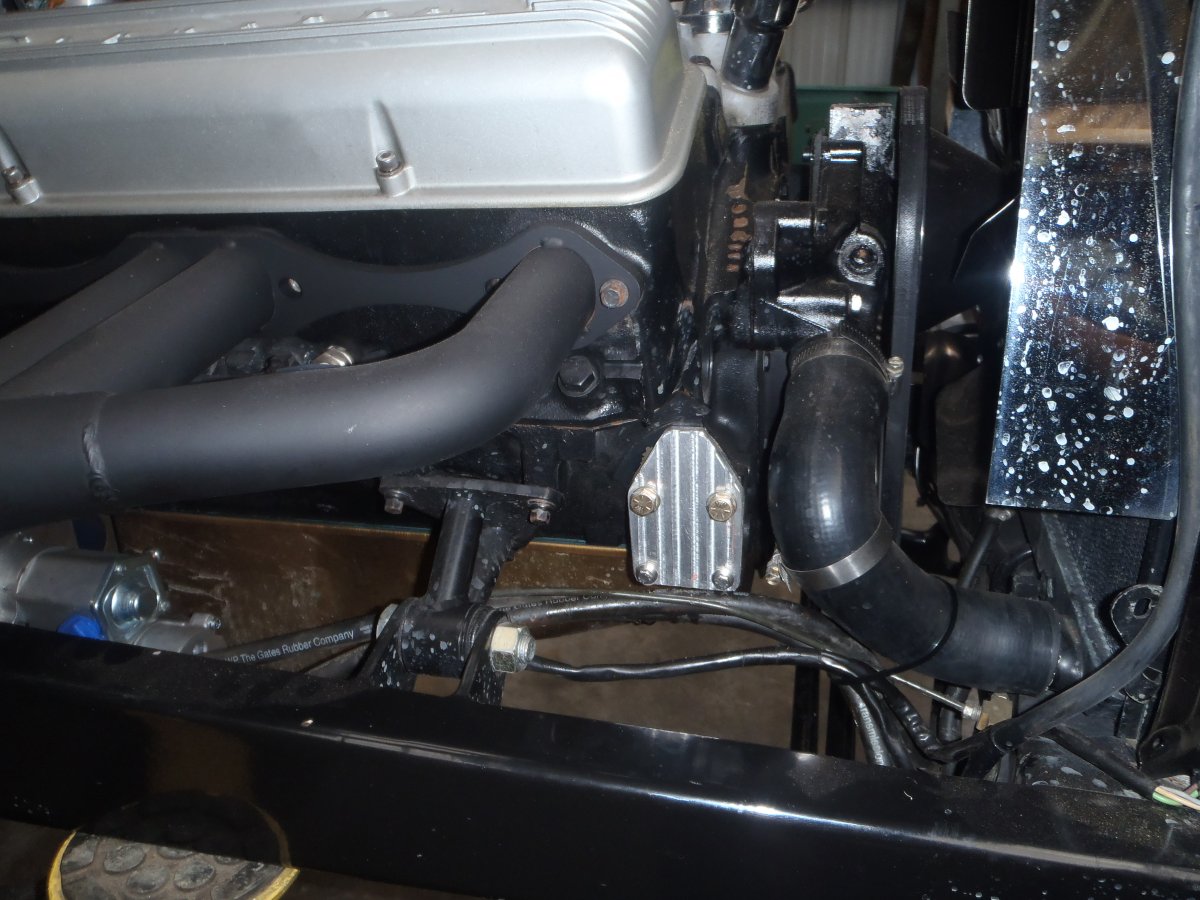

    Thanks guys for positive comments ( negative comments also welcomed if appropriate ), here are a few pics of today's work. Brought some cheap headers - surprised with quality. I will use original headers for registration and put lake style on later. I will build 2 x exhaust systems 1 x legal, the other not so, lake headers require heat protection in Australia. I also like the idea of several styles of looks for this car eg - its quite easy to change headers / exhaust / wheels for a total different look. Glen P4080374.JPG P4080376.JPG P4080377.JPG P4080379.JPG P4080380.JPG P4080381.JPG P4080381.JPG P4080382.JPG

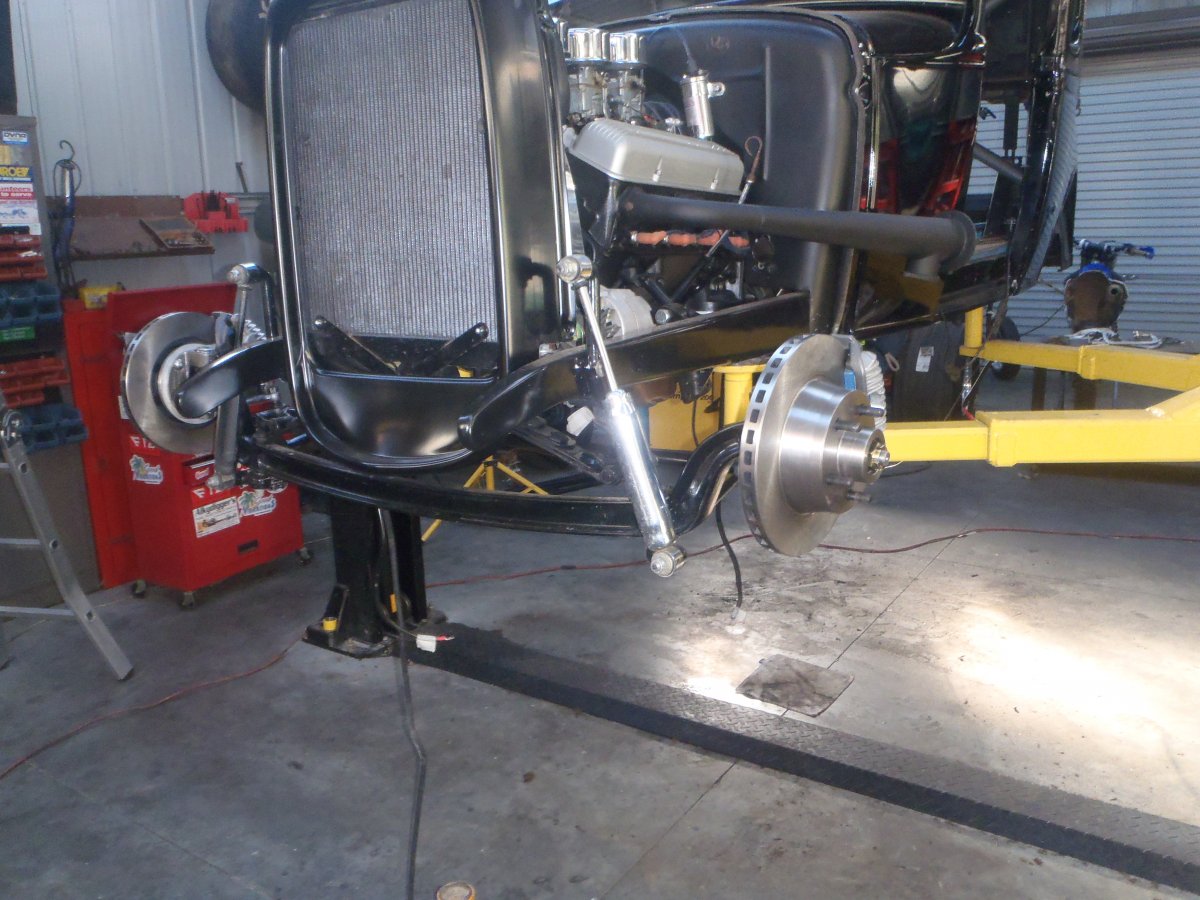

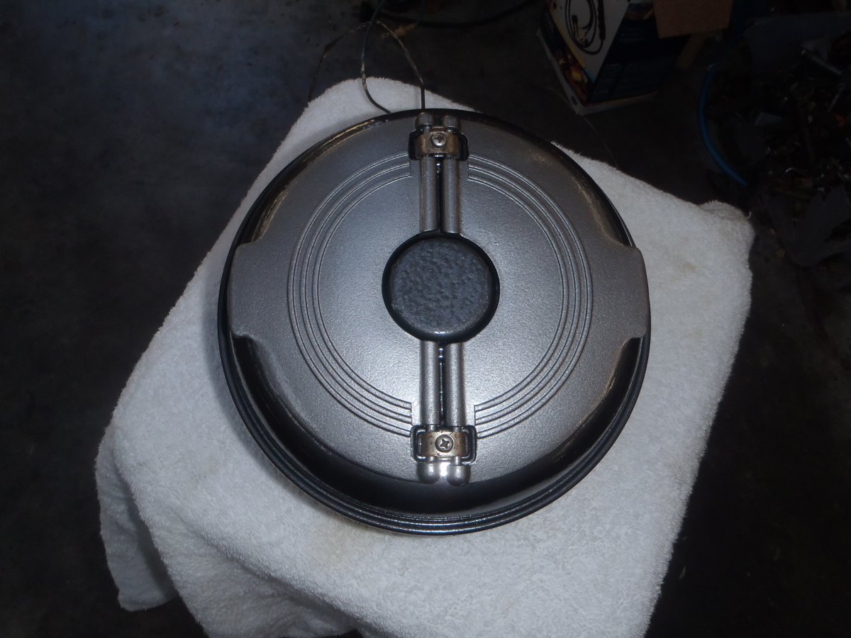

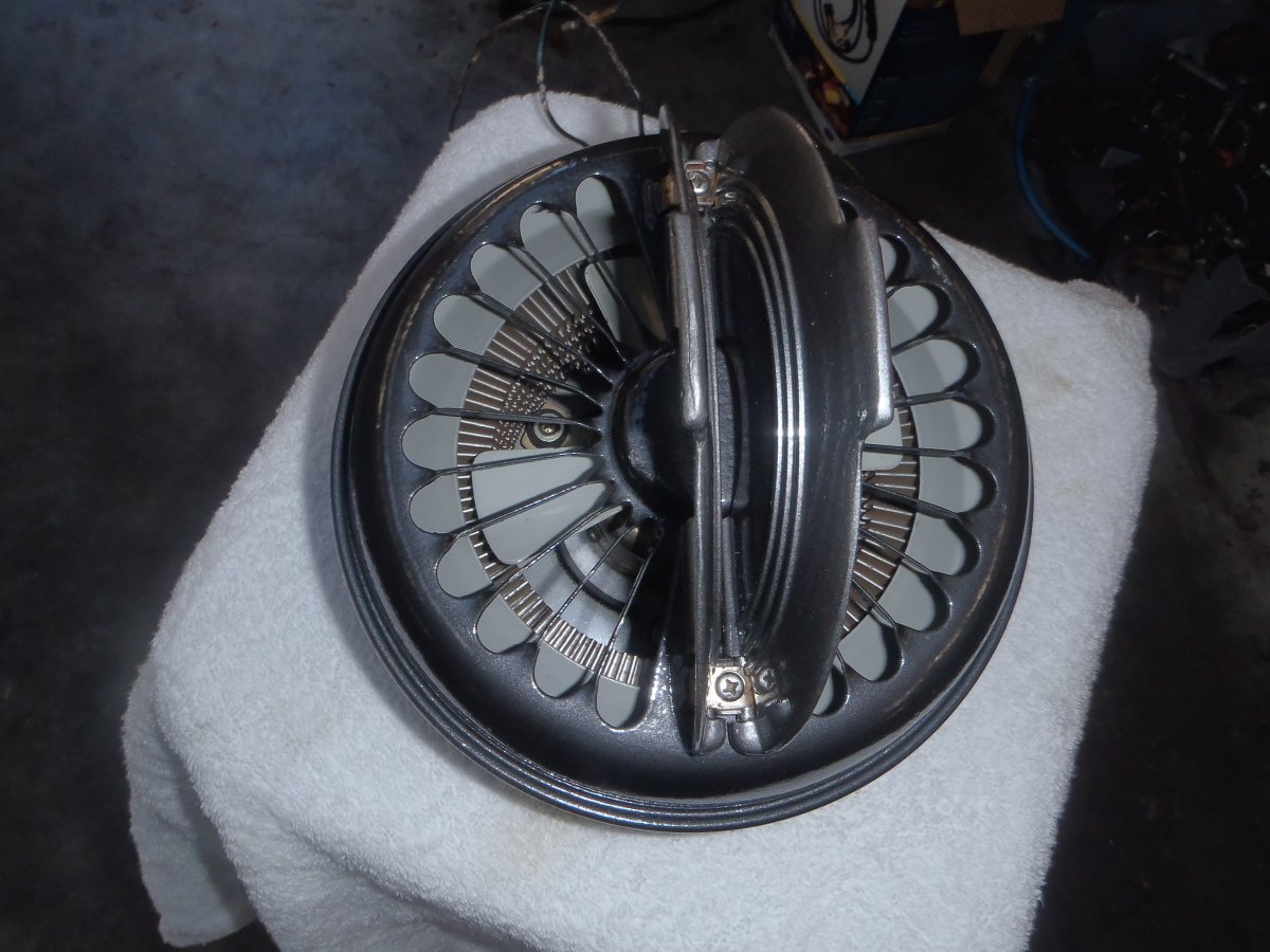

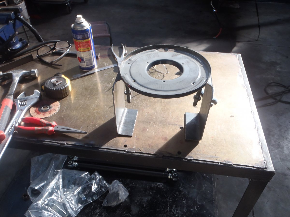

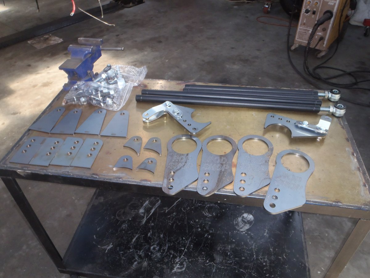

    So-cal front brake kit arrived, 4 link rear kit, axles, tru trac and centre section bearing kit also arrived. Next job is to mount steering column and set up steering box then shorten rear housing. After this is done then I will pull body off and mount rear and strengthen chassis. I also brought this old heater and gave it a fresh coat of paint, happy with results, may mount today if I get time. Progress slow but having a ball. Glen P4180383.JPG P4180386.JPG P4180385.JPG P4180389.JPG P4180390.JPG P4180391.JPG P4180392.JPG

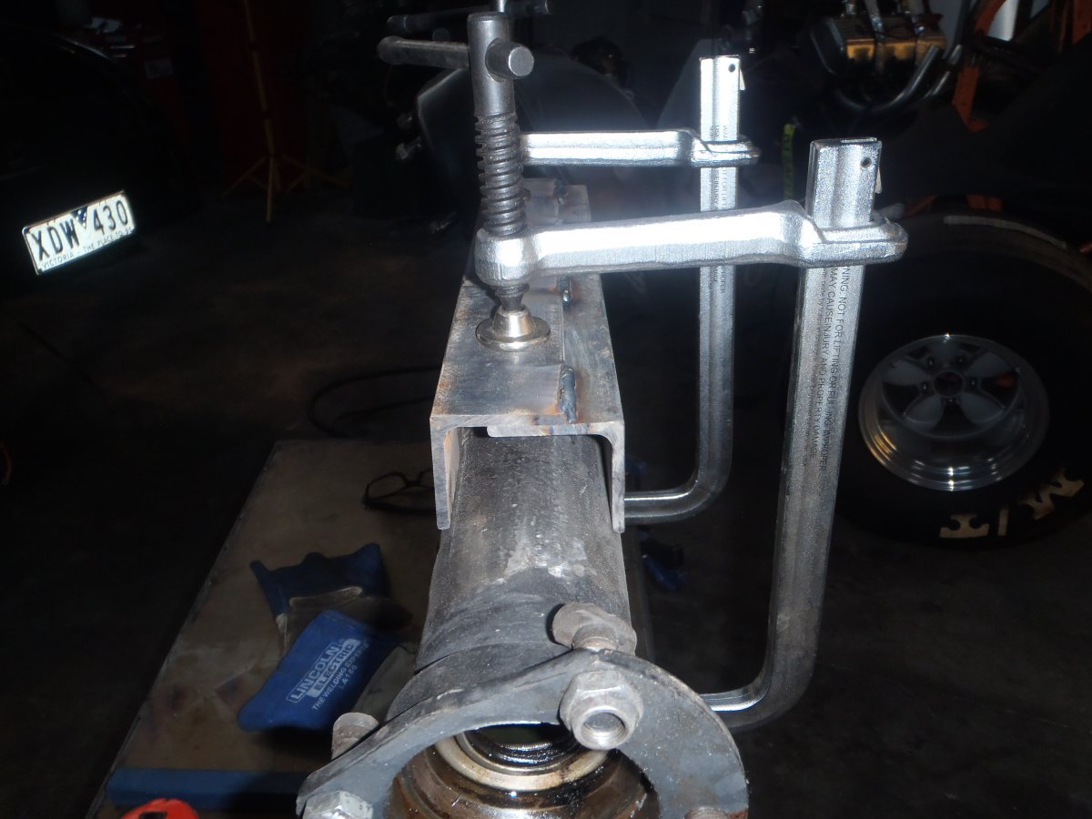

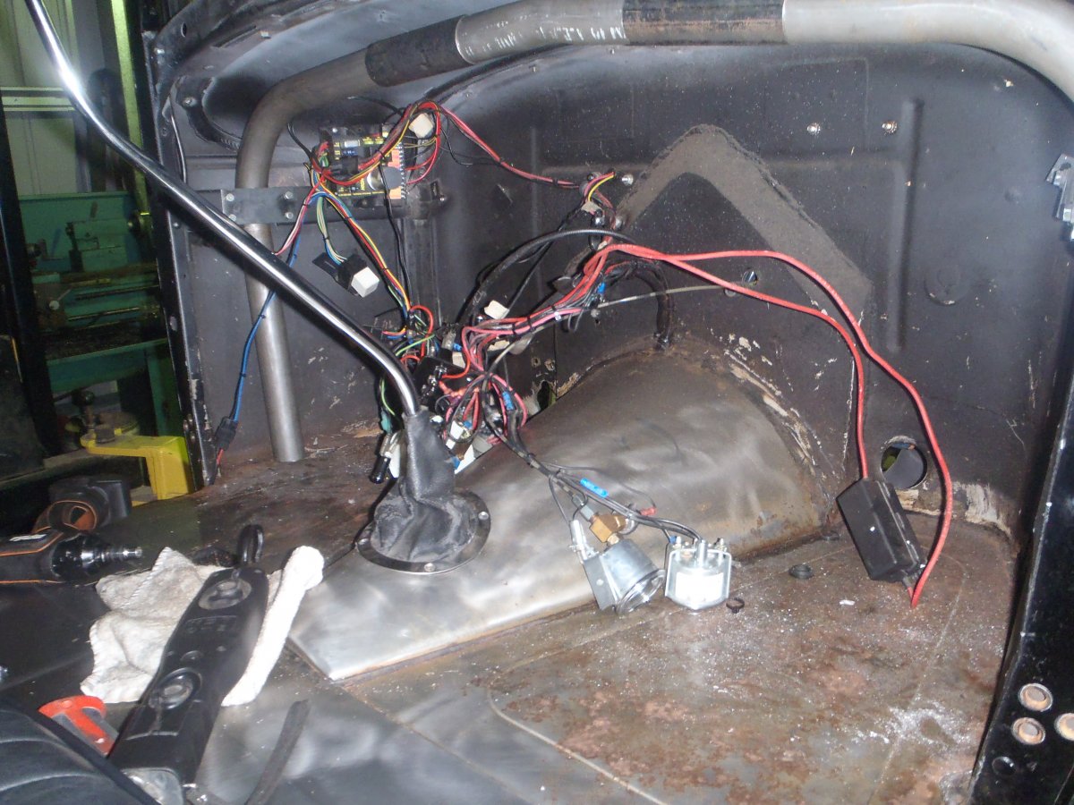

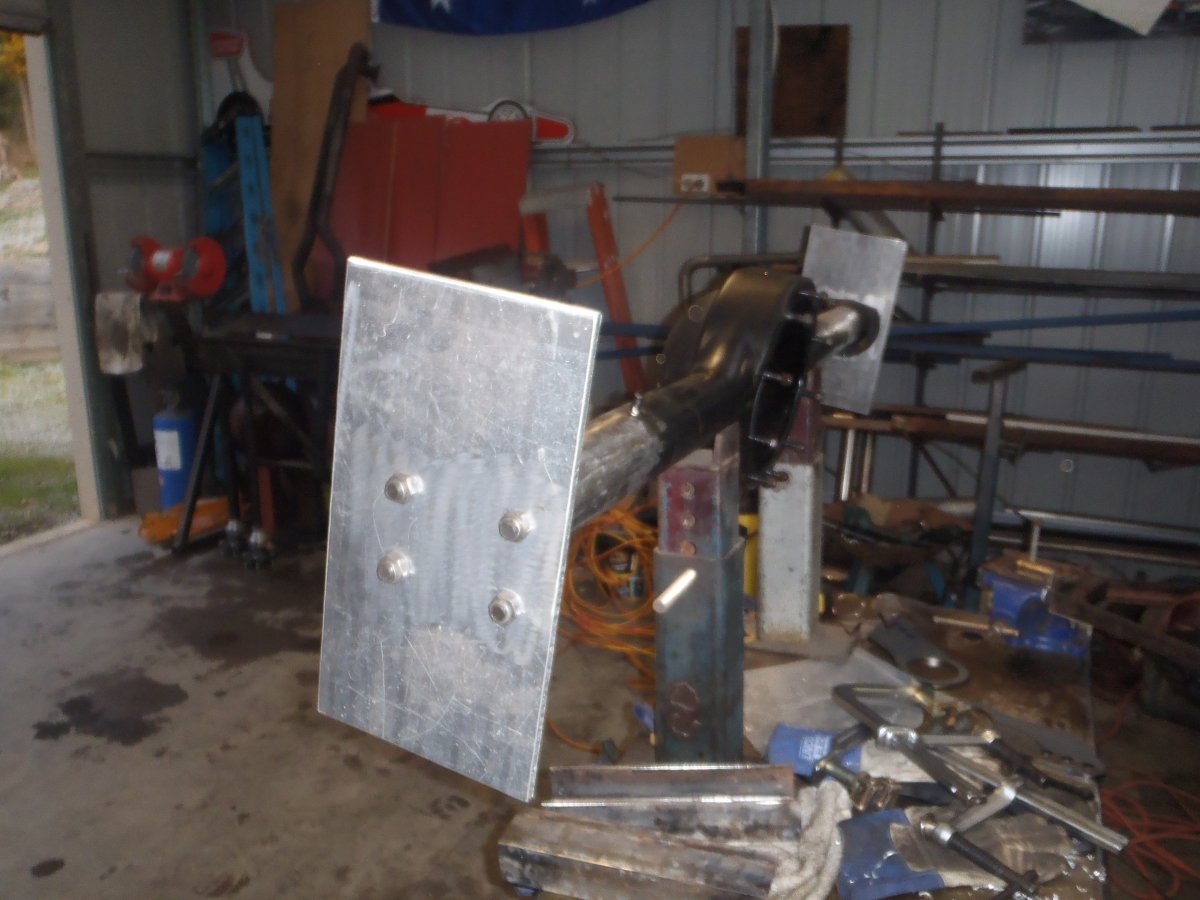

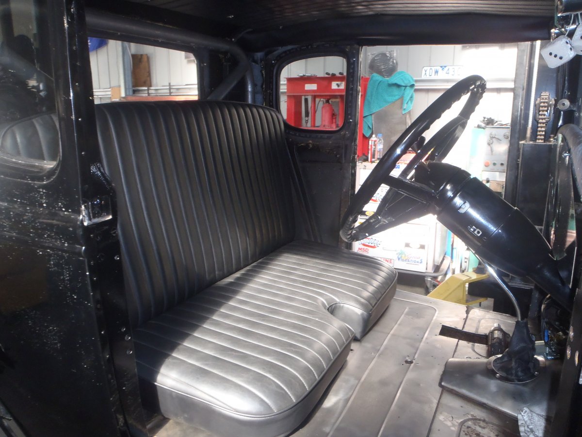

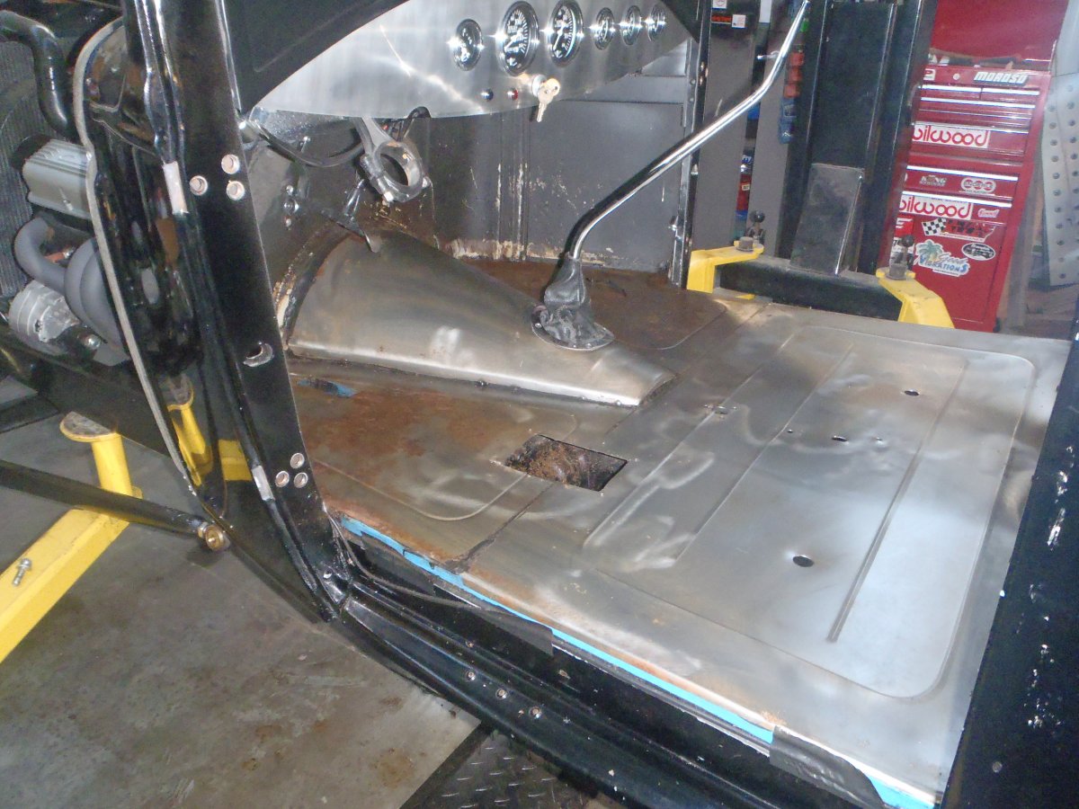

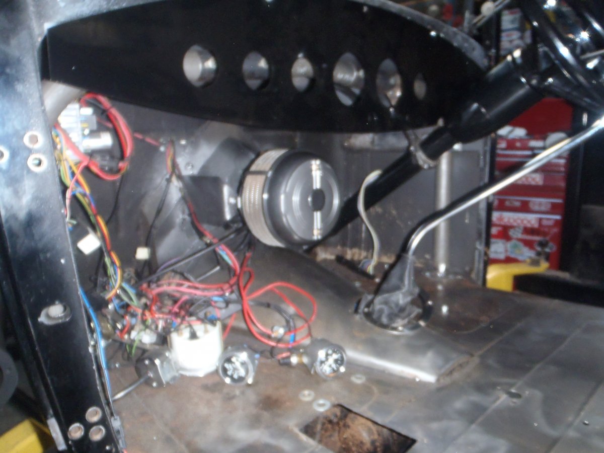

    Thanks guys, a few pics of todays progress, made column drop, mounted heater and welded up some angle iron to clamp on diff housing ends to keep straight / square when I shorten. Glen P4200398.JPG P4210400.JPG P4210409.JPG P4210403.JPG P4210405.JPG P4210406.JPG P4210407.JPG P4200395.JPG P4210410.JPG P4210411.JPG

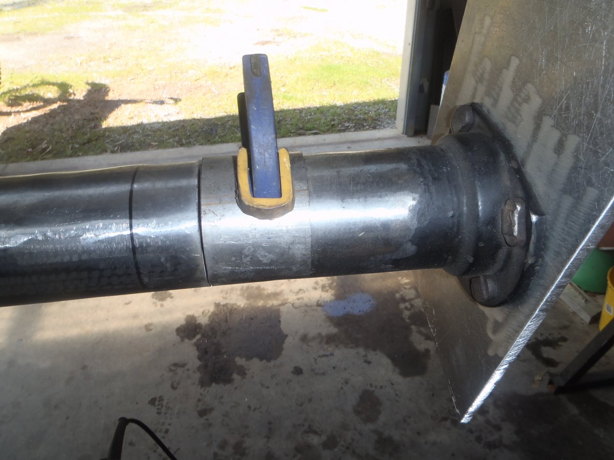

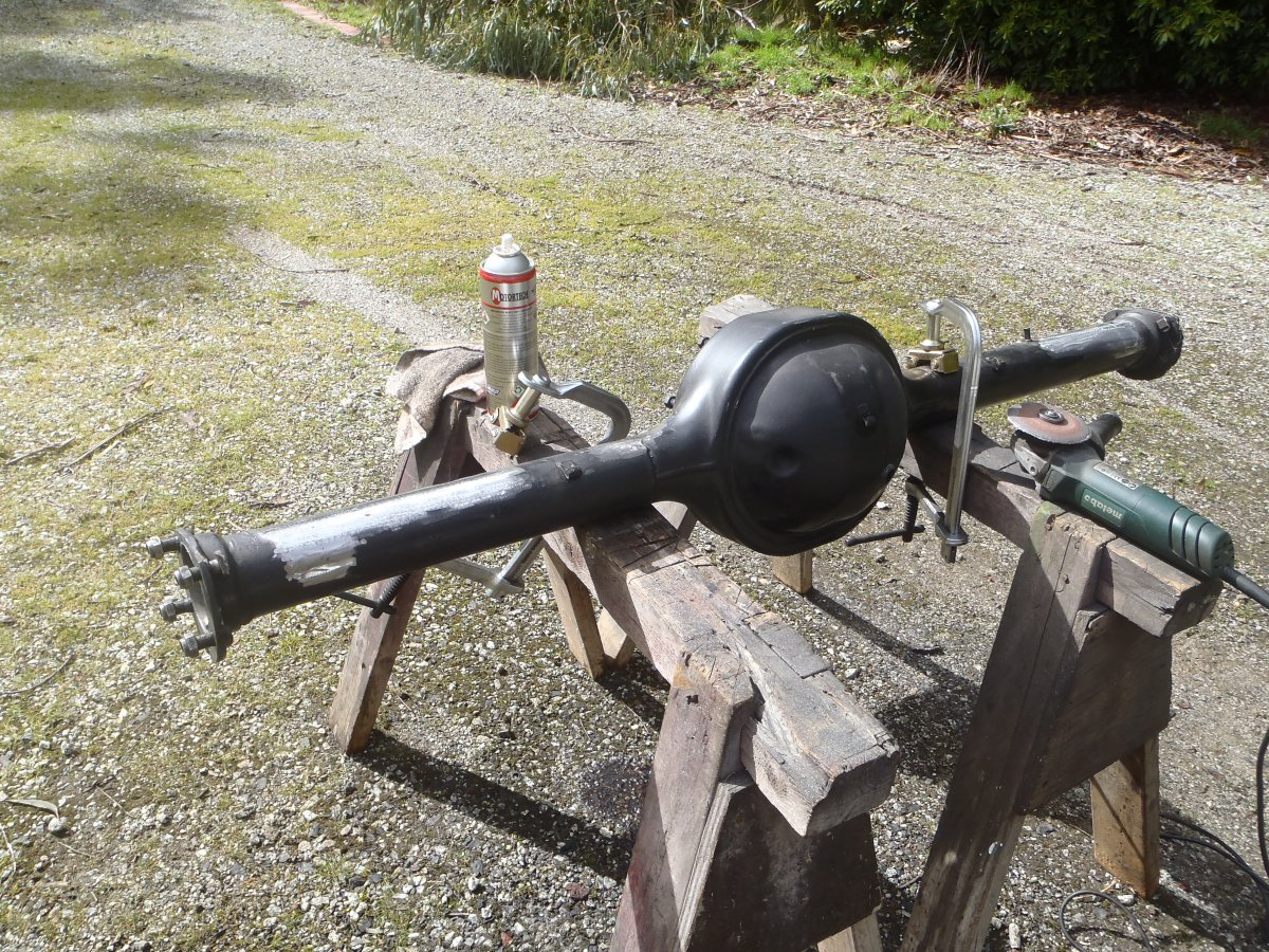

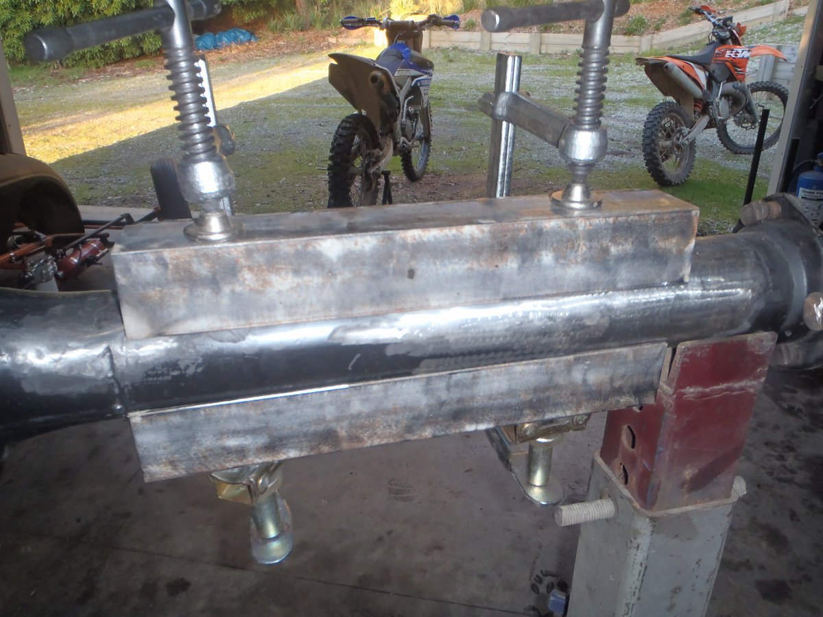

    I work as a nurse in mental health, here in Oz it pays well but you need to put in the hours. Done many other jobs over the years and went to uni at age 40 to study nursing. I am self taught in everything cars and engineering thru playing with them all my life. All my stuff is a result of hard work over a long period. The missus is not happy with all my possessions but I cannot help that, boys need their toys. Anyway a few pics of todays work, shortened housing 1 1/2 inch per side. I made a couple of end plates for reference and used a small piece of pipe to help cut housing square. It turned out ok, now I need to assemble centre and cut axles to suit. Glen P4240413.JPG P4240414.JPG P4240416.JPG P4250417.JPG P4250418.JPG

    verde742
    My friend did ALMOST the same, but put a piece of pipe thru the middle and tighten each end.

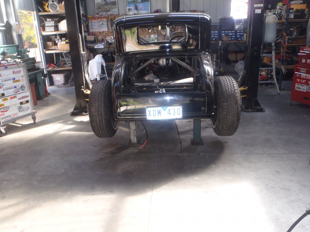

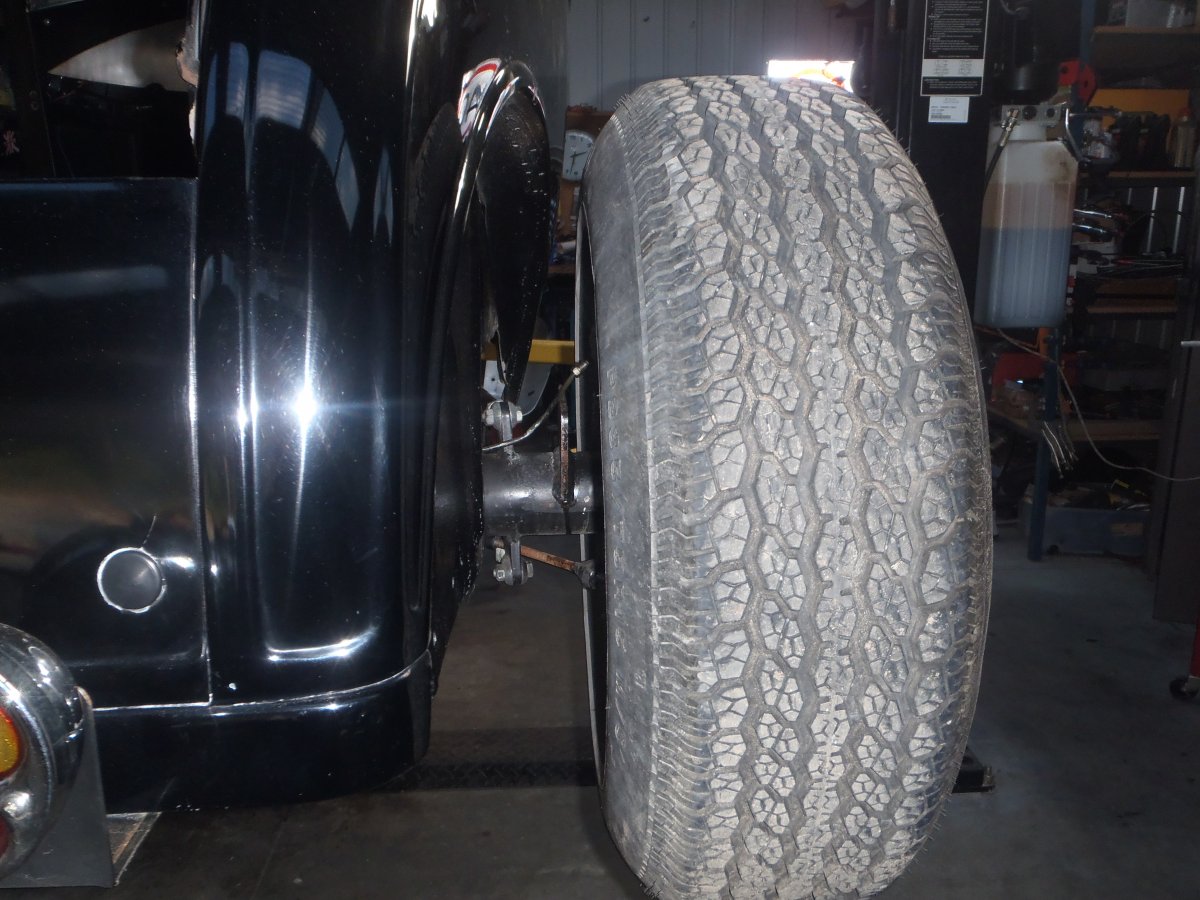

    A few pics of today's progress, axles cut, check out comparison pics, happy with result. Glen P3140325.JPG P4280422.JPG P3140328.JPG P4280421.JPG P3140329.JPG P4280420.JPG

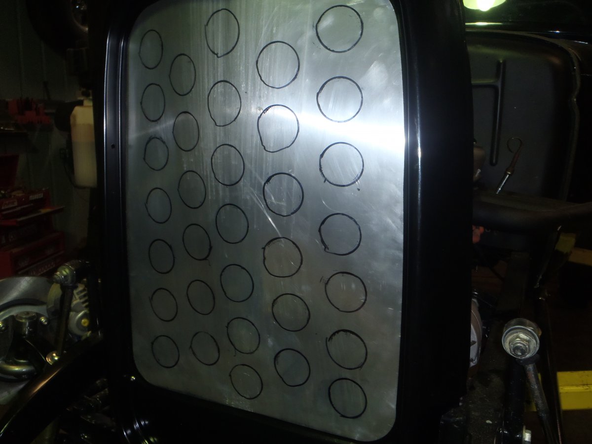

    A few pics of today's progress, Pittman arm required some modification to keep over split wishbone, anyone in OZ no legality's of bending Pittman arm. Also planning to build dimpled grille, any suggestions. Grille will be painted black, Im not into shine, Also a couple of pics of past rides, 28 roadster and 1970 ford replica GT sedan - P4280425.JPG P4300426.JPG P4300427.JPG P4300429.JPG P4300428.JPG P4300434.JPG P4300438.JPG P4300439.JPG P4280425.JPG P4300426.JPG P4300427.JPG P4300429.JPG P4300428.JPG P4300434.JPG P4300438.JPG P4300439.JPG 12 sec street car. Glen
