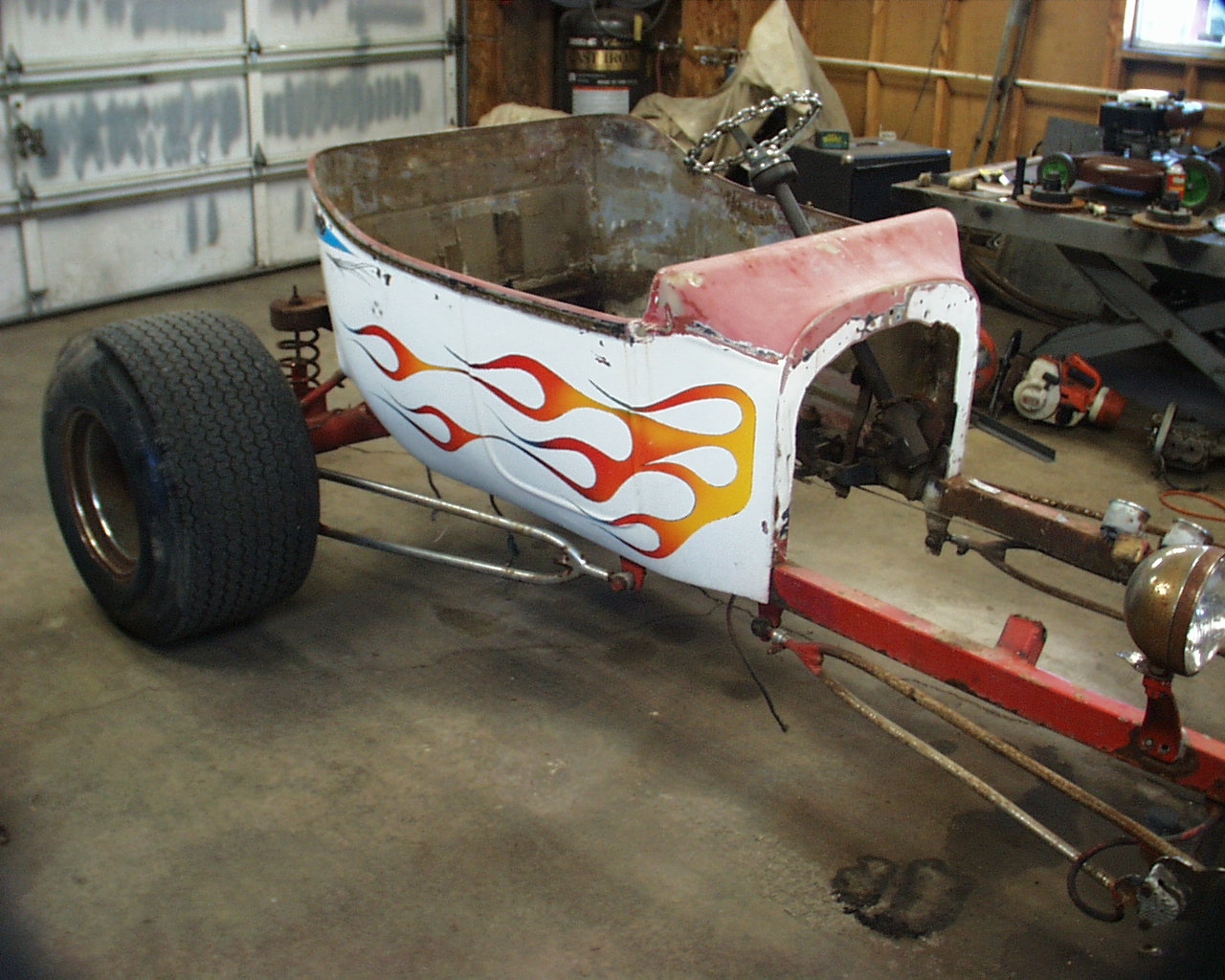

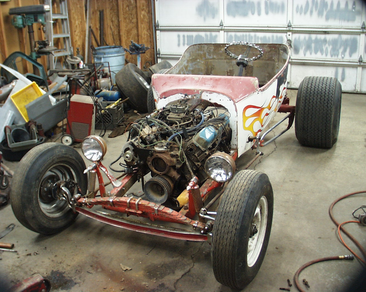

    Here is my new project....yes yes i know its a t buckt... its what i have to work with...:)i have a 413 carb to pan to trans, thats going in it...other that that... not sure... looking for parts... whats you see is all i have..did have skinny wires on the front gone when i got it..looking for a set

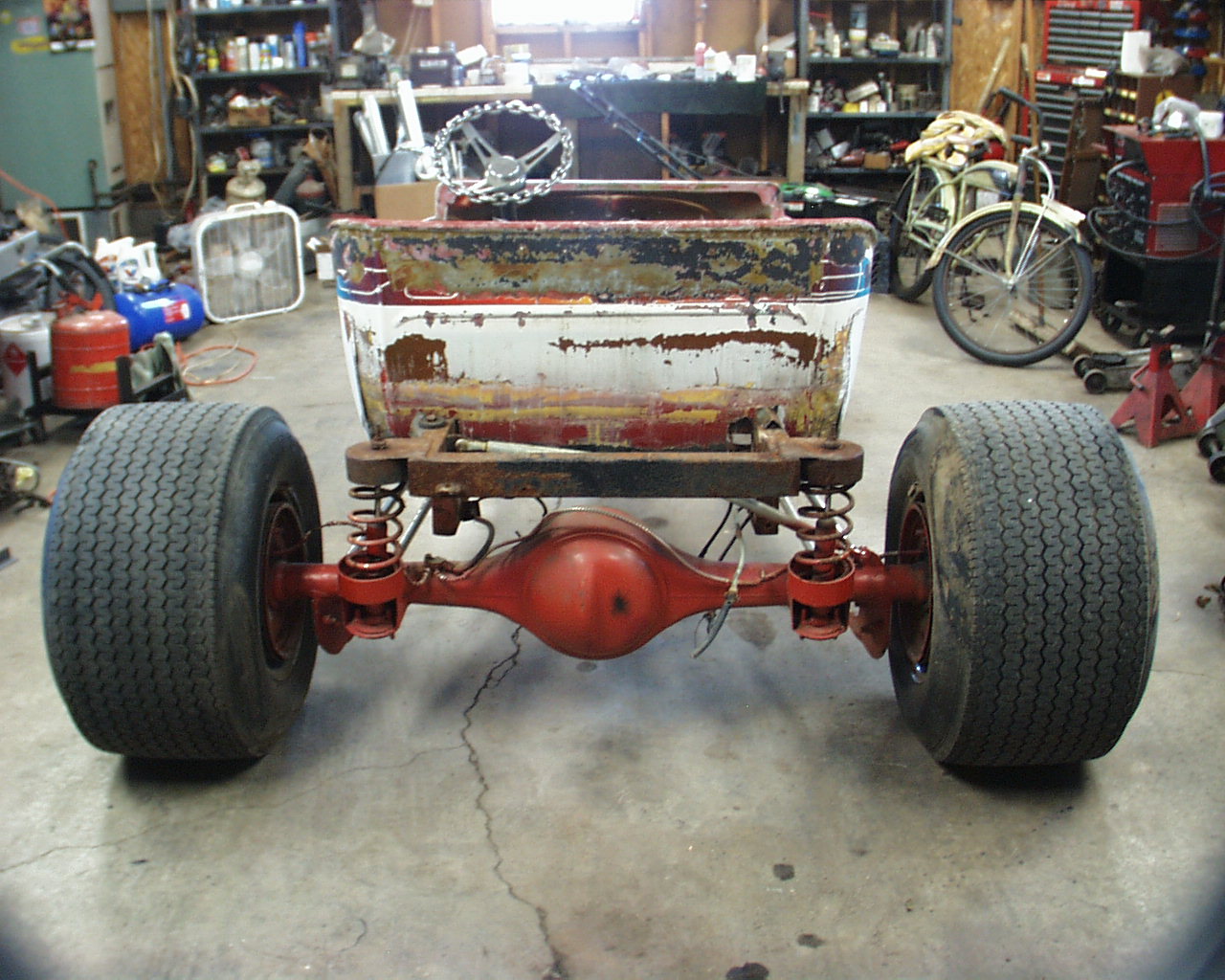

    Call me naive, but can that spring setup handle the torque and big tires? Looks a bit light in the shorts and heavy in the crotch.

    Geez, what a complainer...do you also get so sad when you only find a 50 dollar bill in the parking lot :D
    That is a very cool start IMO. That front end is awesome, as well as other cool stuff. Is that an early Olds rear?
    Do as you want, but I'd go more Norm Grabowski or Tommy Ivo with the back tires AND the steering wheel. The rest is right on target:cool:

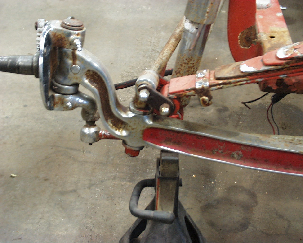

    As long as the hairpins, the panhard bar and their attachment points are strong enough, no problem. Those are what control the axle. The springs don't have much to do with it...they just suspend the car. The springs do look light, because they are...and that's a good thing. In fact, they might even be too stiff. The last thing you want on a light car such as a T-bucket is stiff springs, 'cause it'll feel like the axle is mounted solid to the frame.

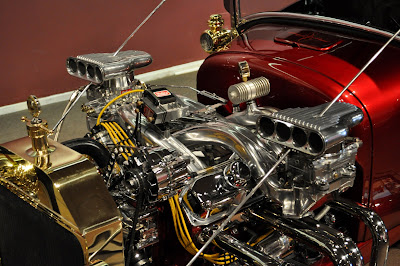

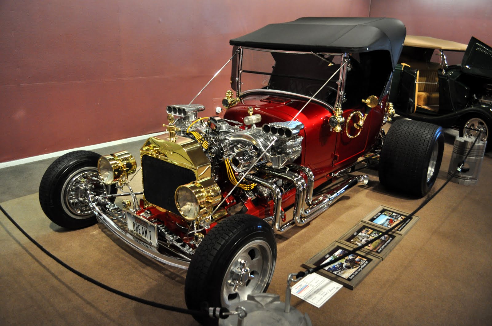

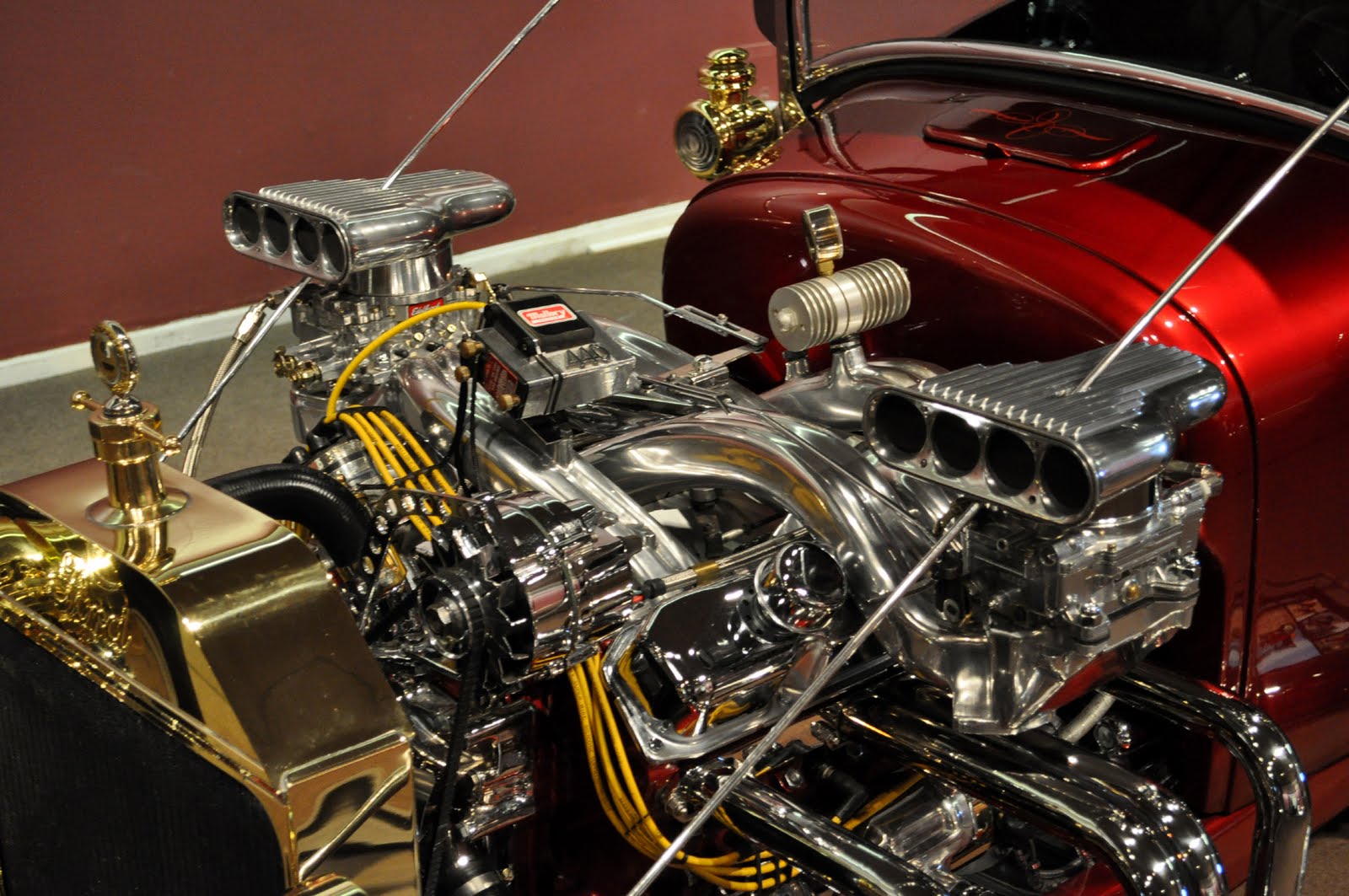

    You mentioned dropping in a 413...I really dig that idea! My question is, would the "long ram" intakes fit on a T Bucket or would they stick out too far? I cant say I have ever seen a T with a set of those on it before...they look totally bitchin IMO.

    Yes!!! Those long rams on that thing look SICK!!!! I think I need one now....

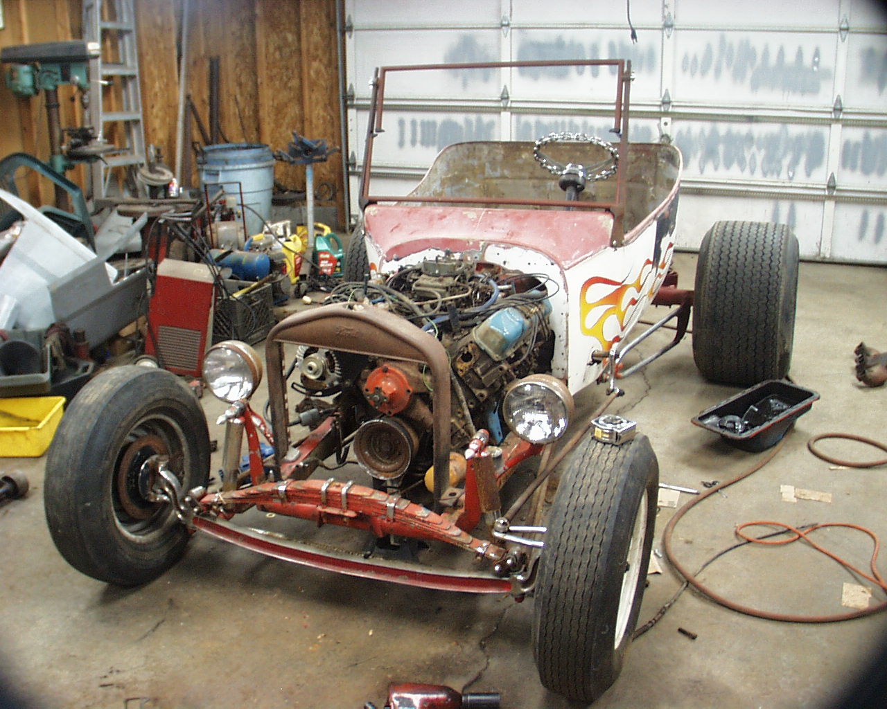

    here are a few more pics that may help someone help as to the year there abouts on this build PIC00040.JPG

    Wow, no space problem for a decent sized radiator. Looking like it's off to a great start.
    I like this car a lot...I suppose I already said that:eek:

    thanks... I can go forward a little more if need be.. I need to get a pump and a fan on to see, were it needs to be... iam thinking it looks good were its at though.... in the same place the chevy one was...its setting to low now .. oil pan 1'' off the floor don't have motor mount pads under the mounts yet...not sure how high it needs to be.. guess as high it can be without looking funny
  26. F&J
    Joined: Apr 5, 2007
    Posts: 13,222
    F&J
    That side view is decieving for how the motor height will look. It does look a bit too low, though.
    One big issue with any older car, is room for a gas pedal in a decent place. So, I'd want to get the pan up as much as possible, but keep an eye on losing too much footroom. The A/T will help gain footroom.
    extra time spent now in mockup, will pay off bigtime later.

    Why wouldn't they fit? He hasn't got a hood?
    Long ram intakes would look bitchin on that car. Does anyone else remember Arin Cee's home made long ram setup that stuck out beyond the fenders? He hung a couple of lanterns on them for night driving lol.
