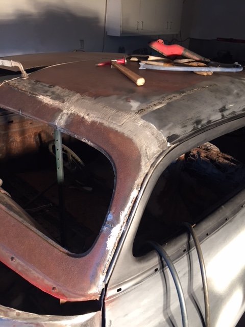

  1. Looking good Andy! You're a mad scientist with the metal work joining the Merc windshield to your Buick. At first I was wondering why you were going through all of that trouble and now I understand. I know it will look good when you're done.

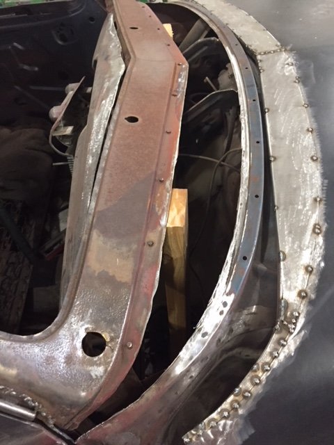

  2. Getting it done . Half the opening welded in . Coming along well . I wasn't sure but now I see it will look good .

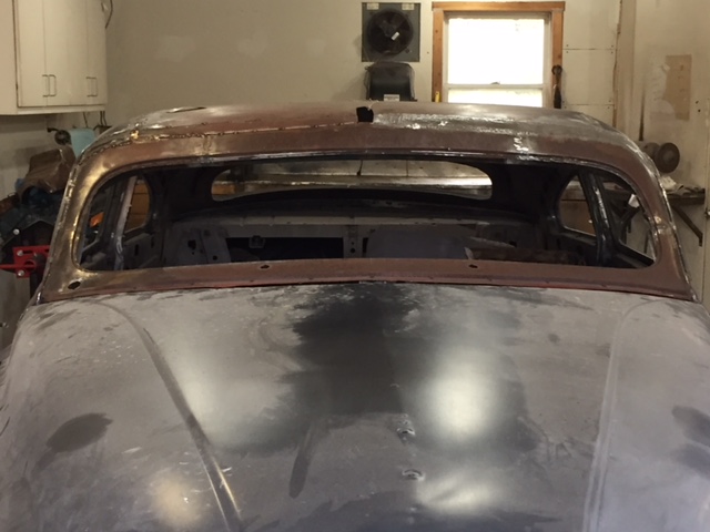

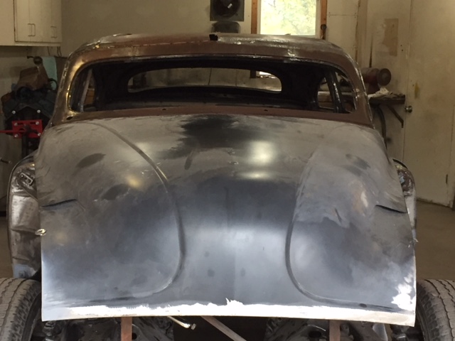

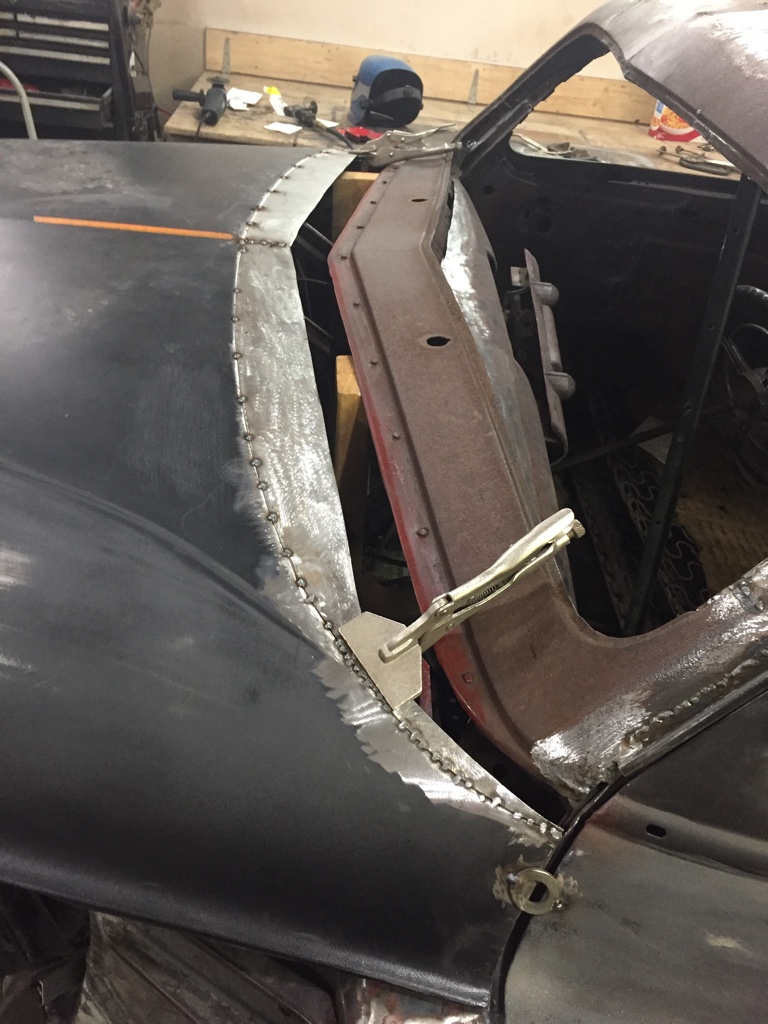

  3. Got ahead of it some more today ! I was able to get the passenger side all tacked in but it still needs some finessing . A buddy of mine gave me a hand while he was here and we mocked up the hood to check flow with body line etcetera etcetera . I am torn as to fill the cowl area with a filler piece or to add to the back of the Buick hood to make it stretch to the Mercury opening . Both options will work and will be kustom in their own right . I just don't know which option I prefer !! Comments / opinions ????

  6. LoL , how about cowl induction ???

    I think the hood should have the same VEE that the windshield has.
    hacknwhack likes this.
  9. Yes sir that is what I have decided to do Andy . Not getting much time on the car at the moment . Fall jobs to get done before the weather turns but stay in touch as I move along . Andy..

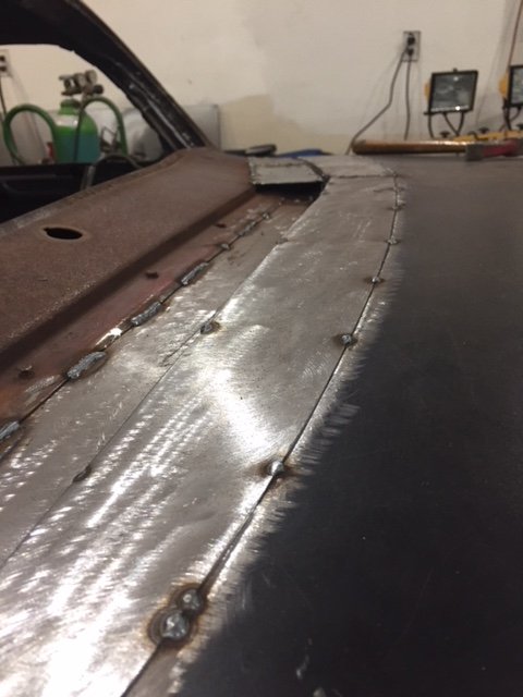

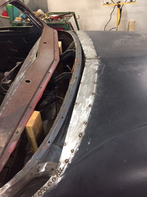

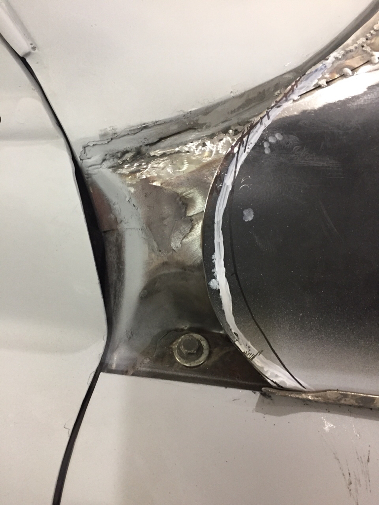

  11. Just a small update . Progress on hood extension . Every time you think something won’t take to long , bam it kicks your ass . I am figuring 40 hours of fabrication to fill the void created with the window graft .

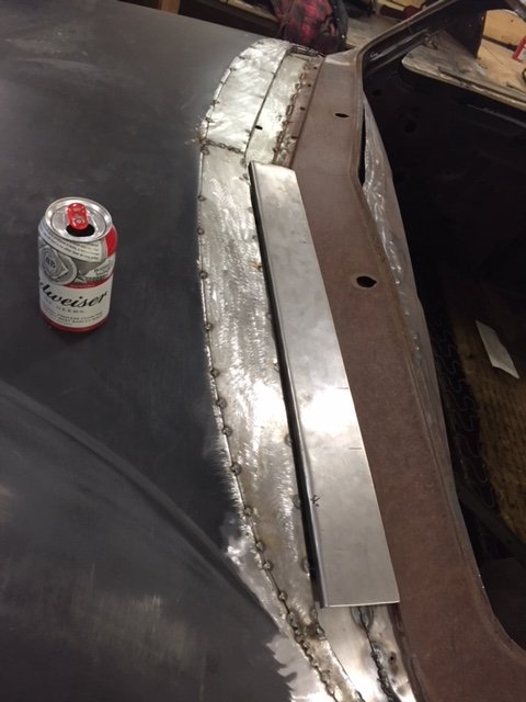

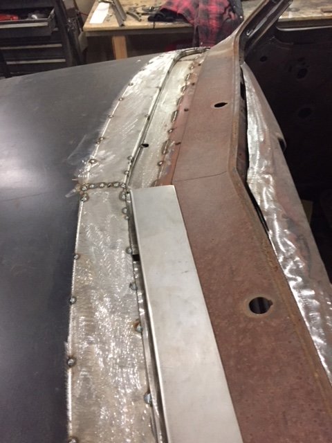

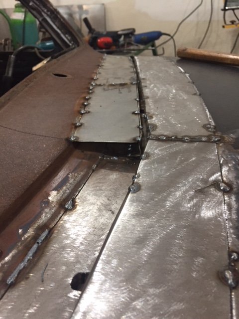

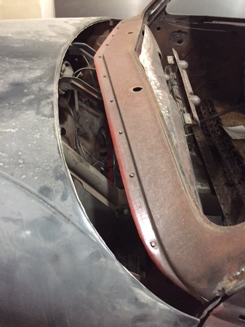

  13. Was able to get out in shop today . Mock up front clip again for the umpteenth time . Necessary to do in order to get things relatively close before filler application . Don't need 1/2 " of filler because I did not want to take my time during fabrication . Needed the mock up in order to get the dimensions of the filler piece needed between hood back and cowl extension .
  14. More progress on getting the cowl to hood closed in from today .

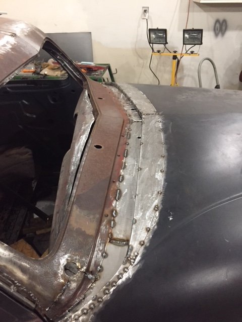

  19. [​IMG][​IMG][​IMG]

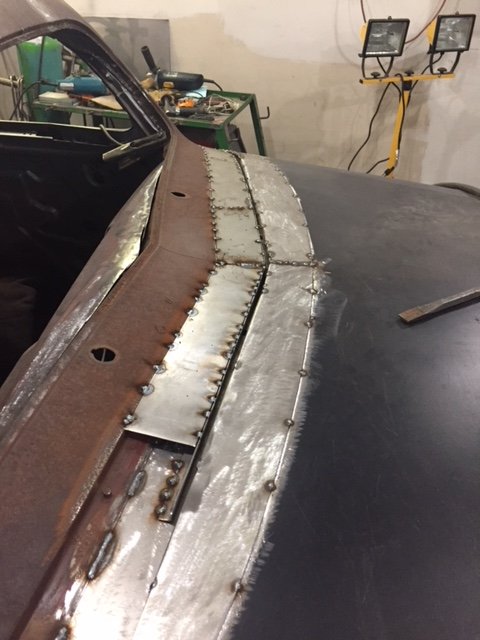

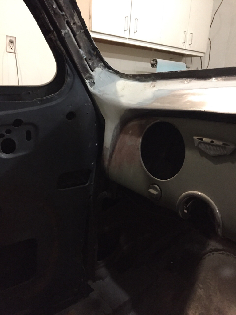

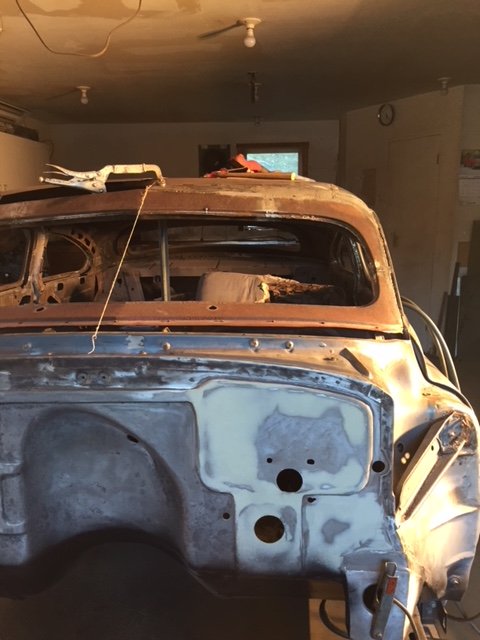

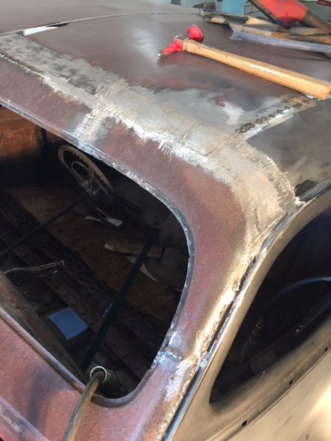

    After a month of welding , fabrication, filler work on the transition from Buick to Mercury opening I can safely say that it will be into a good coat of high build by the end of the weekend . Boring stuff I know but for the few that are sticking with me I just wanted to let you know progress is being made . Tie into the Buick dash at ends are 95% complete as well . Maybe some outside shots this weekend we'll see . Later , Andy...

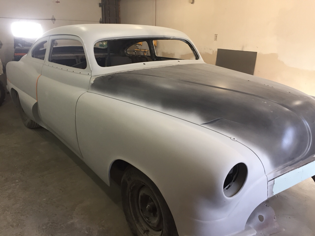

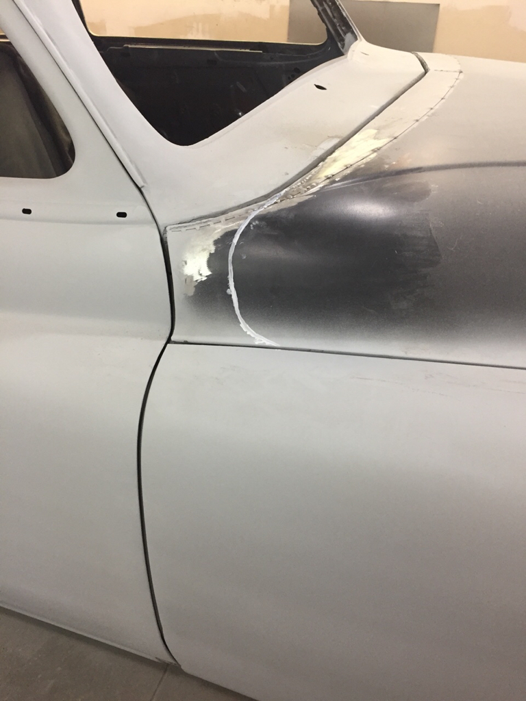

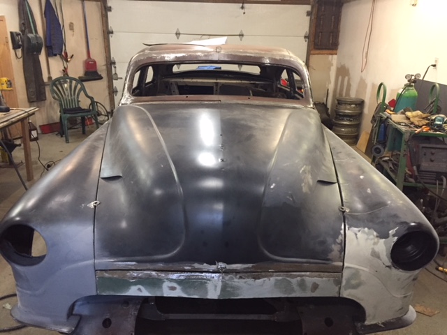

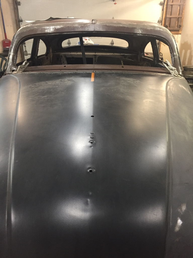

  21. Took a week off to get some serious work done on the Buick . Header panel in final filler . The last pic is what I am contemplating for the hood . Rounding it off . I will think on that one . Bows the time because the back of the hood is the last major piece of bodywork.

  24. Thanks Ricky bop. , Here's some trivia for ya . I know that you have been in contact with Steve ( Koolkemp) He's having a tough go of things at the moment . I see a 55 now in his yard . This car stuff is pure therapy for some of us . Anywho, My Buick now has a 49 Merc opening , I bought it from Steve. He sold it to me Aug, of 16 and I started to graft it in Aug, 17 . Whew a lot of work , on and off, 6 months to get it where I could say I was done . Steve and I are somewhat close to one another . He is in Nova Scotia and I in New Brunswick . Great guy , I wish him the best !
  25. Also with this I am going to have to make a new fender mounting pad . Not much of an issue though , just time . Other than the hood the car will be in complete primer by Sunday ! Maybe some outside shots to get the effect ,it all depends on the weather , right now where getting walloped with a spring nor easter .
