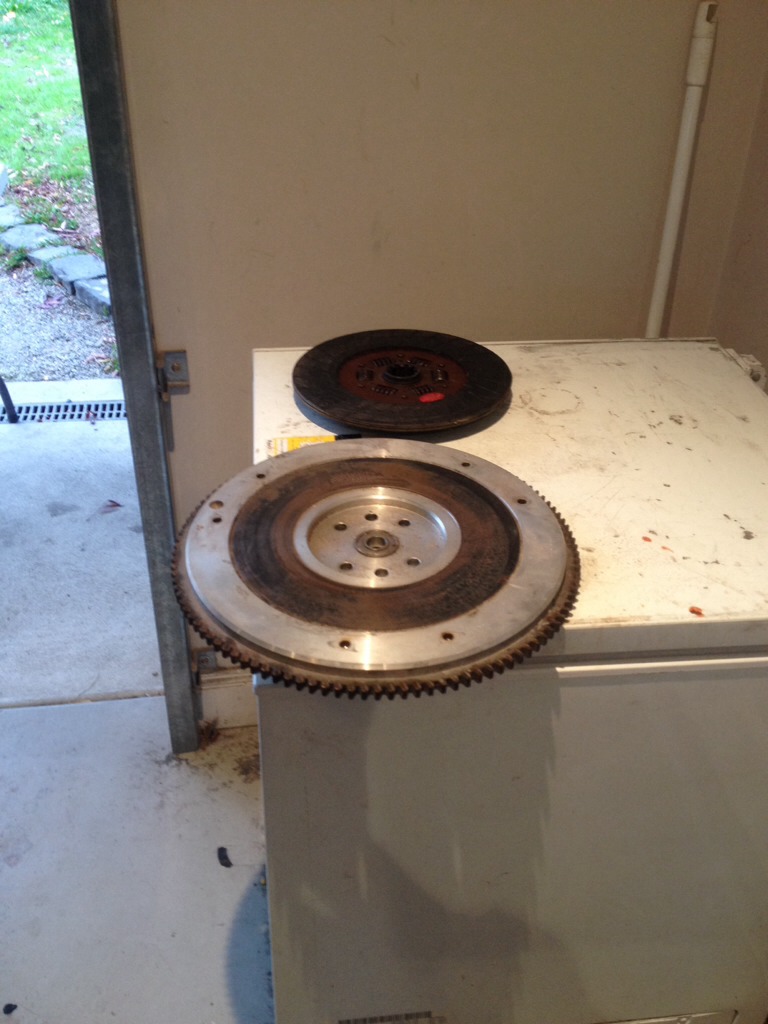

    Going through engine and a double check, refresh gaskets and fit up schiefer aluminum flywheel.
    Swapping heads from the edelbrock to navarro, not a straight swap as the edelbrock's are the hi roof to accommodate the hi lift cam.
    Off to machine shop for heads to have a fly cut and cc match up.
    ImageUploadedByH.A.M.B.1400308332.161895.jpg ImageUploadedByH.A.M.B.1400308347.165513.jpg
