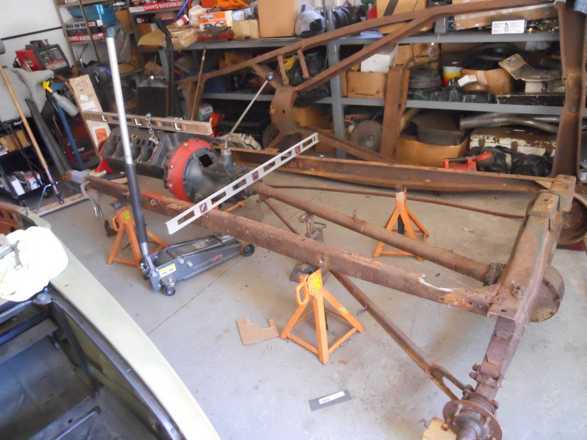

    A good friend gave me a stock model A rolling frame as a starting point..Had some cracks and messed up front crossmember that needed some straightening. Once I got in apart,I set it up on some stands and leveled it and squared it up with a porta power. parts33 004.JPG

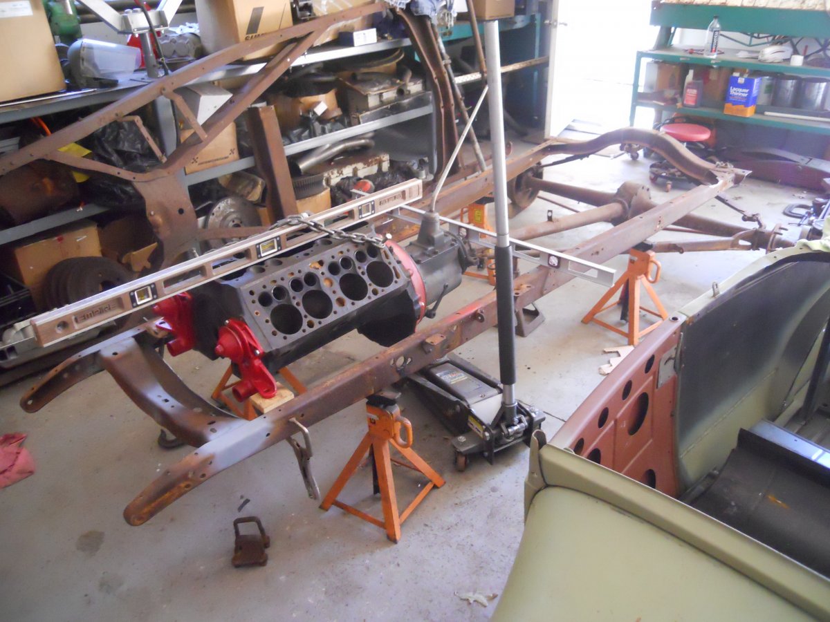

    Using a stock model a rear and working forward, I started mocking things up to figure out where the trans crossmember and engine mounts will need to go.. model a 001.JPG

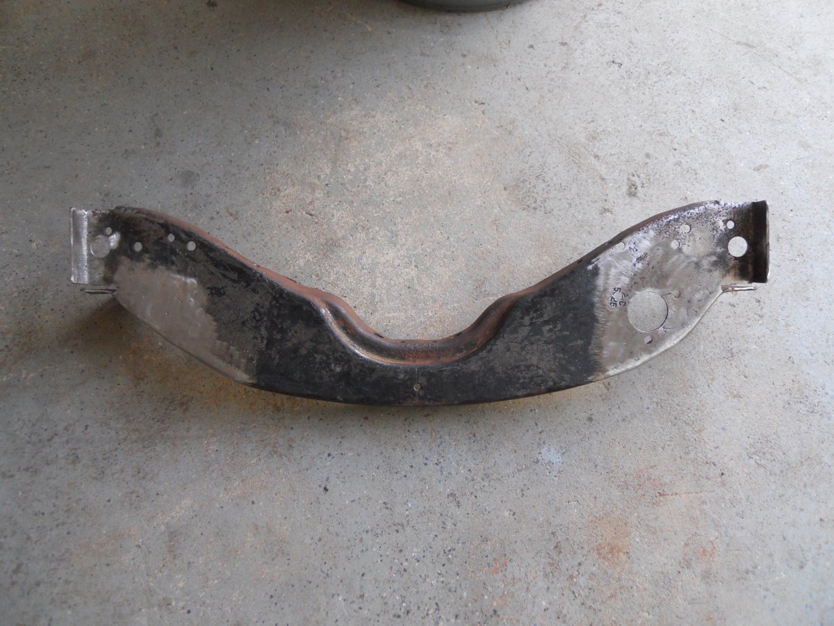

    I went to the junkyard and found an 1949 F-1 panel truck which gave up her trans crossmember and brake/clutch pedals..I cut it down to fit inside the Model A framerails with tabs to weld in place.The pedal holes will have to be relocated to fit in the correct spot.. model a 006.JPG More mocking up with a stock A steering column..Radiator in place to check for fan clearance. model a 004.JPG

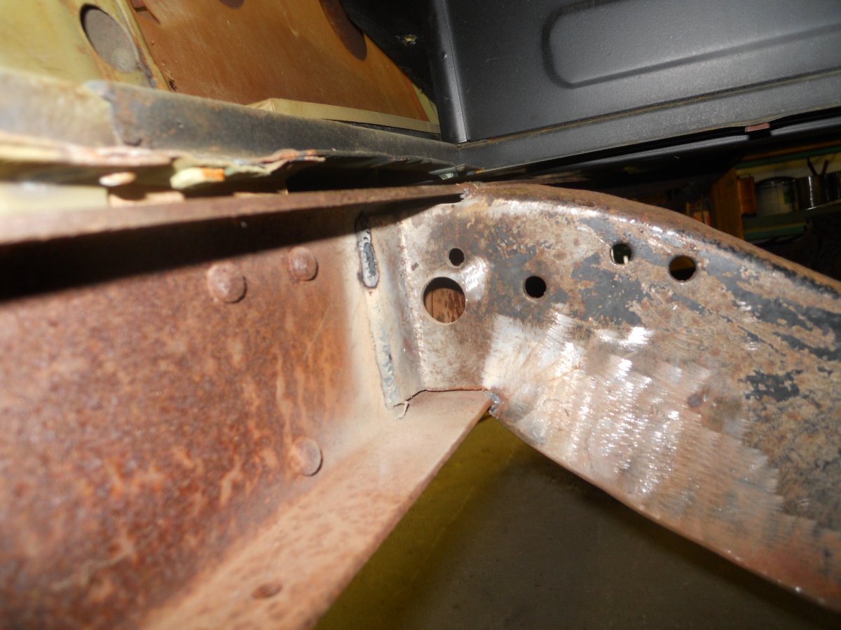

    Once I had all the engine spacing where I wanted it,I cooked up some quickie engine mounts tardel style.
    Some more detailed trans crossmember pics
    Then I cut down a 34 center crossmember for the front wishbone ball mount and mounted it to the tranny crossmember. I need to add some gussetts for strength but you get the idea.

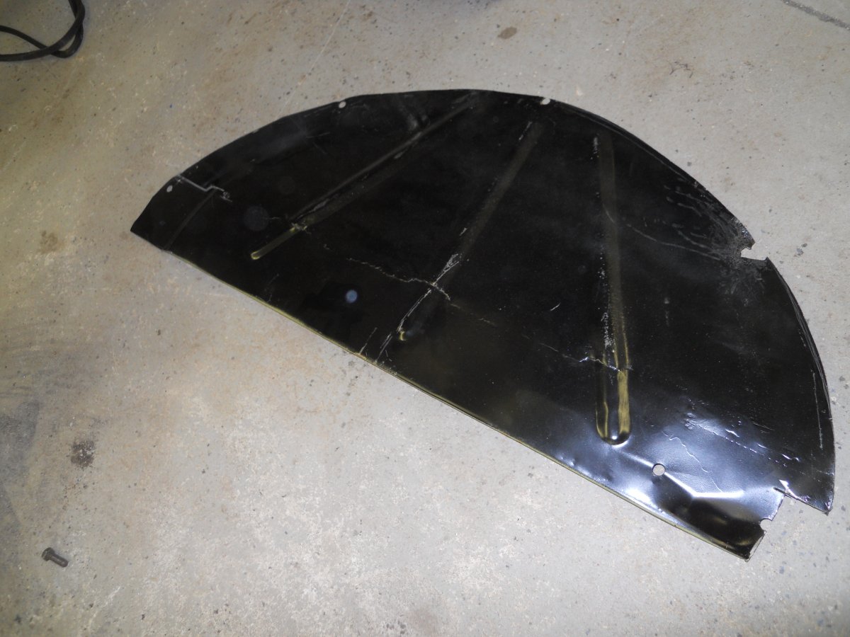

    Previous owner installed some terrible rear inner wheel well patches..I could have just laid some lead over this but decided to cut it out and install a new inner..All butt welded,no over laps..Much nicer..Had to make a new dogleg area..Ran out of gas before I could weld it in.. roadster 013.JPG roadster 014.JPG roadster 003.JPG roadster 016.JPG
