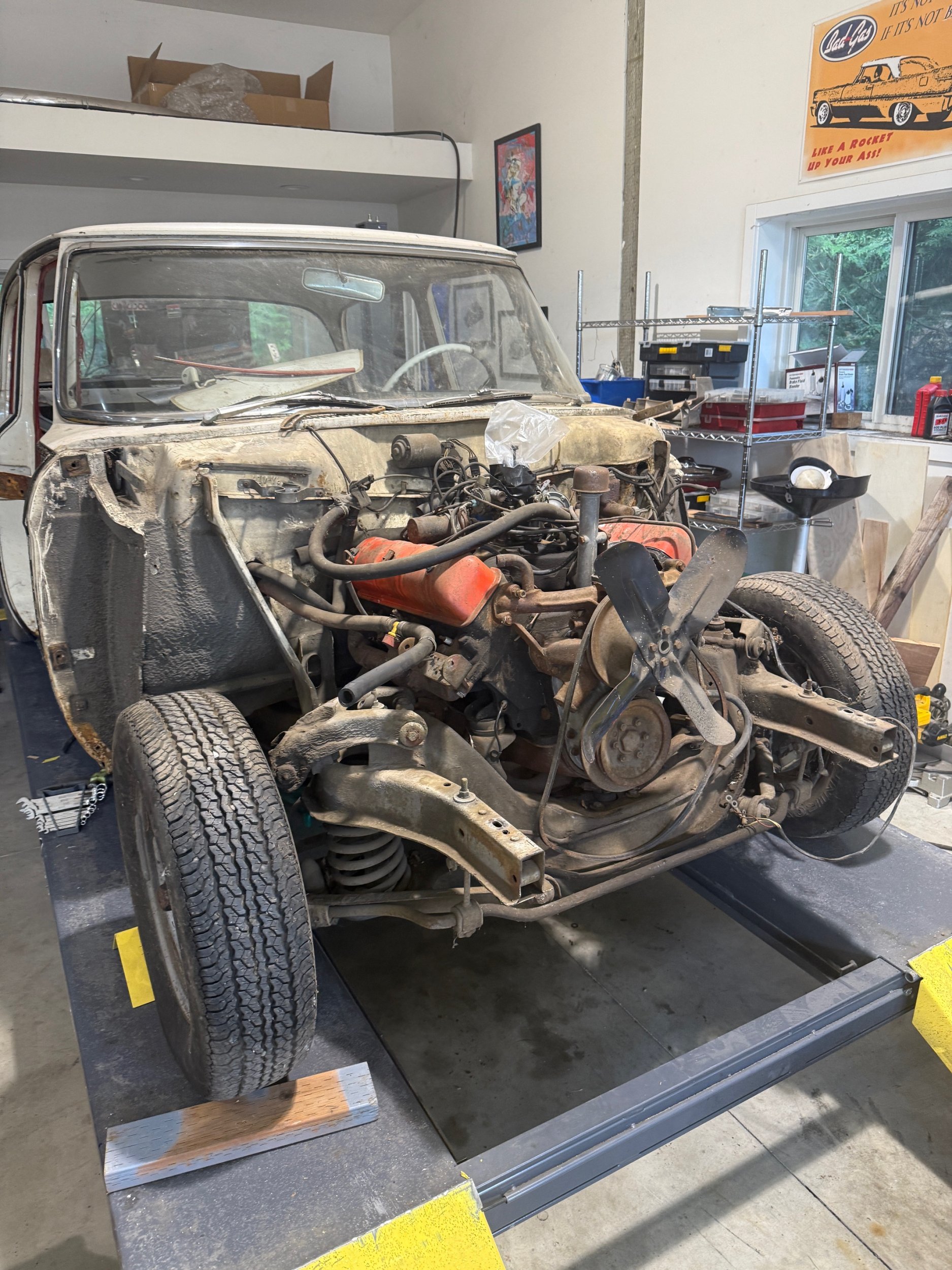

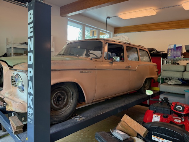

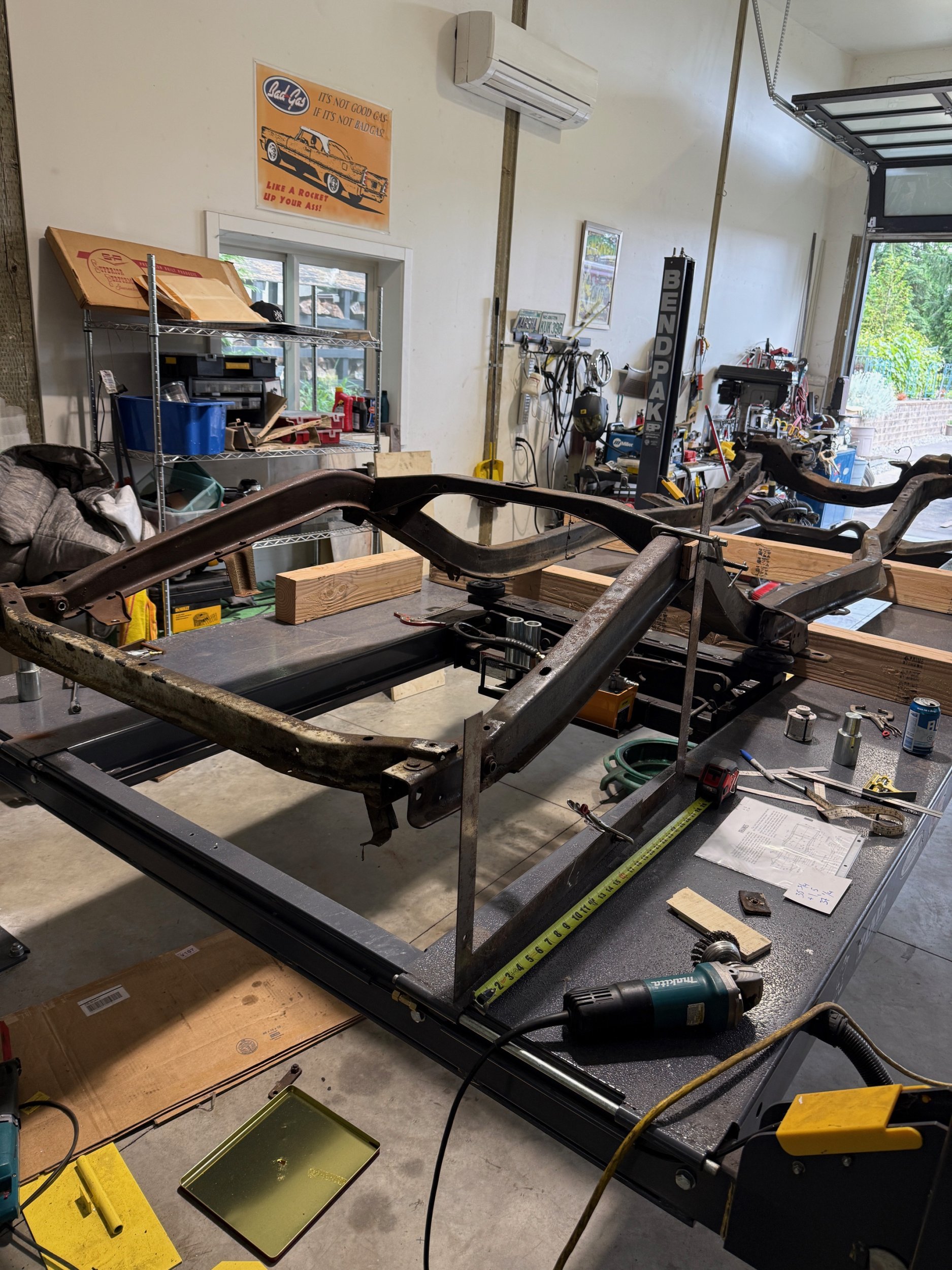

    Scored a 4dr -61 Lark parts car for my wagon project for $400 (sold the drivetrain for $200) which included new bumpers, OEM grill and a bunch of usable parts. Basically bought it for the frame which is 11g versus the wagon’s 14g.
    I have a -84 Corvette C4 front and rear suspension and will use the front for sure, have not decided on the C4 for the rear yet, might go the C10 trail-arm route.
    First decision is frame to ground clearance, I’m thinking 4-4.5”

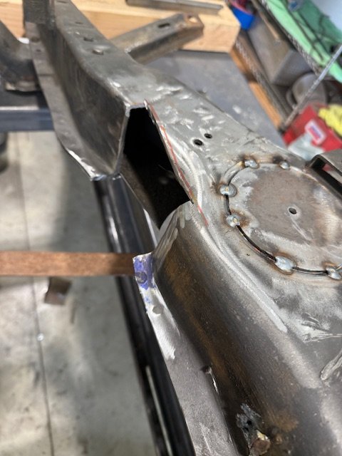

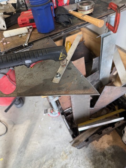

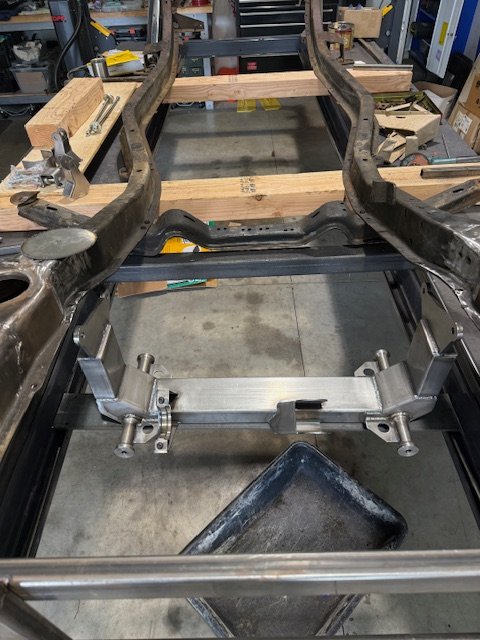

    Getting the Studebaker frame ready for the -84 Corvette C4 suspension. Rather than grafting the original Corvette sub frame to the “Stude” I will use one from Flatout Engineering.
    This is a total budget build that I hope to finish under 20k.

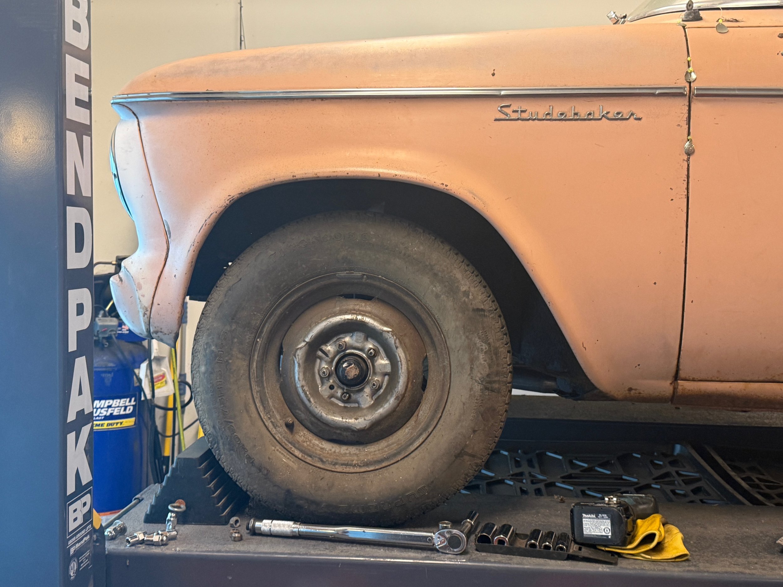

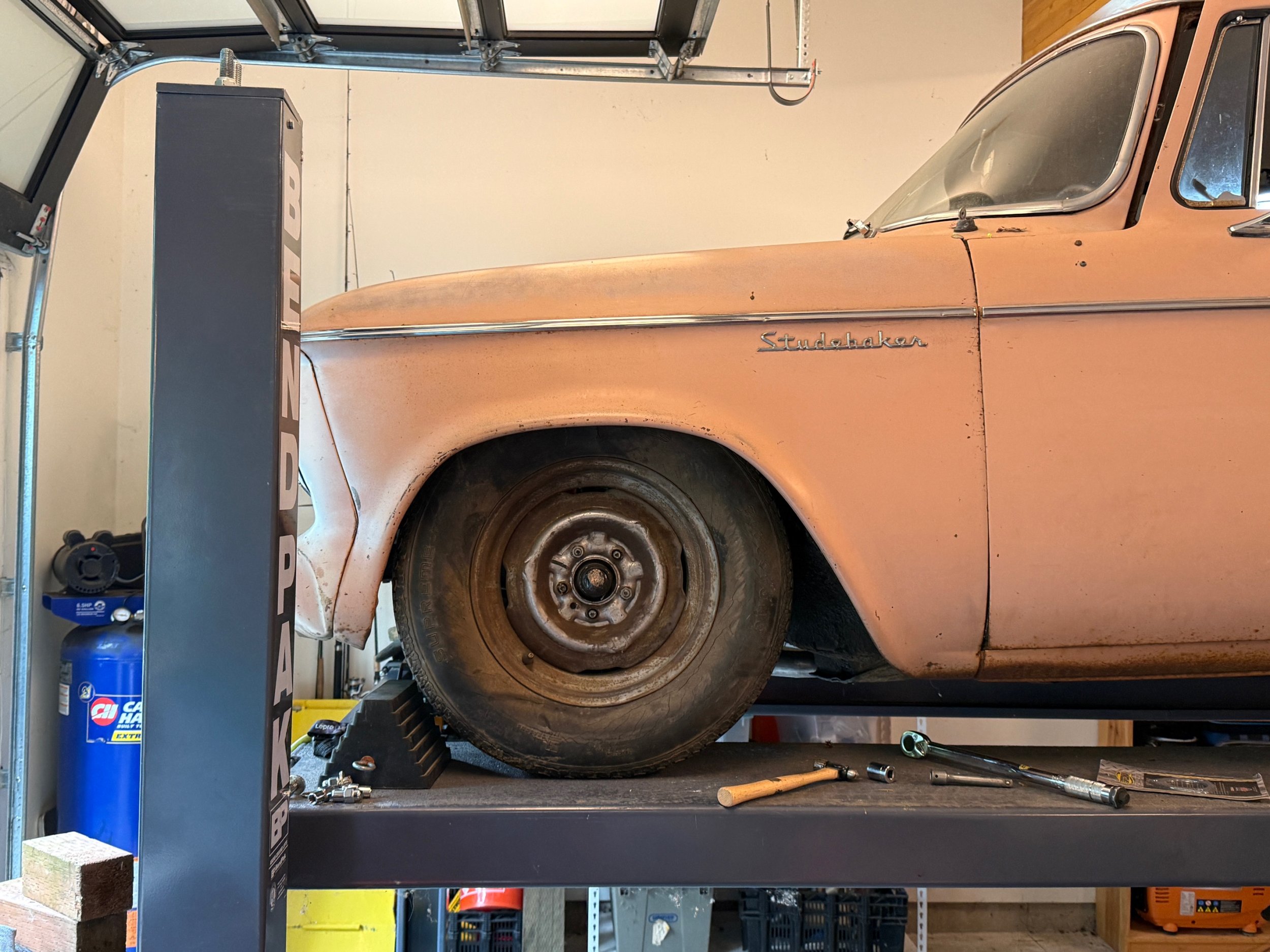

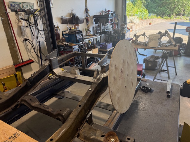

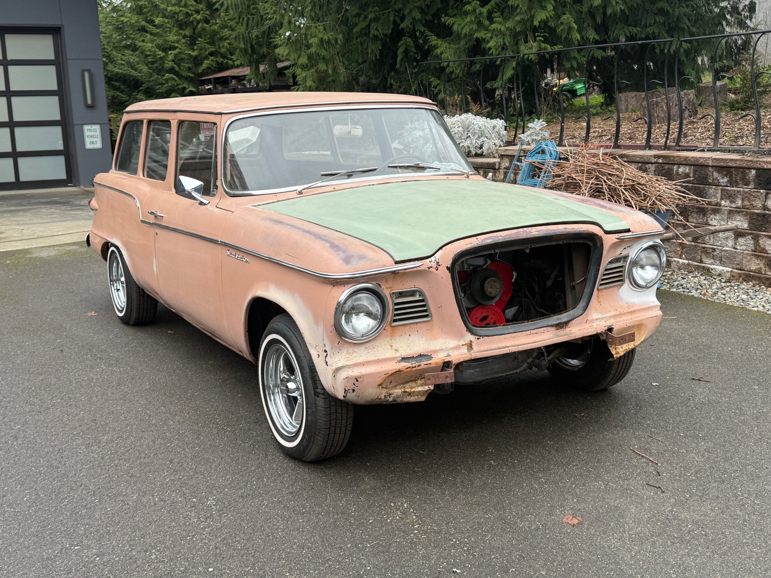

    I am mocking up the stance and preparing for the C4 Corvette suspension and I noticed that the front wheels are favoring the front of the car. I’m thinking about moving them back 1” since I am going to be cutting into it anyway. What are the drawbacks? Thoughts?
  6. The37Kid
    Joined: Apr 30, 2004
    Posts: 32,366
    The37Kid
    Now is the time to get wheels centered, fun project to follow.

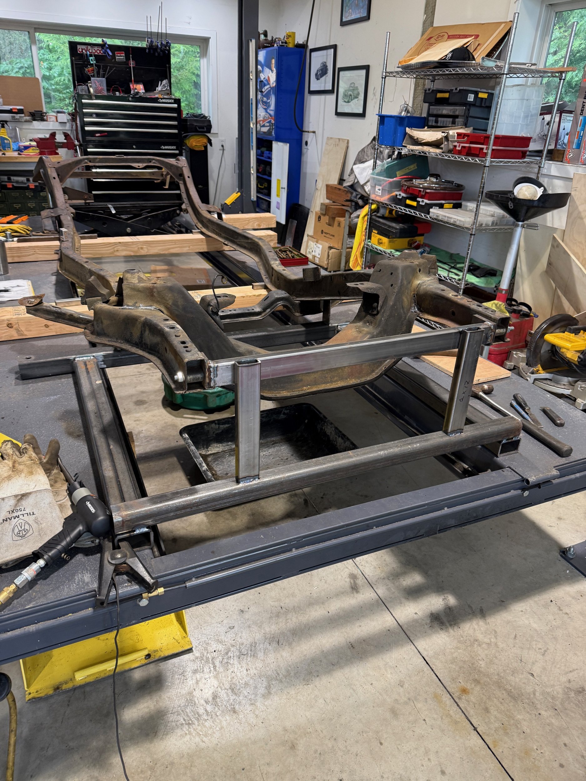

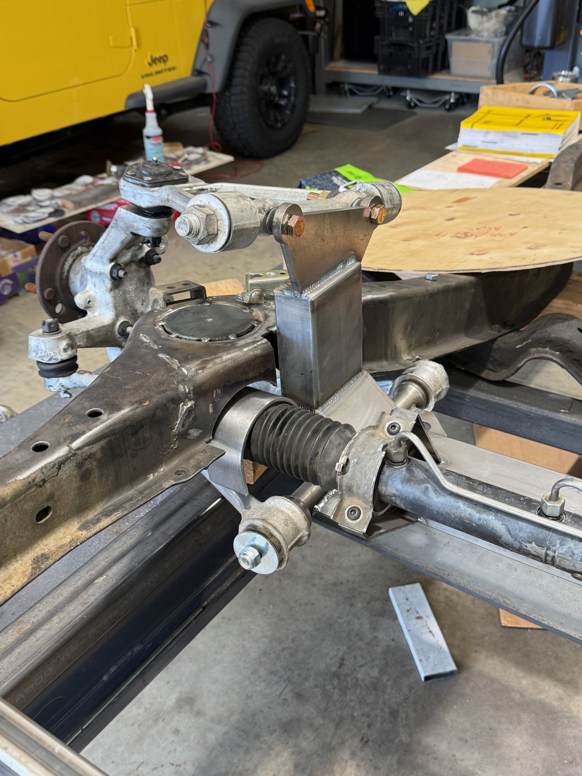

    Making slow progress on the -59 Wagon. Decided ride height and to move the front wheels back 1”.
    Got the C4 crossmember put in to the donor frame.
