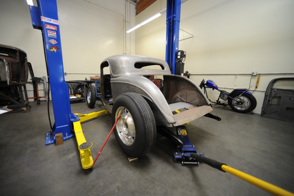

    a couple of pics of the wheels...
    kidcampbell71 likes this.

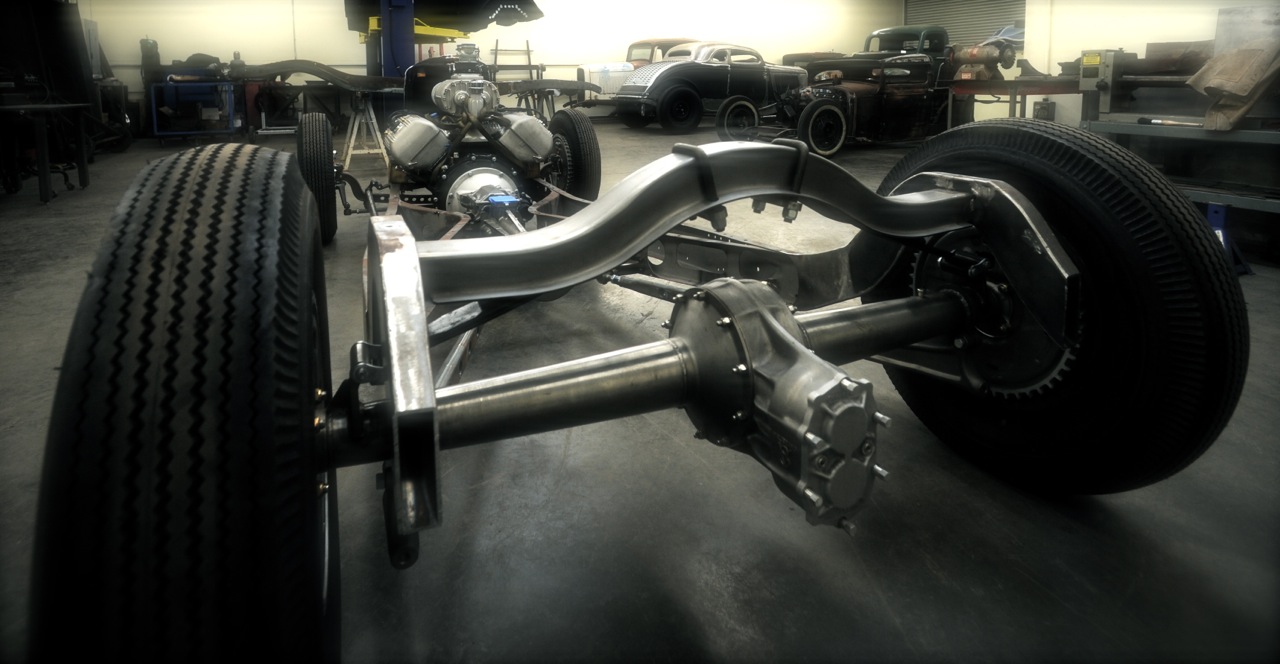

    better pic of the ardun flattie...

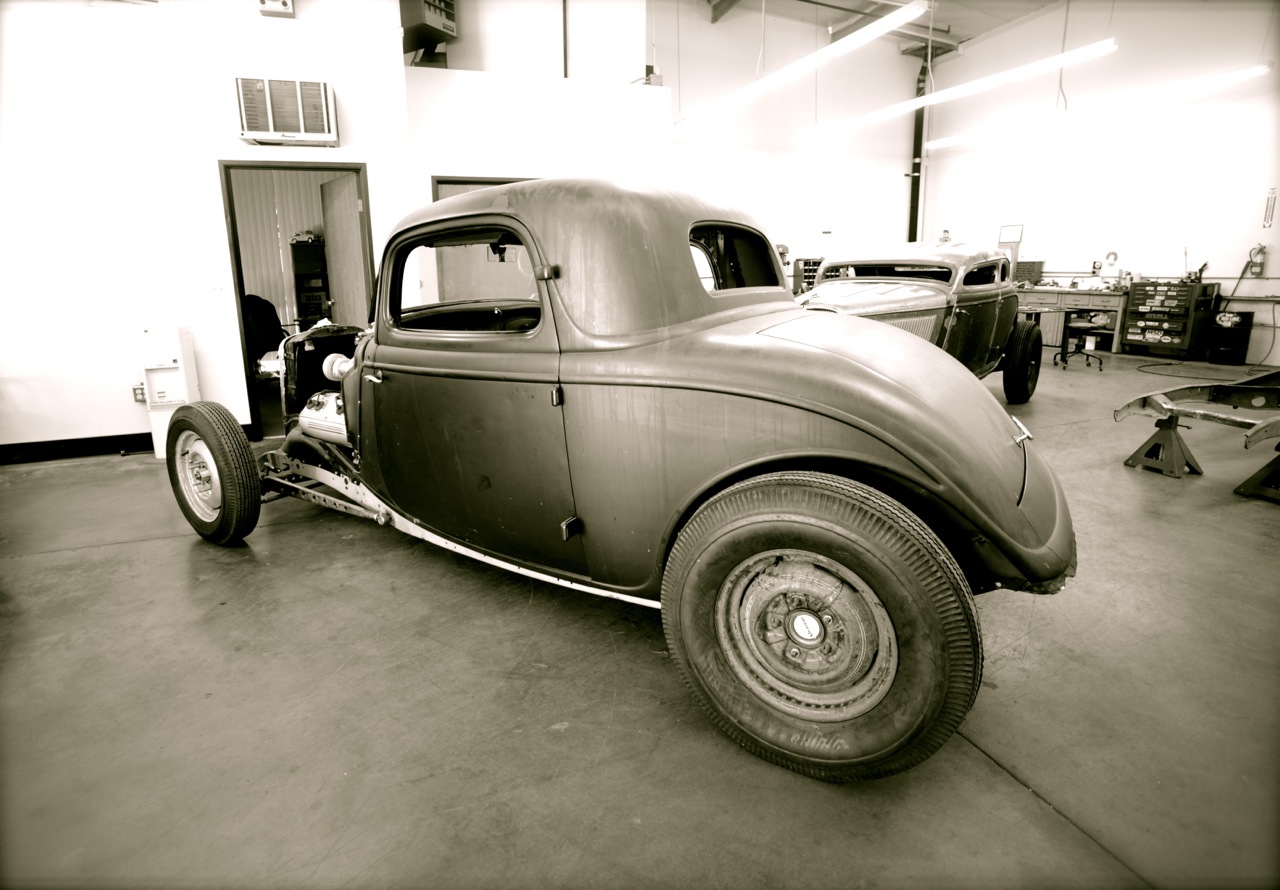

  3. 3wLarry
    Joined: Mar 11, 2005
    Posts: 12,804
    3wLarry
    from Owasso, Ok
    chassis shots...

  5. Gasserfreak
    Joined: Aug 31, 2004
    Posts: 1,341
    Gasserfreak
    from Yuma, AZ

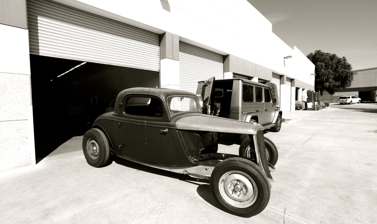

    That Cars Awsome. I thought it was channeled at first it's so low, but it's not, which makes it even cooler. I dig the front crossmember too. No gigantic "Z" just a well thought out car.

  7. big duece
    Joined: Jul 28, 2008
    Posts: 6,830
    big duece
    from kansas
    I like that white and red primer 32 body being shy in the background!

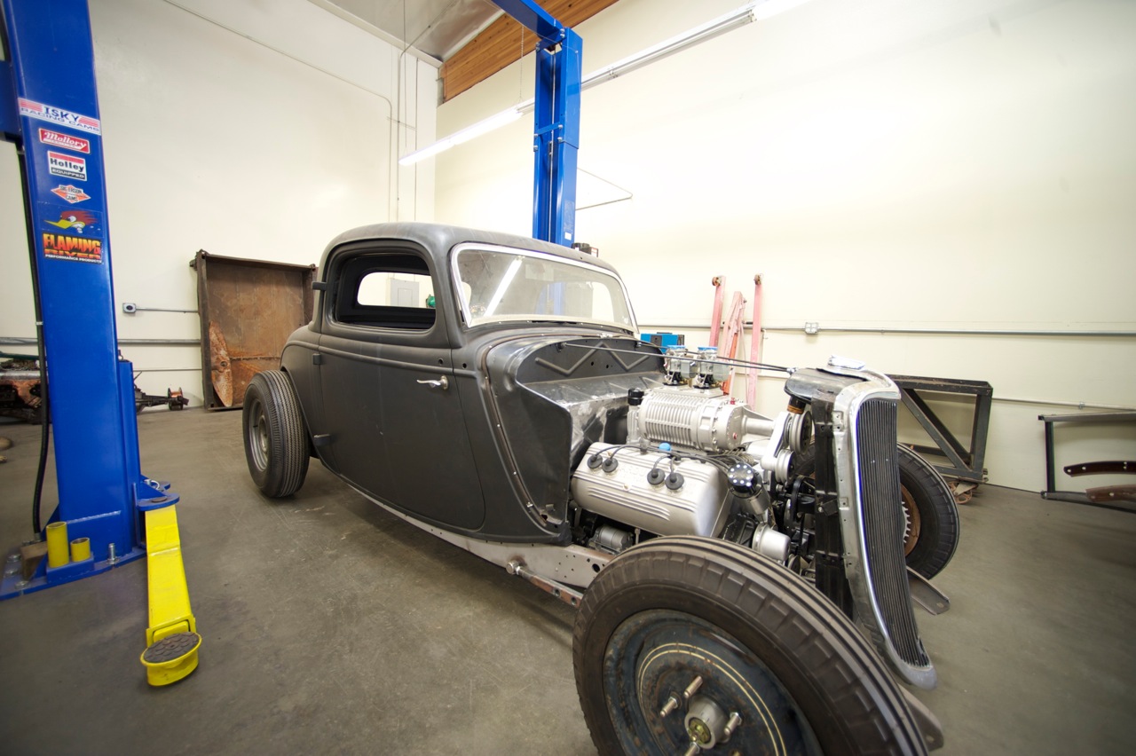

    better shots of the ardun...

  11. TexasSpeed
    Joined: Nov 2, 2009
    Posts: 4,631
    TexasSpeed
    from Texas
    I really dig this picture.
    I don't see anything I would change on your car aside from finishing it.

  15. SCOTT GILLEN
    Joined: Dec 1, 2010
    Posts: 408
    SCOTT GILLEN
    Never chop the Magic of a true Hot Rod......thats why it's so cool.

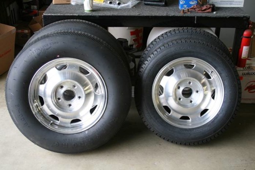

    These wheels were cut for the car but I have changed my mind. They are for sale....18" front and rear, they are very nice indeed.
    Scott

  22. SCOTT GILLEN
    Joined: Dec 1, 2010
    Posts: 408
    SCOTT GILLEN
    The engine was Built by Don Ferguson, also the blower......The Ardun is such a nasty looking beast, it take's the car to a whole new level.

  24. SCOTT GILLEN
    Joined: Dec 1, 2010
    Posts: 408
    SCOTT GILLEN
    The rear end is a small V8 Halibrand made by Richard and it's a locker small rear end. We cut the inside of the housing to make room for the locker. I had the tube's spun like original and made new bell's for the sides based on the original bell's back in the day.
    Looks pretty good and took a long time to get it made right, it was worth the wait. All the rest small V8 halibrand's out there are one leg'ers

    Now this car is about as cool as it gets and I hate to do this but I am glad you're not putting these wheels on the car. They look like new suburban or silverado wheels.....probably just need some paint.

    I wasn't going to say anything about the milk truck wheels but I'm glad you decided to run with the steel wheels. Those look great on there.
