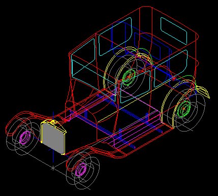

    I have my complete Tudor Sedan, and Coupe drawn out in masterCam.
    I don't believe they made a '26-27 Sedan Delivery.
    Pat

    wow cool i have to go to work but ill get back to you tonight on dimensions as far as sedan delivery i just need 26-27 tudor dimensions cowl length is the main thing but i need to confirm most everything

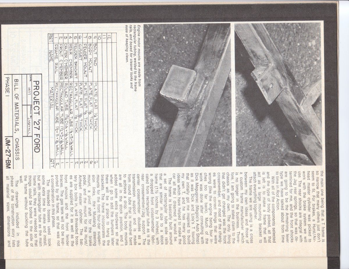

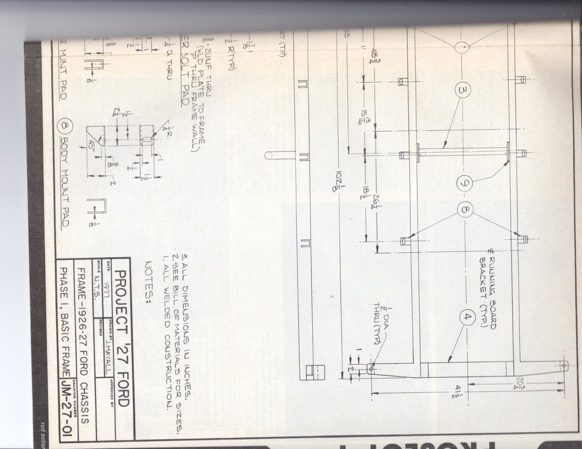

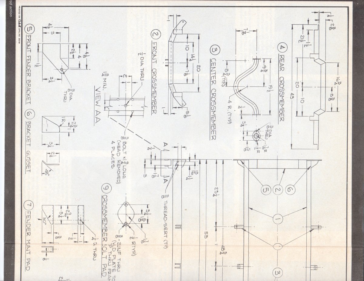

    I found John Buttera T models on ebay for around $40. Here 's the dimensions for a T frame from RodAction, January 1978. Mayall was building a touring, but the frame is the same. Scan-171130-0005.jpg Scan-171130-0006.jpg Scan-171130-0005.jpg Scan-171130-0005.jpg Scan-171130-0006.jpg Scan-171130-0006.jpg Scan-171130-0009.jpg Scan-171130-0010.jpg

    thanks gold mountain defintely helpfull i have tbucket plans but they are different enough to be an issue

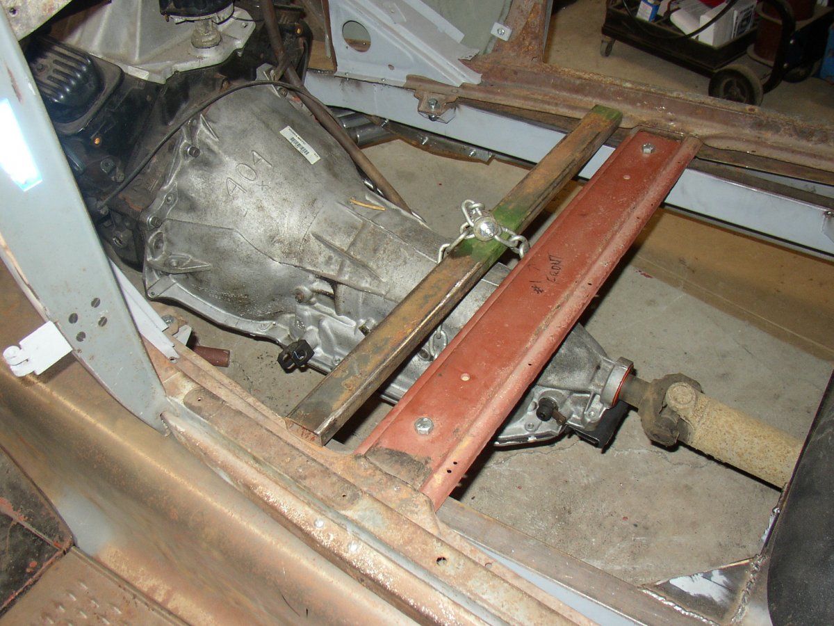

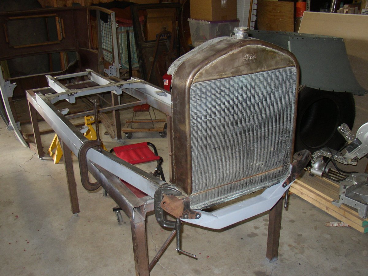

  22. James,
    Check out the corrugated cardboard tires, wood frame, jackstands, engine sitting on a dolly, and the headlight bar is propped up with bricks & vicegrips.o_O
    Hope this helps.:)
