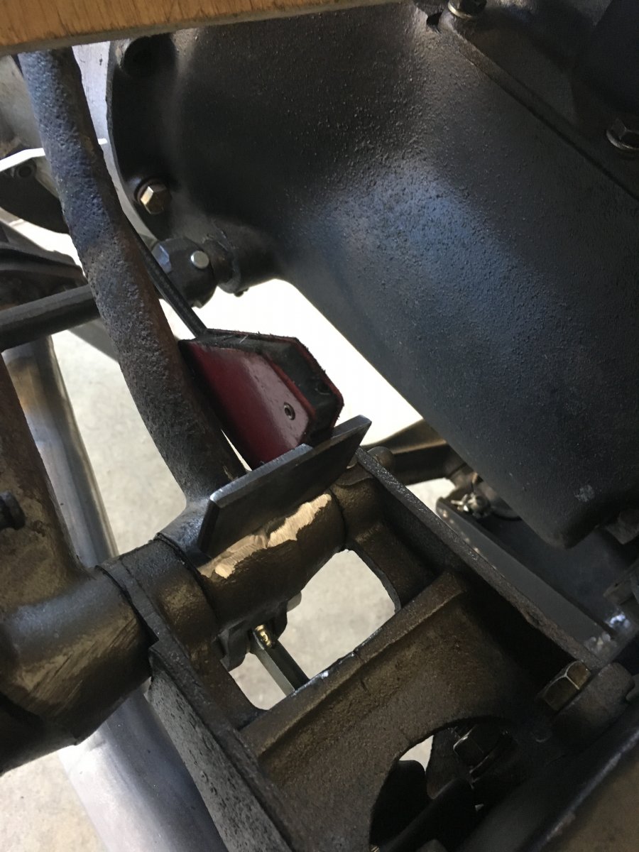

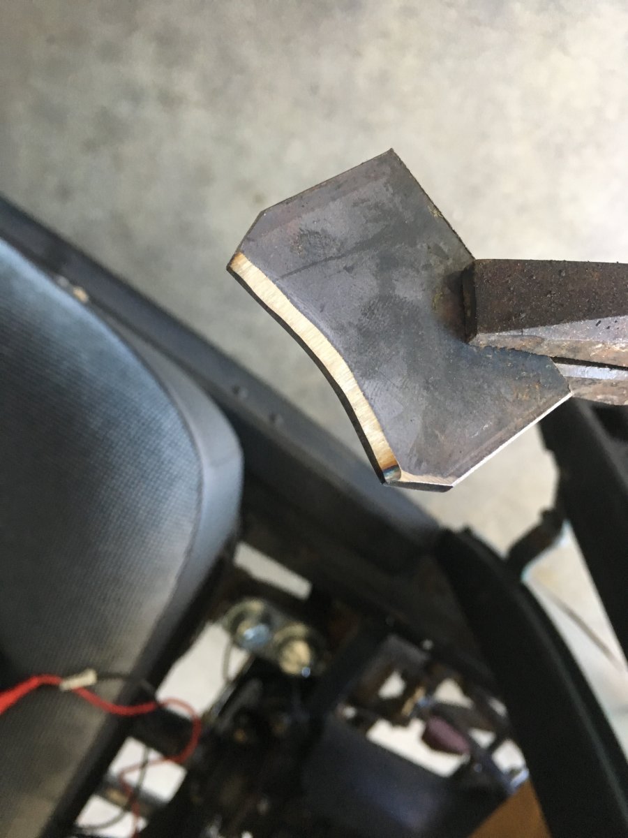

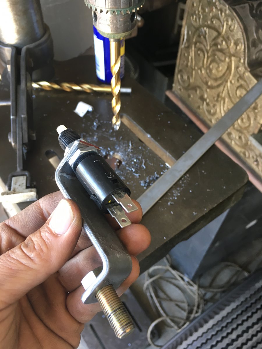

    I made a bracket for a brake light switch I picked up from the local parts store. I’ll weld in a makeshift dog-plate to press against the switch.
    AE6D8FF7-98E8-427F-8F74-5CDE94147604.jpeg 667C5A8B-FFA4-460E-ABC5-3E7C505D856E.jpeg AEA442A2-828C-4A1C-9B5B-84D3C2F5A5C9.jpeg C8DFB92A-3CD8-484D-B5F5-C9E90BFF6948.jpeg

    Nice job on the brake switch. Those little pressure switches dont work worth a damn sometimes
    deluxester likes this.

    Good point. I located a waterproof one on line. I’ll likely replace it
    brEad likes this.
