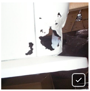

    While the car was in the shop I got a few missing/needed parts:
    Stock wheel to use for a spare
    A new hood since mine is smashed and splitting apart
    The hard to find front hood stainless trim
    Re chromed rear door handles (Too cheap to pass up)
    I got the lost/Missing door stainless from a junk yard in the bay area
    Got a stock cig lighter for the dash off ebay (Now the dash is complete)
    Got the inner door parts that got smashed in the accident (Arm rest, Window crank and door handle)
    Got a good deal on some parts over the weekend. Skirts, 2 Dinged up hubcaps and 2 New in the Bag emblems all for $100. The emblems alone are 100 each on ebay.

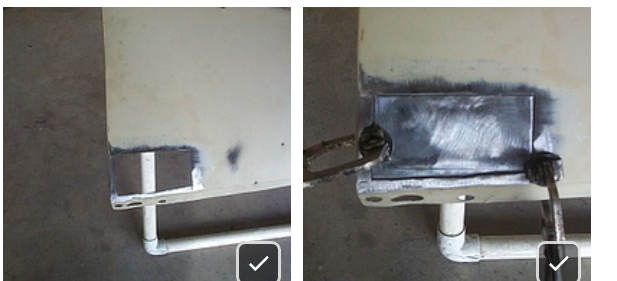

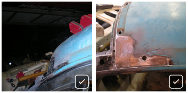

    So as mentioned in my accident thread the body shop that did the work did a very bad job. The front edge/corner of the fender they rebuilt is wavy and off by almost a half inch. The corner of my old smashed fender was good. I saw that this was spot welded on so this weekend I melted out the lead and drilled the spot welds on the smashed fender and pulled off the front edge. The plan is to drill the spots on the new fender and put this on fixing their crappy work.
    How bad the work is... Stainless strip has a gap behind it that will not work.
    Piece I took off the old fender:

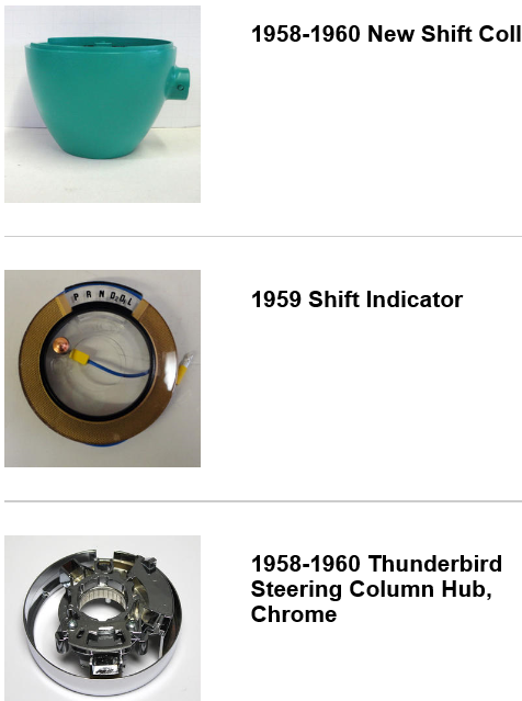

    Looking for some help on 2 items I need to get fixed so the car is safer to drive:
    1) I need to rebuild my manual steering box. I have a 2 tooth steering gear (Whatever that means). I have found replacement sector shaft and worm gear but am not really finding a rebuild kit. Anyone have any ideas on where I could find a rebuild kit for a mercury steering box? Google is not being my friend. The gears are just one part. I am sure there are bearings and seals and all that. Is there any other vehicles that run that same steering box? T-bird, Ford car?
    2) I need to rebuild my shifter column. I have found a rebuild kit for a 58-61 T bird which from this site I learned is the same(Thank you all). I worry that this kit may be missing something... Anything else you all think I may need?
    It comes with:
    1958-1960 Steering Column Rebuild Kit
    This it includes: upper shaft bushing, shift collar, detent plate, shift indicator, shift collar pin, lower shift tube seal, lower shift arm, lower firewall seal, shift indicator and one can of vinyl dye. (Please indicate the year of your car and the color of your interior.)
  20. Rocket Scientist Chris
    Posts: 602
    Your 2 tooth box is the same as those used in ‘55 and early ‘56 Thunderbirds. The ‘55 - ‘57 Thunderbird catalogs are a great reference for parts you will need to rebuild your box. I did my ‘55 Mercury steering box not long ago. I even upgraded to a 3 tooth (little more robust)!
    But, I would not recommend doing a rebuild unless you have all of the tools and knowledge needed. It took me two sets of needle bearings to figure out how to get them installed without binding up the needles! Removing the lower taper bearing race for the steering worm shaft was another nightmare! Loads of other problems, too! Though it looks good and operates smoothly, now. I don’t want to do it again! :)
    If you don’t need bearings replaced in your box, go for it! Otherwise, pay for a rebuild. The price is worth your sanity! :)
