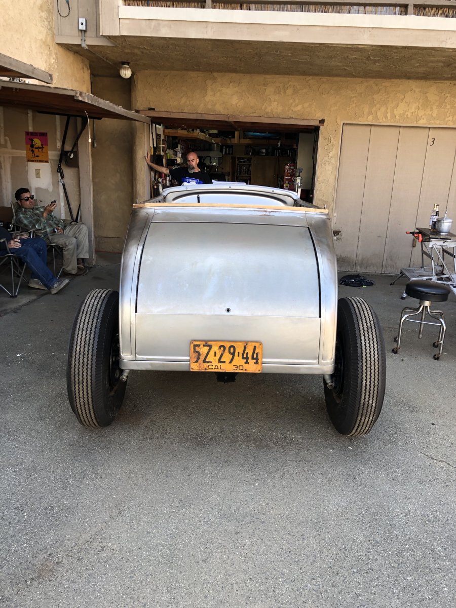

  1. Well, I dropped the body on this weekend and can see the finish line ahead! Thanks to the IMG_1765.jpeg IXLMsEiKR8mctGOPZouaLw.jpg WDY5AK5BSZ2yTltS2UkoPQ.jpg help from guys here. Greg

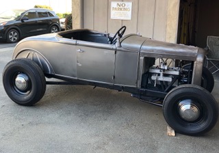

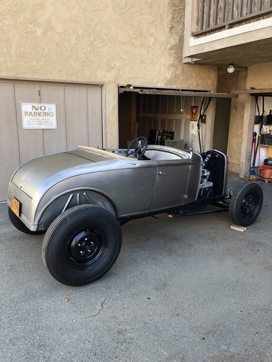

  3. Hmm, I don't see anything that looks stupid, so I'm in to see what you do. Digging' it, so far.
  4. Ha ha, thanks Phil. That is the best comment I could have hoped for! My dad will love that.

    Work like that used to be call 'sano'.a compliment on the cleanliness of the build is in order here.Sensible engine upgrades too,my only issue is with raw speed,you missed a few horsepower by not power by not polishing the cylinder head..

    I like it! What size rubber are you running?
  9. Thanks Guys! I am running 7.50 on rear with mercury wheels and 5.50 front on ford wheels. Ha Ha Rail, I sort of pondered polishing stuff, but decided to just get a running car together first. Hopefully, I get my vintage Mallory distributor back from Bubba in the next couple of weeks and finish off the engine. Hope to be rolling by June.

    Simplicity at its finest...The look of the yesteryear is shaping up nicely...I'm sure its bringing a smile to your face along with a heck of a lot of anticipation...great job @Nosetime

    Nice car! What you running for a carb? 97, 81, ?

    Great looking car. Who built your engine? I'm not a banger person but am thinking of doing one. What is the best motor? It'll be in a deuce.
  16. Hey guys, thanks for the props. Running a Stromberg 97 from a vintage sprint car.. alcohol converted carb. I used the really cool originall SP top and modified base sans choke. It is finicky to start in the cold! I massaged this engine together from scratch to get a running car. Hand fitted swap meet rear main, swap meet H&H G7 cam, Reds Header, old Super Winfield and Ansen intake. Lightened flywheel, V8 clutch. I have yet to install my Mallory YA-11 Bubba did for me. She runs like a bat out of hell....for how long, we shall see.? I am going to baby this until I finish the rest of the car. Greg
