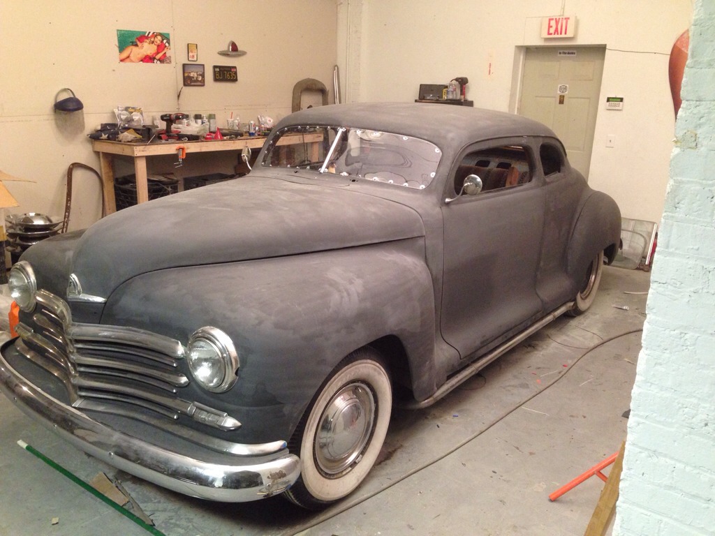

    Little mini update. Got the door tops put on. Interior back in. Rattle can primer job just to keep from rusting. I still got some little lumpy areas I need to block out and that shitty windshield is just temporary so I can drive this weekend. Didn't have time to get glass cut and order a gasket. Started it up for the first time since October and she's runnin great ImageUploadedByH.A.M.B.1391238540.176204.jpg ImageUploadedByH.A.M.B.1391238557.306165.jpg ImageUploadedByH.A.M.B.1391238572.793633.jpg

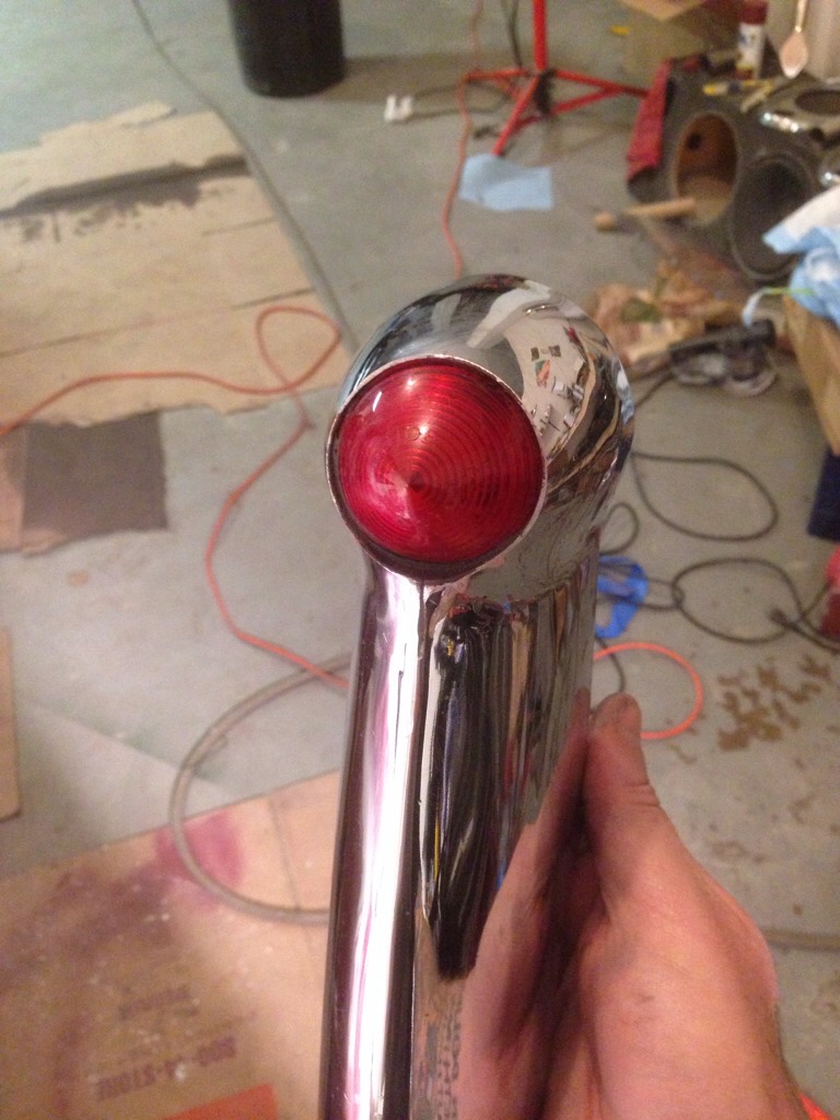

    I also started on the bumper guard tail lights. I think these are 49 or 50 chevy guards I got off fleabay. Impala lenses cut down so they fit in where the cone of the guard was.

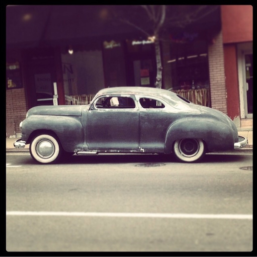

    I did steal this little picture from the cruise. No windows in 10 degree weather. No wonder I got sick haha ImageUploadedByH.A.M.B.1392265327.140468.jpg

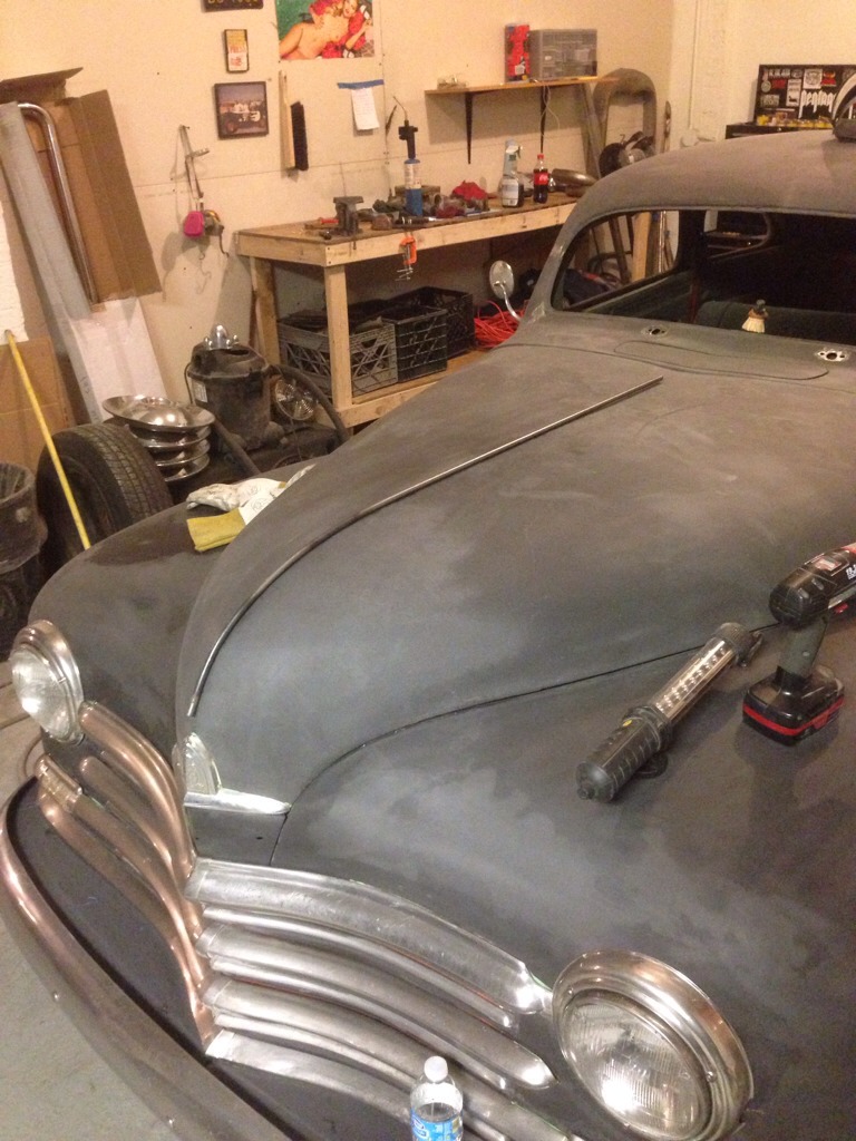

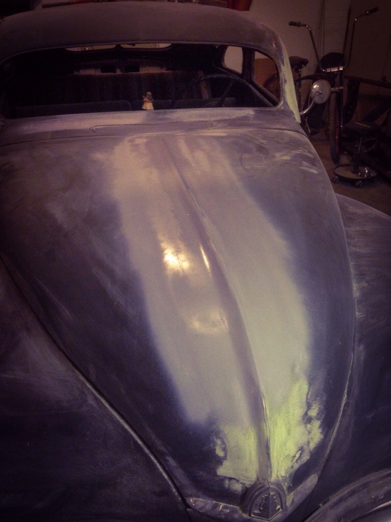

    Finally got my lazy ass back in the garage. Taking a little break and figured I'd post a quick little update. I've been kind of on the fence about peaking the hood, but I was looking at the car earlier and decided I'd go for it. Here's what I've done so far. ImageUploadedByH.A.M.B.1393295277.992038.jpg ImageUploadedByH.A.M.B.1393295315.506690.jpg ImageUploadedByH.A.M.B.1393295326.904230.jpg

    ImageUploadedByH.A.M.B.1394178467.802589.jpg ImageUploadedByH.A.M.B.1394178476.466433.jpg
    Got the hood peak pretty much done. And cut off my rusty old drip rails and made new ones out of 3/8" round bar. I don't have a tube bender so I just did it with my bench vise and the good ol' acetylene torch. I brought them all the way down to that belt line and am working on making them fade into that bodyline that goes around the back. I think it looks pretty cool. I was going to shave them completely but it looked so silly without them.
    It's probably hard to see in the one picture but I also filled the holes where the wipers used to be.

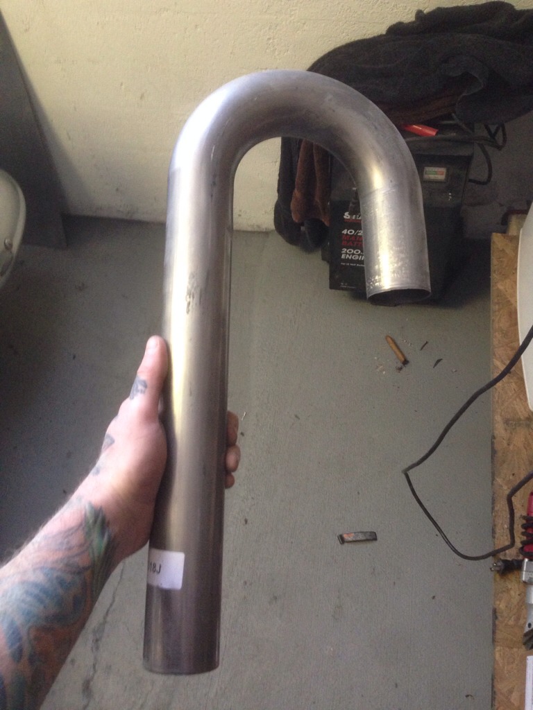

    Finally getting some good weather out here. Been driving the Plymouth the past couple days. Nice to see the ol girl on the road again!! I also started doing my lake pipe pods and took a bunch of pictures of the process.
    ImageUploadedByH.A.M.B.1397246906.384912.jpg ImageUploadedByH.A.M.B.1397246913.926625.jpg
  17. uglysteve
    Joined: Feb 15, 2011
    Posts: 312
    uglysteve
    from Elgin, IL

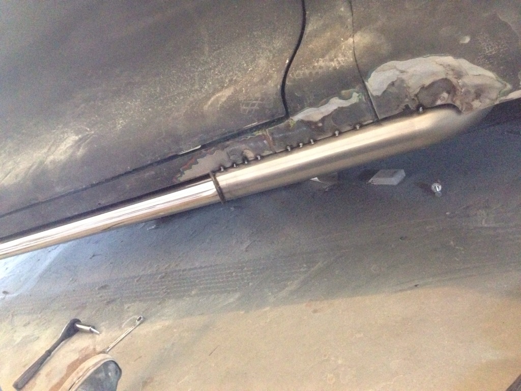

    So I started with some mild steel J pipe. Not stainless since I don't have a tig welder. 2 1/2" diameter since my actual lakes pipes are 2" diameter. Got these off eBay.
    I cut half of the J curve off the pipe and used a little angle finder tool to do a 45ish degree angle. I just kind of went with what I thought looked good.

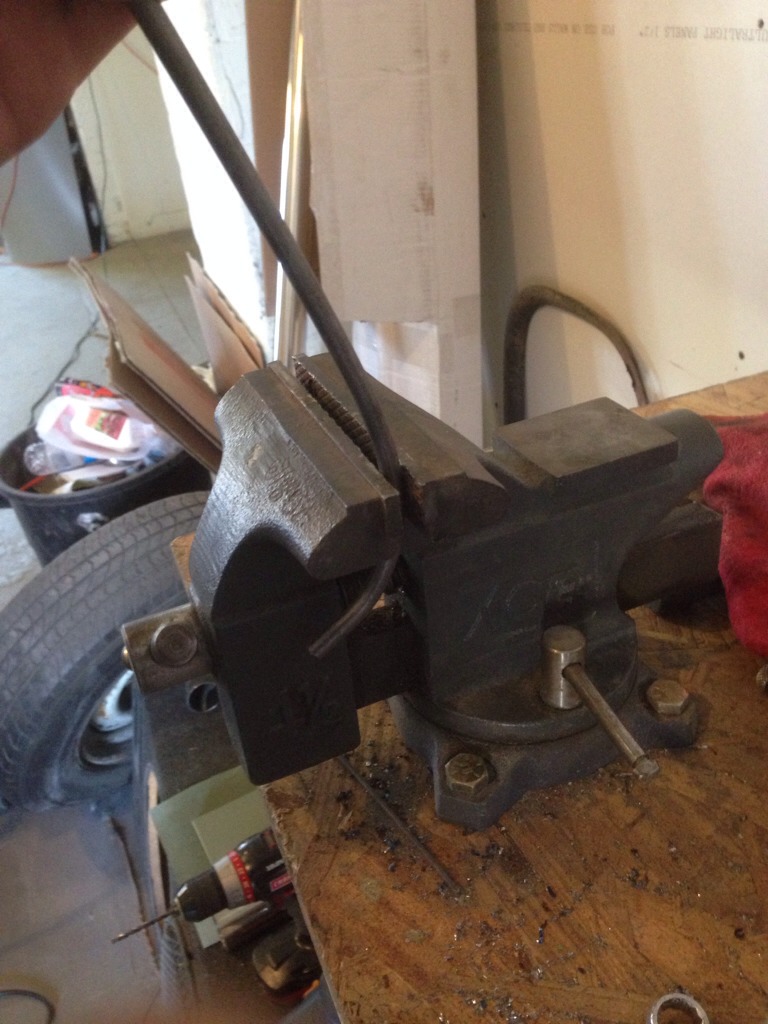

    Then, since I don't have a tube bender, I carefully started bending some 1/4" round stock with my trusty vice. Checking the shape against the pipe as I went. It's hard not to kink the round stock doing it this way but it works if you're careful! This is how I bent the stuff for my hood peak and drip rails too.
    Checking the shape. I figured it didn't need to go all the way around since you won't see the back anyways. And the pipe would stick out away from the body that 1/4" and look weird.

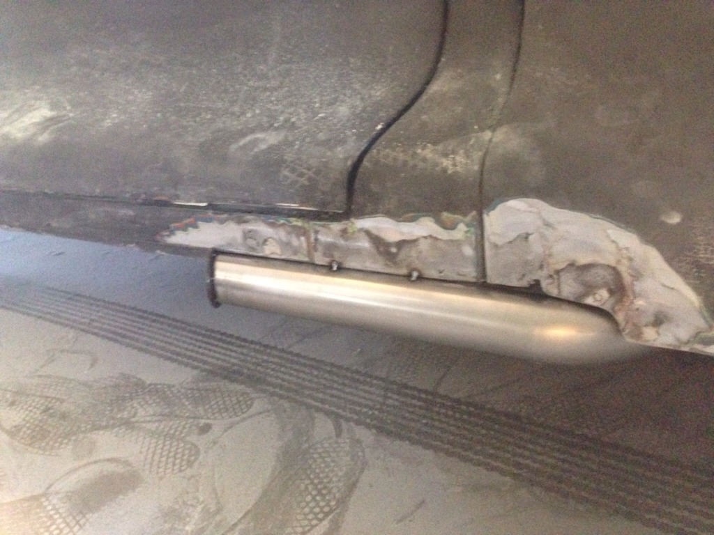

    Once I was happy with the shape I welded those suckers on and cut off the excess with a cut off wheel.
    Tacked in place. I cut a little notch out of my fender and will use some sheet metal and bondo to smooth everything out.
    Little mock up to see how the pipes will fit in there. I cut the bends off the lakes and just slid them in there. I'm planning on making them functional but I'll run a pipe into the lakes further down so it doesn't heat up the paint on the pods once they're finished.
    I'm still figuring out how to mount the actual lakes on there and tie them into the exhaust. This is about as far as I got.
    Thanks for looking dudes!!

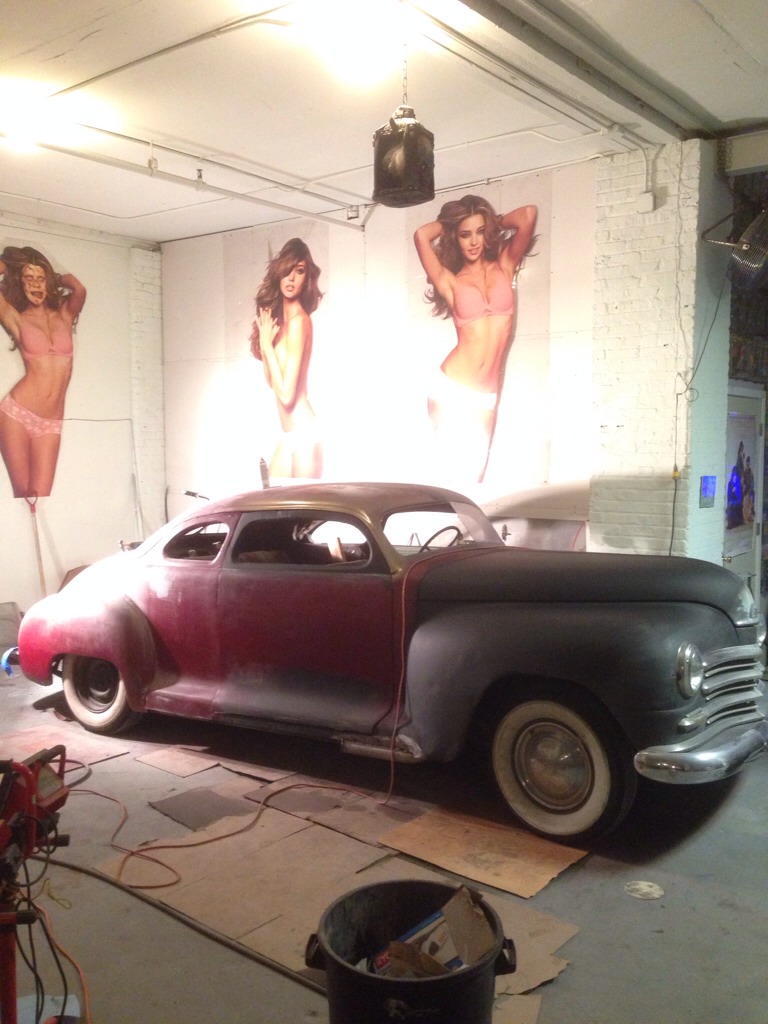

    Well I'm an idiot and decided to be cheap and lazy and put a temporary (again...TEMPORARY) rattle can paint job on my car for the summer. Instead of just rocking black primer. I found what looked to be a cool really dark satin red. I've done rattle can paint before and had people say "wow that's really rattle can?!?" so I figured why the hell not. Yeah dark satin wound up being fucking fire truck red. But it turned out to be a blessing in disguise and revealed some lumpy areas I need to address that were hidden by the black primer.
    So I learned two lessons. One...rattle can paint jobs are for chumps. And two...don't skip the guide coat.

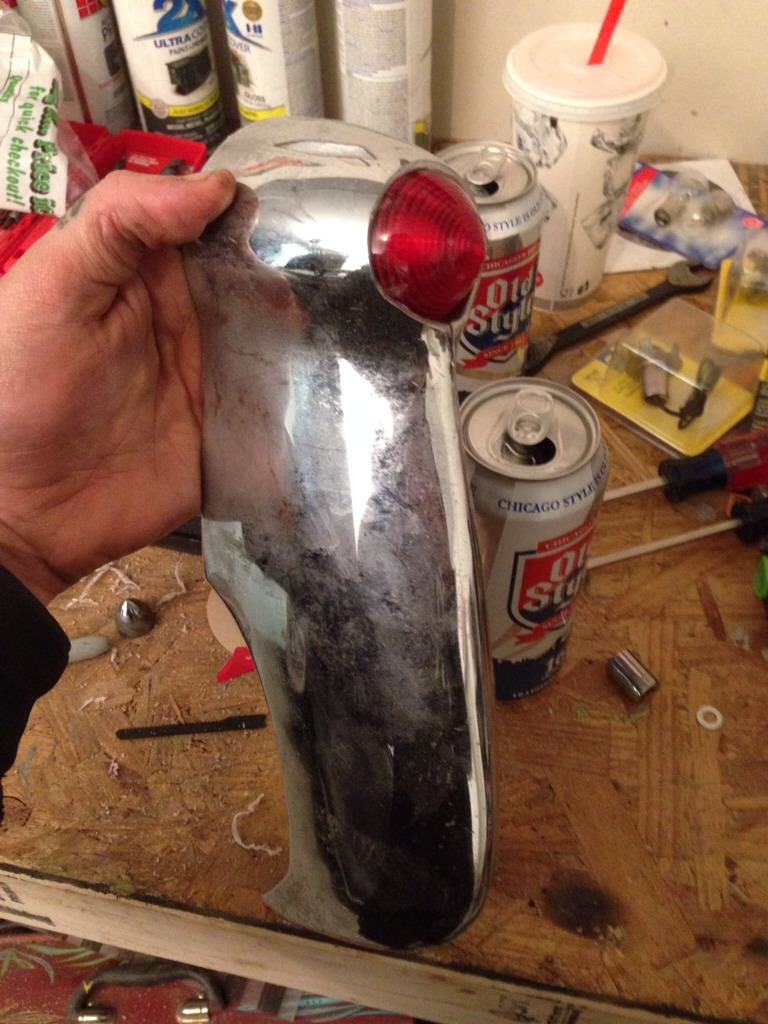

    I've also been slowly doing my tail lights. I think they look alright. Good enough for a driver anyway.

    Tail lights!
