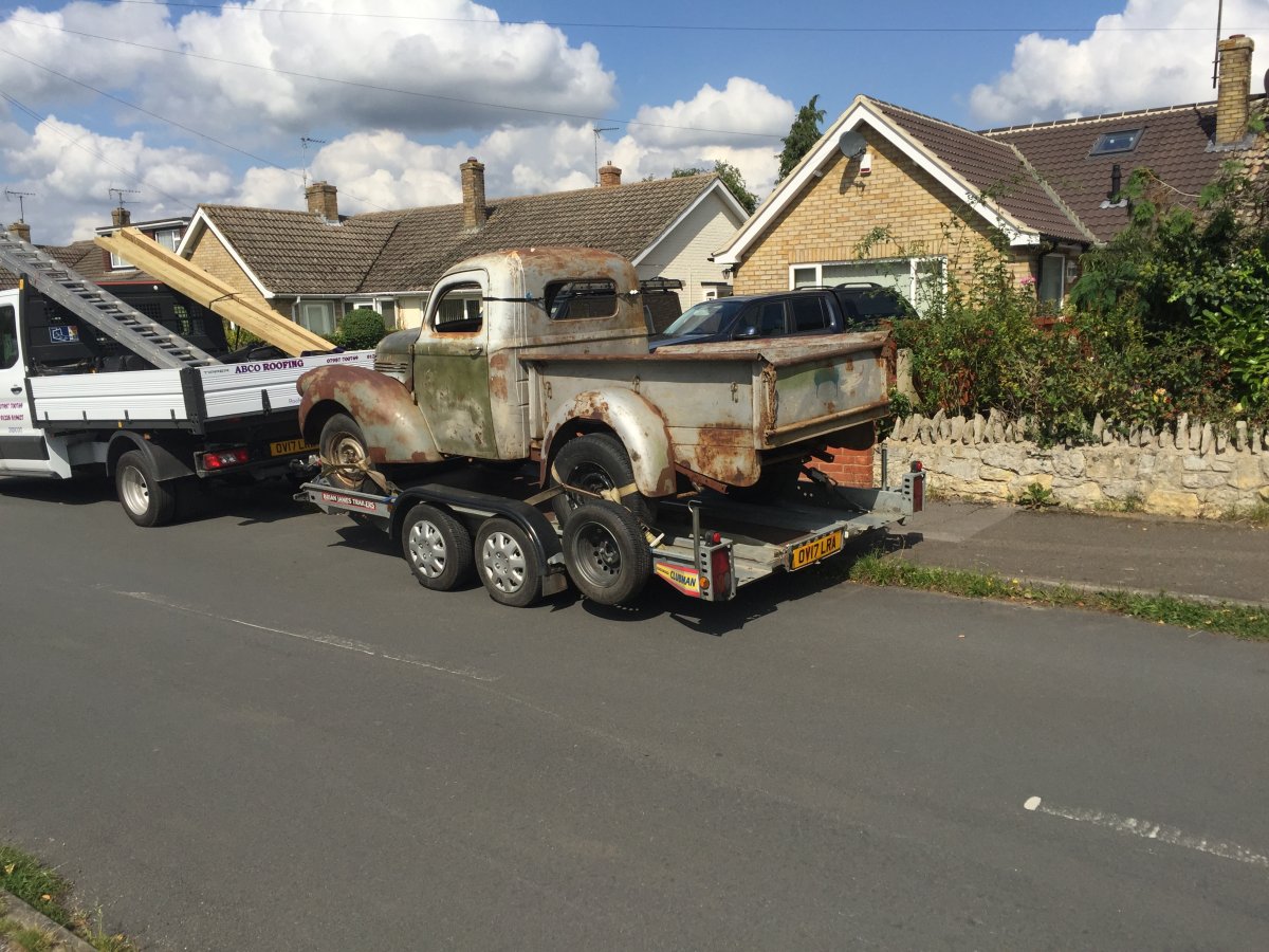

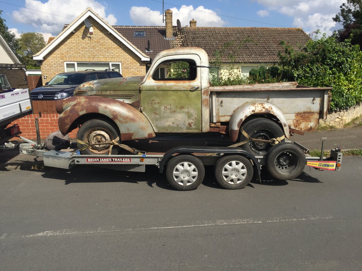

    Day of collection 2nd September 17
    0DC36747-E72D-4B47-9D9C-0D7C316C4F6C.jpeg D7E951FE-F6FC-43FF-AF33-A7C04AC5B993.jpeg

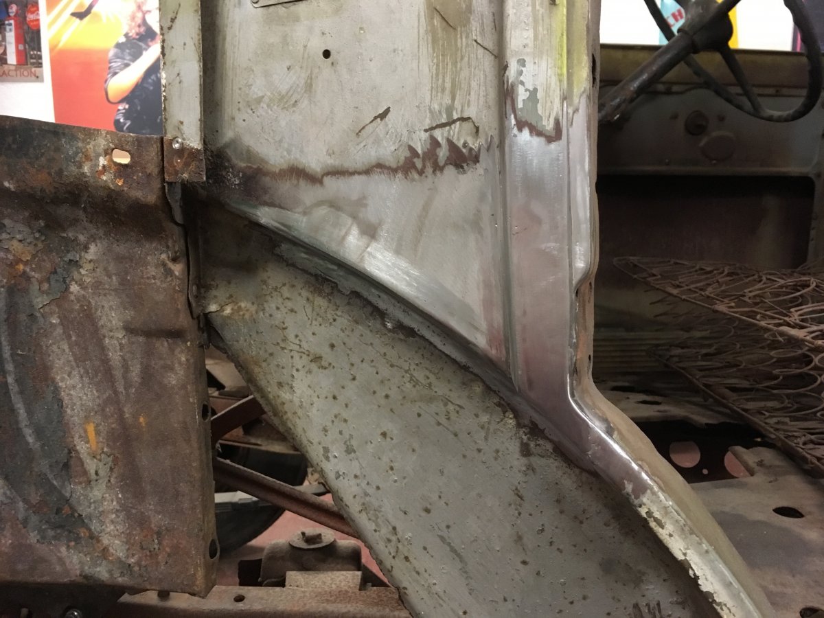

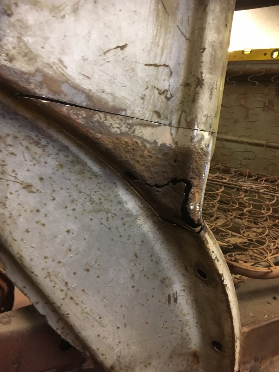

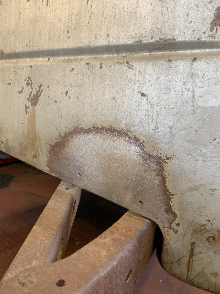

    It actually has gasser springs fitted here but the cab mounts had been cut and had no inner fenders so the whole cab was sagging over the chassis. So I replaced the missing bottom section and then repaired the rear cab mounts 5D403211-6A7F-4568-ACA3-7CA2730301D8.jpeg 3C67835B-9CDB-4B02-80D8-25447A09563E.jpeg C76443A6-A23F-4F4D-AFEC-15E87041E580.jpeg 219562F7-8D2E-4F34-87AA-E4D07EC2C8E6.jpeg EF3B024E-08B0-4B45-9986-B27A2C47ACD2.jpeg 8626B7C1-9216-497A-9652-85C8D8C954A8.jpeg
    Lower cowl repair

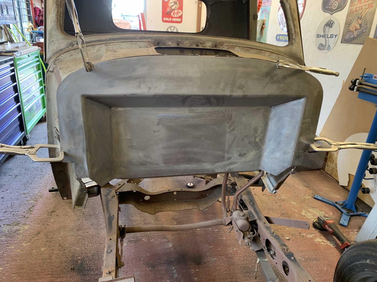

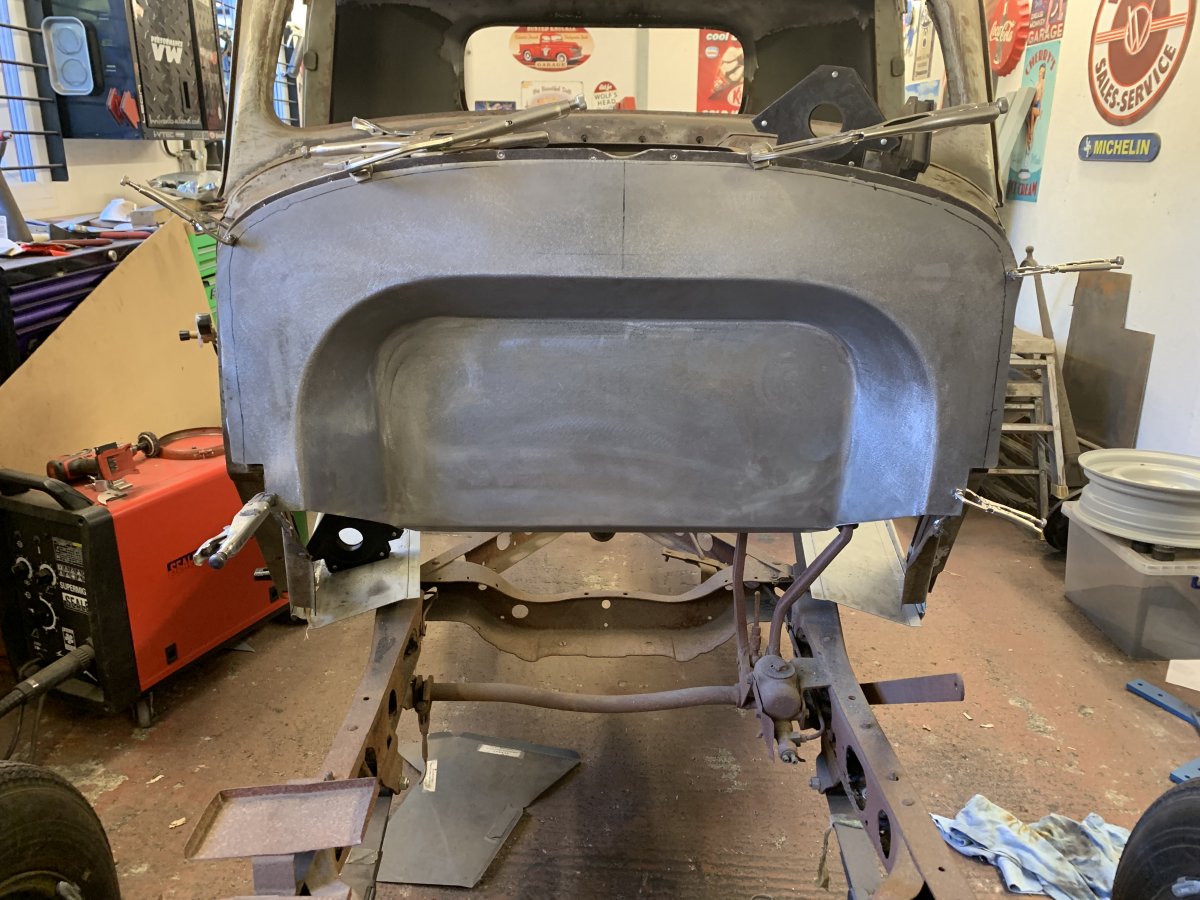

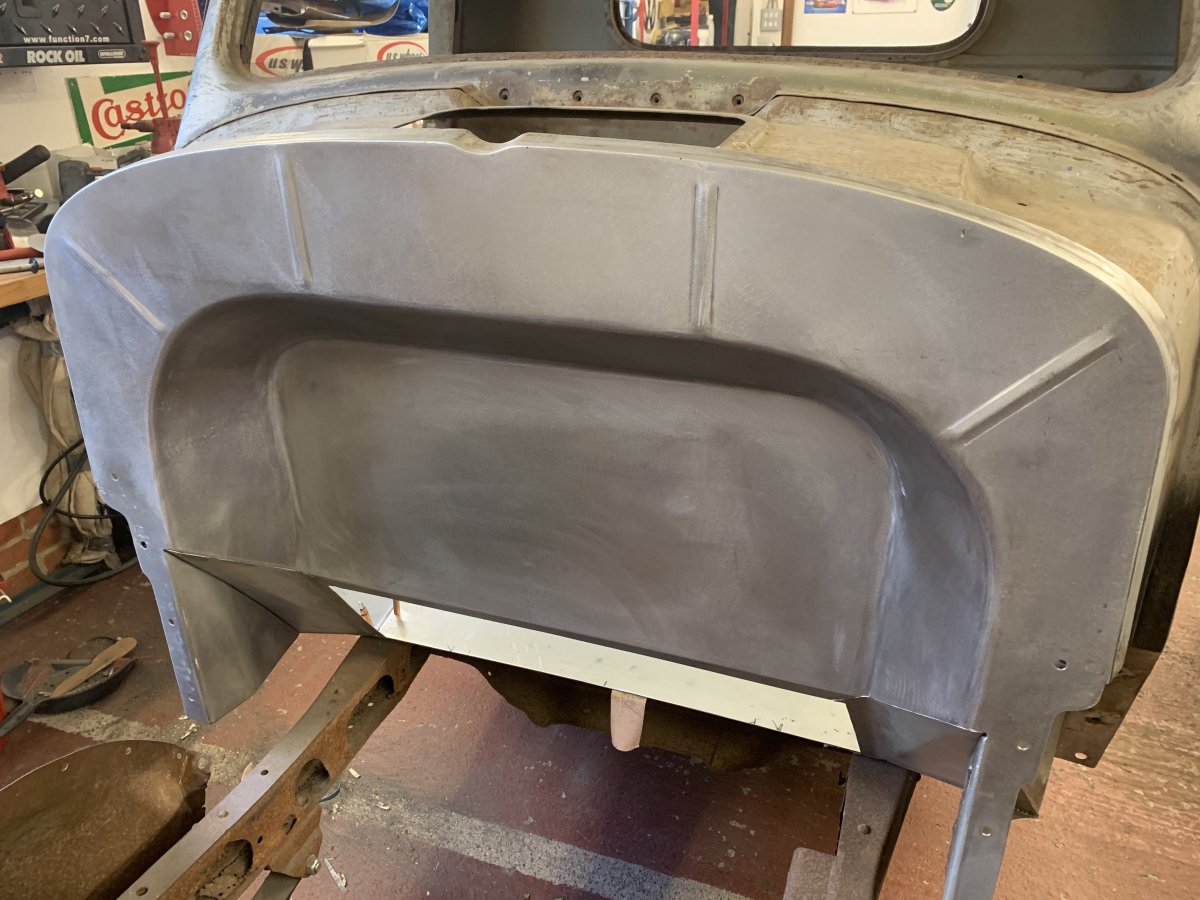

    Next up was firewall I knew with a 38 front that I would need a recessed firewall and although I wasn’t a 100% keen on it I ordered a direct sheet metal 4” recessed one as I no it works with a small block chevy with 38 front . When it arrived I was disappointed they had slightly changed the style and it looked strange so decided something had to be done so set about making it look a little more in keeping
    B17F5E7C-B671-448C-BBAA-39250BB9344F.jpeg 7E888E42-D0E2-4382-9040-5477CC9AB324.jpeg 2D86357F-62B3-463D-B875-BC67DE60BDAE.jpeg 7D13DF8A-5A84-43DE-8641-F83A60611FC2.jpeg 160183EE-57BB-4939-B20F-05770D13283E.jpeg
    It’s all now welded in but no pics yet

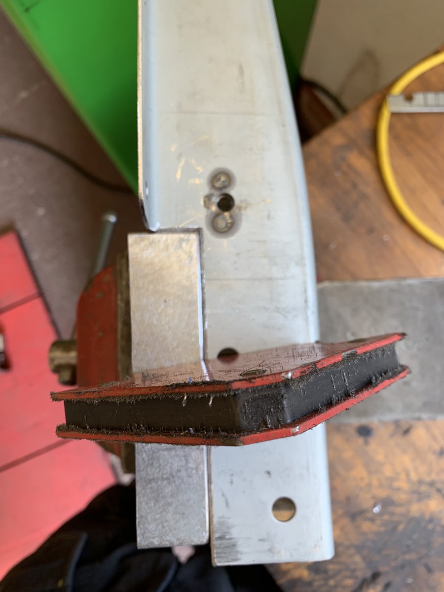

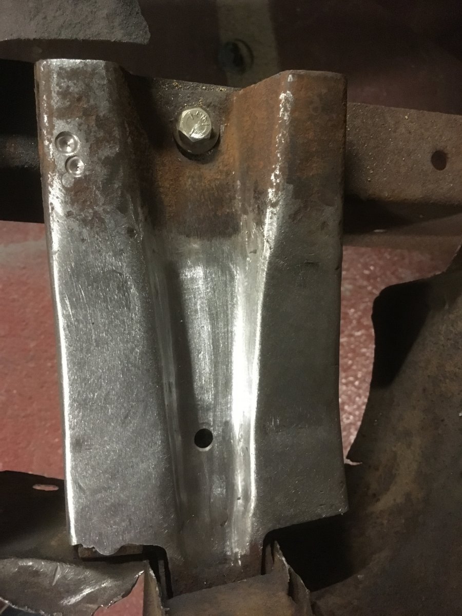

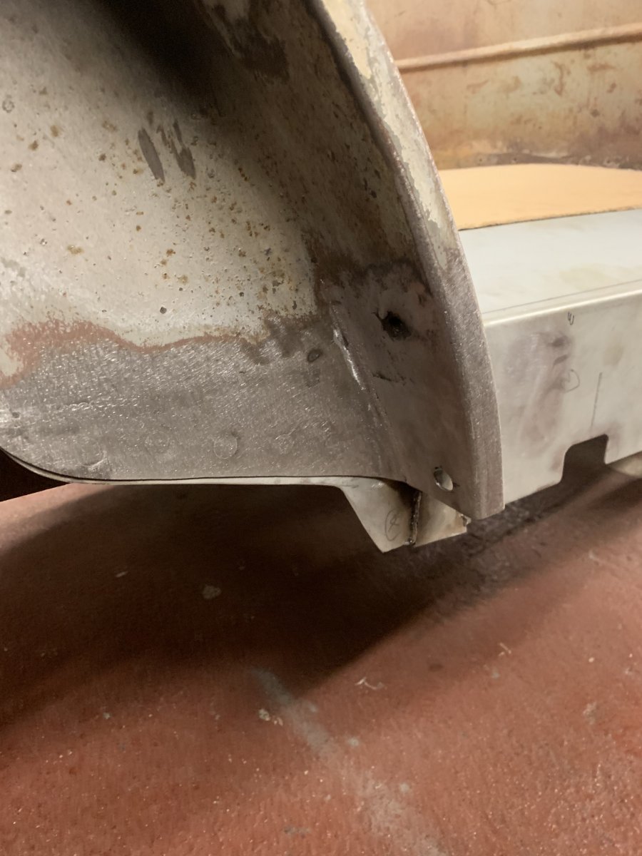

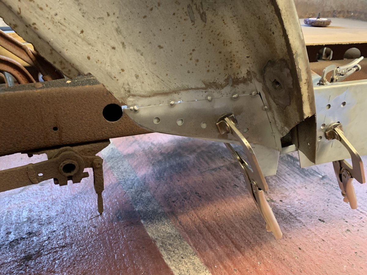

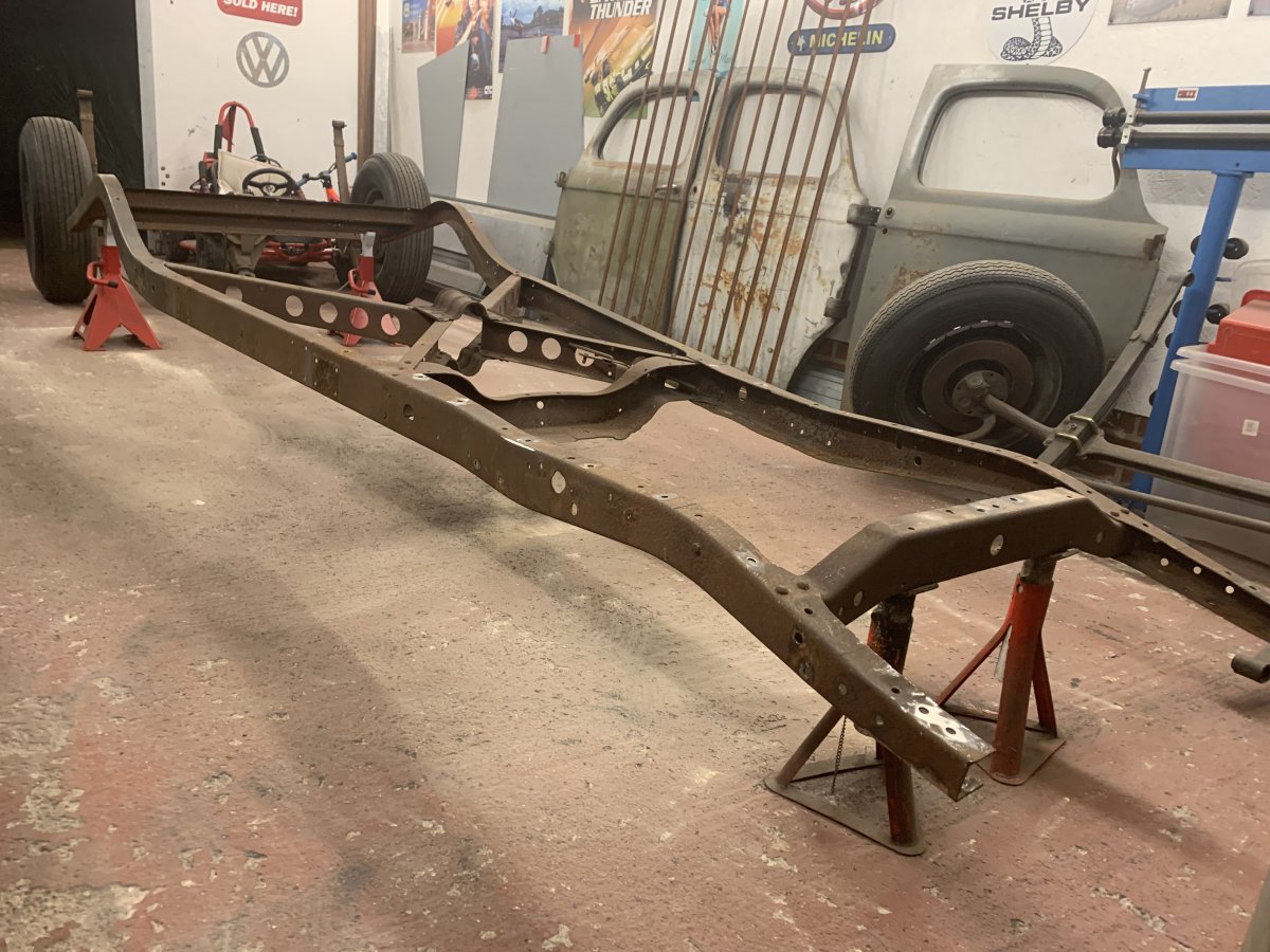

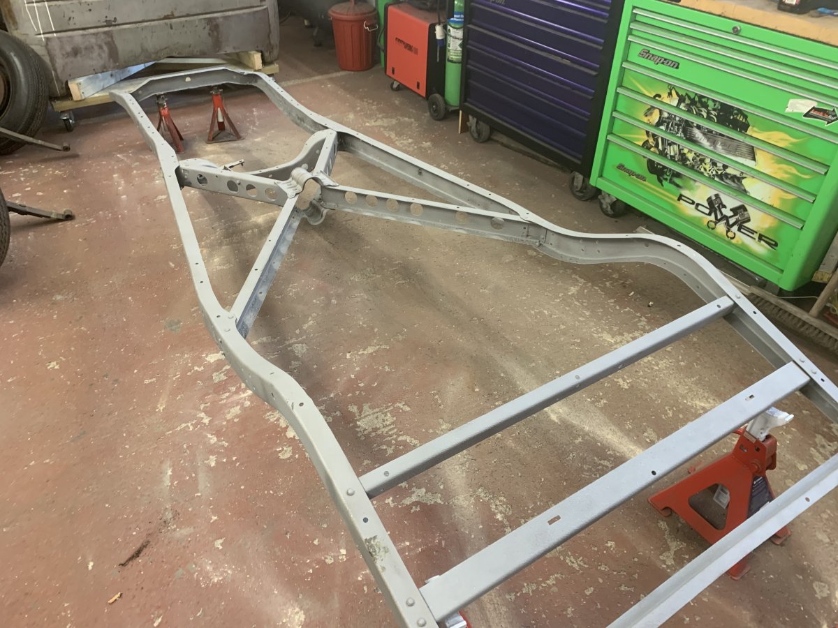

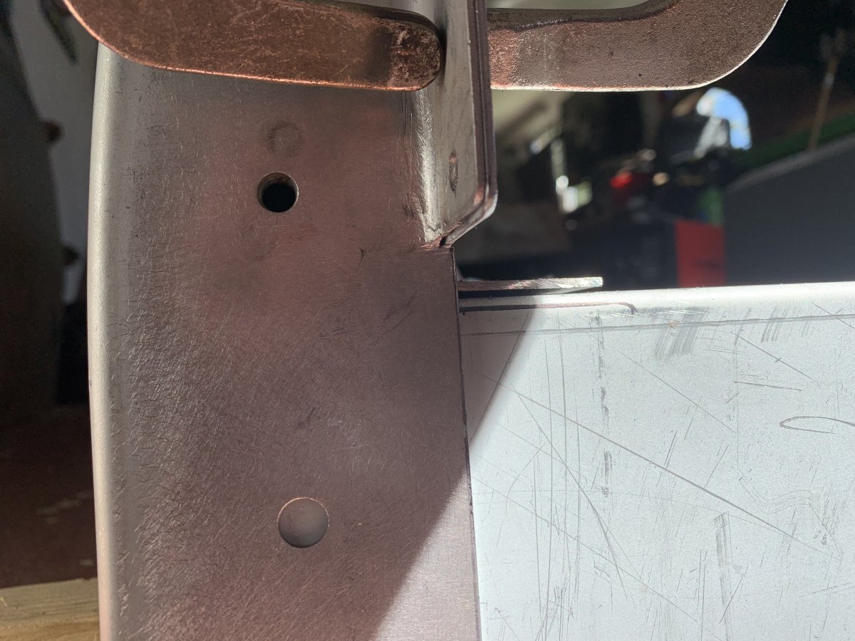

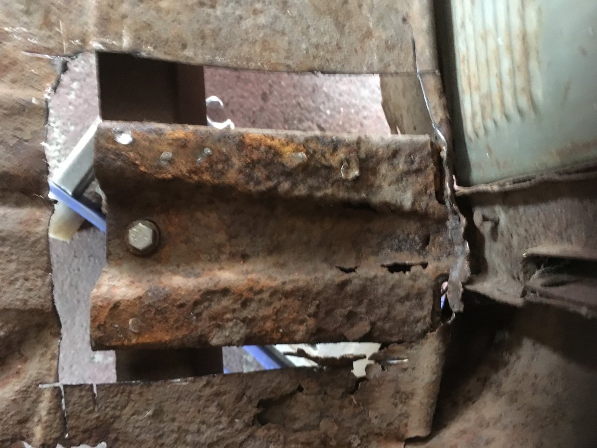

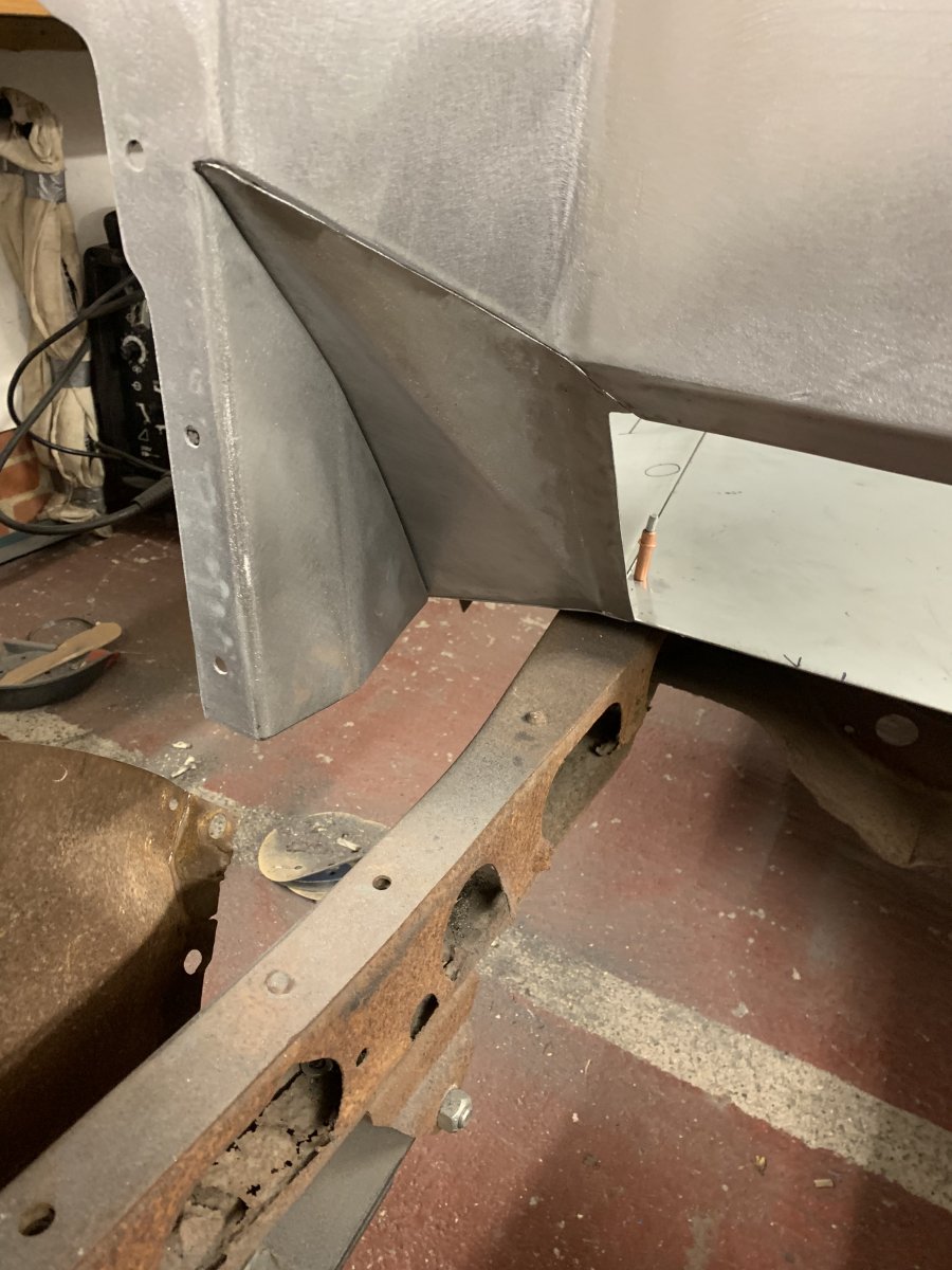

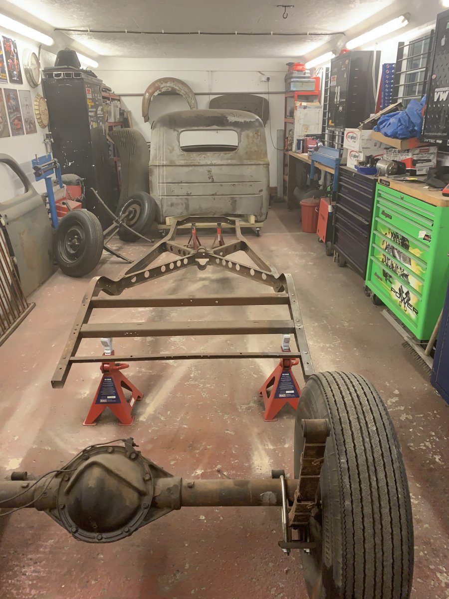

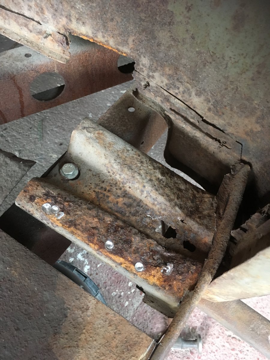

    Before The Willys was imported to the uk it was sat on an s10 chassis but came with an original Willys chassis so the guy that imported it put it back on the Willys chassis. Many pieces had been cut about for the 2 to be mated together including the afore mentioned cab mounts they had also butchered the floors and cut 2 sections from the cab back panel
    So these were welded up there’s 1 on each side but this is just the passenger side 2D71CDF6-173D-46EF-8CD9-3101CE5F779A.jpeg 363BB2D2-5CA5-4B77-895D-4C6D04B14753.jpeg

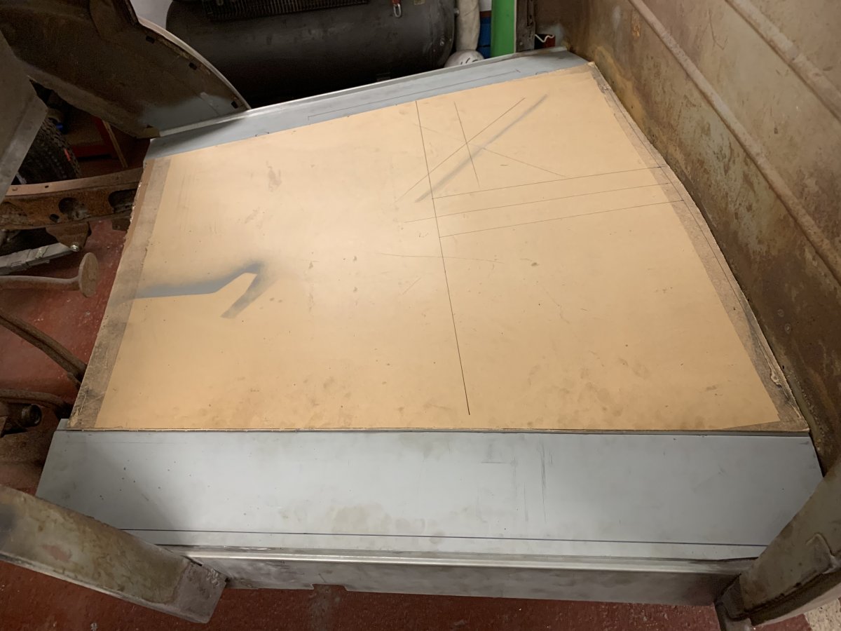

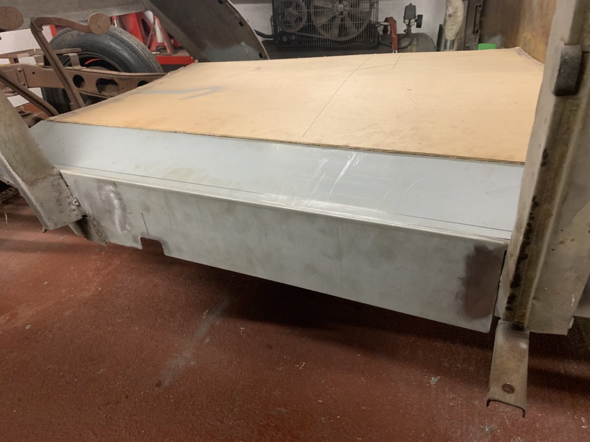

    2 new sill panels and lower arch repair and start to the floor. Wood is just a template for the central piece to give me an idea of how it will work.
    479C999A-33C1-46BC-A11C-3835F544EE28.jpeg 35EBC2BE-01DC-4B35-B613-B8D91E8C78D9.jpeg E899C7BB-51F2-4647-8DC3-DBB00236EDA3.jpeg 02B3DE31-7A7A-47F8-9B9C-AA0043EB5433.jpeg 41E00830-1471-4BDB-92A4-A6931D2CC926.jpeg
    This is pretty much as far as I have gotten with the cab as I need to do some blasting and could do with a new compressor as mine isn’t up to the job so I have moved onto the rear bed as I already had it made and it’s another step forward until finds allow for a new compressor

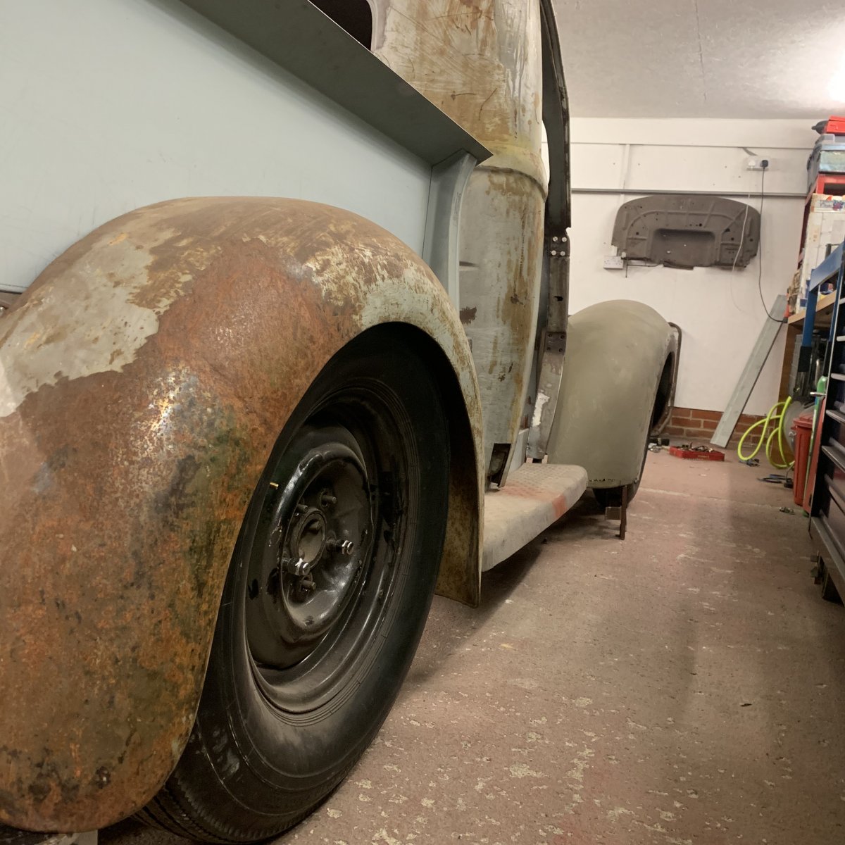

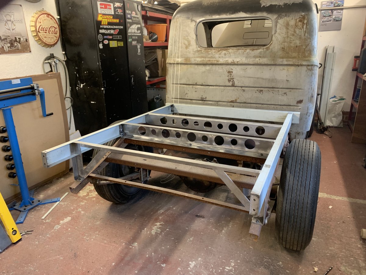

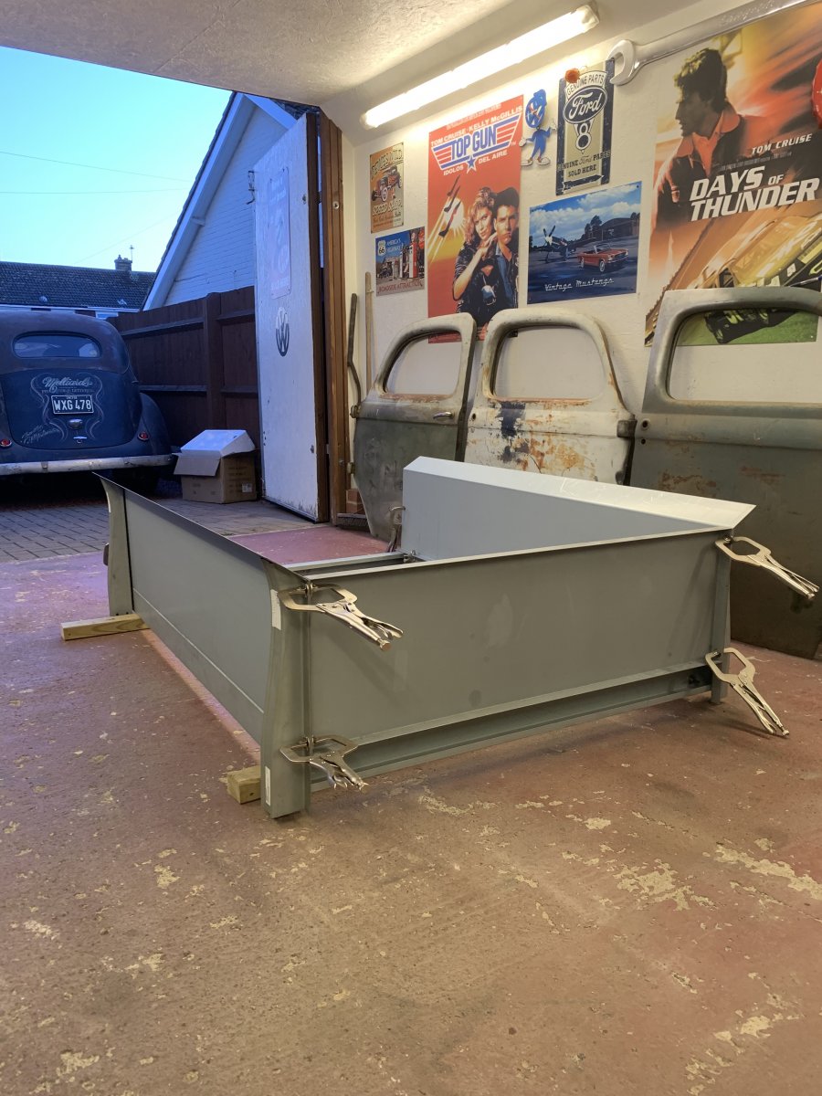

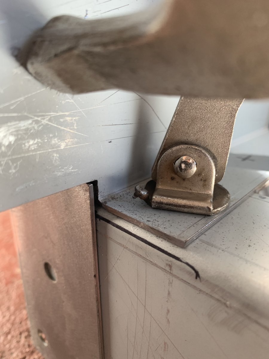

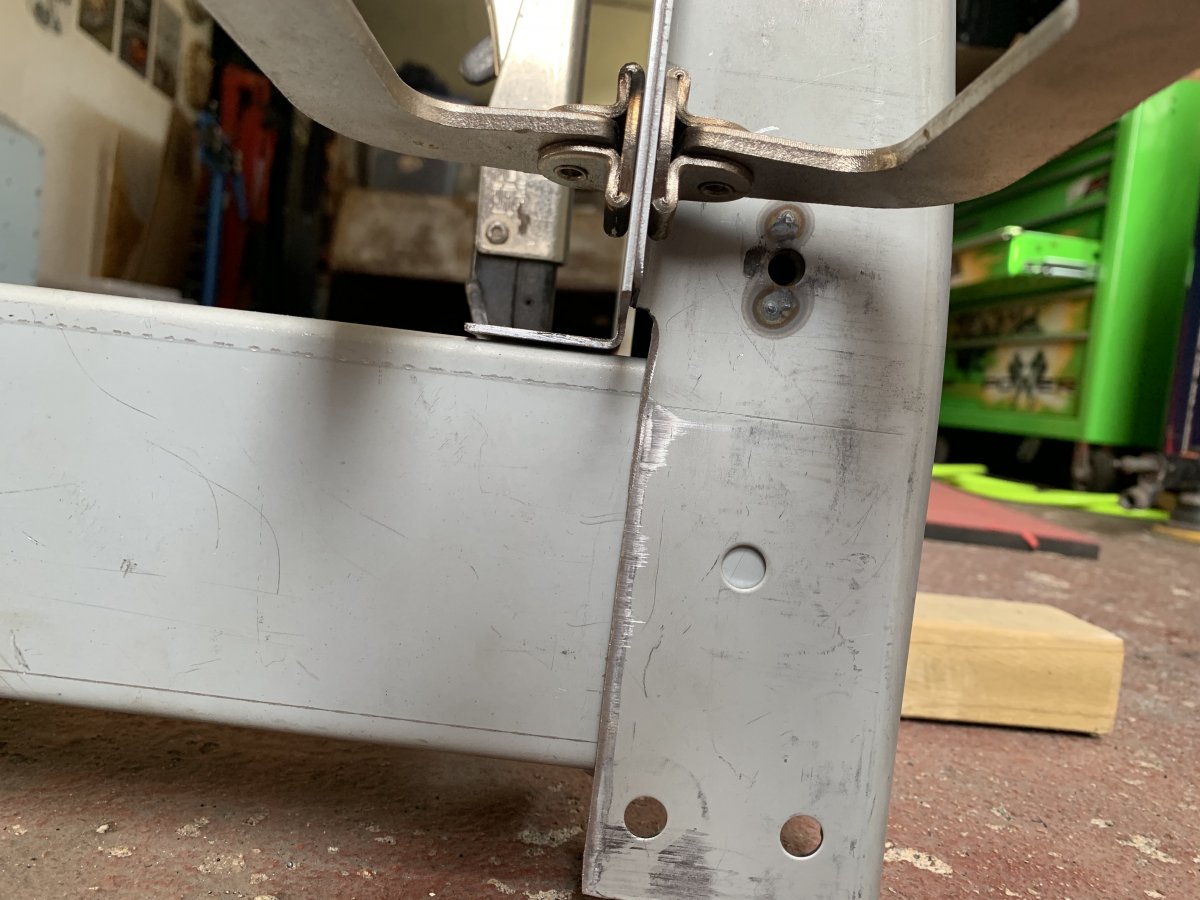

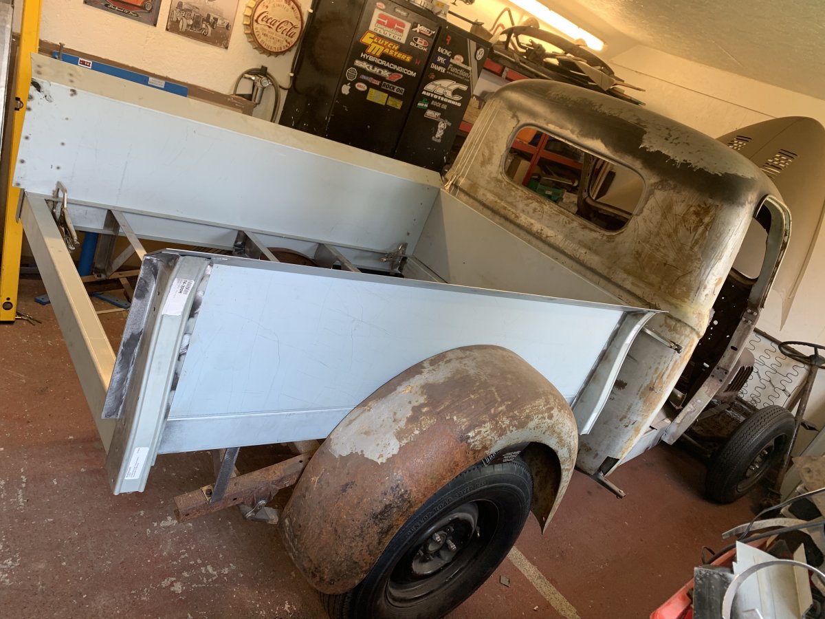

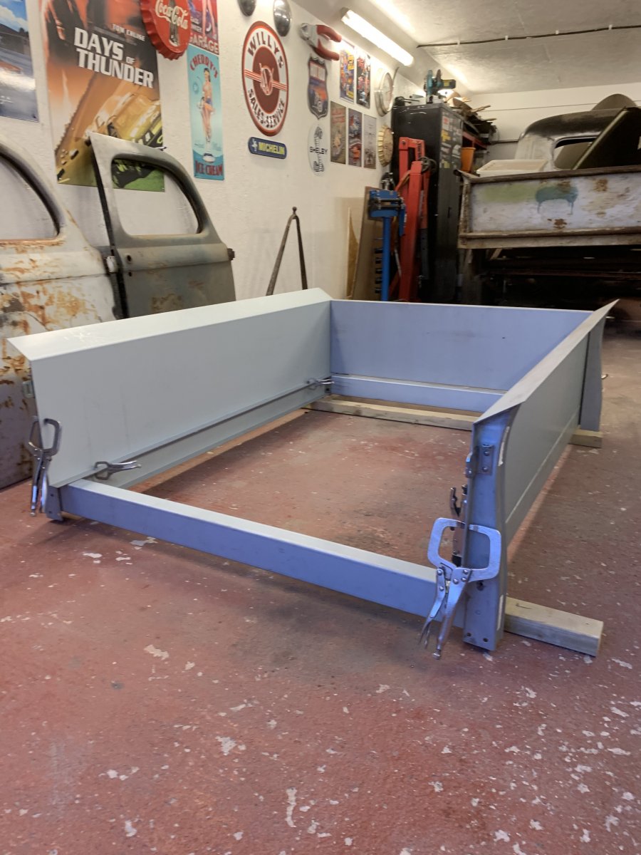

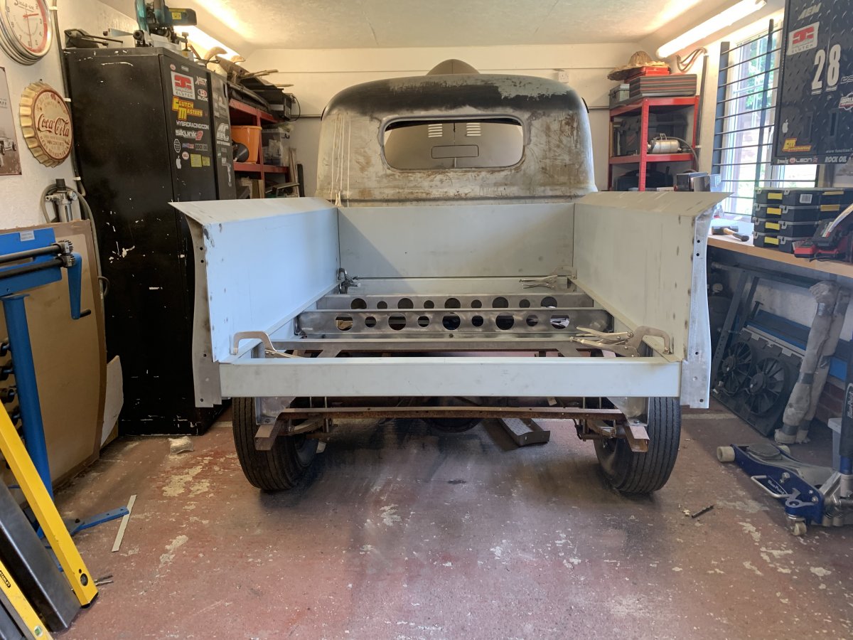

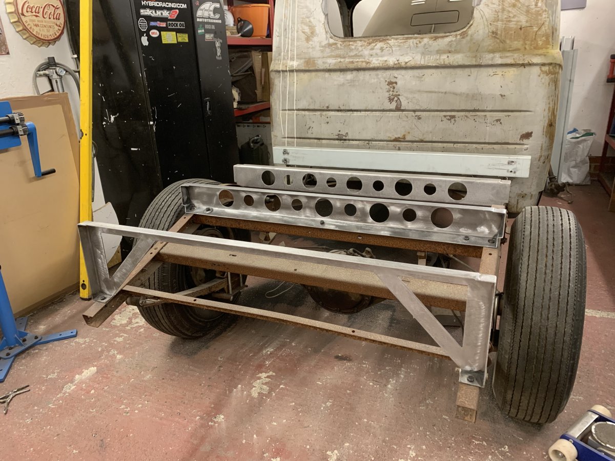

    Rear bed. I got a friend who is a sheet steel fabricator to fold all the panels as I don’t have equipment big enough to do them. I mocked it up on the ground as at this stage the original bed was still in place and we were in lockdown due to covid so couldn’t lift the original on my own.
    D3A2B845-9E76-4484-A438-5EF83192A98D.jpeg 2C6317E0-2923-4D0E-95A8-B86DE131E97C.jpeg
    I ended up using my engine hoist to get the original bed off as I was running out of things to get on with so started on the bed crossmembers and mounts and assembled the bed. The crossmember holes were drilled with a hand drill with the clutch on so I’m sure you can guess was a very slow process about 7 hours total but not all at once D83F922B-551F-48C5-8110-C1F6B9D2B22F.jpeg 0DF92BF0-A635-4422-93A0-5562004FBE70.jpeg 55B58C1D-E661-4F3F-9BC6-20C03E6D2C64.jpeg 3B95E297-B577-41D6-A04A-B564A36A7547.jpeg
    The stake pockets are chevy and pretty much the same as original Willys ones. When I cut the bottom corners on the 2 rear ones to allow for the tailgate hinges it left a hole that would be visible with the tailgate open so I decided to modify the pockets to get rid of the hole 6130CEA4-B94B-40F1-BEA4-D1ABF0753F86.jpeg 6D377739-D991-4D41-B033-908350F42F06.jpeg 3F35203A-1F7E-4BC8-9DC9-00E2B8E6A5C9.jpeg
    There’s loads of bits missing in the middle but pretty much brings you up to where I am right now. Next job will be tubes on side boards and head board and tailgate
    Cheers
    Luke

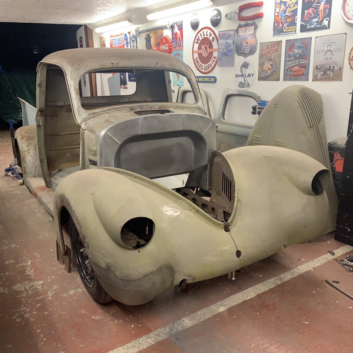

    That your ‘40 two door outside the garage? If this truck is half as cool as the sedan you’ll be doing alright. Lol

    Sure is yes I presume you have seen other pics of it to no it’s a 40 2dr (4dr conversion). The 40 is currently for sale to release some funds to build the truck.

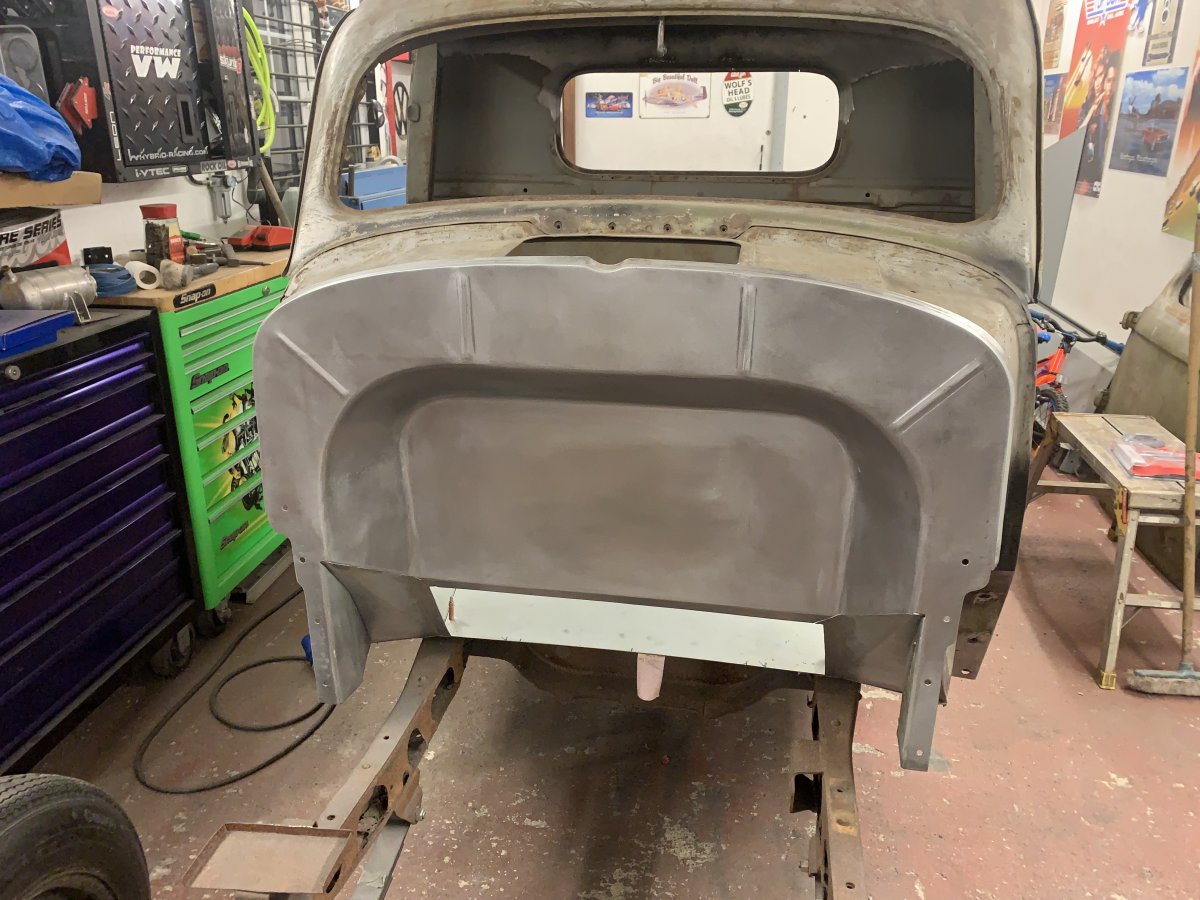

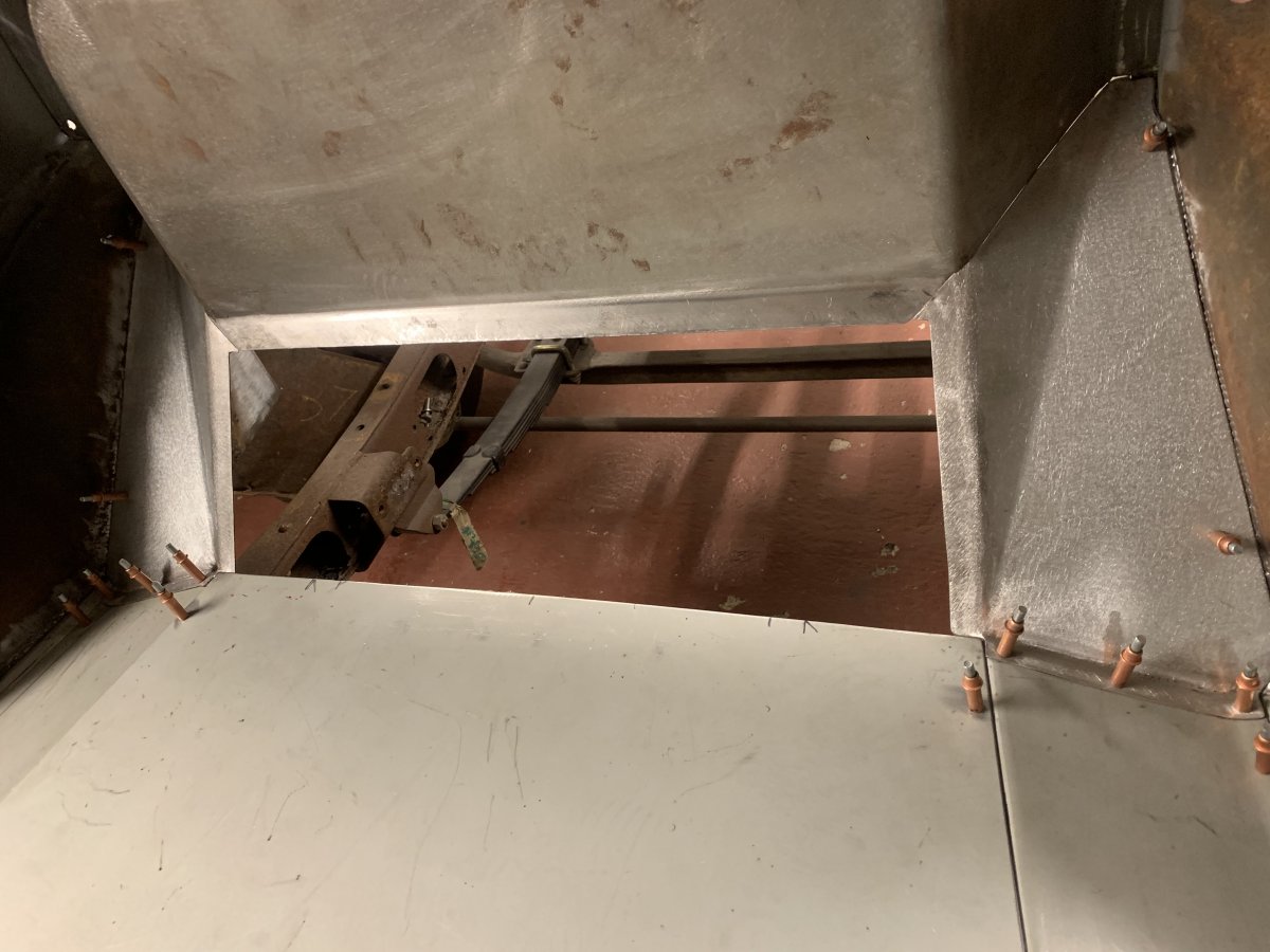

    Small update not done much on the Willys lately but the firewall is pretty much done got a couple of pin holes to tack in on a couple of welds. Toe boards made and ready to be welded in and have the floor roughed in also lower cowl panels made and welded in . Overall I’m pretty happy with how it’s turned out got a few wobbly bits but a very mild skim will take care of that before paint

  22. The firewall is recessed now or is that stock ? I seen where you had said you didn't want to recess because of losing interior space, if you used buggy spring setup.
  23. Luke stone
    Joined: Sep 5, 2017
    Posts: 135
    Luke stone
    Firewall is recessed 4” but floor length is stock so toe board angle has been altered. It’s a sacrifice I had to make to allow room for a v8 with the 38 front to allow enough room for a radiator. I still don’t have room for a buggy spring unfortunately as I’d still need to go back a few inches to allow room for bottom pulley and at this point in time to get it to sit where I want it looks as if I will be going independent front but don’t worry I won’t post pics of that

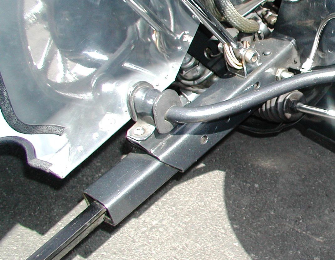

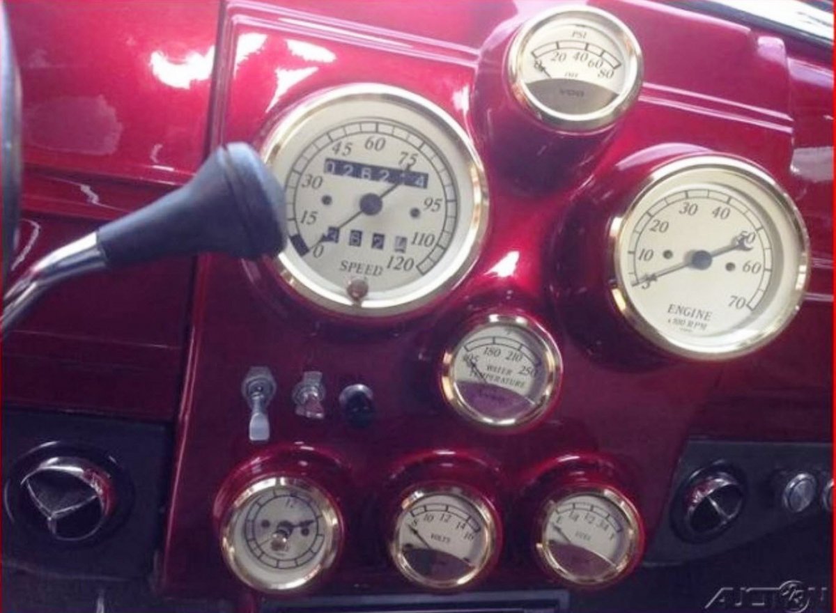

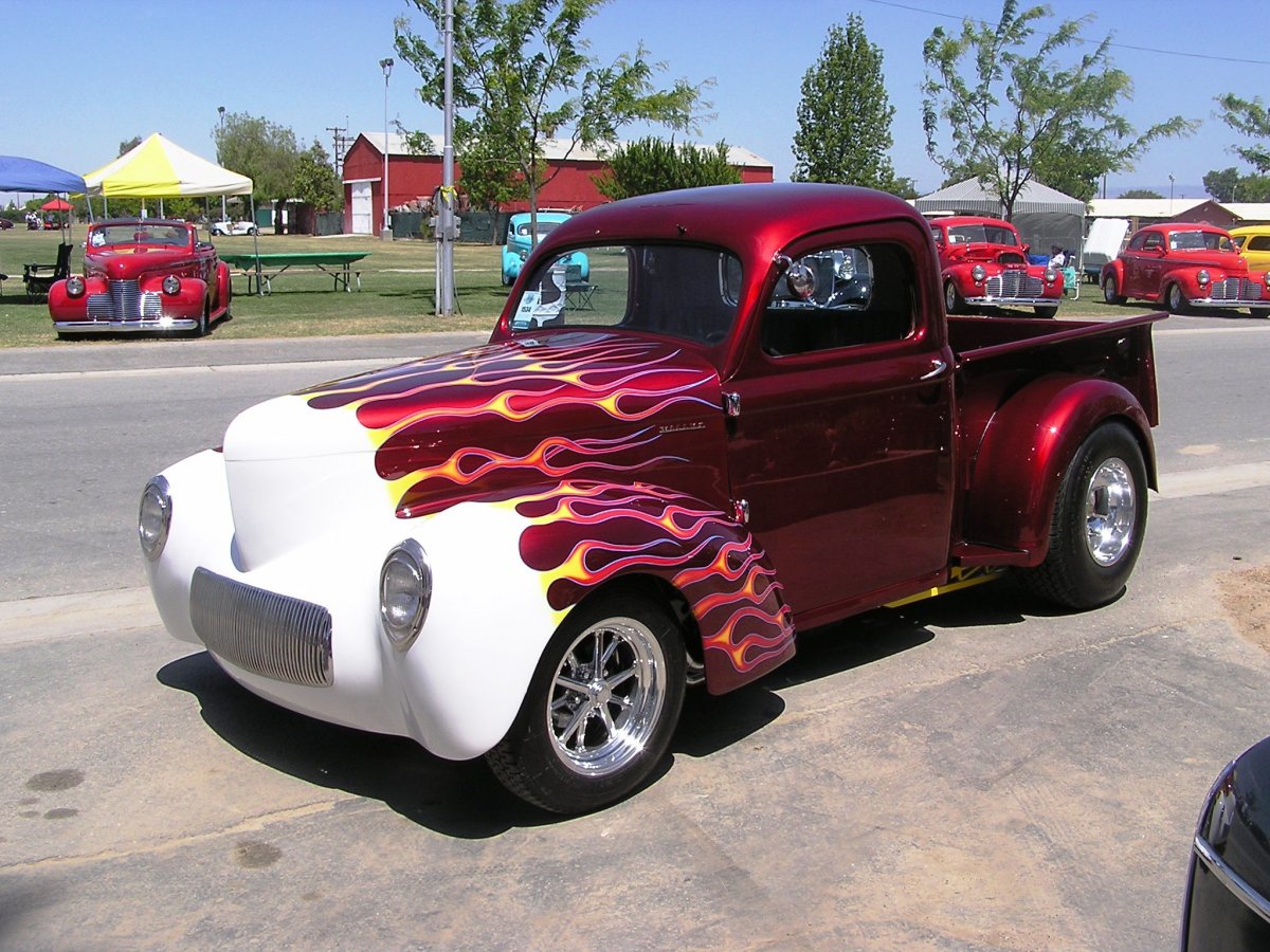

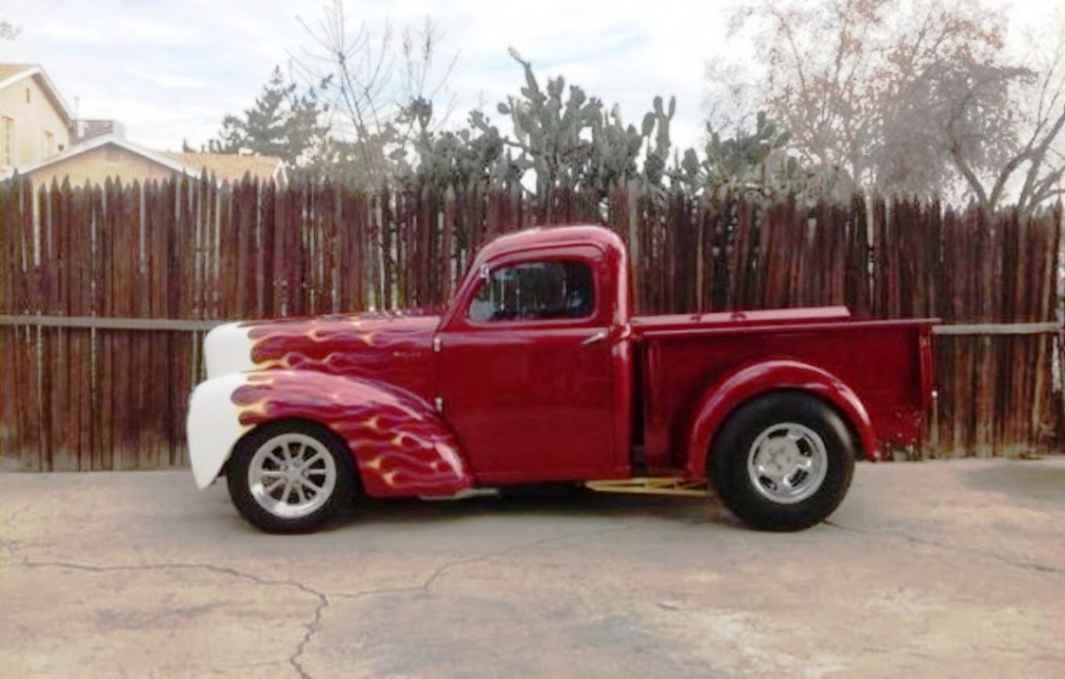

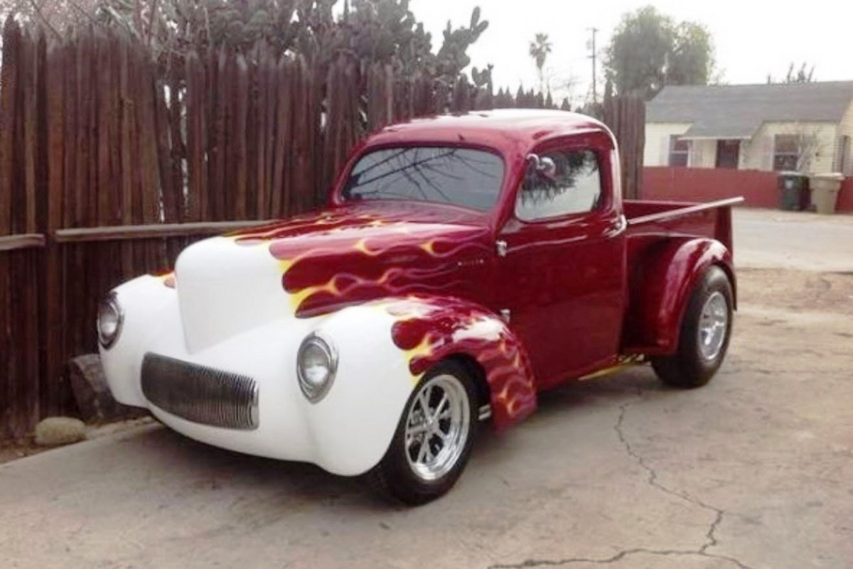

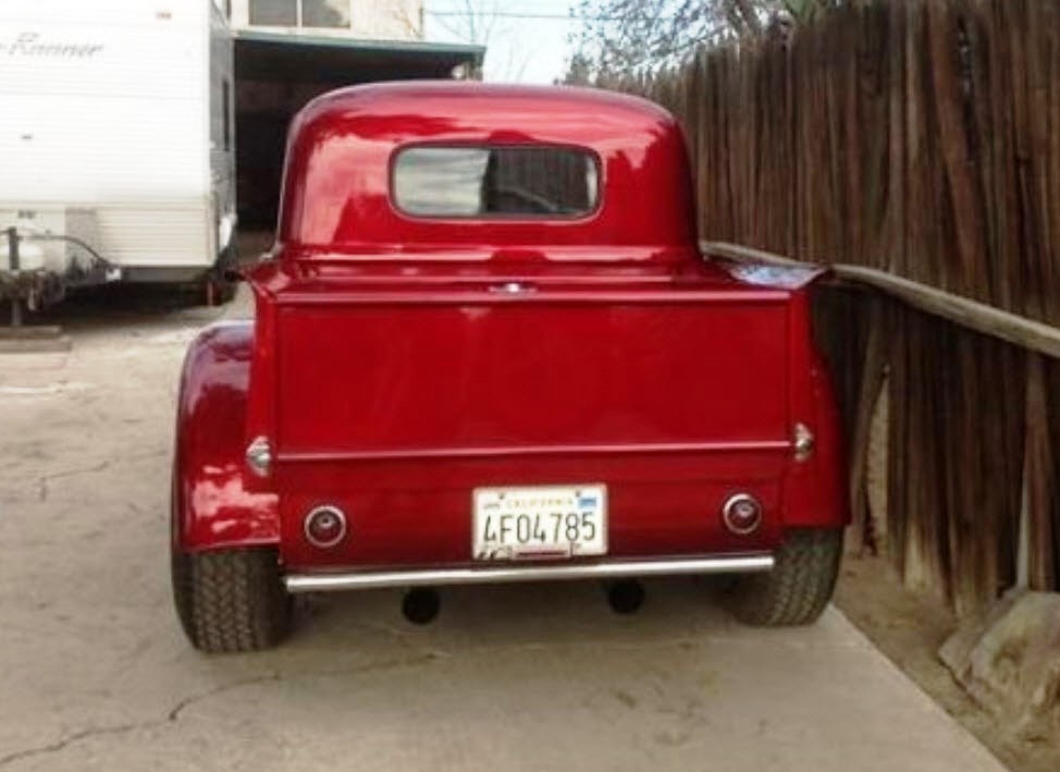

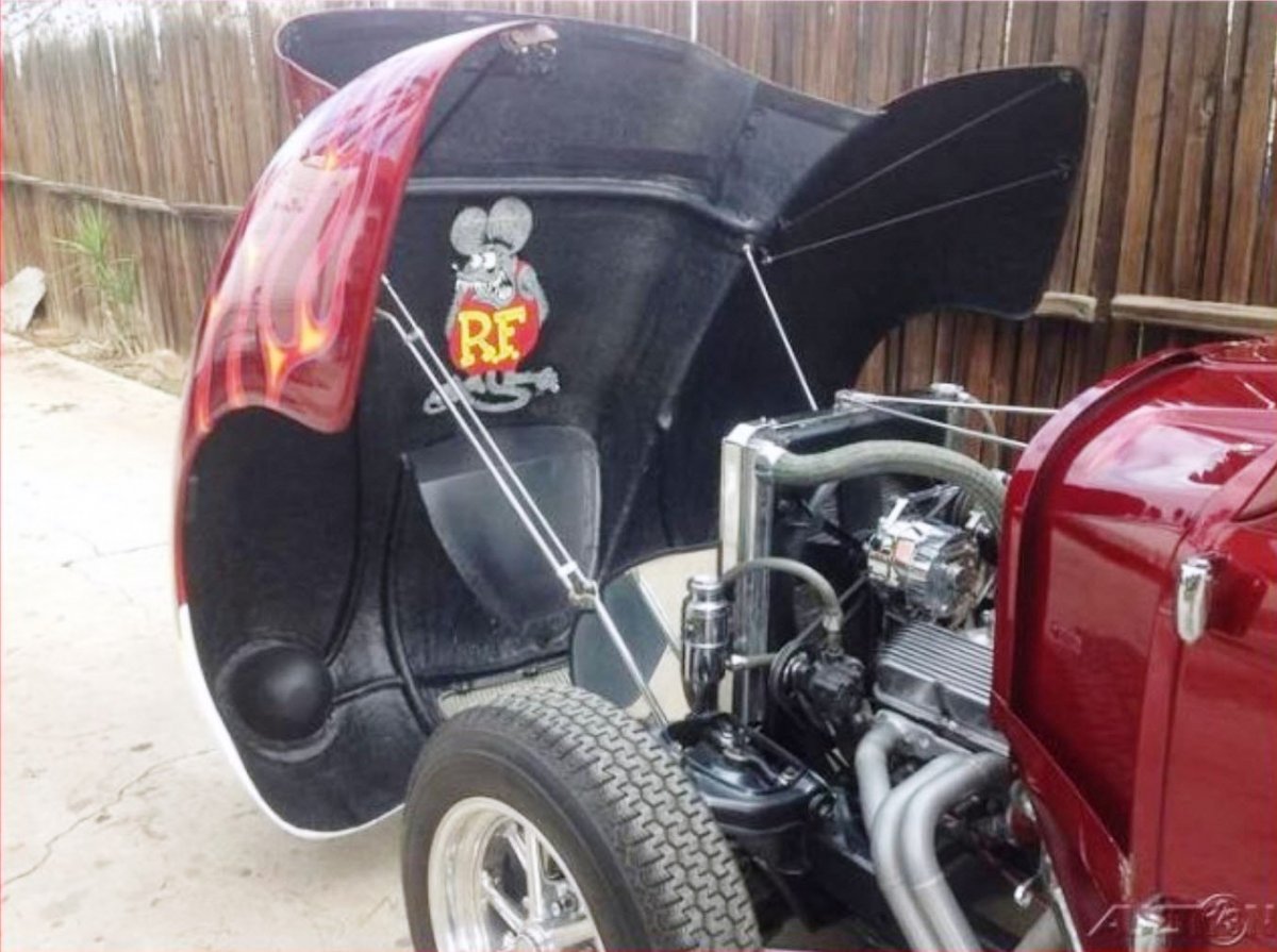

  24. Very nice work. Will be a great rod. Here are some pics of the '38 I built for a friend. We used some shaped cab patch panels from a guy who reproduced them. Fit pretty well. We also added some lower door sills made for coupes/sedans. We used a wheel barrel dash indent just wide enough for the SBC leaving a bit of foot room. He wanted a 'glas '42 front end. I made a mechanism that slides the hood forward a few inches the clear the door hinges then tilts up.
    His bed is Willys but he used I think Dodge rear fenders because he didn't have the Willys ones and the dodge ones are wider and look almost identical to the Willys. We also added a MII stock front crossmember and suspension. Worked great.
    Note the dash with gauge pop-outs to make room for the under-dash Vintage Air AC unit.

    Hi jon yes you are correct I did buy this from Mel had it 3 years now. I’m the 3rd uk owner and really the only 1 to do anything with it. It was up for sale for quite along time and I stewed on it for a bit until my dad pushed me into going for it. I’ve never built anything like this before so it’s all knew to me done restoration work before but in comparison that’s easy as you just put it back where it came from. Got a long way to go with it but cogs are turning now after a lot of head scratching and planning which way I’d like to go with it but I think I have a clear plan now but you no what happens to the best laid plans. May be a slack period again until the chassis is built now as want to make sure
    Everything is squared before going too far

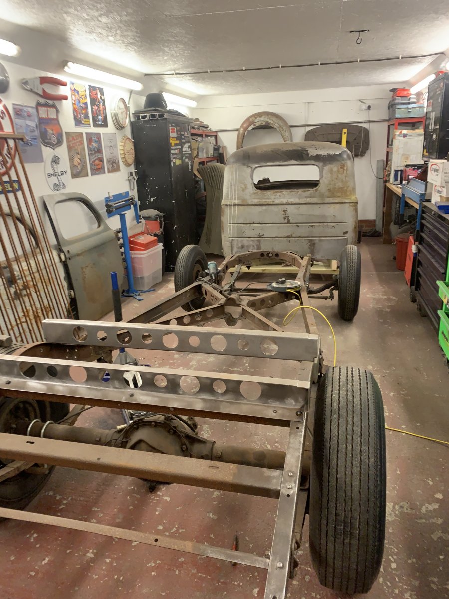

    Been a busy week here. I contacted a local company about building my chassis last week and turned out he had a free spot over Christmas but I need to have it with him on the 12th dec so the late nights began straight away . I mocked up for ride height and took all the necessary measurements. Next was to brace the cab and build a trolley to mount it too then blew it all apart to strip the chassis and remove all unnecessary brackets and the rotten front inner structure etc. I’m now sick if rivets. My dad blasted the chassis for me today as he has his own pot I just had to hire the compressor. Couple of hours later I now have a clean chassis all be it a bit thin in places. 553CC970-4C62-48C4-8AF5-BE5CA65D520D.jpeg
    Cheers
