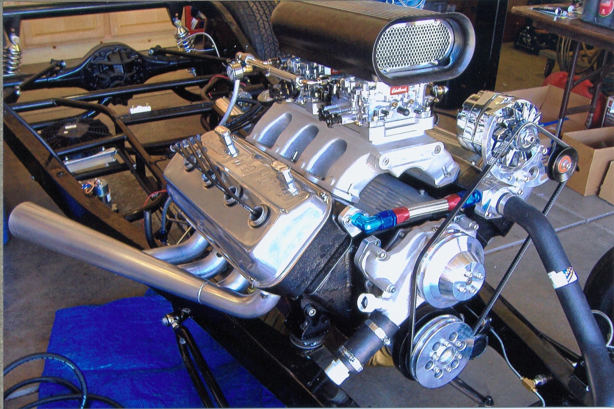

    Hey TomH the frame was a set of american stamping rails streched 5". The only ford part in my chassis is the model A rear cross member .The old chevy is channeled 3" over the duece frame and the body is contoured to match . We live in a world of mixed marriages this one is ford chevy and chrysler !!. But I was thinking thats what Hot Rods are The best of many and faster than any !!

    Terry, Thanks for the info and the pics to back it up. The reason I was thinkin' the front was to get the Hemi in.
  23. nailhead terry
    Joined: Mar 23, 2008
    Posts: 1,460
    nailhead terry
    TomH its realy hard to see but I mocked the frame and set the body on and set the engine in as close to the firewall as I could and leave fan room and thats how it all was done! then I determined that then I needed 5 more inches of wheel base to make the thing fit right . My chevy coupe is a mercury series which was a 107"now its 111" if you want know anything let me know !!
