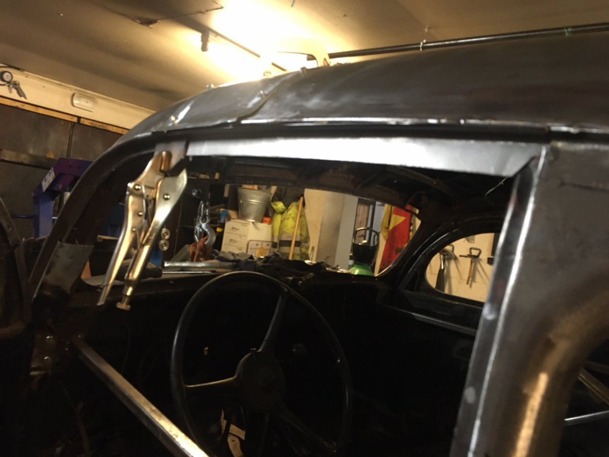

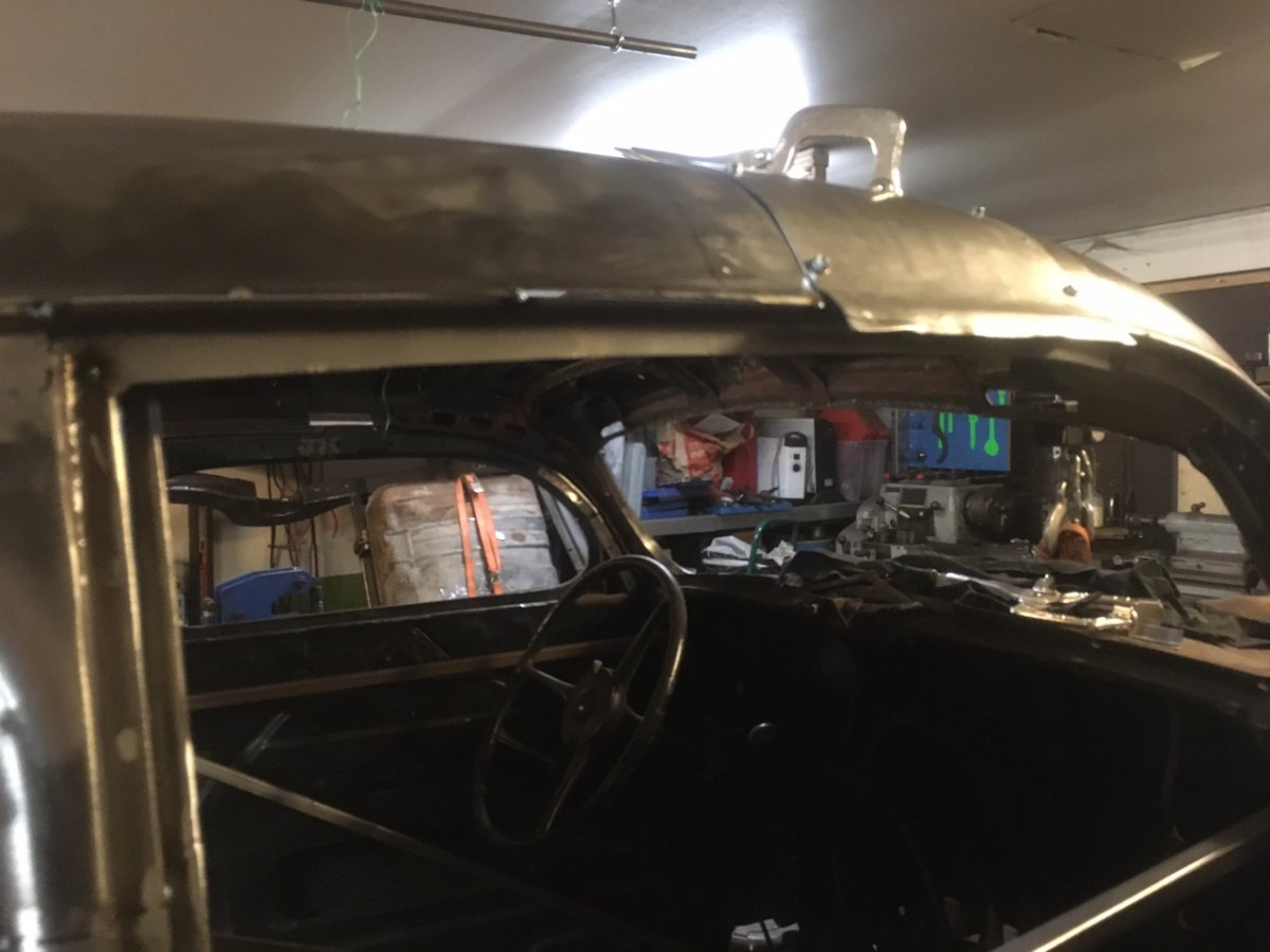

    So today I got some pieces in place.

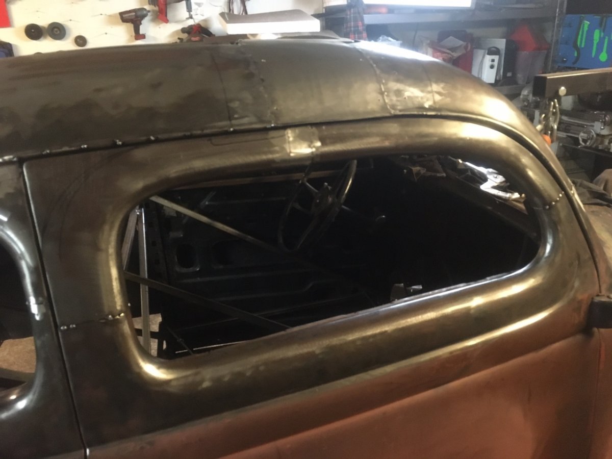

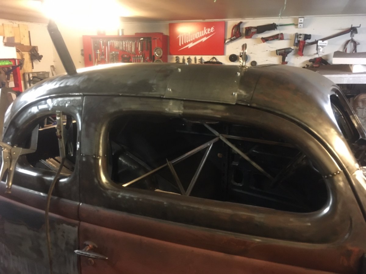

    So first I made the top of the door, after fitting the wood template properly.
    Then I cut out the entire top part of the door jamb, and made a new piece that got buttwelded in place before I started fitting the roof piece and screwed it down in place.
    Then the magic cookie cutter came out and I cut along the edge of the roof piece and welded as I went along, lifting up the edge with a flat screwdriver to align the metal.
    Still have some fitting along the drop rail and some more work along the roof insert before I can finish weld and hammer it all.

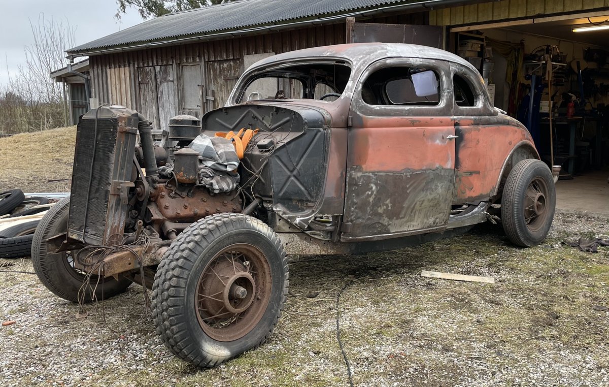

    Not really, I had a sketch that mr eBlack made of a 36 and the 36 Cole foster made for kirk of Metallica.
    The latter is a 5 window rebuilt into a 3 window.
    I just tried to study the curves of the roof and wanted to make it feel more slick and make it flow like jazz down the back of the car.
    So I cut and pasted on my drawing board a bunch so I knew where to cut it before I even had the car at home.
    The chop changed a bit when I finally cut it apart tho, took an extra inch off the rear.

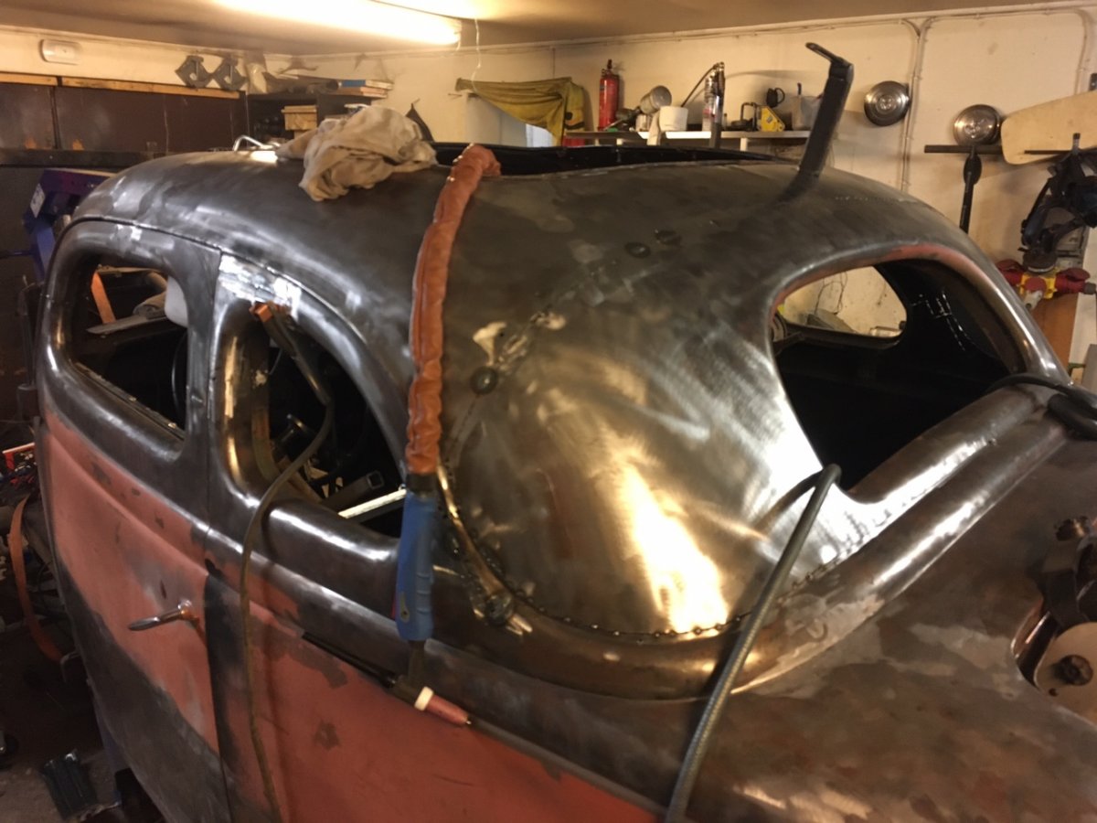

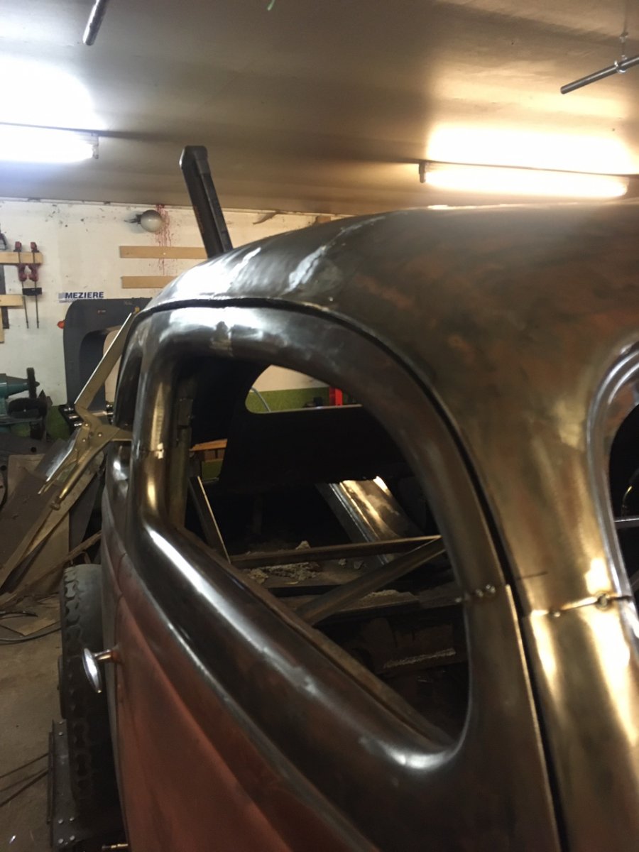

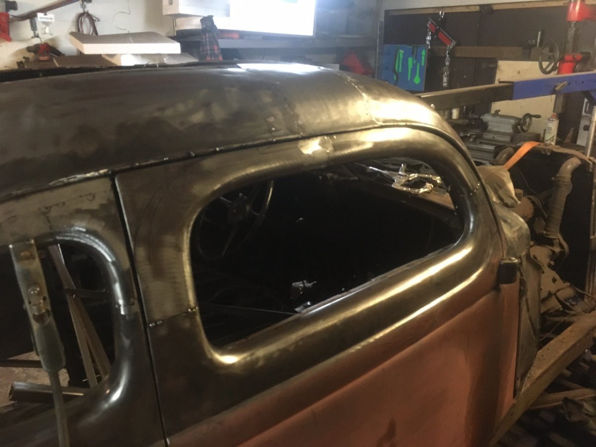

    Got both sides of the roof welded in, started making some fill pieces for the surround of the roof insert and the inside of the door jamb.
    Here you can see I still have some massaging to do on the drip rail before it’s done.

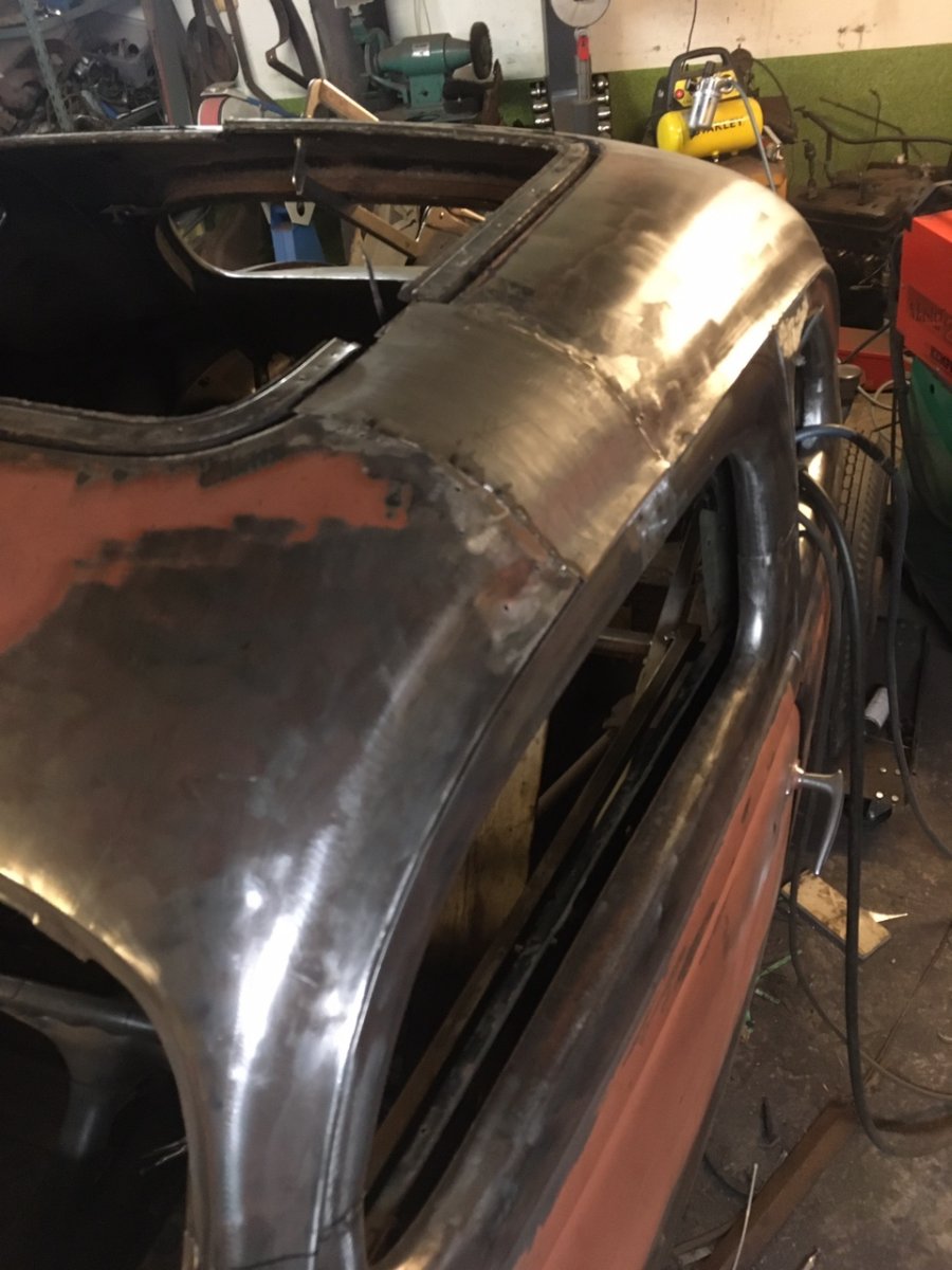

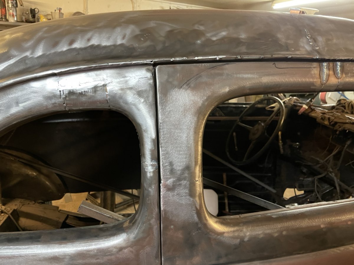

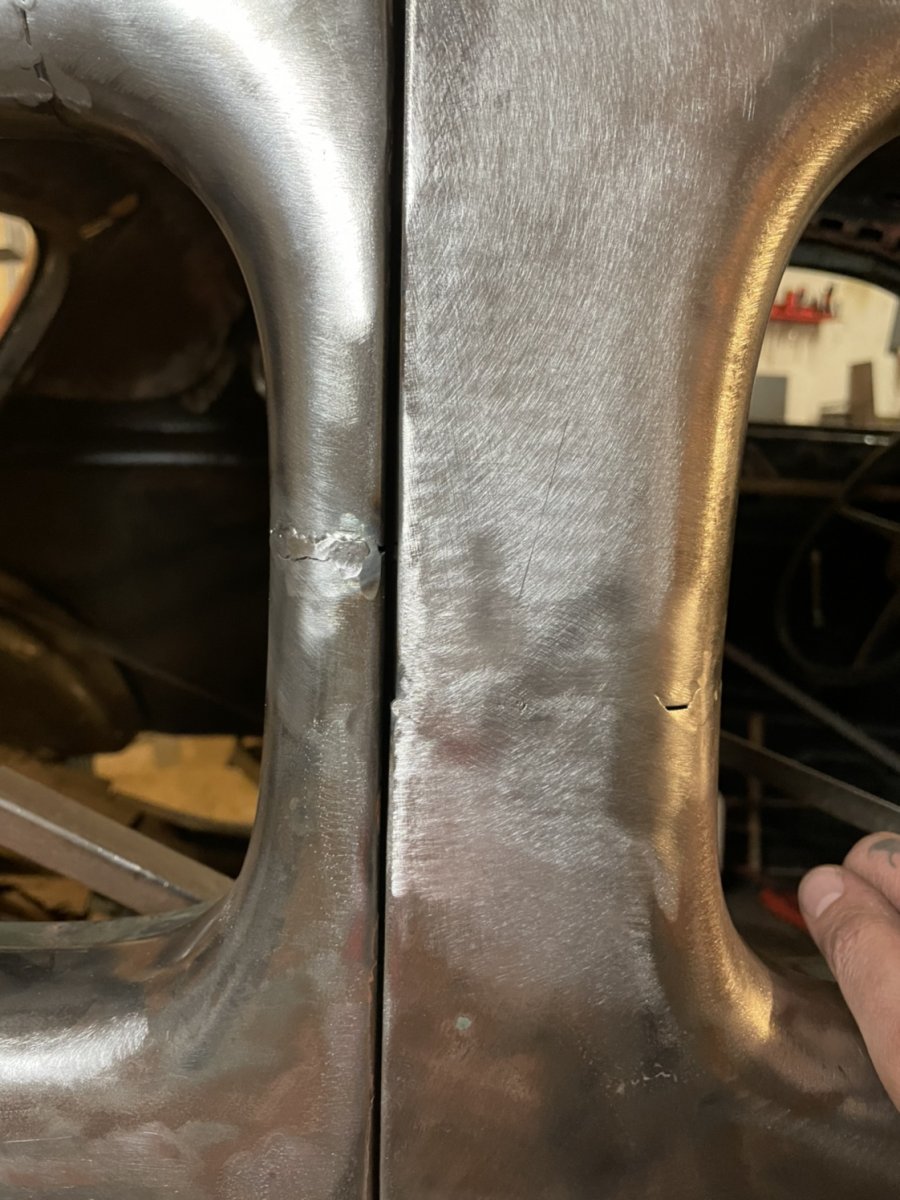

    At this point progress is slow, a lot of welding, cooling, grinding, cooling, hammer and dolly, and then rinse and repeat.
    Everything needs to be worked over properly so I don’t have to dip the car in bondo when I’m done.
    Photos are still shit.. but the work looks better.

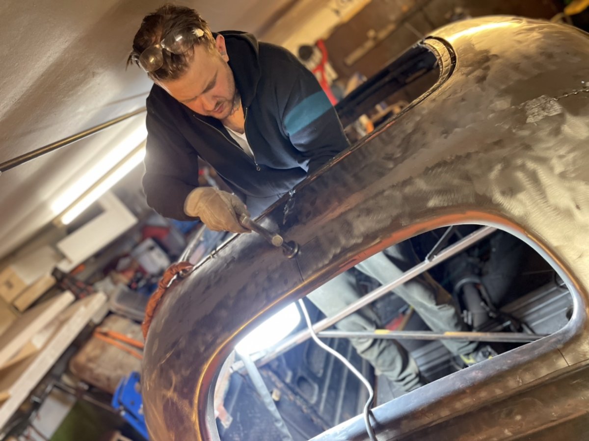

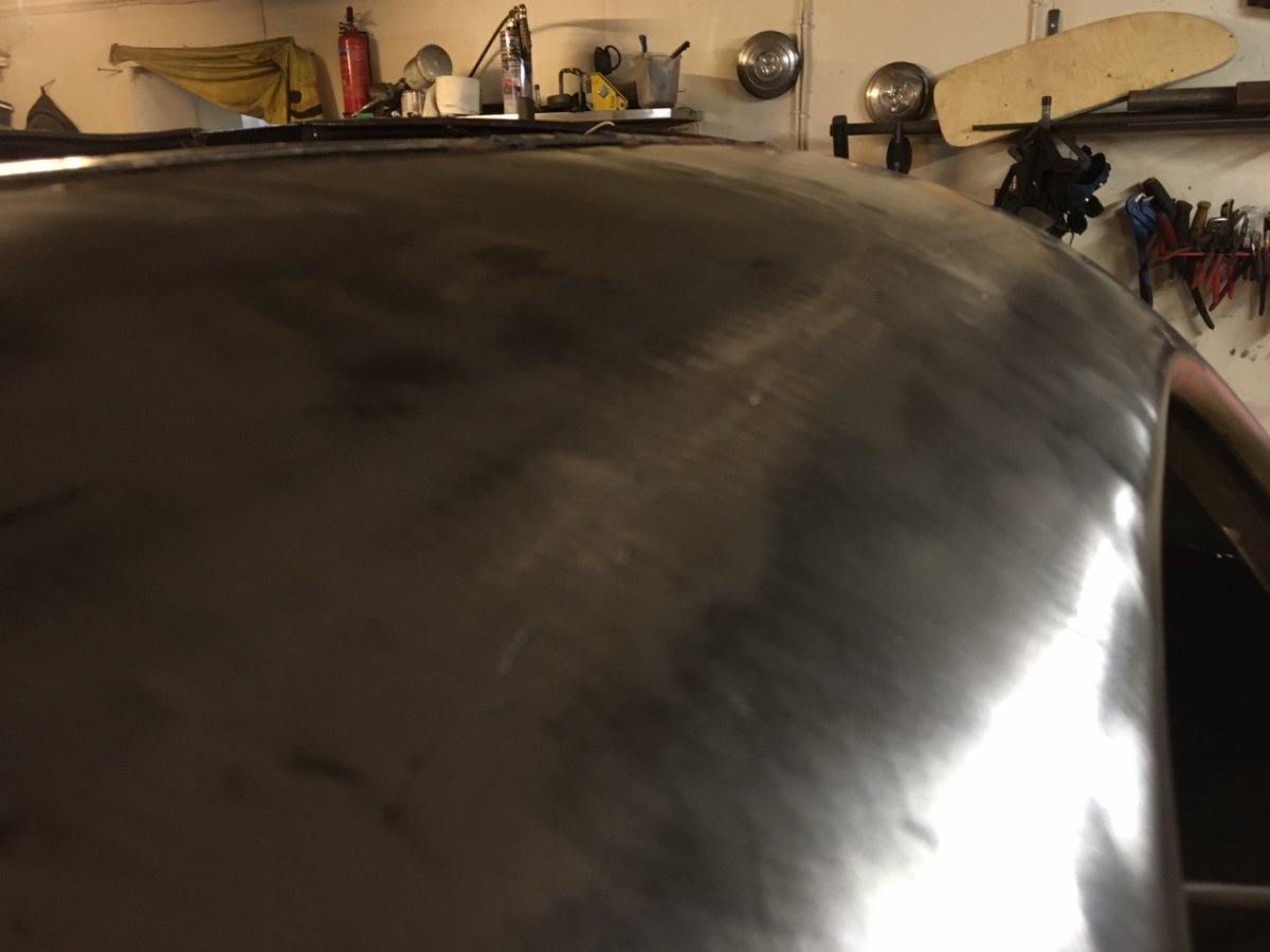

    from sweden

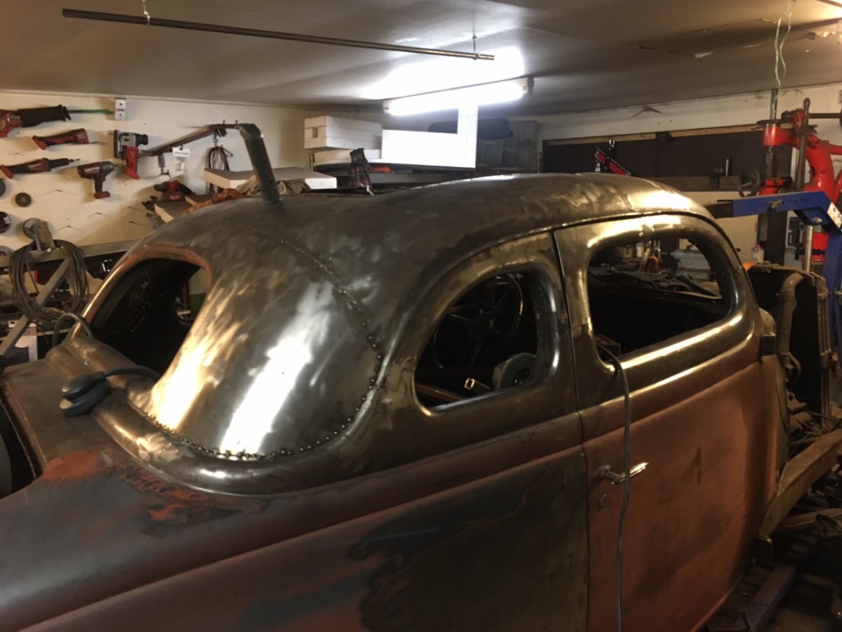

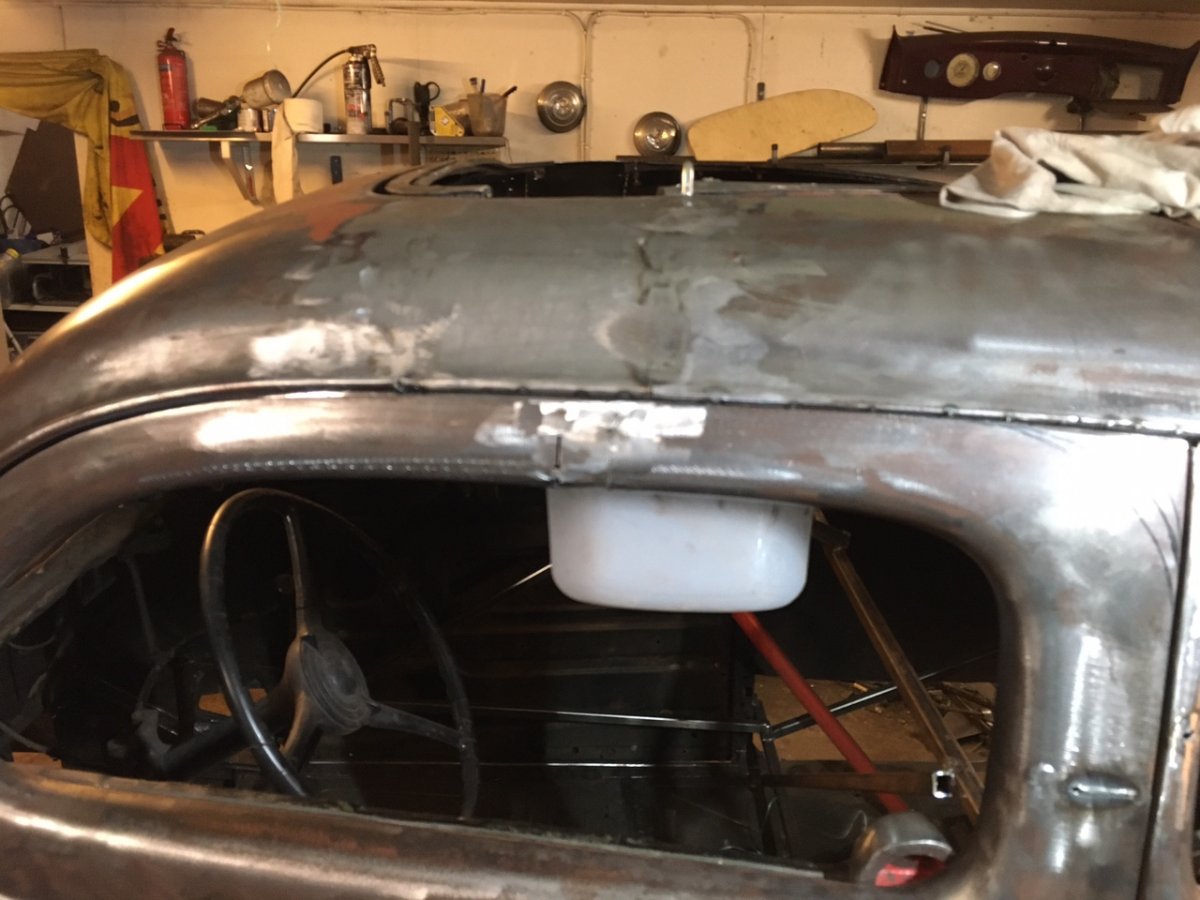

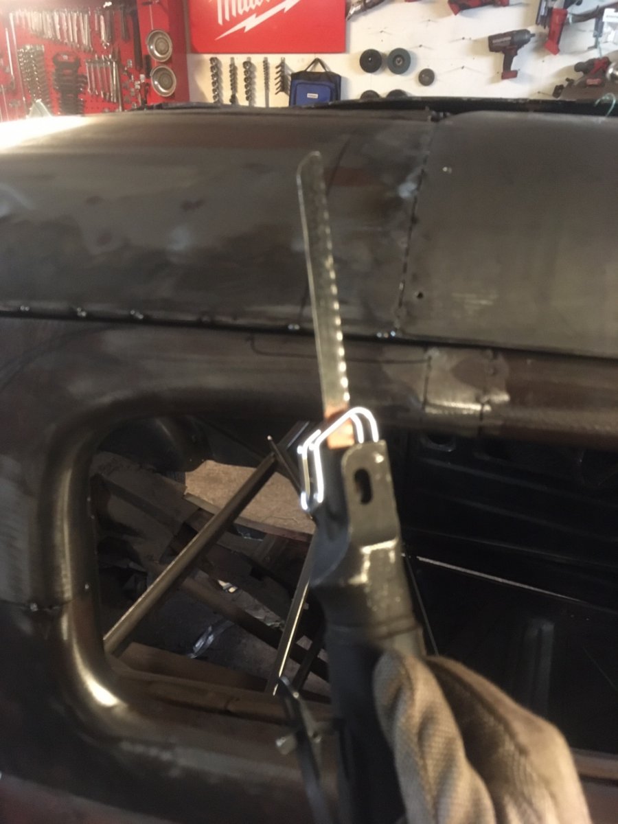

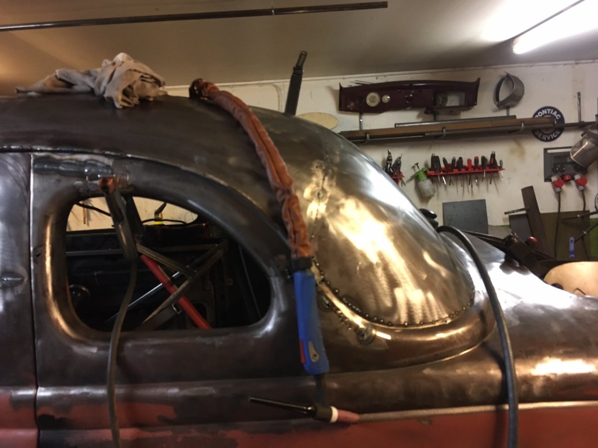

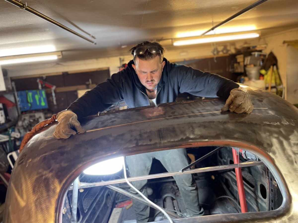

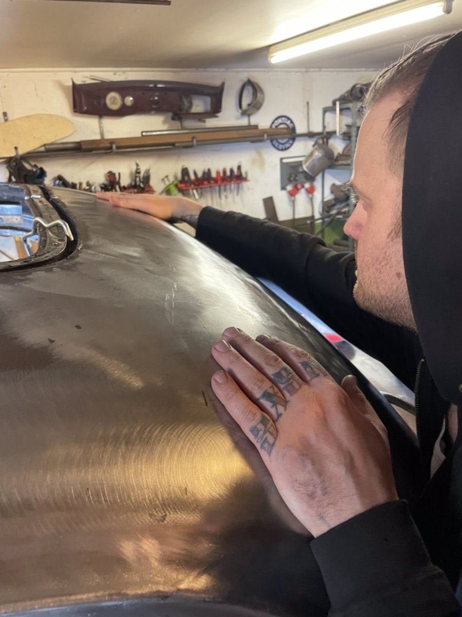

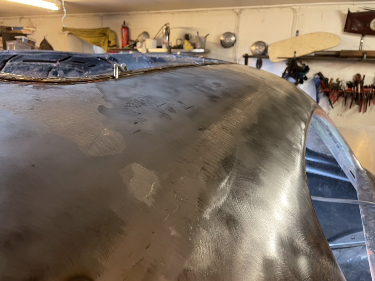

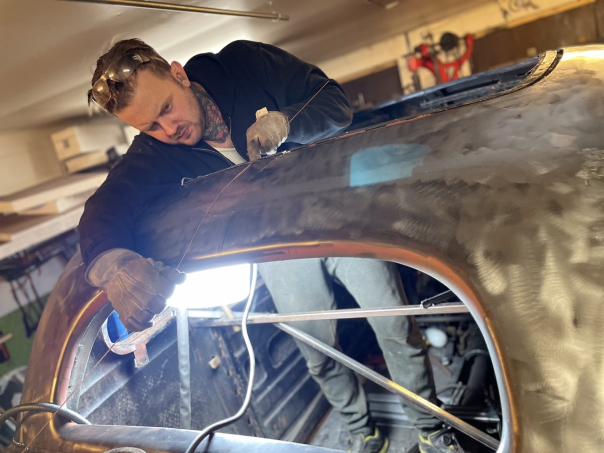

    Today I got the top of the roof finish welded, nothing too exciting to look at but this shit tests my patience which I don’t have a great deal of.
    I’m dragging a welding rod along the contour of t he roof to detect any low spots, before hammer and dollying.
    Turned out pretty good!
    Won’t need a lot of bondo to make this paint ready.
    I don’t know if I’m going to do any more updates until I have finished off the welding on the roof.
    Doesn’t seem too exciting to look at photos of that small a change.
    Skickat från min iPhone med H.A.M.B.

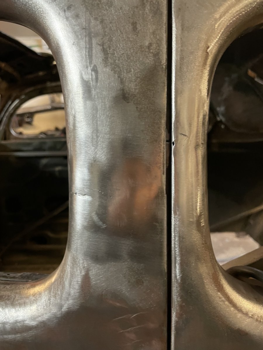

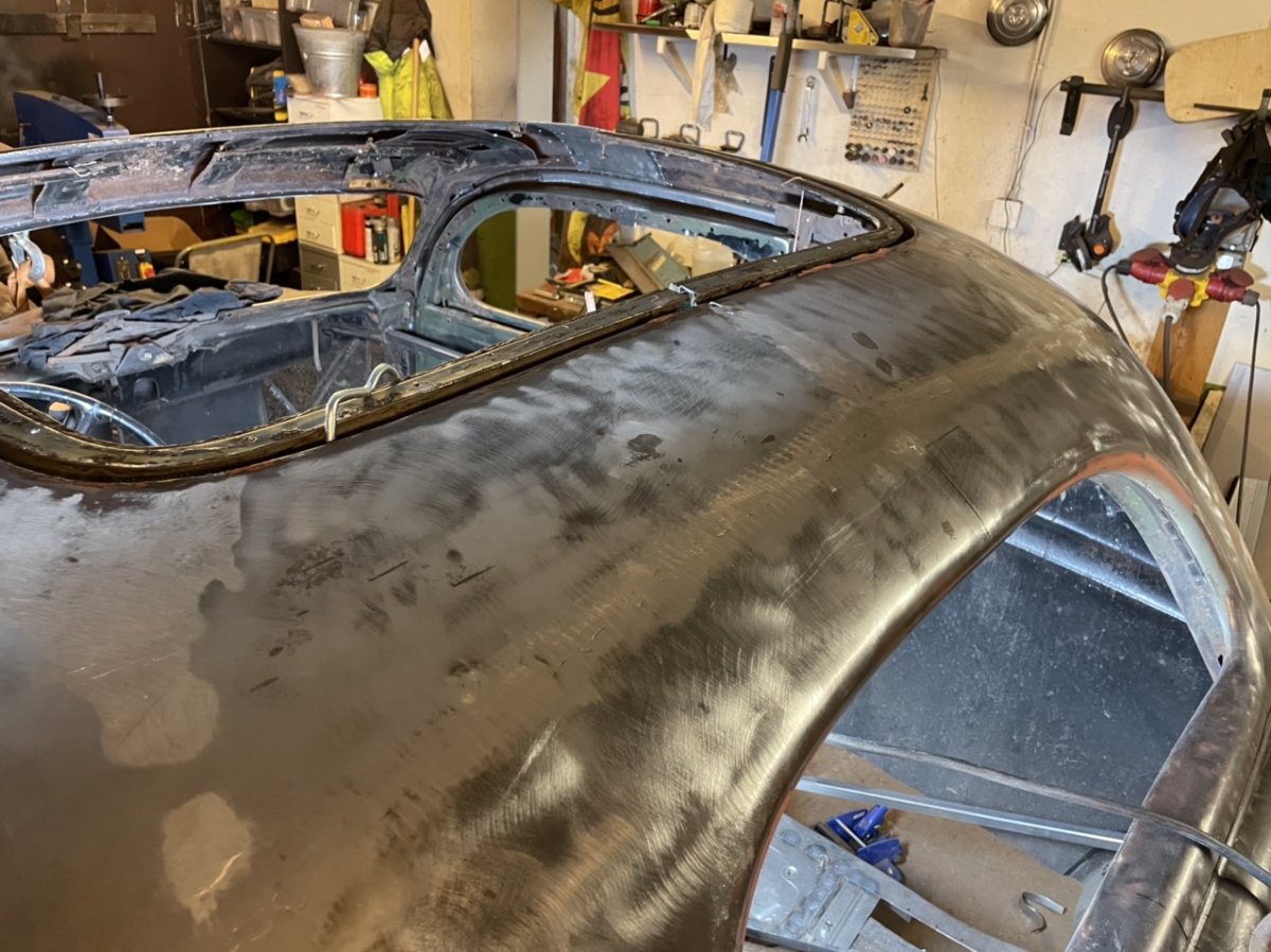

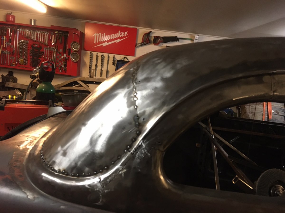

    Here’s some photos, it’s slow and tedious to finish weld all this but today I made some good progress.

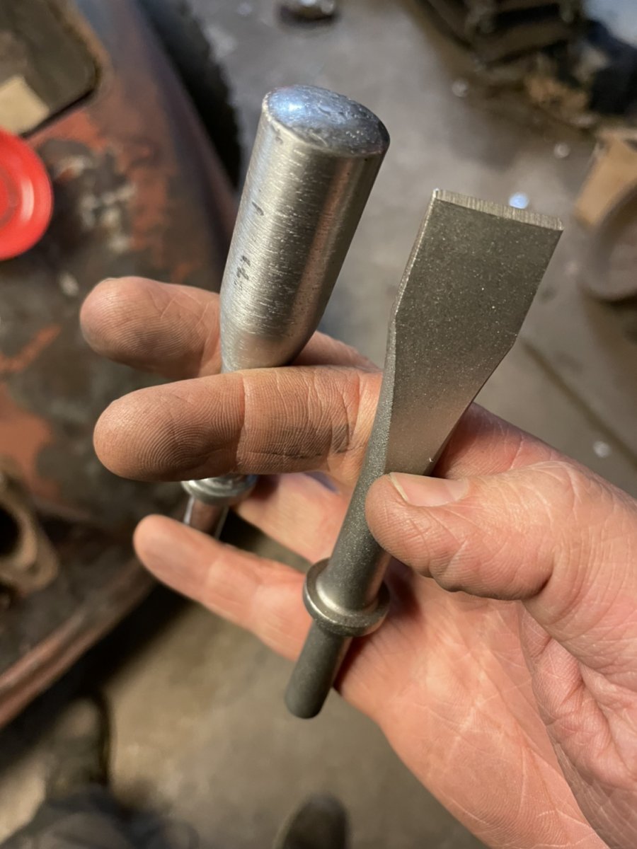

    I also had to make a tool today to be able to hammer in some hard to reach spots, so put a piece of round stock up in my lathe and turned this lil baby.
    Chisel for comparison.
    Worked pretty good.
