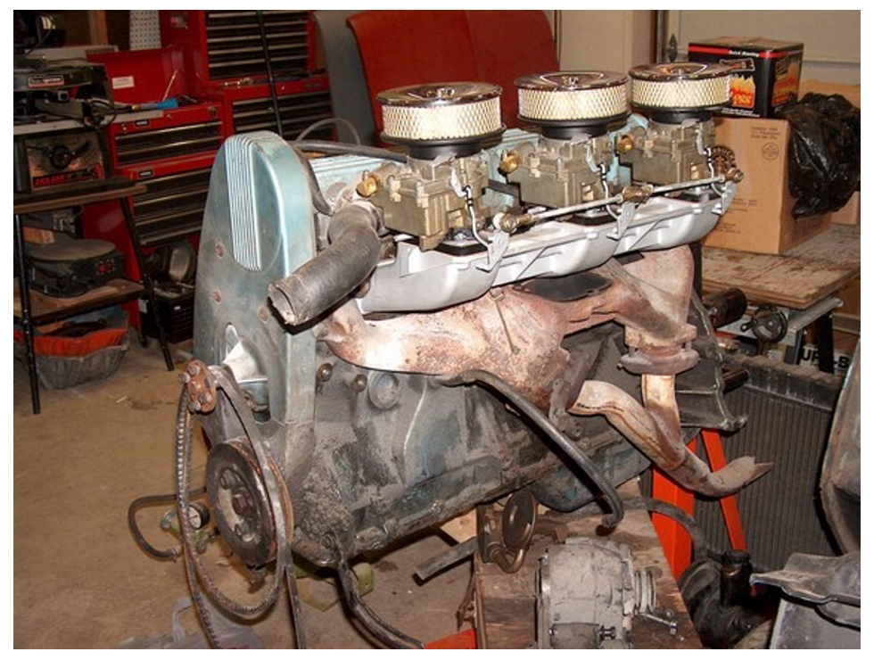

    -Pontiac OHC 6 with triple weber DCOEs

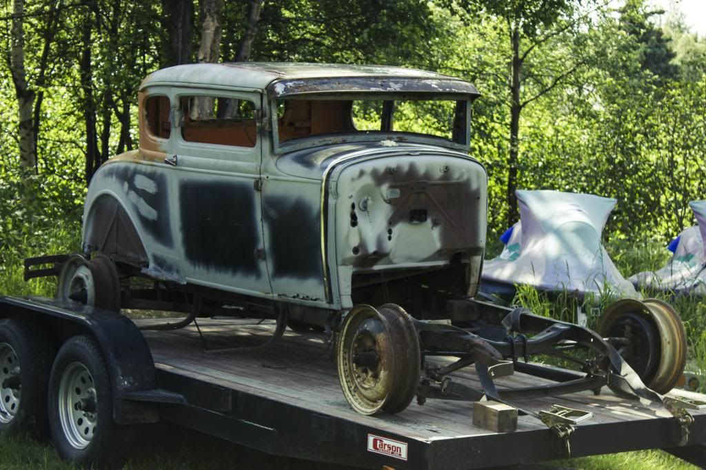

    So here's the story. I bought the car in fairbanks alaska and it appears to have been off the road since 1960. The title was signed over in 1969! Lets hope the DMV lets me keep that. The body has got a 5 inch chop started, needs to be finished up around the a and b pillars, they need to be pie'd and lined up. All the floors are a bit rotten, so those will have to be replaced, or new ones fabricated (can I get a bead roller in here?).
    The bit of this car that will be kind of the centerpiece is the inline 6 that will power it (or at least, is slated to). The motor I have a line on is from a '67 firebird non-sprint. I know, that's non-hambable but hey, people have jag suspension and mustang II suspension and stuff on here, so I figure, close enough. That plan for the engine is to balance the rotating assembly as precise as I can (probably have to have a machine shop do the crank). My goal is a "red line" at somewhere around 7500 rpm. I'd be happy with 300hp, preferably up high. So the plan is so far, triple webers (probably from pierce manifolds). I'll probably have to have a custom cam ground to get the revvy power band I want out of it, any one on here know anything about welding and grinding cams? The trouble is with this ohc stuff, you can't just lengthen a pushrod and call it a day... Also, I may or may not have to have the cam carrier machined out for a standard cam bearing. Stock these motors just have the cam ride against the bare aluminum (and oil, obviously! haha). Possibly having the head ported would do me well, and of course I'll need bigger/dual valve springs for the higher rpm. Hardened valve seats are probably in order as well. The good news is that the lower end will all cross over to chevy inline 6's, so forged rods, aluminum pistons, etc, are all available, as well as different cranks. I think the pistons may cross over into small block land as well. I'll probably run it at a higher compression ratio as well (probably 10:1 or 10.5:1? I think that's what the factory sprint motors were).
    Now! On to the good part.

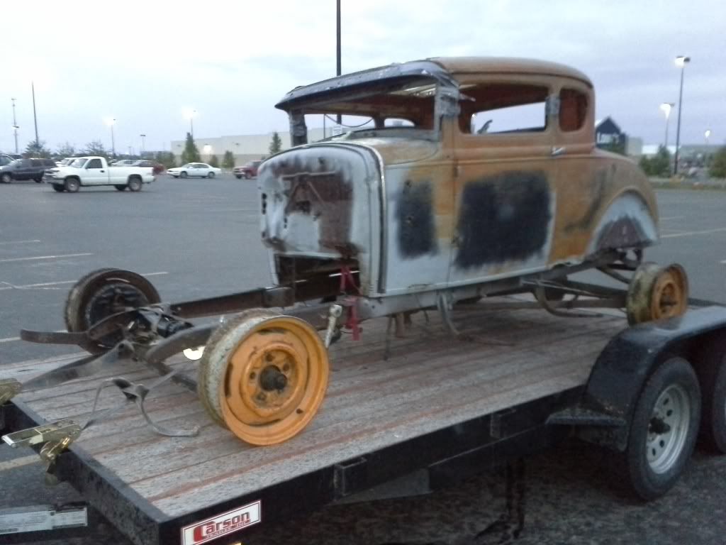

    The car on the trailer that towed it 360 miles home to anchorage. Oh and note the dent in the firewall, apparently it's a late '31 which is cool or something.

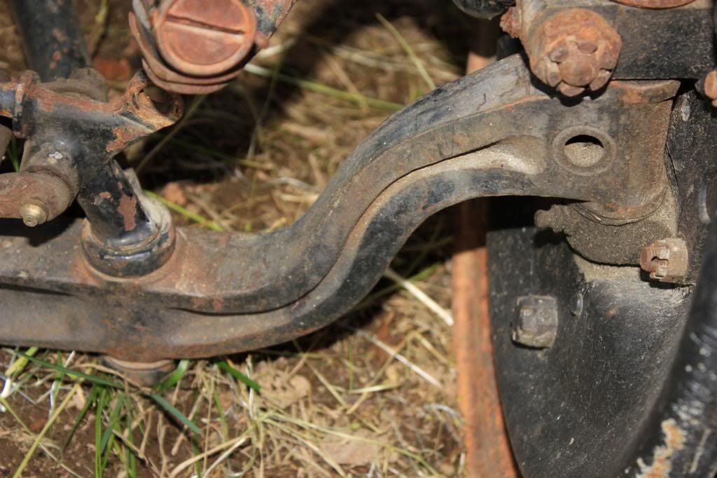

    'Nother shot of the front. You can see the genuine heated and dropped 'A axle up front. Really cool, what should I do? Keep it or not?

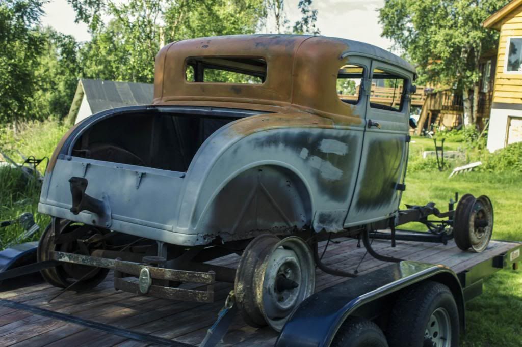

    Rear quartering shot. You can see rust all along the bottom of the thing, and up into the wheel wells. This is happening on both sides. Oh, and the caty-wompus stance is due to the rear spring being not bolted in! This was super legit on a 360 mile ride. I of course, cargo-strapped the spring to the crossmember.

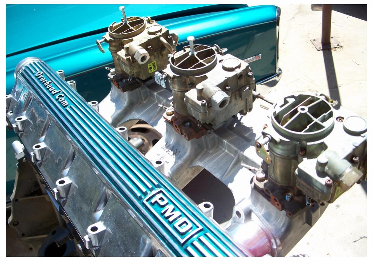

    Am I allowed another artsy fartsy shot? Well, either way you can see the stuff inside. An old seat and back, and the rumble seat decklid!

    The finished bit of the chop looks good. I'm told it has a bit of filler, but I'm not concerned. The welds look good from the back.
    Here you can see the issue I need to correct with the front posts. Any tips from the experts?

    Rust in the rear wheel well. This whole piece will probably be replaced.
    Similar rusts, other side.

  14. ty johnson
    Joined: Mar 16, 2006
    Posts: 597
    ty johnson
    Cool! Looks like a Dago axle, maybe not, but if it is that's cool by itself.
  15. Leviman
    Joined: Dec 11, 2012
    Posts: 201
    Leviman
    Woah! Hey, you're right. I did some googling and it looks like a power-hammer drop whatever it is. I'll take some close up pics of the drop. Any identifying marks that would identify it as being made by ed stewart?

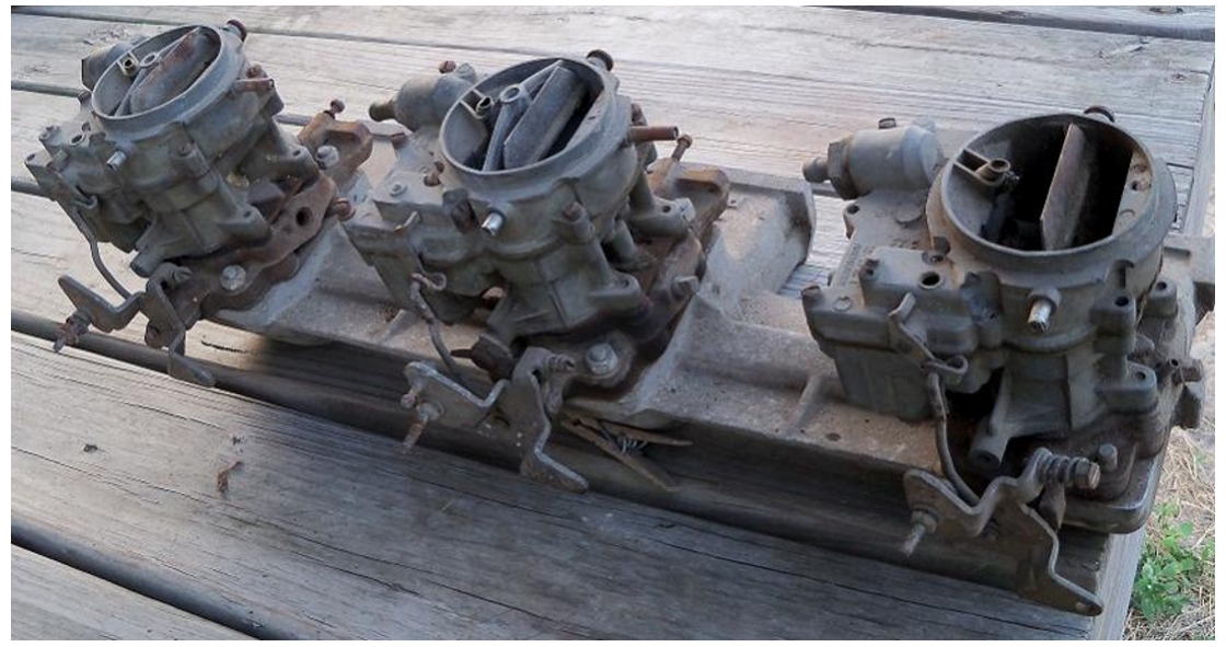

    Do you have the Weber carbs and
    manifolds for the OHC-6 yet? If not,
    another cool set up to look for too,
    that also works gangbusters on the
    OHC-6 is the old 'Man-A-Fre' 3-2bbl
    set up that uses 3 large-bore 2GC
    Rochesters. It's a 'semi-individual
    runner' design rather than a true
    I.R. set-up like the Weber set-up.
    Similar to a Weber set-up. other
    than a small connecting passage
    to facilitate idling, the Man-A-Fre
    manifold doesn't use a common
    plenum - but unlike a true I.R
    set-up, where one individual
    carb venturi serves one dedicated
    intake port, the Man-A-Fre manifold
    uses the two venturies of each carb to
    simultaneously feed a pair of intake
    ports. The manifold is long out of
    production, but the odd used one
    turns up from time to time. They
    work killer on the OHC-6 and the
    2GC Rochester carbs are easily
    junkyard source-able and they're
    also a whole lot cheaper and easier
    to rebuild and set up than the exotic,
    and albeit very cool, high-dollar
    Webers..

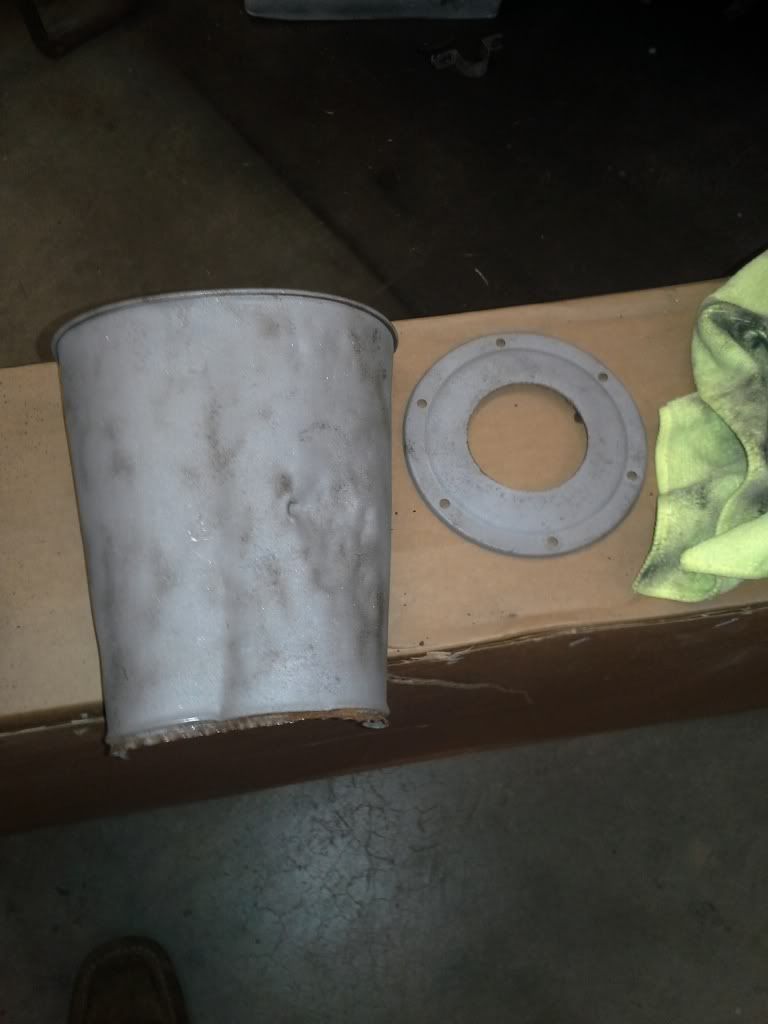

    Next, how do I get this dent out of the bell?
    Rip the bell apart! I called it bed time before diving into the hammering. So we'll have to see how I do on this. It'll be good practice for metal working. Screwing up the bell of the horn is much less important than screwing up the body IMO haha

    As for my car, here are a couple pics of the drop axle I've got. Any powerhammer axle gurus out there?

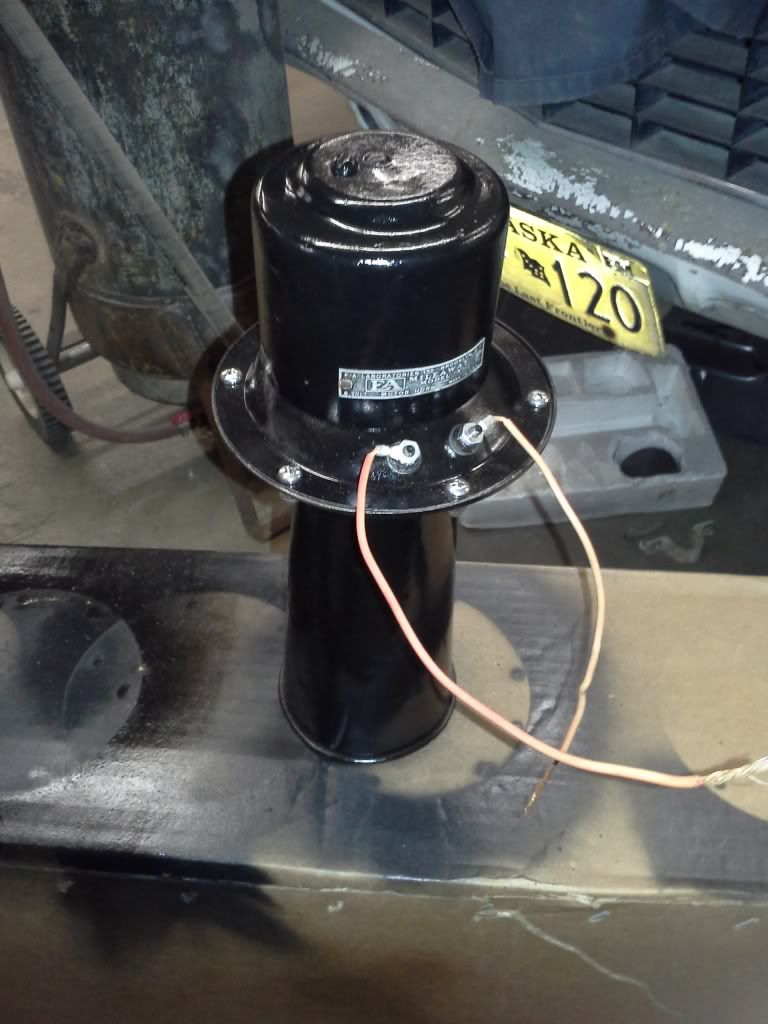

    Oh also, I got the ahoogah running. Here's a picture. It's certainly not perfect, but the general shape is there. I'll have to practice finishing out the fine hammer marks and such in this whole metal finishing shenanigans. Anyone want to show me how? haha
