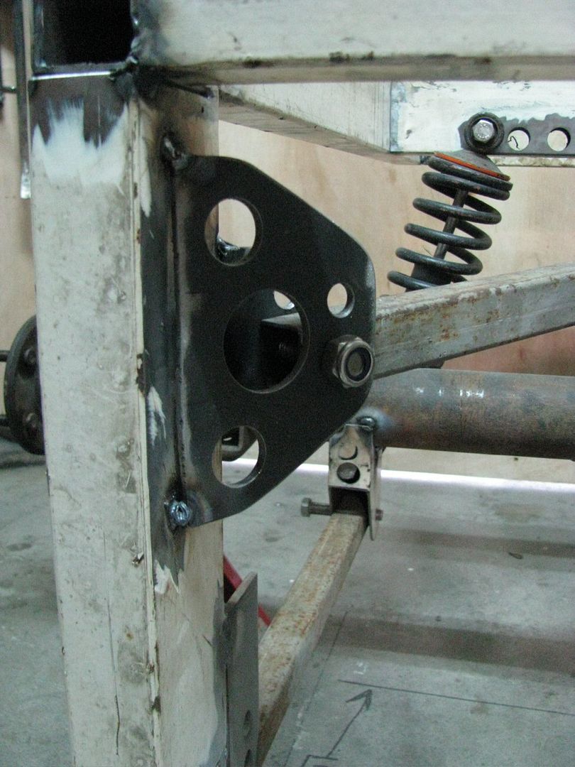

    Triangulated four bar in position, with temporary gash square tube links:
    A bit of diagonal stiffness added:

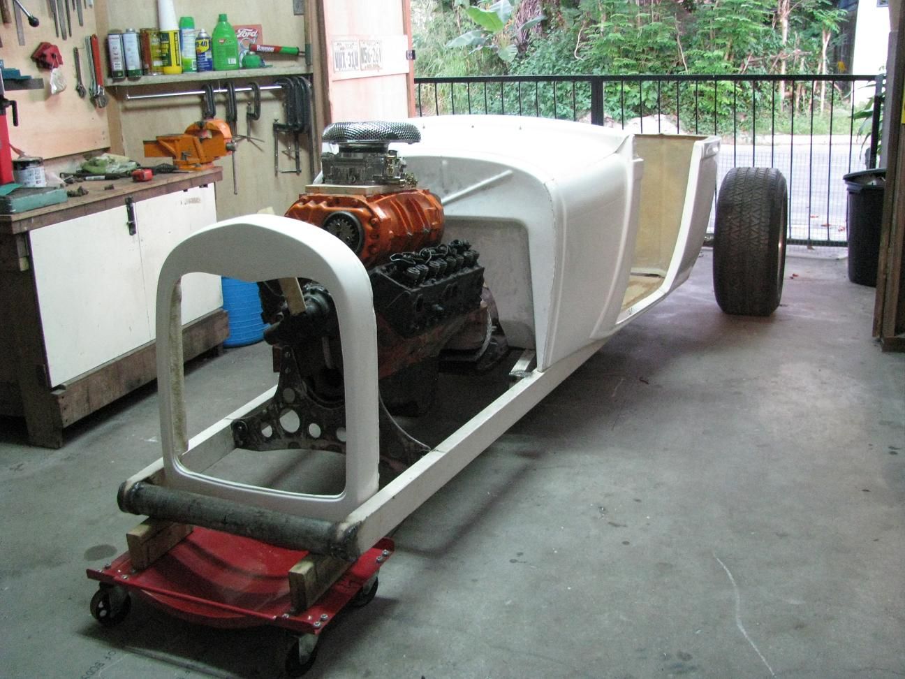

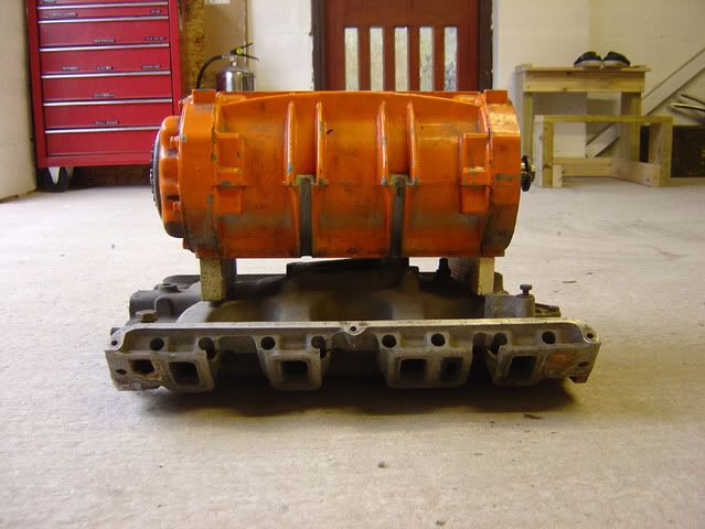

    I'm thinking about putting my 6v/71 blower on it, or probably just a Performer manifold and an Edelbrock 600 carb for now. I do fancy a blower, and it'd be fun making all the drive and stuff up.

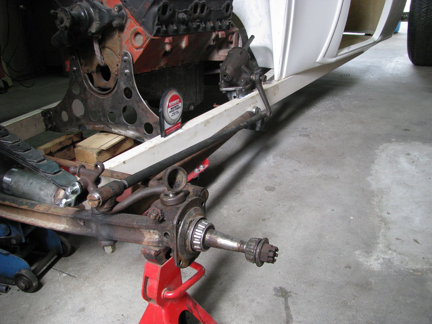

    Mounting the Corvair steering box, requires an angled oddball bracket, cut from 3/8 steel:
    The hole is so I can run a brake line, without ducking and weaving around the chassis rail.
    Looks like it'll work:
    Tacked in place, Pitman arm end lines up exactly with the hairpin end: good geometry. Clearances look a little tight between the various links, but at ride height it is all good. A little heating and tweaking of the steering arm may be required, but not much.

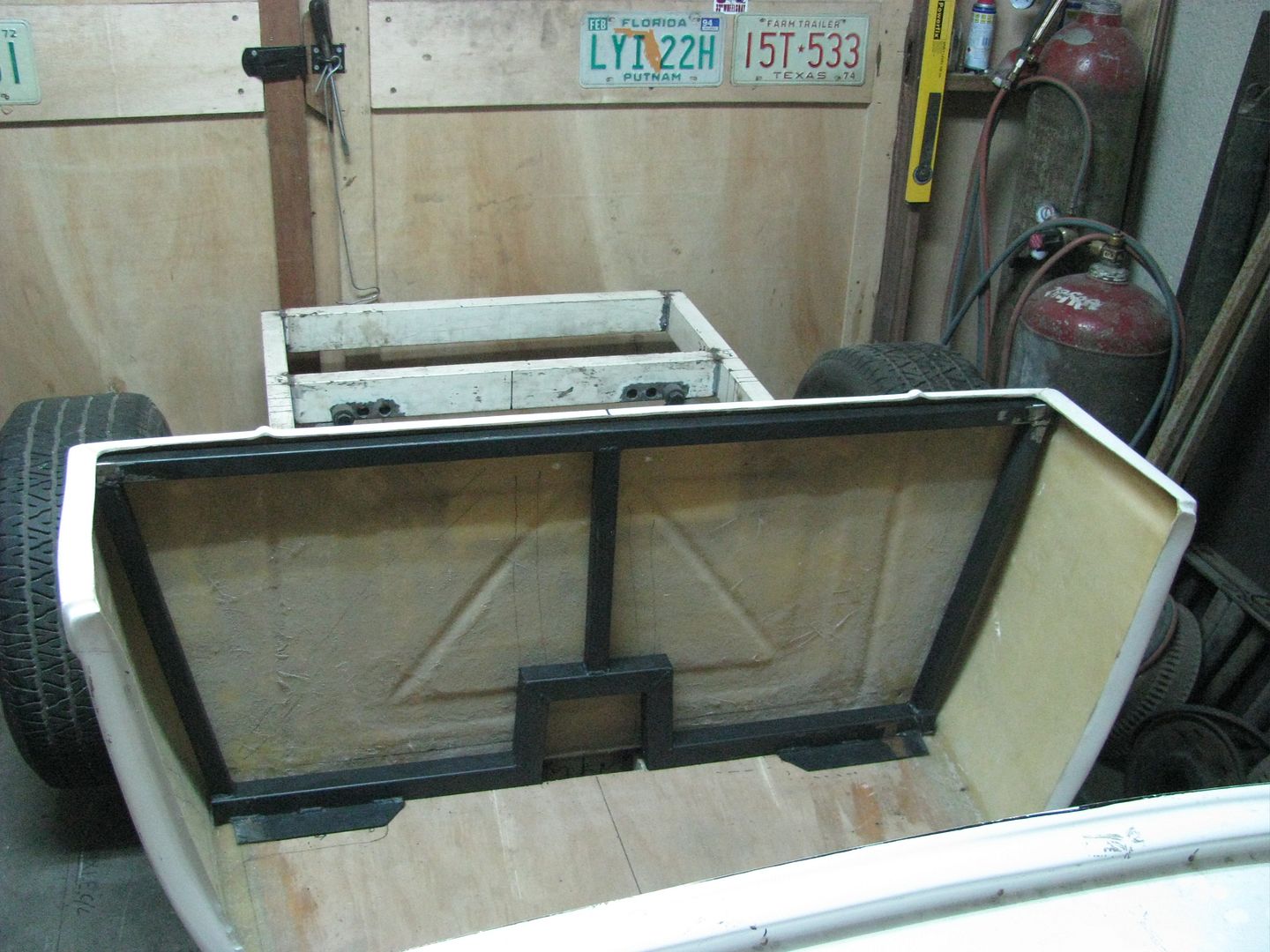

    I've made up a steel tube sub frame to go inside the glass body, to stiffen it up, give a little collision protection, allow seat belt mounts etc. It was welded solid in three sections, outside the car, then installed and fully welded together in place. Some more crosspieces were added where the dash will eventually go, to tie the front together.
    Back half went in first.
    I'll glass it in place, and if I can find some of that squirt-in expanding foam I'll use it to bond and goo it all solid inside the glass.
    The square 'cut out' at the rear is for the prop shaft tunnel to go.

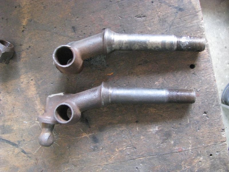

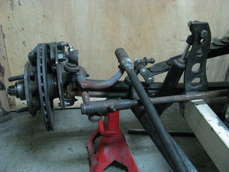

    I decided to use all the old Model A joints for the steering, no idea what they are called, so I had to bend a few levers and extend the drag link, make a pitman arm etc.
    I needed the Model A bottom ball and the Corvair top spline , so some cutting and grinding and welding was required, then some bending to line it all up. I ground it all smooth and checked the welds, then cut and welded a plate that follows the rear of the arm, top to bottom, welded fully around, strong and discrete. The bits in the background are the redundant ends. I forgot to take pics of the finished item, but it should be good 'n strong.
    Bit of heat to coax it into shape.
    Steering arms needed raising a touch to clear things. Mr gas Axe assisted most ably here. :)
    Bit crowded in here, but it all clears. That welding on the drag link looks awful in photos, but not too bad in the flesh. :? I keyhole welded the extension tubes on in a couple of places, as the drag link was solid 5/8 bar and I used seamless 'pressure tube' to stretch it.
    All the bolts holding the dampers etc are just temporary mock-up stuff, as are the wheel 'studs'.
    Some details of the front end:
    I found an 'auto surplus' yard locally that let me dig around and I dragged away a pair of complete front of hubs of something apparently called an L300, some sort of Mitsibishi people carrier.
    I made up a caliper bracket, got the caliper hung, but I still need a couple of adaptor sleeves making to sort the bearings out. I made the mistake of buying bearings to fit the spindle before I bought the hubs, as I originally intended to make the hubs to suit, as I (thought) I had suitable Corolla discs and calipers, but it turned out they were not a matching pair. I got ripped off....
    Oddly enough, the hubs have Ford stud pattern, but strangely I have Chevy pattern wheels for the front, and Ford for the rear end. I might just swap them for something that fits straight on, Ford all round, save more engineering.
    The top extra area is for when I mount some cycle fenders and will be cut and shut to suit. Gotta think ahead. :D
    The whole plot fits quite deeply into the wheel, and I'll make some sort of ally old-timey vented cover for it one day, maybe...
    Just lashed into place with some washers and spacers, to set disc clearance.
    Finally rolled it out into the warm sun for the first time today. :D

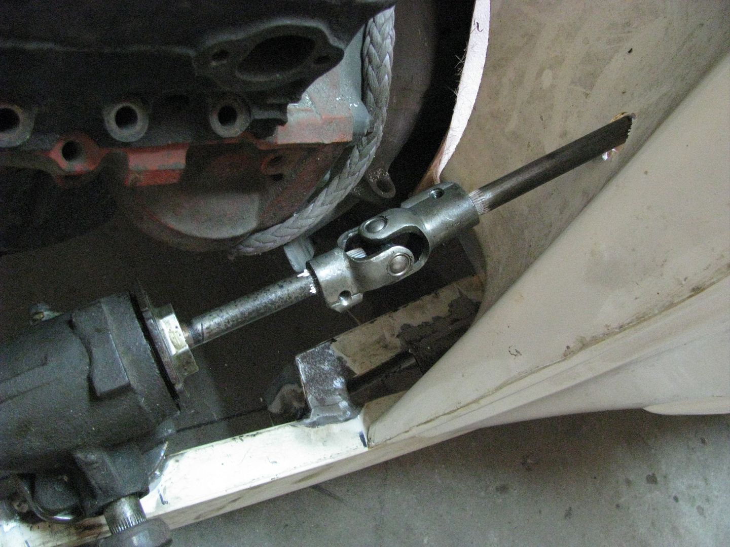

    I got the steering column and Corvair steering spindle splined to suit a Jap U/J, to save messing about welding something onto either shaft.

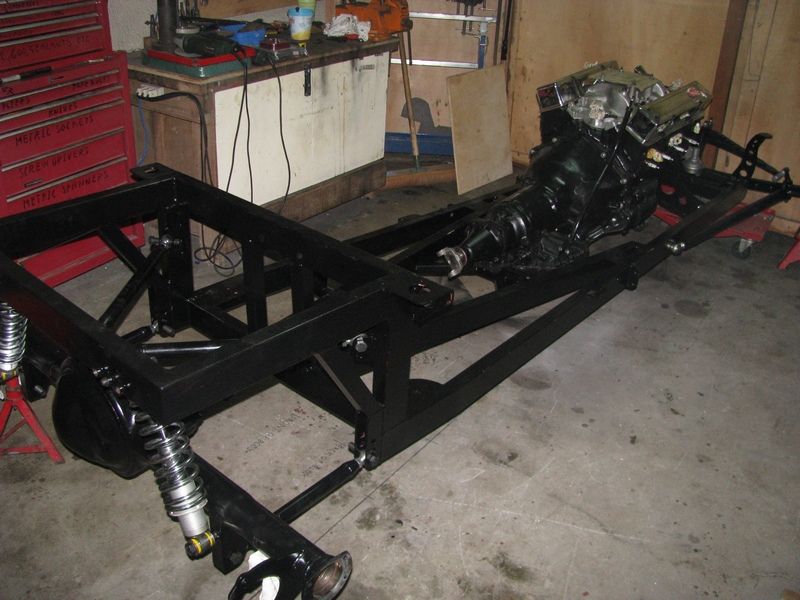

    Blagged the motor and trans off my mate, stuck them together, can't wait to get it bolted in place:
    The shed is getting no bigger either, with all these parts kicking around:

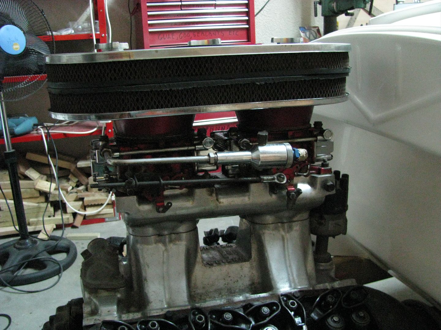

    cool build I like the high rise intake over the blower

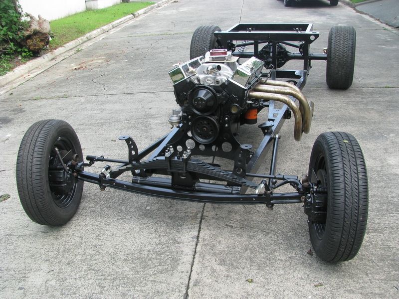

    I started bolting stuff together yesterday:
    Bit of a problem, the steering cross link just touches the headlight brackets on full lock, so something needs to be fiddled with there, maybe less steering lock.
    And I think I'll modify the wheels to give less offset, bring them together a bit more. Just need to cut out four welds to release the centres, and hopefully tap them over 1 1/2" and re-weld, but I doubt it will be so easy......
    I need some rear axle bearings, so I can get the back end all together and wheels on.
    Something that has always confused me a bit, but with the hairpins swinging an arc, the leaf spring going up and down at some angle different to the hairpins, steering, and movement all around, how can you tell whether the spring is binding or moving freely within the shackles?
    So, I decided to fire up my trusty drill lathe and remove the shoulders on half of the shackle bushes, so when it is all assembled and loaded up I can visually see whether my hair pin length is adjusted to put the axe in line with the spring. I assembled it, bounced on the suspension a few times, and the spring 'walked along to one end. A tweak on each hairpin rose joint, bounce again, and it is dead centre.
    Yeah, I'm a sad man. :D

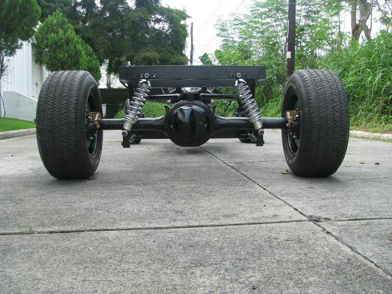

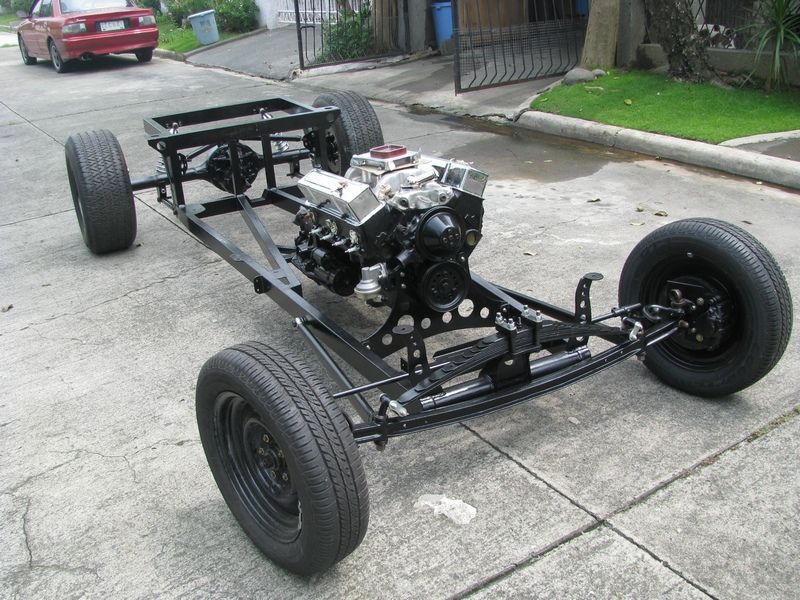

    Sun was out yesterday, so I fitted the back axles/wheels in place, and rolled it out into the sun whilst I cleaned out the shed.
    Threw one side of the headers on for a look see.
    Going to start work on the body again on the morrow. :D
