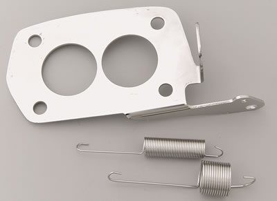

    I had 3x2 set up with a 700r4. I used Rochester carbs. I used a rear carb bracket Lokar trp-4003. You have to use a stainless steel TV cable and just hook it to the center carb and adjust it to the setting your transmission needs and that's it.

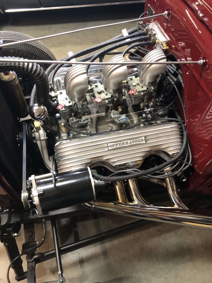

    Maybe this will help the picture shows the geometry but mine was backwards from this setup since my gas pedal pulls the center linkage from the bottom towards the firewall instead of the other way around like th picture but will help you get the idea.
