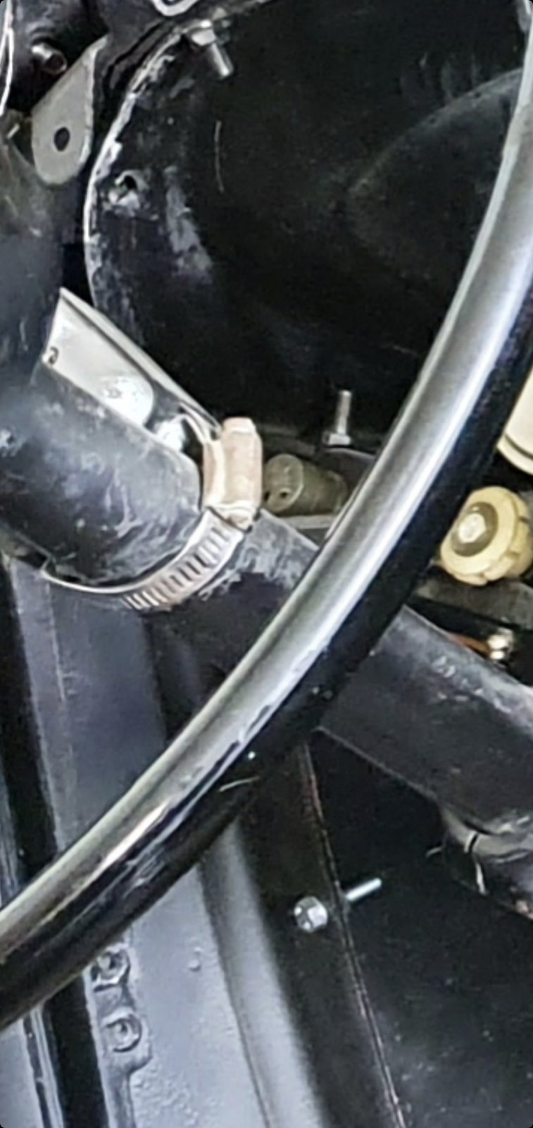

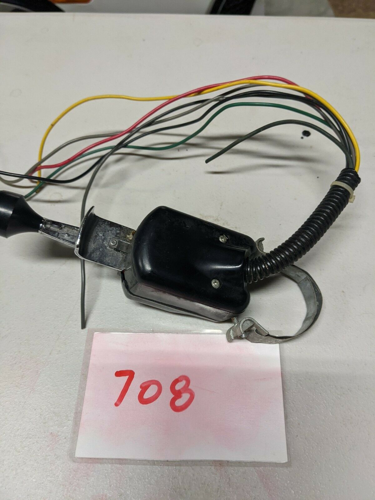

  1. This should be really easy but I'm not seeing it. How do you mount a SignalStat turn signal switch on a skinny steering column?
    If I mount the switch hugging the curve of the column, it crushes the wire bundle. Look like the bundle is aimed to go into a hole in the side of the steering column but on a 1941 Ford or other very old car, that's not going to work. On the other hand, the curvature of the SignalStat looks like it's made to fit a skinny steering column.
    I could just take off the back cover and cut a bigger hole in it to run the wires perpendicular from the switch down the length of the column. Wouldn't be hard. Doesn't seem quite right though having to cut a hole in the cover.
    Am I missing something? What are you doing with wire bundle on your retro-fit turn signal switch?

    maybe if you remove that ugly black plastic crap, and form the wires to fit next to the column, then tape them up, it might work?

  4. Thought about that, even without the wrap still seems to crush the wires. Agree with your assessment though about "that ugly black plastic crap." I'll look at it again.

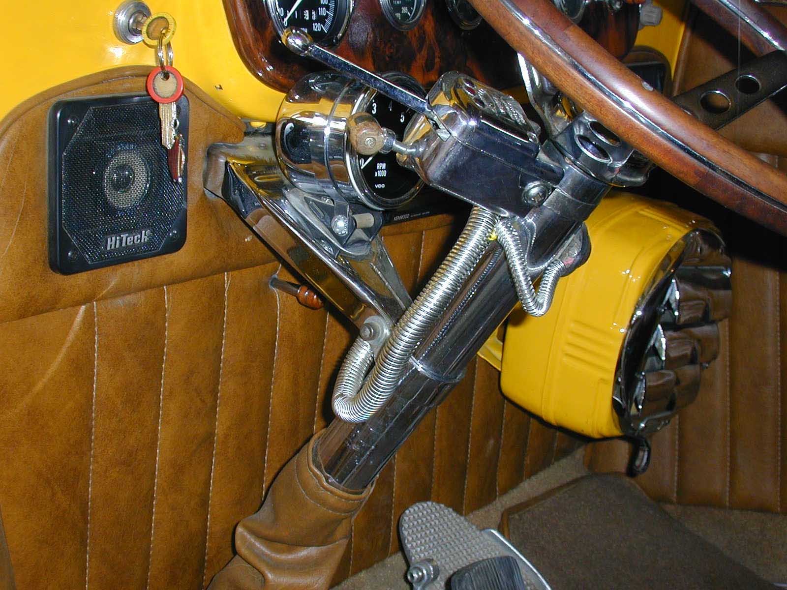

  11. I modified my stock '36 Willys steering column and used one of those signals. The factory column has composition bushings in a thin tube. I machined out a heavy water pipe to accept ball bearings suppoeting the stock shaft. Had to modify the stock braclet to fit the larger tube too. Worm clamp works fine. I used chrome plated flex loom.

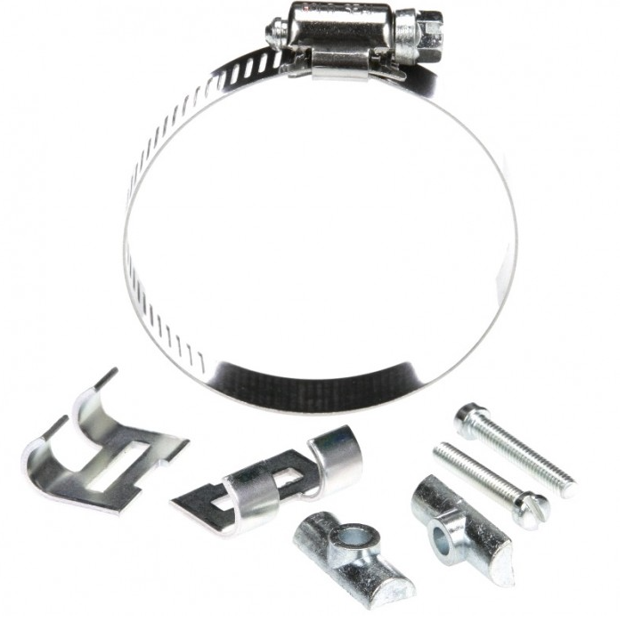

    Here are the instuctions for the Signal Stat :
    Put a turn signal switch (HOSE CLAMP STYLE) in this summer with the help of a friend. First thing was removed plastic wire loom, and put an asphalt loom on instead. Here it is installed in my '47 Plymouth. Used a Harley Davidson clutch cable clamp to hold the wires down the column.

    With that
    • Truck-Lite Part No.: 9190 part number for the kit that TRRodder showed above you should be able to walk into a lot of semi truck parts counters and buy or order the kit.
    • There is usually an independent semi truck parts house in most cities of any size and at some truck stops with shops.

    View attachment 5238984 View attachment 5238984 you can also cut a hose clamp in two amd to the required length. punch a hole into them and screw both parts to the signal stat instead of the original clamping mechanism which might be tricky on a skinny column.
    plus you can add a ground cable between clamp an switch
    after that just use the clamp to mount it. that's what i did..
    concerning your cable problem you could maybe unbolt the rear cover and file it open to get more cable room or remove the plastic shield and just tape the cables as it was on the old ones

  26. You're right. Unbolting the rear cover and 'file it open to get more cable room' is the answer. Thanks to the people who've replied, I can see some covers are different than mine.
    Thanks, I do have these parts. One of the replies mentioned a "bracket" so I thought there was something else.
    Enlarging the opening is the easy answer. It's only a few minutes work.
