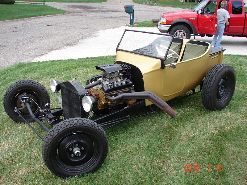

  1. I have been running a set on the front of my t-bucket since day one. Mounted on a set of 16" s-10 spare steel wheels. The motorcycle shop that i baught the tires from mounted them and another better shop balanced the whole assembly (wheel, hub, disk). Most tire shops didnt want anything to do with it. Run great. Know better than to turn hard in rain. After all these years they are starting to show some wear and haven't had any problem with air leaks. Not running any tubes. Went this route since i couldn't afford bias all around and couldn't find narrow enough 16" radials for a 4" wheel.
