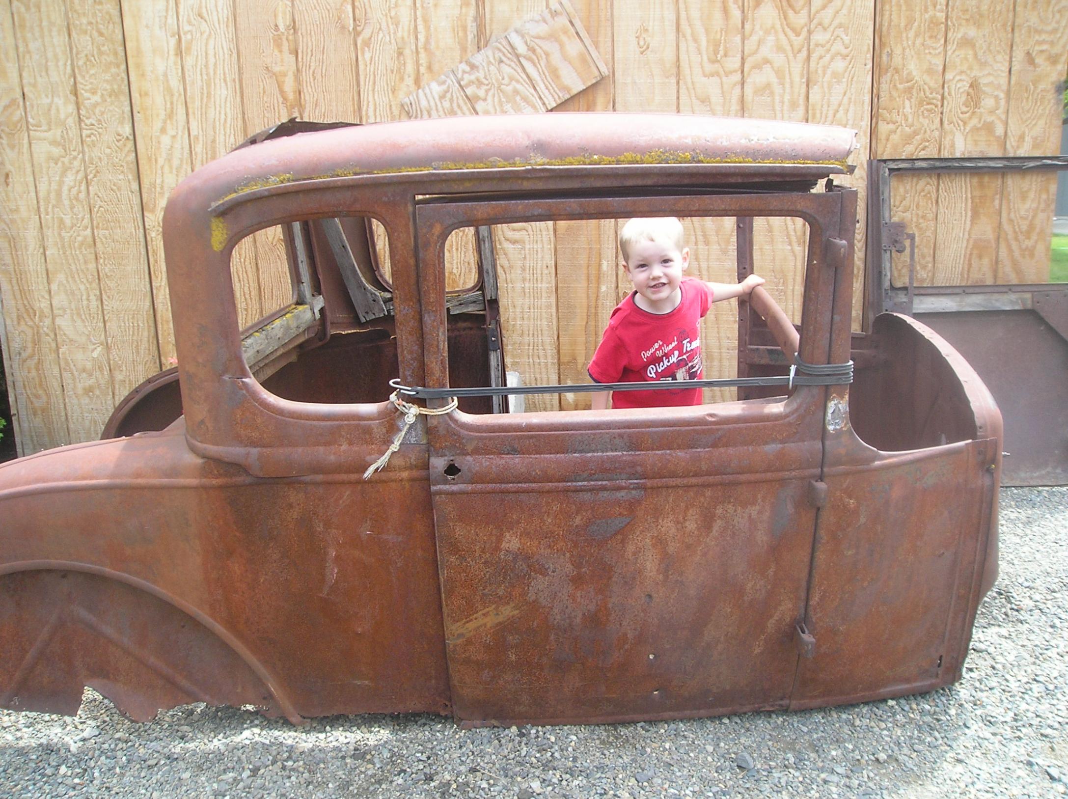

    Well, the drive and the night of tearing up Missoula left me with a bit of a cold.. so I've only managed to take a few more photos.
    I think my first step will be to build a dolly so that I can move it in and out of the shed to work on it without stressing the pannels any more.
    I'm looking to build a very simple period correct little A v8. Something we can bum around in and maybe..just maybe take to the local strip on a weekend or two each year. I'm awfully new to this, so I've been reading Bishop and Tardel's book, Ron Bishops text on flatheads, Tex Smiths book on chopping and watching David Gardner's dvd on metal shapping over and over. For the last month or so I've also been practicing my sheet metal welding with the oxy-acet torch. Hopefully those things, in addtion to reading everything on this board will prevent me from screwing things up beyond repair.
    anyway, I'm thinking a highboy on an A frame steped a little in the back with a drop axel in the front. I like fairly hard chops (e.g., the Green Grenade) but I don't want it too look like a r** rod either, so I'd have to make sure it looked right. I imagine a wide fives and a 48-53 flathead. No red rims, no flat black, no roof fill. I'm pretty much open for suggestions after that.
    the body has some obvious issues, but also some good points. I think I got a fair deal for what I paid.
    the good: both cowl pannels are solid with the lower bead intact. The rear quarter ends are in good shape too. The firewall look fair, except where someone stick welded the hood support brackets on.
    the bad: the front cowl brace is snapped on the passenger side, and there are some helacious stress cracks under the rear bead line that I'll need to figure out how to weld up. the rear subframe is missing, and the someone bent up the door pretty bad..look like they were pulling the window regulator out.
    I have another front brace I can use, and a good tank..thats about it.
    If there's interest, I'll post more when I have some progress to show.

    I am thinking the quarter window and upper quarter got hit, and then the car was still being used as a truck on a farm. All the stress from kinked metal caused it to crack from driving vibrations.
    You need to straighten all the upper and lower damage first, before welding. You may need to relieve the buckled up moulding area with a torch, just to de-stress it.

    You're probably right. The passenger side rear quarter is dented in and the rear window has dammage that could have occured at the same time. the missing rear subrails no doubt made things worse. I need to get it secured as there is very little structural strength in the rear. I cant move the body without stressing those cracks (both sides). I wont be tacking anything until its square. I dont know about releaving the stress with a torch..wouldn't that just shrink the area more, increasing the pull on the stressed area?

    I mentioned that because after you fixed the dents at the window and dents below the beltline, the beaded moulding might not want to go back in the right spot when cold.
    Another thing is that the metal edges right at the cracks is likely stretched a bit right now, and even if you have to heat to bend it back, you may have to trim a bit with a cut-off tool.....mainly because the metal just won't fit back together.
    Whenever you have a vibration stress crack like from a bumped fender that eventually cracks at the bead, the areas right at the crack seems to be stretched. Most times a slight cut-off wheel slice through the fender crack allows the fender to look good after welding. If you did not trim first, the extra metal makes the curve of the fender to be wrong.

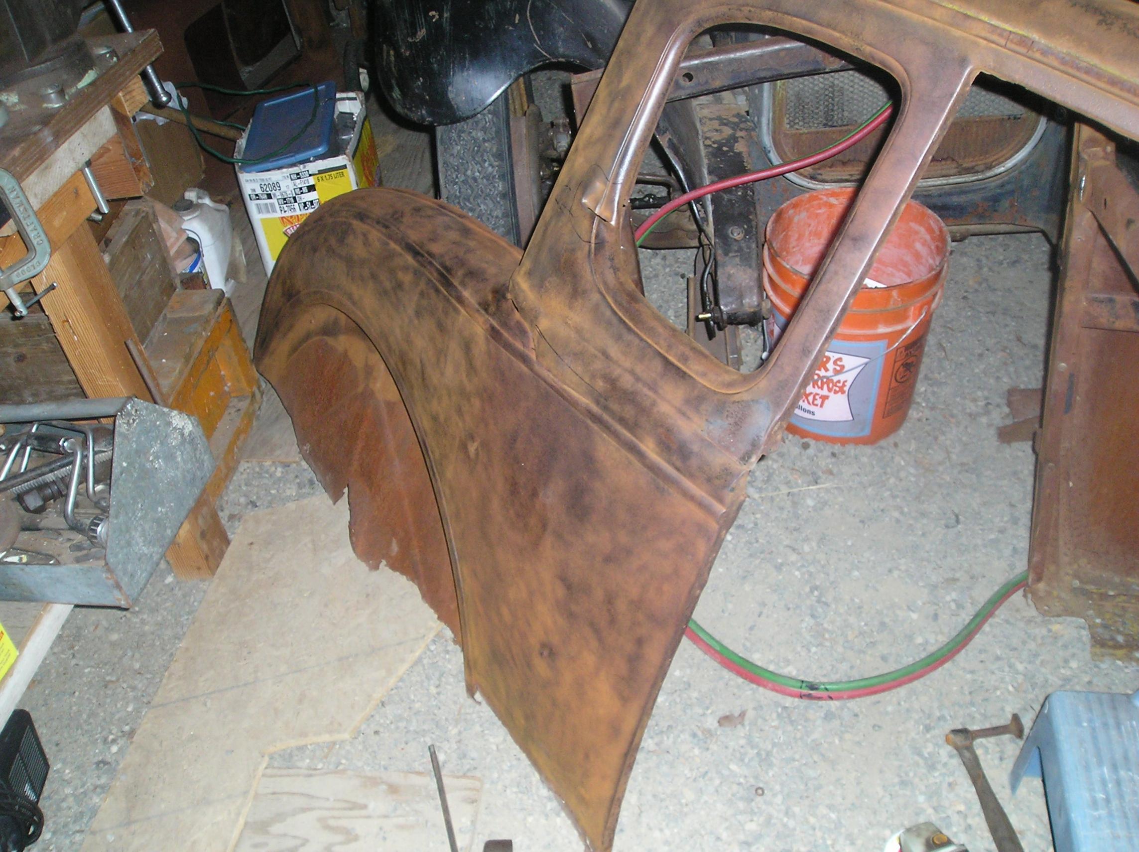

    Tonight I went out to continue stitching the rear quarters back together. I pulled out the passenger side quarter and sat it down where I could straddle it and work some of the major dents out. I was pretty happy with the progress until I looked down and discovered that I'd laid it across my gas hoses. The sharp edge of the lower panel sliced right into them. One step forward, two steps back. damn it.

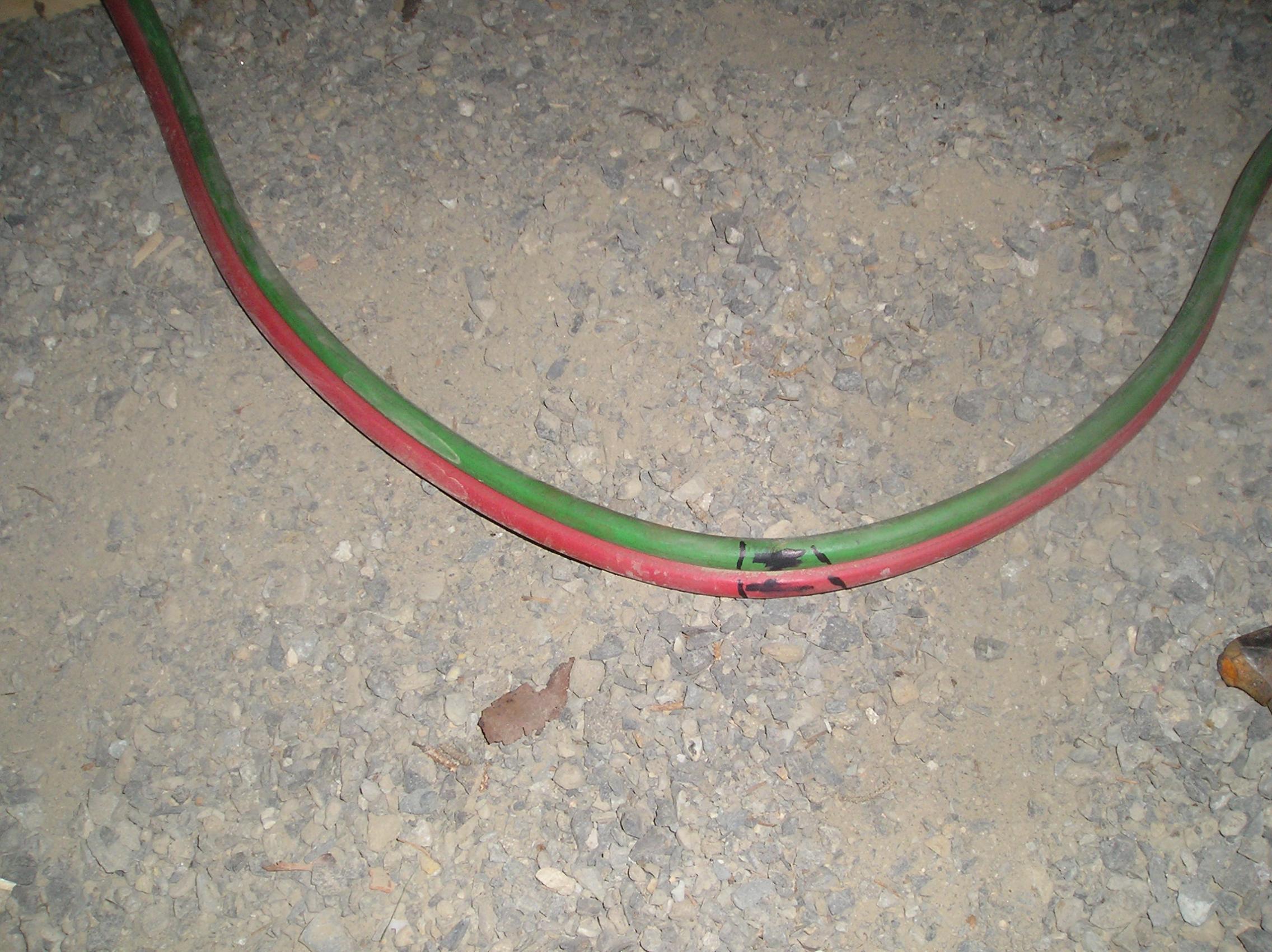

    That's just collateral damage brutha.... expect it in the shop when you're working with rusty ford parts!! :D
    I used the torch to cut some parts apart and the slag rolled under my air hose and burned it all up. air blowin everywhere!! :)

    Better an empty gas line then my toe or something I suppose :)

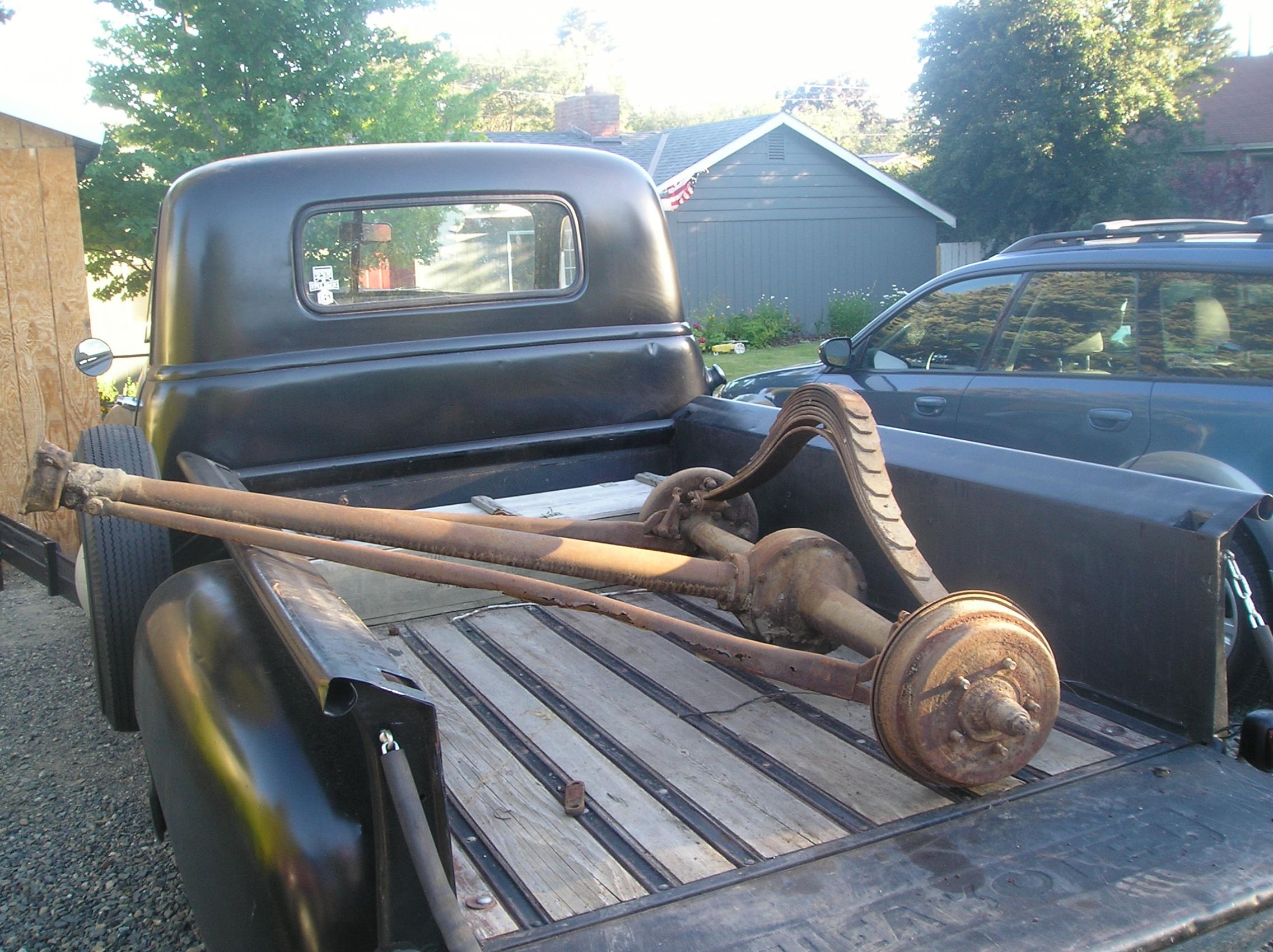

    Picked up a rolling chassie yesterday. Good frame, front axel and front wishbone. I'm hoping to split the wishbone myself, and have the front axel dropped. I've read that using a T rear spring will bring the back down a bit, so I suppose the banjo and A spring pack will find a new home.

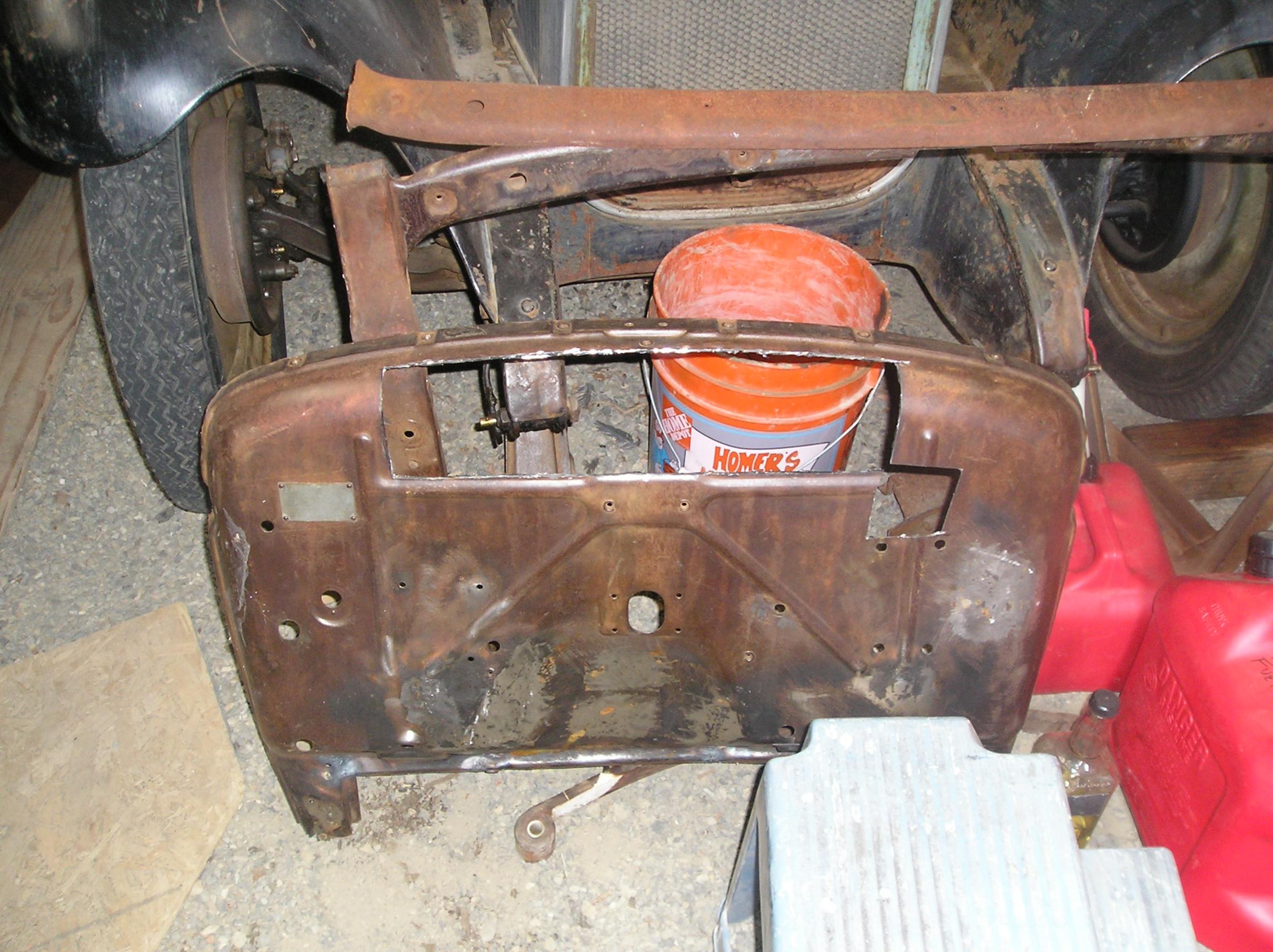

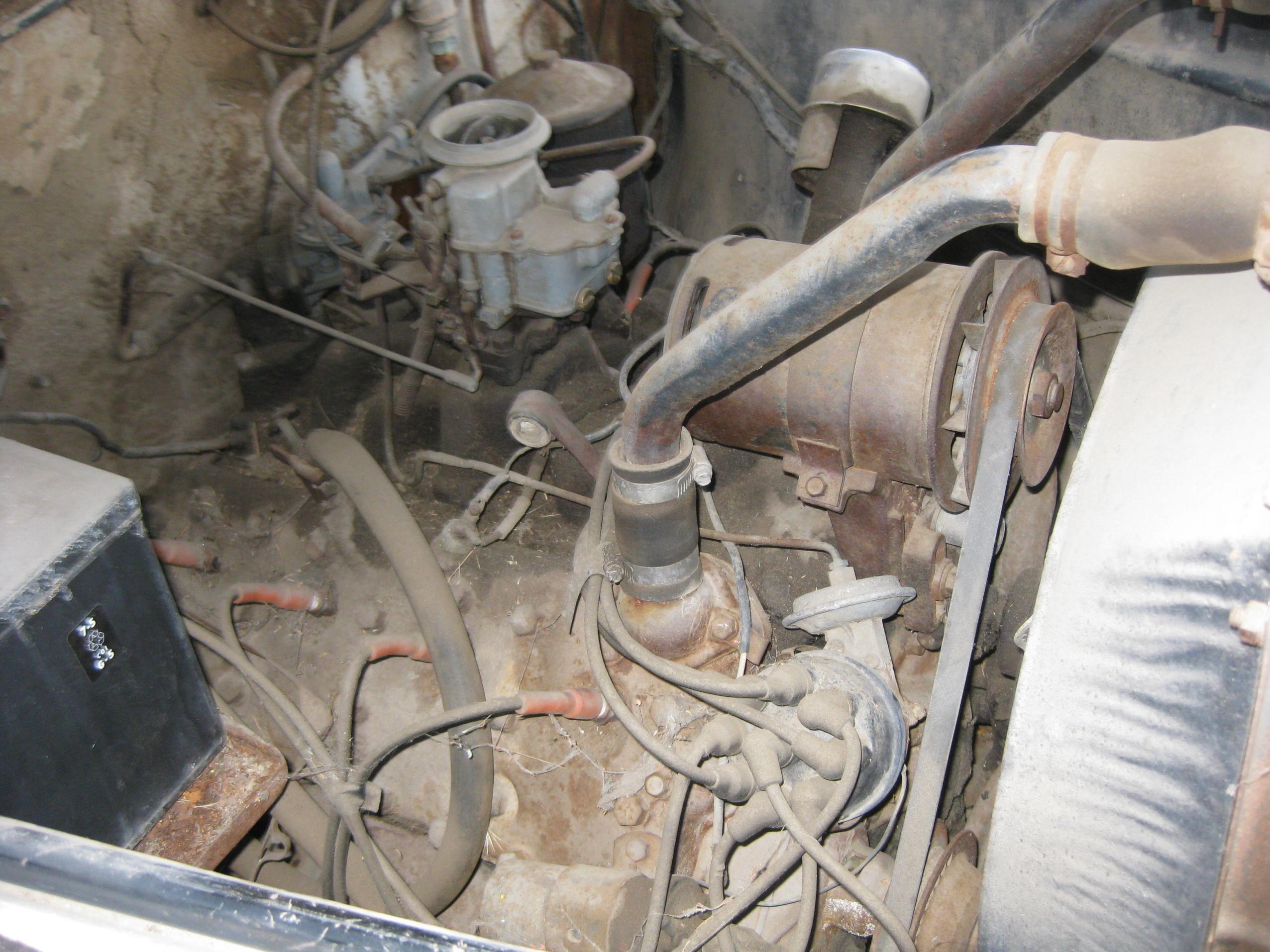

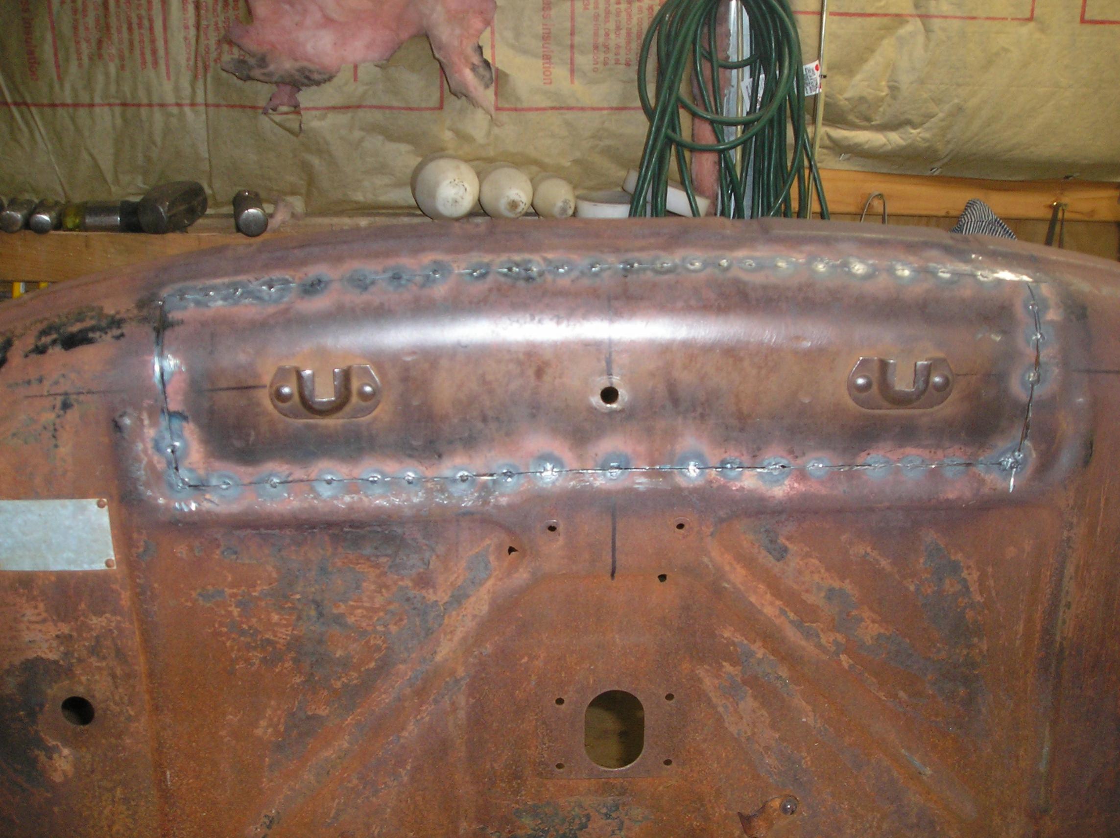

    Made a little progress this evening.

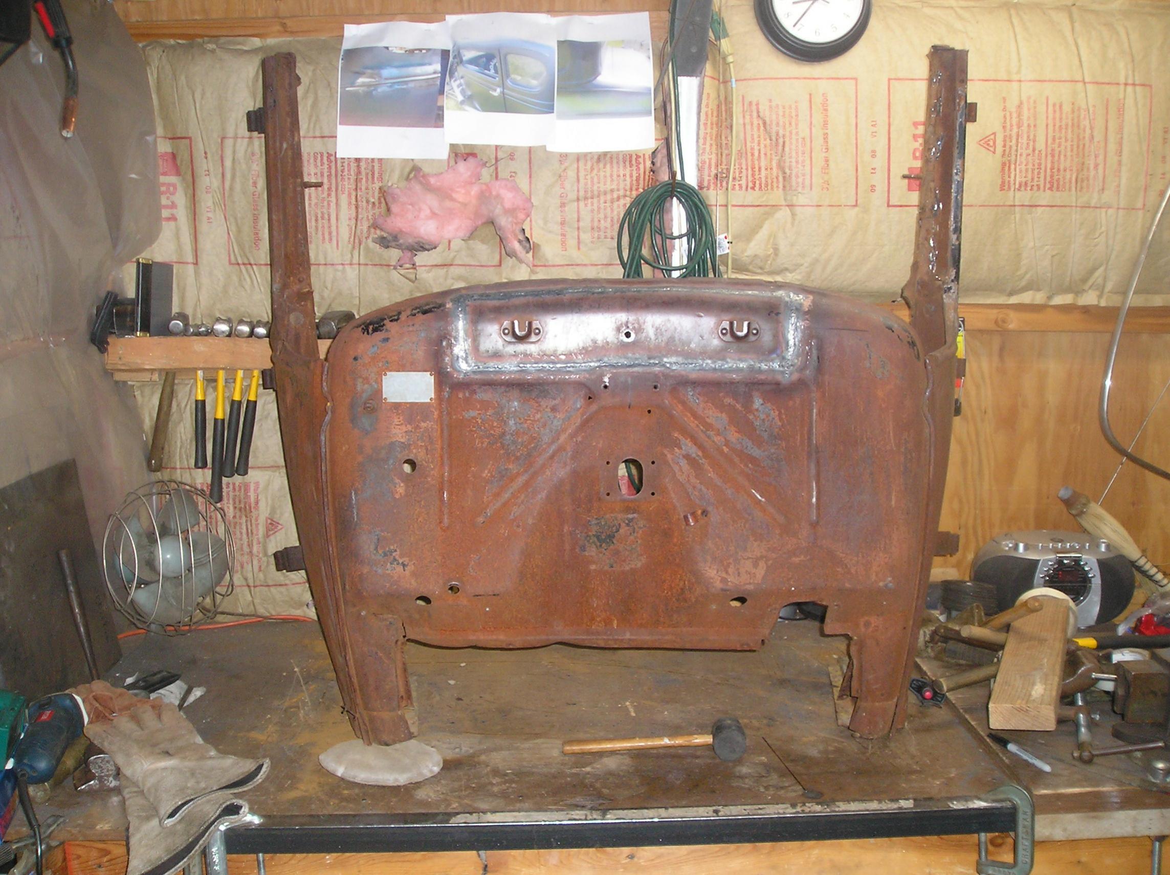

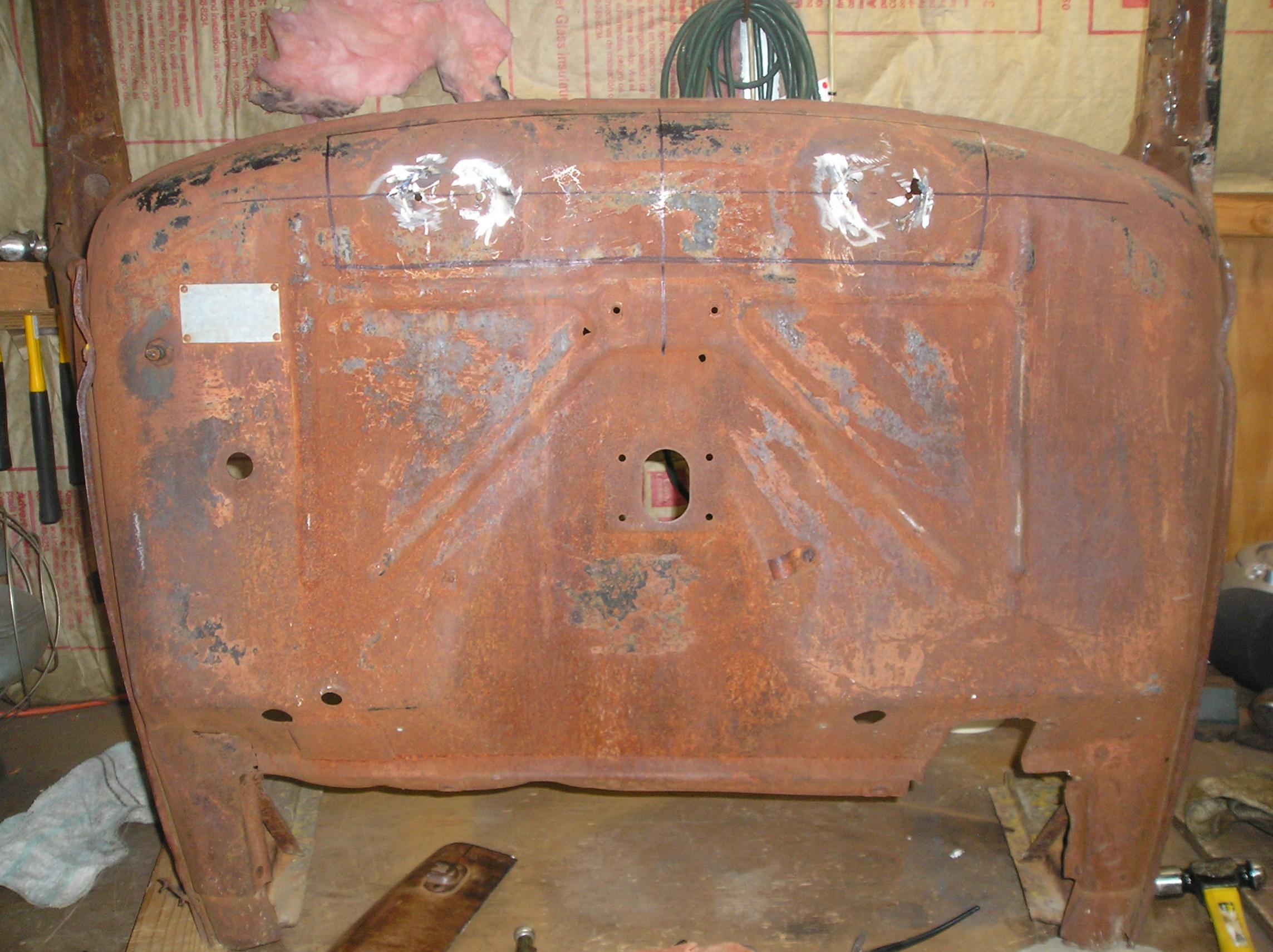

    I took a break from the quarters to work on the firewall. Someone had stick welded the hood rod mounts to the firewall (cant imagine the story behind that one). I had another firewall that had what look like factory plates behind the rod mounts, so I went to work with the torch. It still needs a little grinding and finishing. Tracing the patch acurately was difficult with the curve at the top of the firewall so I had a little larger gap than I would have liked.

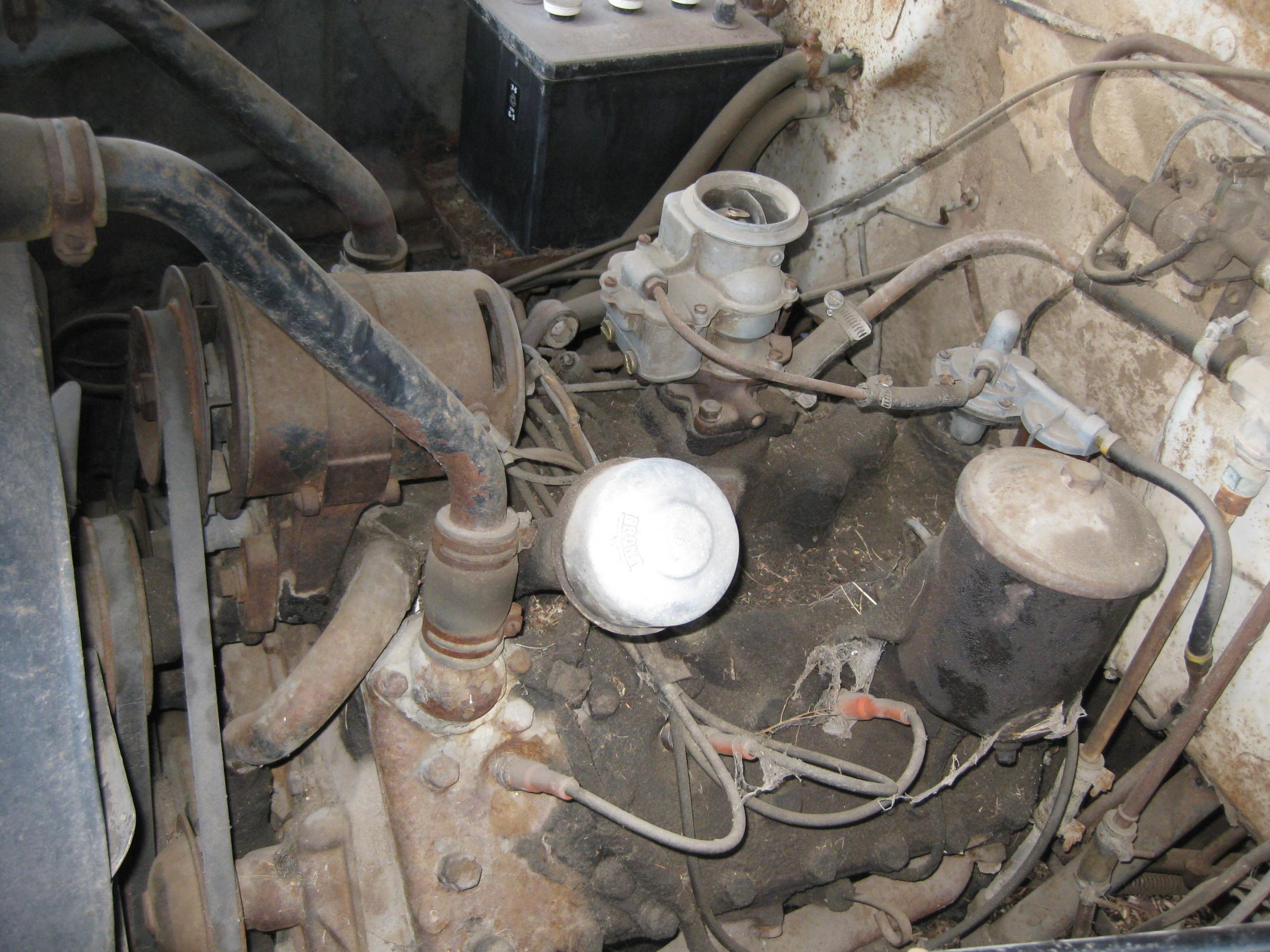

    The Holley 7RT I pulled yesterday gets rebuilt as soon as the kit gets here next week. hopefully I can get the flathead to fire sometime next weekend.

    I think that stress cracks at the radiator support rod bracket and the amateur weld repair was pretty common on many Model A's due to frame twist. The tudor that I built several years back had the same repair. I just took a grinder and removed the old bkts., welded up the cracks, ground it down and bought new bkts. I didn't just happen to have a spare firewall laying around though. I think that your firewall looks good but then I see you have good help!!! Keep up the good work!!!
  23. Rehpotsirhcj
    Joined: May 7, 2006
    Posts: 1,447
    Rehpotsirhcj
    1. Northwest HAMBers
    I was after the spot welded plates behind the brackets too. Seems to be a good deal stronger.
    I used the metal from the scrap cut-out to replace the footer sections where the firewall sets in the front of the frame rails. I think the gauge is a tad heavier then 16. Spent the rest of the night welding up a few other stress cracks and one of the quarters.
