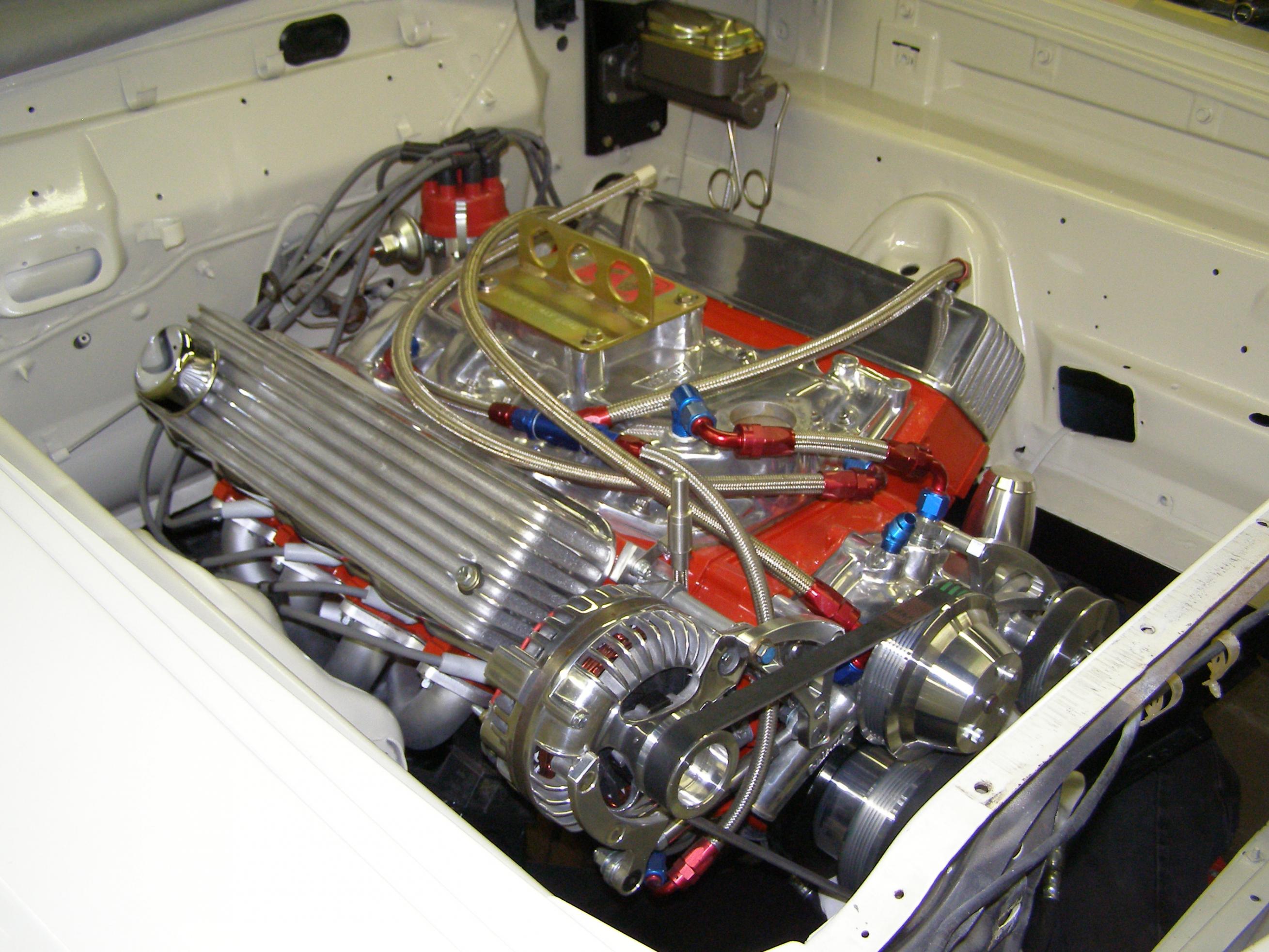

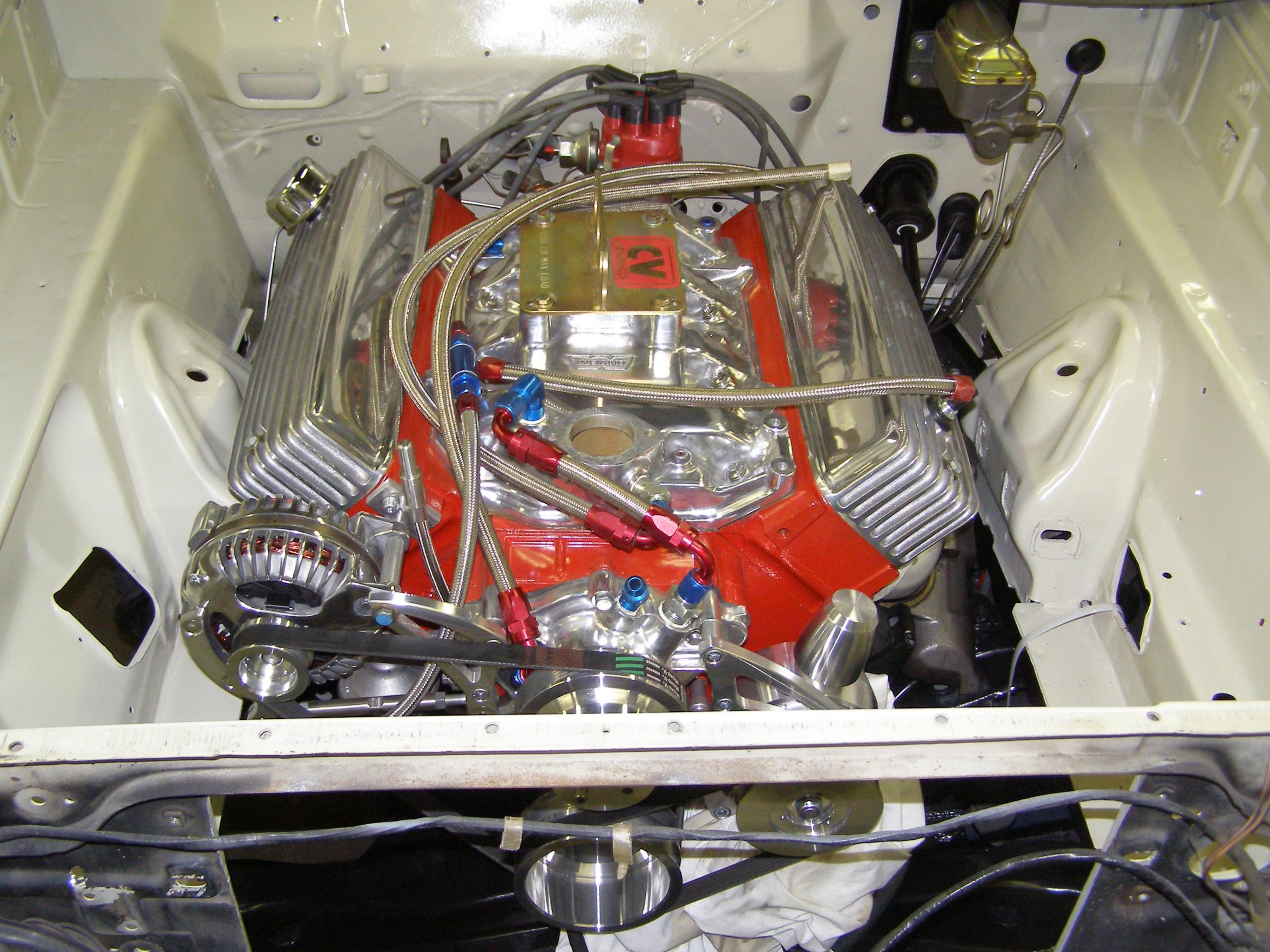

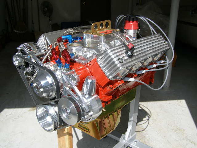

  6. FuryUs63
    Joined: Nov 6, 2010
    Posts: 12
    FuryUs63
    My 1st project is complete using a 1964 318 block, bored .090", stroked to 3.58" making 359 cu.in. A Callies Dragon Slayer crank, Crower rods, CP forged aluminum pistons 9.5 CR, Racer Brown ST-14 flat tappet cam, Weiand 7503 intake, Rev valves, Mallory 57 distributor, & TTI headers.
    On the dyno it made 392 hp @5700 rpm, 392 tq. @4200 rpm.
