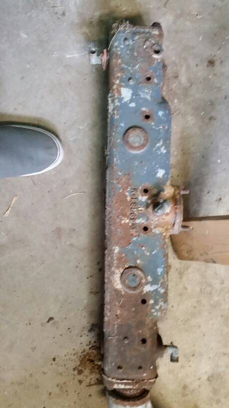

  24. A chrysler marine manifold would give your in line six a unique look, they are hard to get, but they are intake and exhaust in one. Here is a few pics of one i have.
  25. 64 DODGE 440
    Joined: Sep 2, 2006
    Posts: 4,422
    64 DODGE 440
    from so cal
    I believe that those are designed to have water running through them when operating.
  26. daliant
    Joined: Nov 25, 2009
    Posts: 700
    daliant
    You'd also need an updraft carb to go with it. Also the exhaust would have to run through the firewall.
