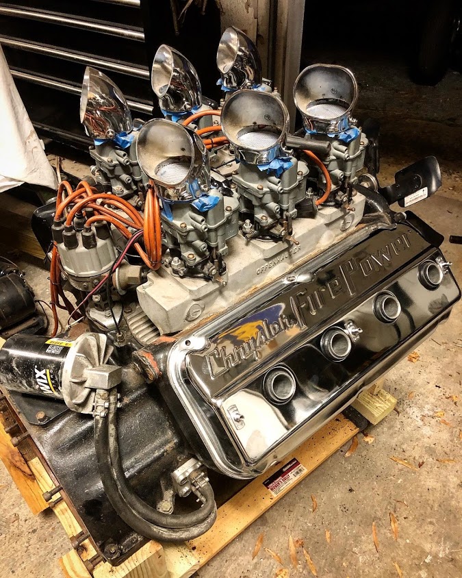

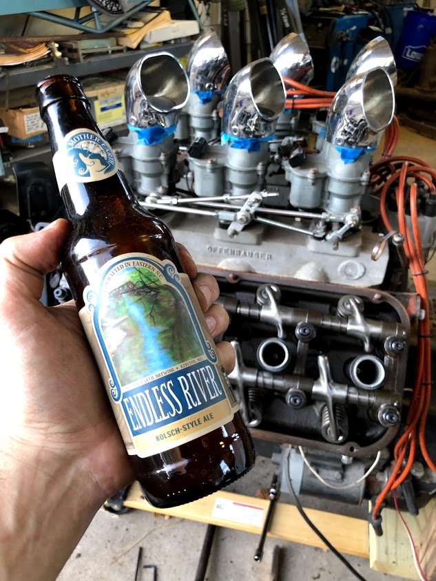

    Hemi is out! My buddy Josh (@Silvair ) came over and helped me wrestle this thing out and get it ready for all the little things I need to fix and wrap up.
    I had forgotten how big this engine is! Crazy to see this elephant sitting next to the little 283 for the truck.

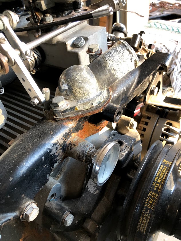

    I have a bunch of cleanup to do on this engine. Paint, corrosion, head studs, oil filter nut, and blah blah blah. Also time to get the clutch setup and order a hydraulic throw-out bearing.
    Here's the corrosion.
    Head studs! They wouldn't sit deep enough, as it turns out. Glad I found out before putting some nice chrome valve covers on! Trimmed anywhere from 1/16" to 3/16" off of a handful of studs. Should be able to clear the VC's now. If not, a thicker VC gasket will have to be used.
    And set! Drink beer. Enjoy!
    How about a chrome mock-up pic!?

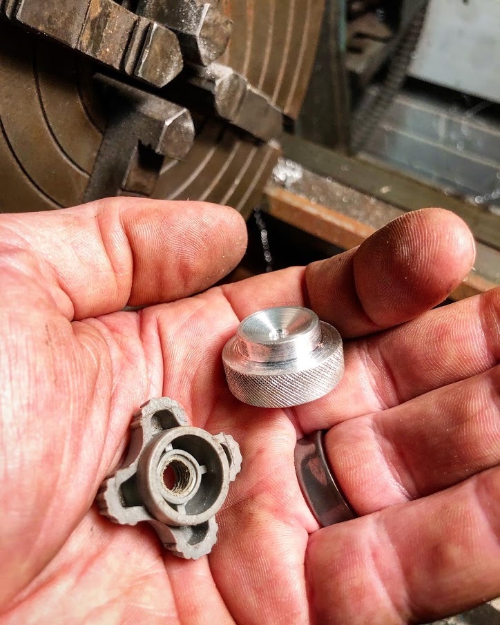

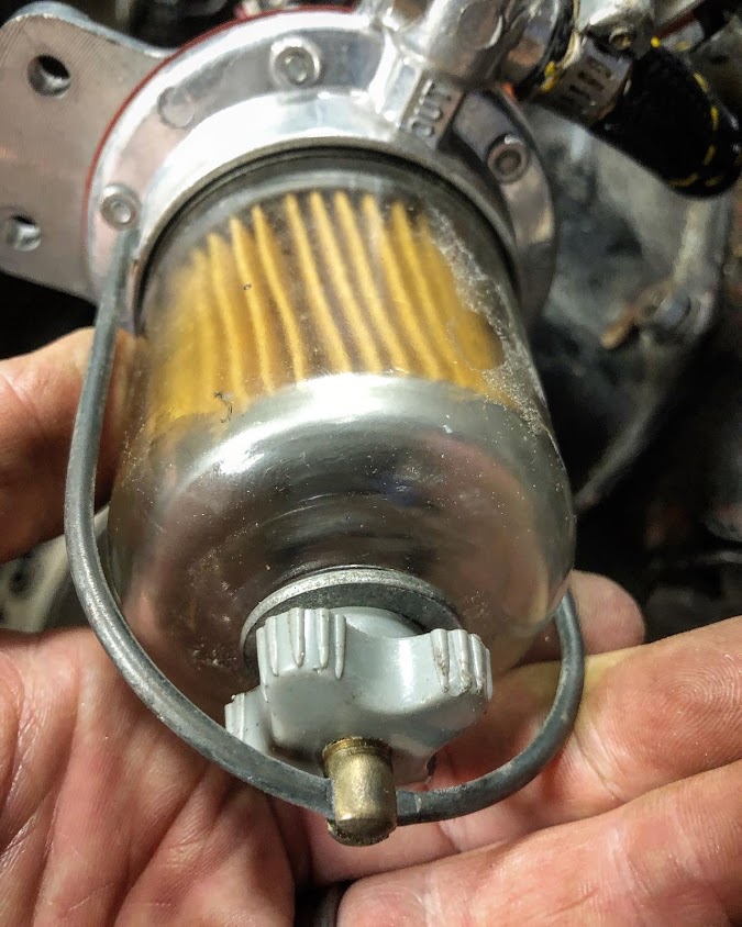

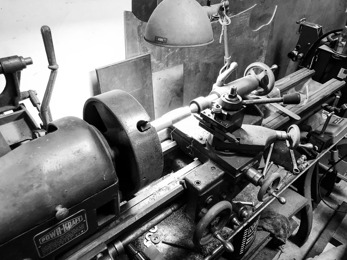

    Spending a little time on the lathe was nice too! Had to make that nut for the King fuel filter/regulator. The original was a crappy plastic knob (with an M7x1.0 thread) and got over-tightened. Was lucky it didn't start a fire when it last ran! Fuel bowl dropped under pressure and blew fuel all over the engine and firewall. Knob made. Just waiting on an M7 tap to get here so I can run it thru and install it.

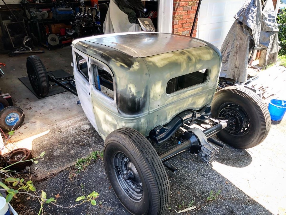

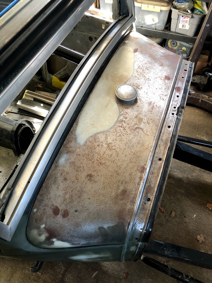

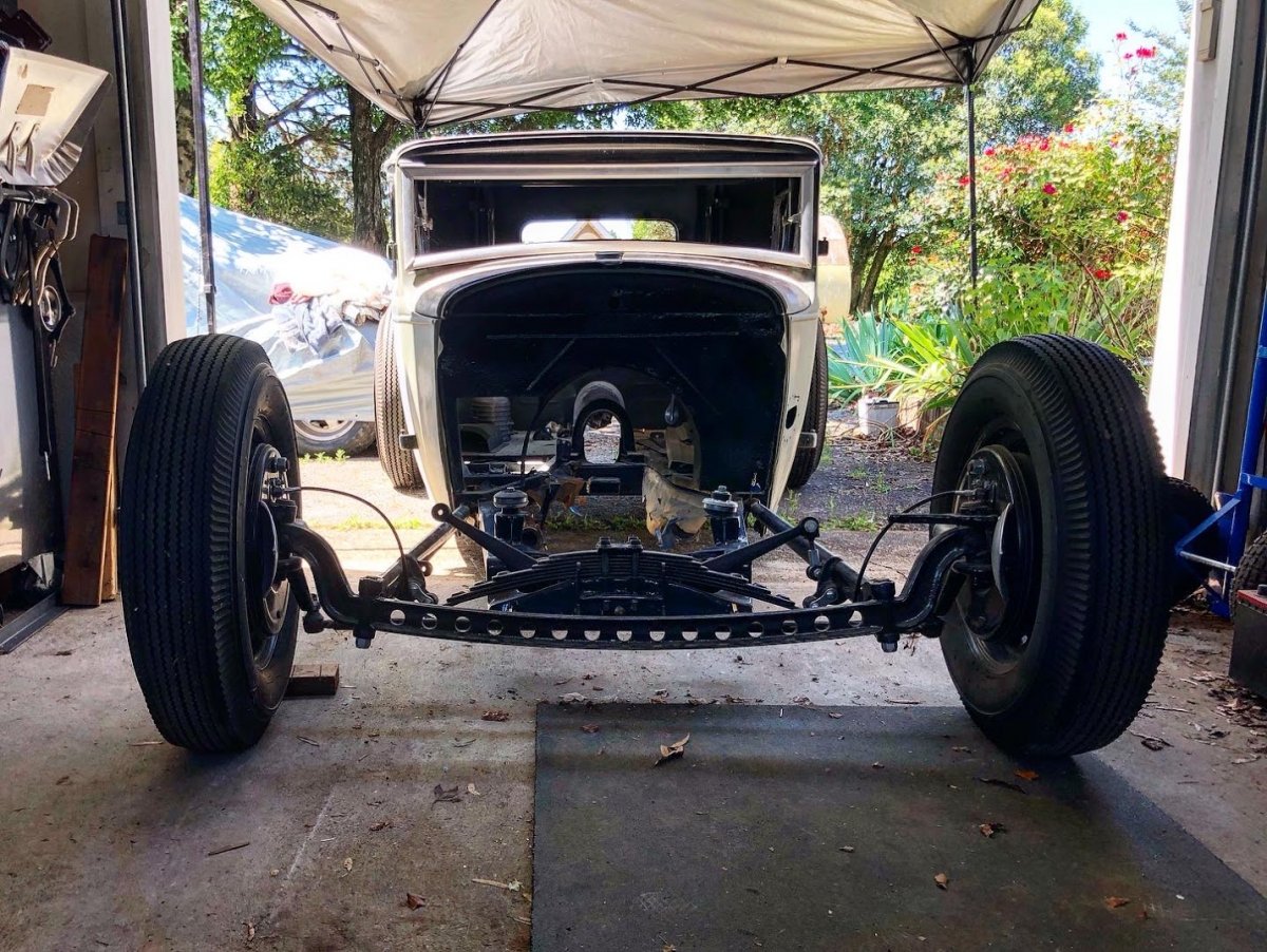

    Well, I'm still alive and this build just won't won't die, either. But, I have renewed energy to get this car done. Going to try again to make it to the Old North State Invitational at the end of September, even if it means it's going on a trailer as a partially finished car. The deck is definitely stacked against me, but I always said I would never put the car in the public's eye without it at least being in paint... SO! I'm jamming to get paint on this thing.
    Unfortunately, all this Covid stuff has hit the industry I work in pretty hard, so most likely the car will be going up for sale when all of this is over. I've already let my '64 C10 go and have been cleaning out random stuff I don't have plans for. Feels pretty good to clear a few things out, but kind of surreal that times are the way they are.
    Okay. Here's where we're at! This list is still long, but I started working again this past weekend and will keep on pushing the best that I can while raising two toddlers and doing everything I can for my family during these bizarre times.

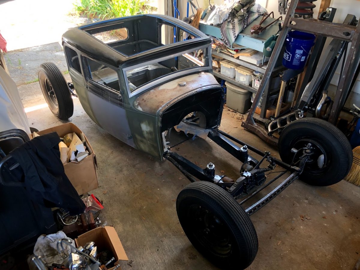

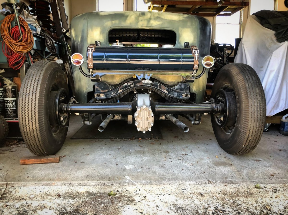

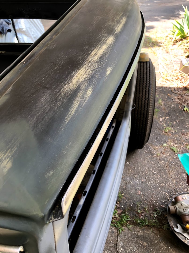

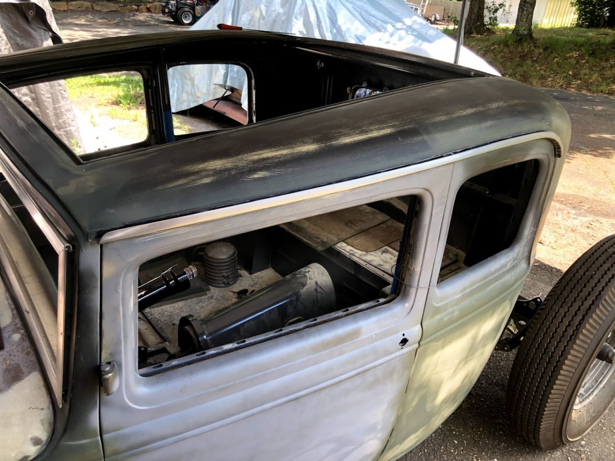

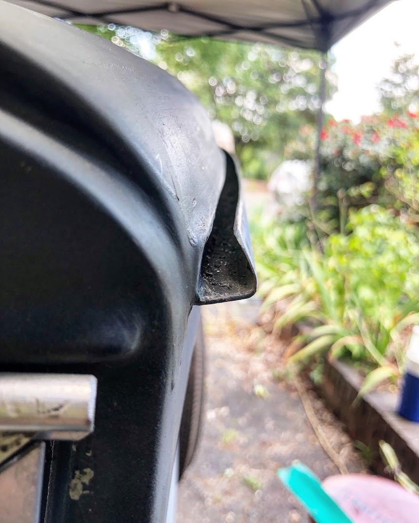

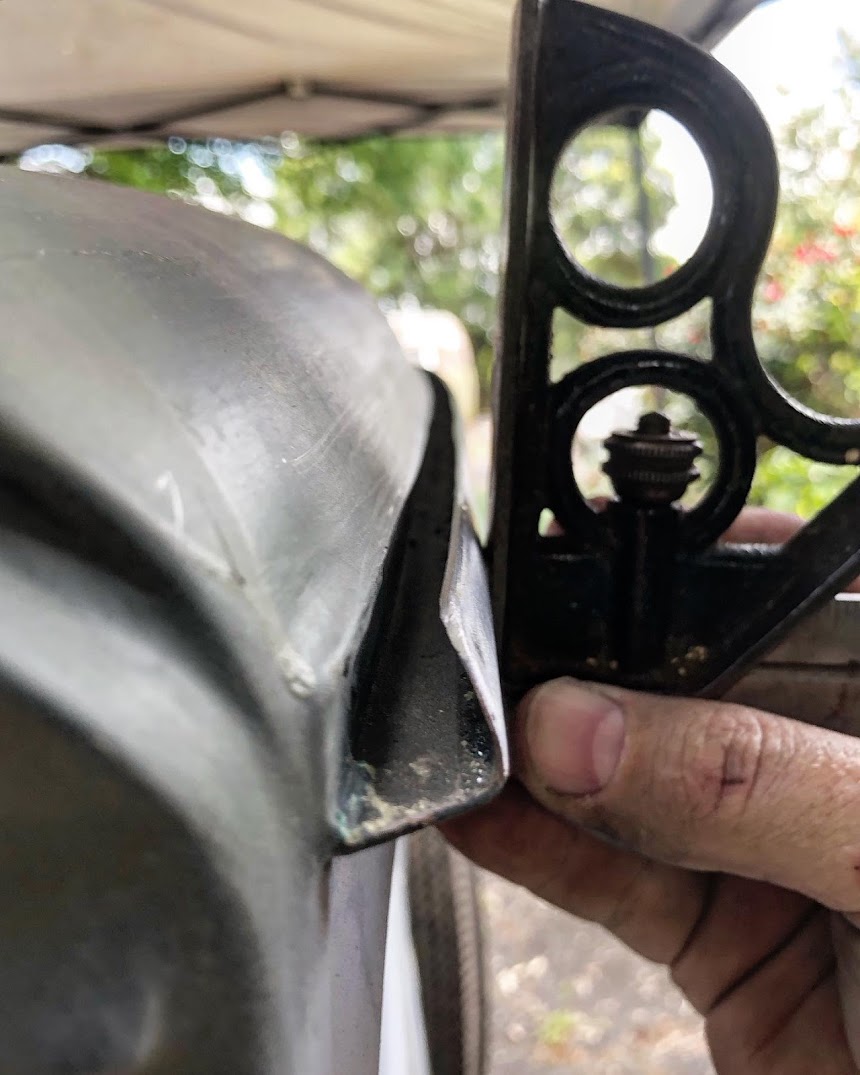

    First up, while waiting for some supplies, I've been working on drip rails. The scratch-made drip rails always kind of bothered me. The frontal profile just never looked right to me and I had a few whoopsie's that needed to be cleaned up. So I spent like 5 hours reshaping and filing them. It was worth it! I like the new direction much better and it flows with the roof shape much better.
    F46F7C5C-69BB-4F84-90D4-79840FAF0819.jpg 22D80C3A-E1F9-479F-96D7-7309BC03898D.jpg IMG_3245.jpg IMG_3249.jpg IMG_3250.jpg

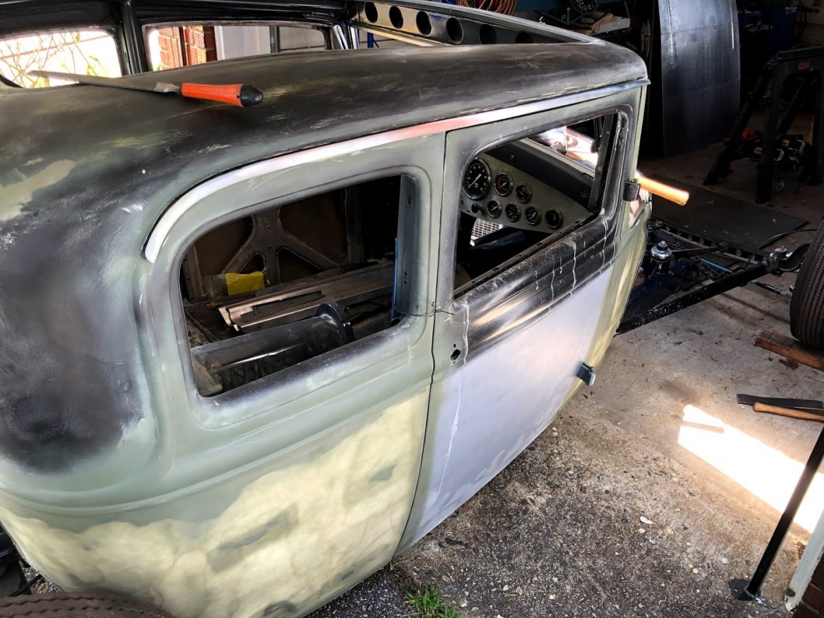

    Seats are out for upholstery. I should have them back in perfect time to put back in the car immediately following paint and then I can start on everything else. And, I just really have a lot more to do and REDO (since it's been sitting) to be ready for high build, final prep, and color. But I'm SUPER close now!! The weather is super hot and humid, but I'm gonna make it work.
    This car looks so weird without the push bar and everything else removed. Or maybe it just looks strange all the time, actually.
    E3ADD1DB-064F-4A36-8D50-F6152A92BFA8.jpg 3BECDD9C-1300-4A03-9328-64F693BB82ED.jpg BF1ABB85-8221-41F5-B53F-E88044D92335.jpg
    Guess I'll be stripping the cowl top and redoing that, but that's what happens when things get neglected in a humid climate.
    Stay tuned! More to come! Gonna be a tough couple of months to balance everything with family stuff, work stuff, weather, etc. I'll keep you guys posted on this mess. There is an overwhelming amount of stuff that will really probably take the rest of the year to get done, but going to get out in the garage every second I can. Extremely challenging to balance everything life has thrown at our family. Seems like there's always something, though...
