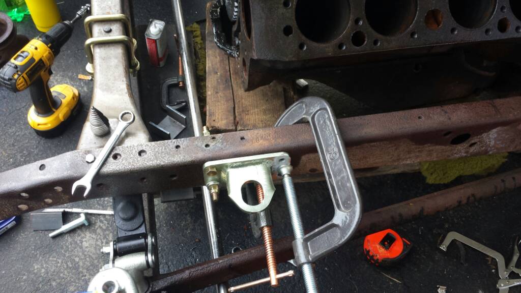

    Next on the agenda is going to be bolting in the engine mounts through the boxing plates. I'm considering my options as far as that goes because I have an opportunity to basically run what is essentially bolt-in second frame. I doubt I'll ultimately decide to run it that way however but it does present some advantages for construction with what I've got right now.
    My plan is to shim the bottom to make sure I'm snug against the top and drill the holes for the bolt-in flathead mounts I'm using (and then the bolt-on wishbone tabs). This will hold everything together but not really control horizontal location of the boxing channels. For that, I'm thinking I'm going to make some offset pegs or tubes and then drill down through the top and bolt them in place. That will lock in the XYZ location of the boxing channels to wherever I want them. Right now they sit a bit inside the rail; I can push them out a bit to potentially get a better weld.

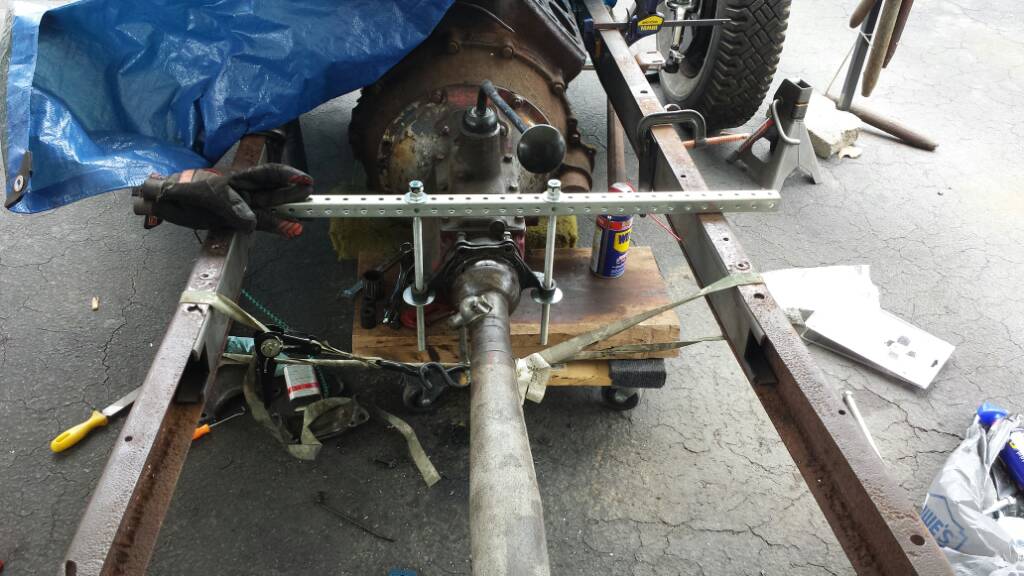

    Here are some more photos from the weekend including what I did and how as far as the frame kick up and in process.
    Vertical location will happen next. I'll be coming up a couple inches, obviously:
    I sanded, wire wheeled twice, and sanded again before cleaning and laying down some weld through primer on all the mating surfaces.
    Here is my clamp jig. I used a 1/4" plate and a 2" piece of angle iron with a pair of clamps and vice clamps I just bought on each side. I went back and forth with my rubber mallet bumping it until it was as square as it was ever going to get and locked it down.

    Not adding anything, just cut the frame, put the rear section on top of the rail and moved it forward until the torque Tube mated up to the transmission. In your case, you'd use math since you'd be going for locating the wheelbase to a specific number whereas I was just going for making it work with the TT I had.
    That piece of box tube is just welded on there to brace the frame for cutting BTW.

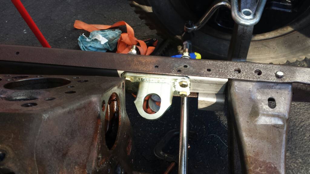

    The bolt-in mounts I've got on there now will put them down about a half inch or so and probably 3 inches or so offset from the non-stock 32 style crossmember (probably around where they'd land with a stock A crossmember). That puts my fan at just about the back of the crossmember, so I should be in a good relationship to the radiator.

    So, it took me all day yesterday to drill 8 holes essentially, but I nailed it. Today once I get going I'll hit the other side.

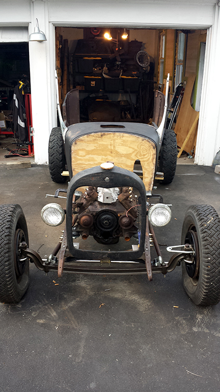

    I dub thee, THUNDERCASKET.
    Looks like more of a car than it is but it is a milestone and ok for a sloppy mockup.

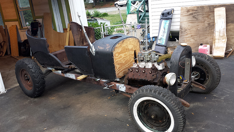

    Here's a photodump of the rest of the pictures I took from my lawnchair.
    There is obviously a ton more work to go but this is as close to a car as it's ever been.
    I've got a bit of an apparent fitment issue with the motor mount pins that I've gotta sort out. They don't seem to want to line up and go through enough to reach the nut. I suspect that I didn't do things quite correct as far as mockup when I tacked the frame kick in.
    I figure I'll let it sit and settle a bit this week and get a good look at it this weekend. I was thinking I might want to increase the kick anyway depending on where the rake settles. Right now those are 29" 6.00-16's up front and the 32" 7.60-16's in back but it's tough to tell a difference in these photos.
    The body, well, that's just kinda sitting on top of everything. It's going to come down at least an inch and meet the frame when it's not sitting on clamps and tubing. Once I get a look at that, I may decide it HAS to be channeled, but we shall see. The rear quarters will need to be channeled down around the rear crossmember regardless, so it may work out better to go all the way.
    20150614_173300.jpg 20150614_173312.jpg 20150614_173318.jpg 20150614_174019.jpg
