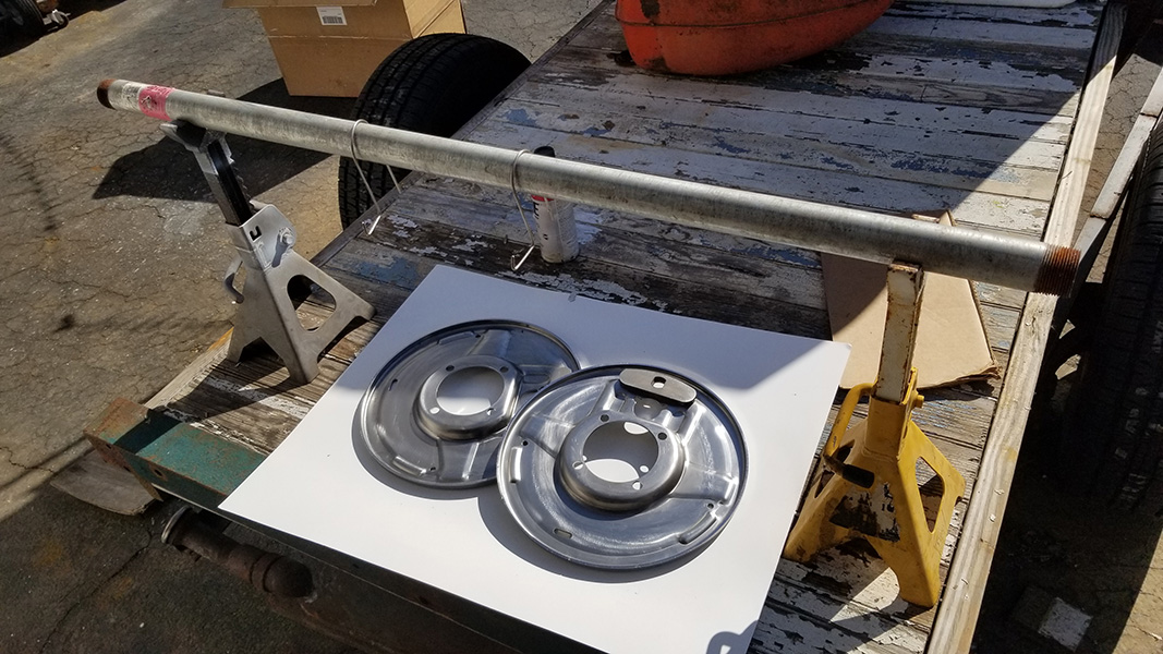

    Not a whole lot of time in the shop this weekend. Ran an errand to go pick up some scrap drops from a friend's shop in Salem, which is like trying to drive into an ant farm, and once I was done with that, my neighbor, Paul, came by to inspect my progress. After all that excitement I was about done so I didn't get into much of anything other than setting myself up for Sunday.
    I started off laying the second coat of the Rust Bullet on the frame with a 4" roller. That was SIGNIFICANTLY easier and better than the chip brush. Some of the fibers from my roller got pulled into the paint though but I need to scuff it down anyway so it won't really matter for the end result. I'm going to lay a skim of filler on it and top coat with a satin or semigloss white since the White Shell is a bit too slick looking for how I envisioned the car.
    Having wet paint on the frame meant there was not much I could do IN the shop since I didn't want to kick up any dust, so the logical thing to check off the list was my new repop Lincoln front brakes. SO painting became the theme of the weekend since weather was good for it. I made some hooks and an improvised rack and laid down some VHT primer and white. Now when I putter around out there this week I can get to assembling them. I'd like to get my front end blown apart and painted too so I can assemble everything up there once with the new brakes ideally.

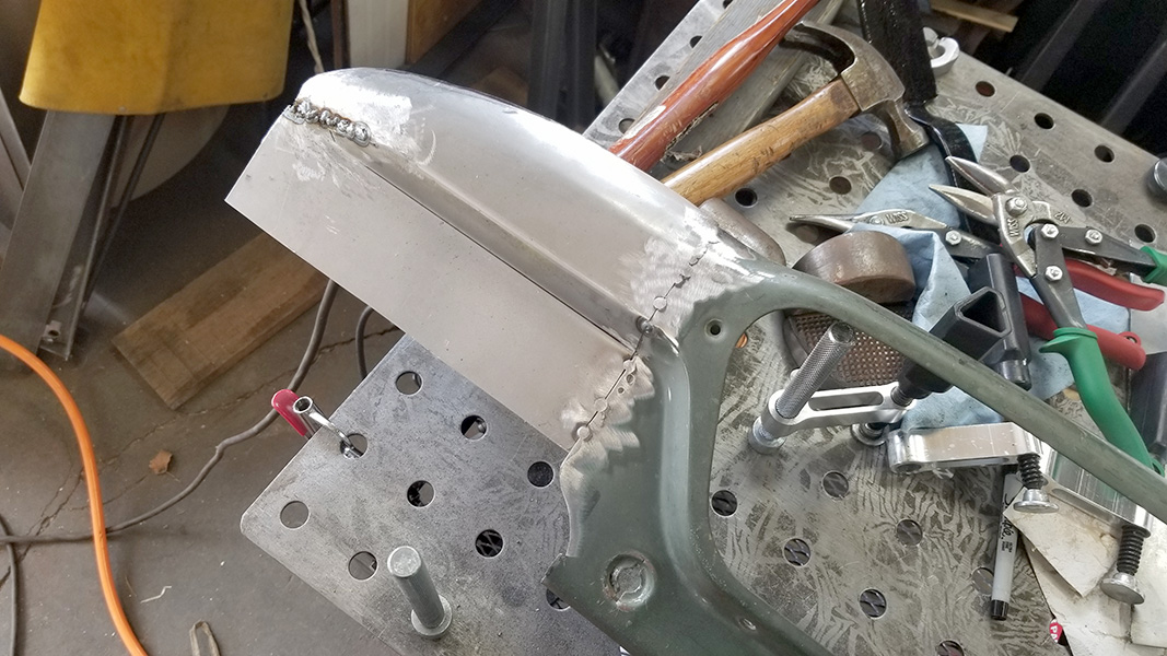

    The OTHER news is that I bought an Allis Chalmers Tractor fuel tank. Plan is to split it and cut it down once I get the line from the cowl to the tangent on the curve then fill the middle to make the new nose.

    I've always liked these tanks since I saw a Modified built with one hanging off the back. They are really stout and have a great shape to them. So far 2 people have said it looks like a GIANT Harley tank, LOL.
    EDIT: Here's the article from HOT ROD about the car I mentioned: https://www.hotrod.com/articles/hrxp-spring-2008-1929-ford-roadster-pickup/
    It does indeed. I generally try to look at any piece of metal for its raw material and shape usage as best I can. The only thing about this tank that gives me pause is the metal it is made with. I think it may be 16ga which could complicate pulling dents and welding slightly. I've only found one dent so far but it's a bit deep. I have welded 18ga to 16ga before too so, also NBD.
    Figuring out how to split that big seam is going to be the first big hurdle here.

    I think I would try to just remove †he seam with my big belt sander or a cutoff wheel.

    I'm thinking I will run a flap disk around the edge and over the flats on that big seam tab to try to figure out how the pieces are fused and go from there. Ideally I would like to have those ribs on there to work with; they might give it a neat look. If that just isn't feasible I will just cut along the seam above that rib on either side and be done with it. I don't think it will relax the shape much if at all.

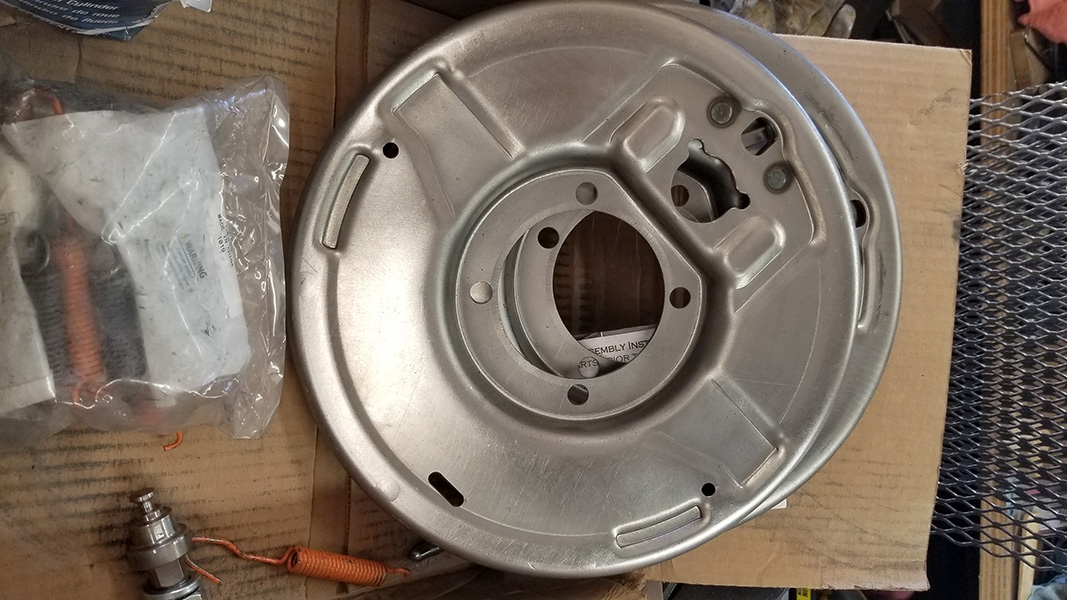

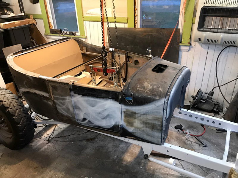

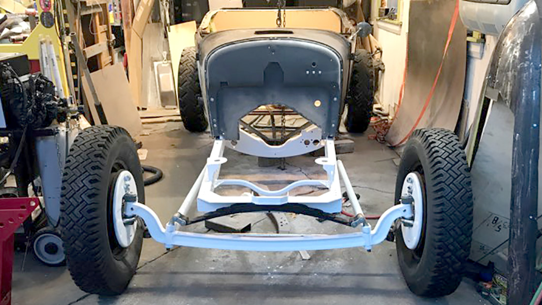

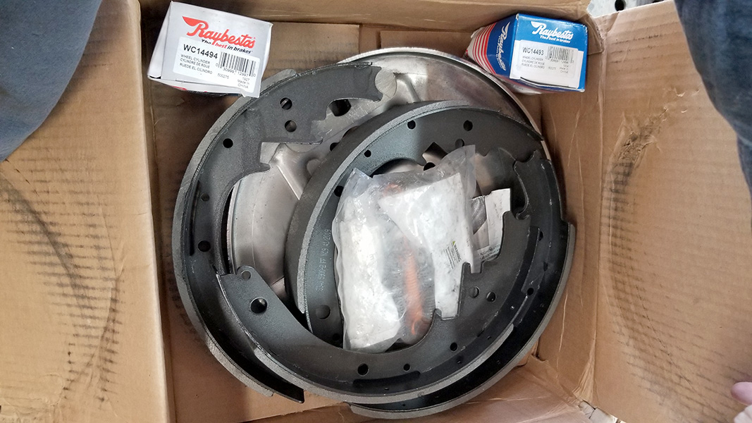

    Well despite having to learn beginner dryer repair last week, I got a lot done. Brakes plates are fully painted and assembled (I had to scuff and re-coat them some). The frame got some internal coating sprayed in which was an awful mess; next time I will mask over all the holes before I use that stuff.
    Put the wire wheel on the Eastwood SCT and finally got it to do something impressive (they really should ship with one). Took 8 years of shop crud and scale off my axle in minutes so I could wipe it down and lay some self etch primer.
    Then on to the big stuff. @BOSTONCAMARO came by and we laid a skim of Bondo on the frame, sanded, and top coated with rattle cans. I slung the axle under there while I was at it and did it at the same time.
    Now that this is done, I can move on to making a finished roller. Gotta get some paint on the wishbones after I finish weld and grind those hopefully this week. Then I can reassemble the front end. The rear end just needs to be cleaned up and painted. Then I will put it all back together and do brake lines.
    After that I can take the engine whenever the machine shop gets my crank back from regrind/balance and assemble the bottom end for me.

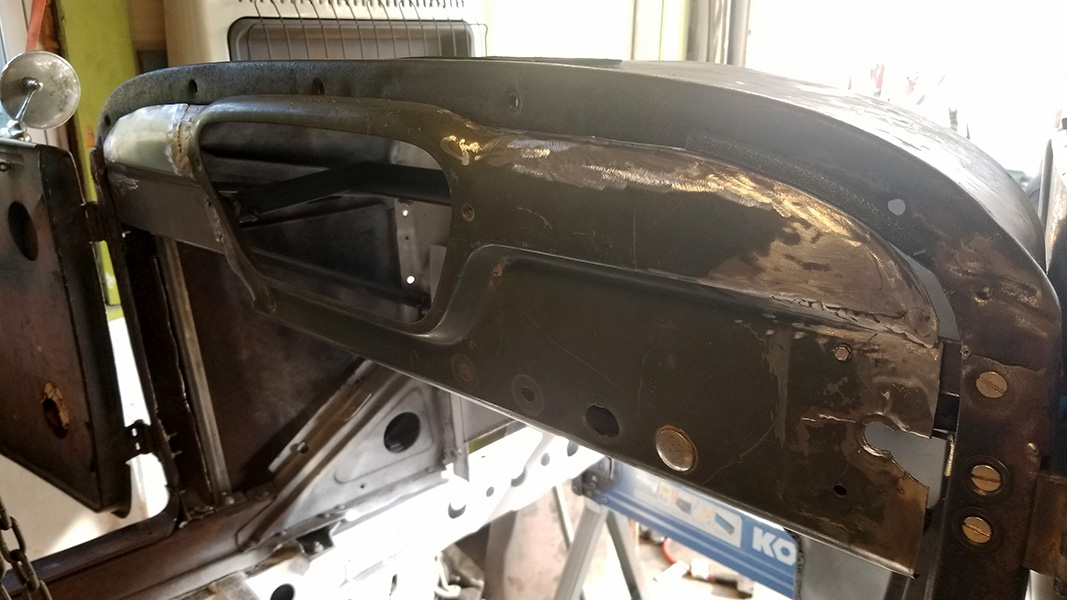

    I don't NEED the dash done to drive the car but it was something I could actually start in on while waiting for thinner welding wire to show up (so I can finish weld the body without blowing through every other tack). So, out came the hammers!
    After hitting it with hammers enough, I remembered I had a bead roller and used that. Then I remembered I bought a motor for it and the whole game has now changed. I got that mounted to my English Wheel frame with a simple bracket by blowing a couple half inch holes in a piece of angle iron. I cannot praise the Milwaukee step bits I just got enough; I have never made a half inch hole in steel that quick and clean before.
    close enough is good enough.
    Now, I really should have rolled the curve into the base piece I made instead of doing it straight then cutting it like I did with the original piece but I decided not to start over just for the sake of doing it "right" and made it work. I replicated the F100 dash rail using the tipping die for the second brake since the brake I built is a POS and my little HF couldn't do it either. Then I clamped a pipe down and bent the curve to match.
    this was a bit of a mess.

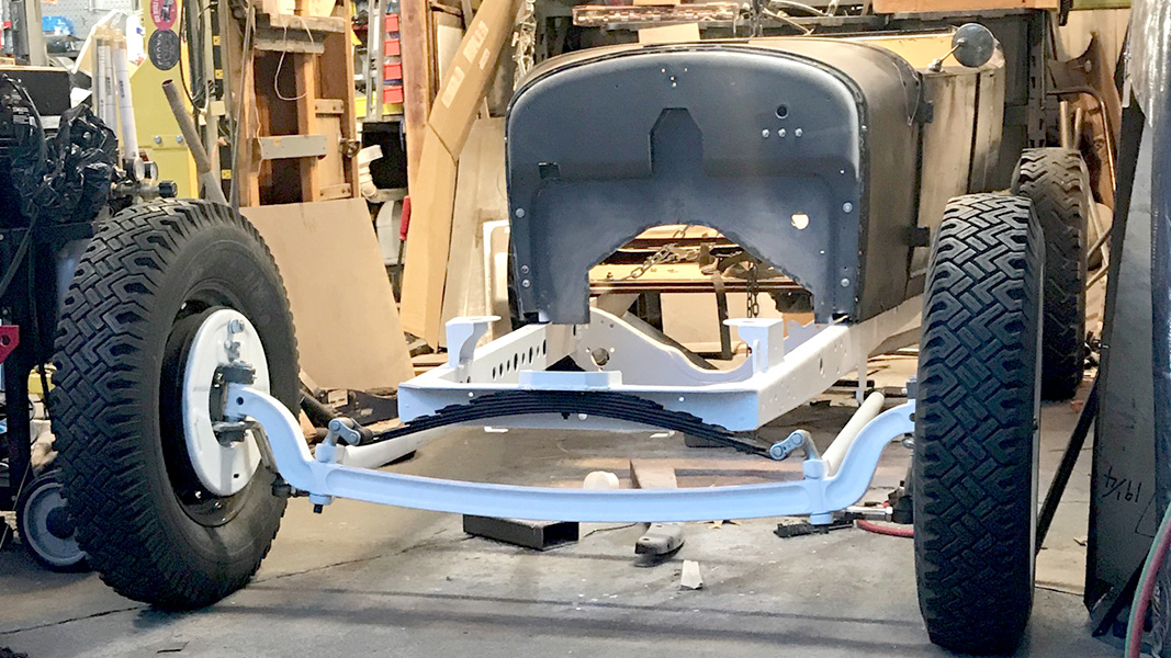

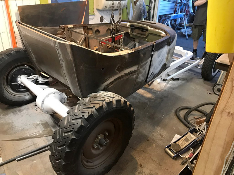

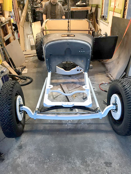

    Finally back on track to getting this thing rolling, steering, and stopping again.
    @BOSTONCAMARO helped me get everything assembled and down off the horses without hurting myself and took a few of these pictures for me. I also got the F1 pedals and MC with the Old Yankee adapter bolted back in with the idea that I can start running lines soon.
    Before my spindles showed up I got the new piece tacked on to the dash and started the long process of tuning the fit. more smacking, cutting, and bending to get it just right (enough) but it is getting close enough to be good enough. I could firm up this as it is and it will hold the instruments so I'm happy to just pick away at this now with the broad strokes handled.

    Diggin your white chassis! Did the paint cure?
  19. patmanta
    Joined: May 10, 2011
    Posts: 3,874
    patmanta
    from Woburn, MA
    1. MASSACHUSETTS HAMB
    It seems to have mostly cured finally but it will certainly need to be touched up once we get some better weather and I can roll it outside in the sun.
