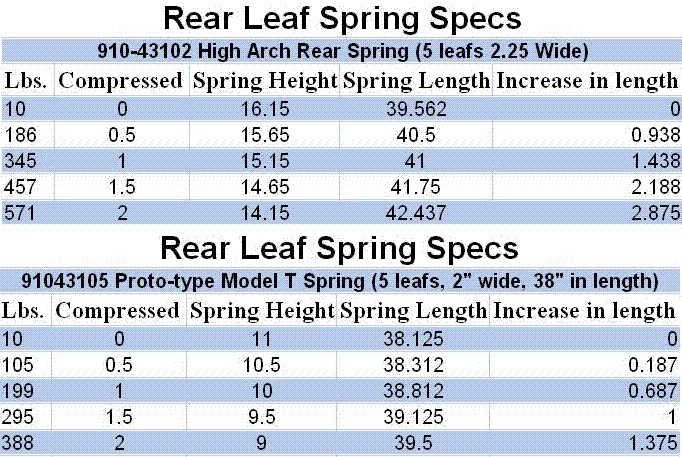

    My dilemma is having purchased a MODEL "T" low arch transverse spring for my Model A hot rod. The spring is TOO weak! I end up with approx. 1 1/2" from the rear end with a full load and not to mention bottoming out when going over the slightest road bump.
    I took care of the problem for now by installing a couple of coil springs.
    The transverse spring measures 38" from eye to eye. I have it installed on an S10 pickup rear axle and the perches are welded as far apart as possible on the axle. I DO NOT want to replace the rear axle.
    MY QUESTION: Would it be OK to purchase another exact spring and use some of the leaves to reinforce the one I have installed in the car. The spring comes with 5 leaves. I'm thinking maybe leaving the bottom one a single leaf and adding 3 leaves for a total of 8 ??

    The spring is the 38", 2" buggy medium range height sold by "SPEEDWAY".
    YES, it is TOO weak. My ride is a 1930 Model A Sport Coupe with a 6" extended frame. If I recall correctly, my ride weighs around 2,600 lbs. I added a LOT of steel to the frame...……….LOL
    My frame is "Z'd" and boxed. The guy who built it used TWO "A" frames to accomplish the task and did a GREAT job...………….
    I want to keep my 1991 Chevy S10 rear axle. SO, I'm curious to know if it would be feasible to just purchase another like spring and add the leaves to the current one. Another words, double up on the leaves making them twice the thickness of just one spring.
    Also, should I cut the added leaves to STAGGER the pack, or just leave them to match in length. Another words, two of each with same length...…….doubling the width of each leaf I currently have.

  9. VSO737
    Joined: Aug 24, 2005
    Posts: 237
    VSO737
    YES (see attached)
    I don't have an issue with how the spring was mounted...….the perches are welded properly and the spring is at the correct mounting specs.
    ONLY issue is that the SPRING is rated for a "T" and I have an extra heavy Model A.
    I did NOT know any of this when I built it. Looked great UNTIL I set the body on the spring.
    I want to KEEP the current SPRING and REAR AXLE, I just need for the SPRING to be strong enough to HOLD up the car...………….
    My question is could I accomplish this by just doubling up on the leaves from another like spring?

    "This Speedway spring might have a totally different arch from a stock T spring, so you are in uncharted waters."
    YES, this "SPEEDWAY" buggy spring is CUSTOM made and different than the ORIGINAL "T" spring.
    This is the reason I purchased it. This spring has a lower arch which makes it ride LOWER and closer to the rear axle. If my ride did NOT weigh so much, I would not be having this problem.
    When I say borrow leaves from another spring, I'm talking about using another EXACT spring to the one I already have. I would be purchasing another spring from "SPEEDWAY" and removing the leaves and put them on the spring I currently have. Another words, convert their spring from 5 leaves to 9 leaves.
    This SPEEDWAY spring is also 2" and NOT the 2.25" that the MODEL A cross member takes. This also contributes to it being WEAKER than what I need.

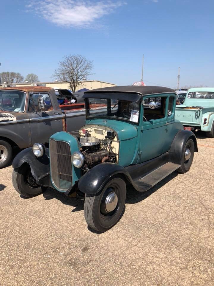

  19. VSO737
    Posts: 237
    VSO737
    ALCHEMY- "you hit nail in the head"...……..my exact issue. My rear end has perches welded (on top) to the exact specs this 38" eye to eye spring requires. Any heavier spring has a much wider eye to eye dimension.
    I just viewed one of my DVD's and took a picture of the rear end BEFORE the body weight was placed on it. Looks great out of the car...…………….LOL
    The rear axle is from a 1991 Chev S10 pickup. I'm pretty sure that I ended up putting the short leaves in the picture on TOP of the spring and not the way they appear in this picture.
    I will have to get under it and take a picture to see exactly how I ended up. I know I spent a lot of time on it years ago.
    I will be talking to the SPEEDWAY tech on Tuesday to see what his input is. I'm leaning towards purchasing another identical spring and making ONE BIG one. I'm going for the 9 leaves total...…….LOL
