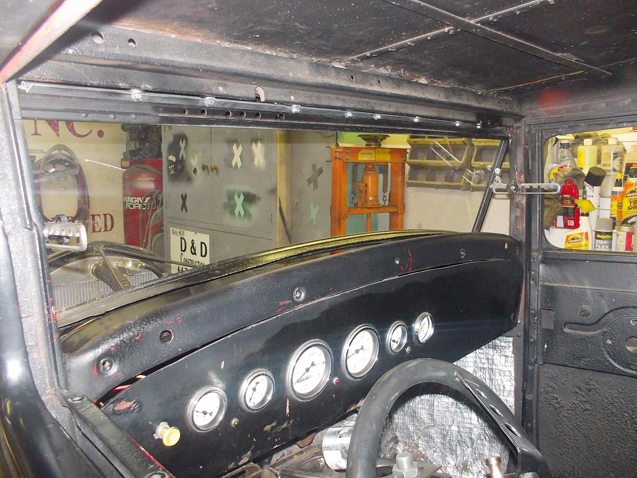

  1. Hi, I'm trying to mount my windshield frame so it will swing out. All I got with the car was the frame and it and the car have been chopped 3 inches. I think I bought all the hardware or close to it. Does anyone have any pics of their installed upper hinge and side mounts and slides so I can see what I'm trying to assemble? I think I'm missing something where the upper hinge mounts and maybe also on the A-pillars from when it was chopped. Any help is appreciated. Thanks.

    The upper hinge is screwed to the wood header. You may be missing the upper hinge, check MAC'S website for a pic. There is a stud on each WS post for the slides, also available from MAC'S. Order a catalog.

    Wagoon's drawing is quite accurate, it does not show the angle iron cross piece that joins you door posts together along the back side. The hinge detail is accurate for a 30-31 hinge, 28-29 is different.
    To put it all together, you need the wood header or a metal replacement (not easy to make), it also ties in to the wood going over the door tops and the wood going along the roof opening from front to back. This is covered with the cover plate with a welting along the top to seal to the visor. All major connections tied together with formed metal connector plates bolted in place.
    Some fairly decent pictures of the wood installed in the January section of my blog. I am not using the original style welting across the visor as a seal. Rolled a replacement out of steel and will use modern sealers to keep the wet stuff out.

    I welded 1 x 2 tube across the top of the A pillars - drilled and tapped for the hinge …. In place of the angle and wood

  9. Thanks Again.... After looking at the drawing and taking a better look at my car ( a 30), It is all much clearer. I think I can get the upper hinge mounted and the slides should be no problem. I've wanted an A as long as I can remember, but never learned much about them and never knew anyone that had one. So I'm trying to figure out what all mine is missing a little at a time. It's kind of stripped out since it has been a race car most of it's life. I want to drive it rather than race it.
  10. Thanks all. Got it together and working!
