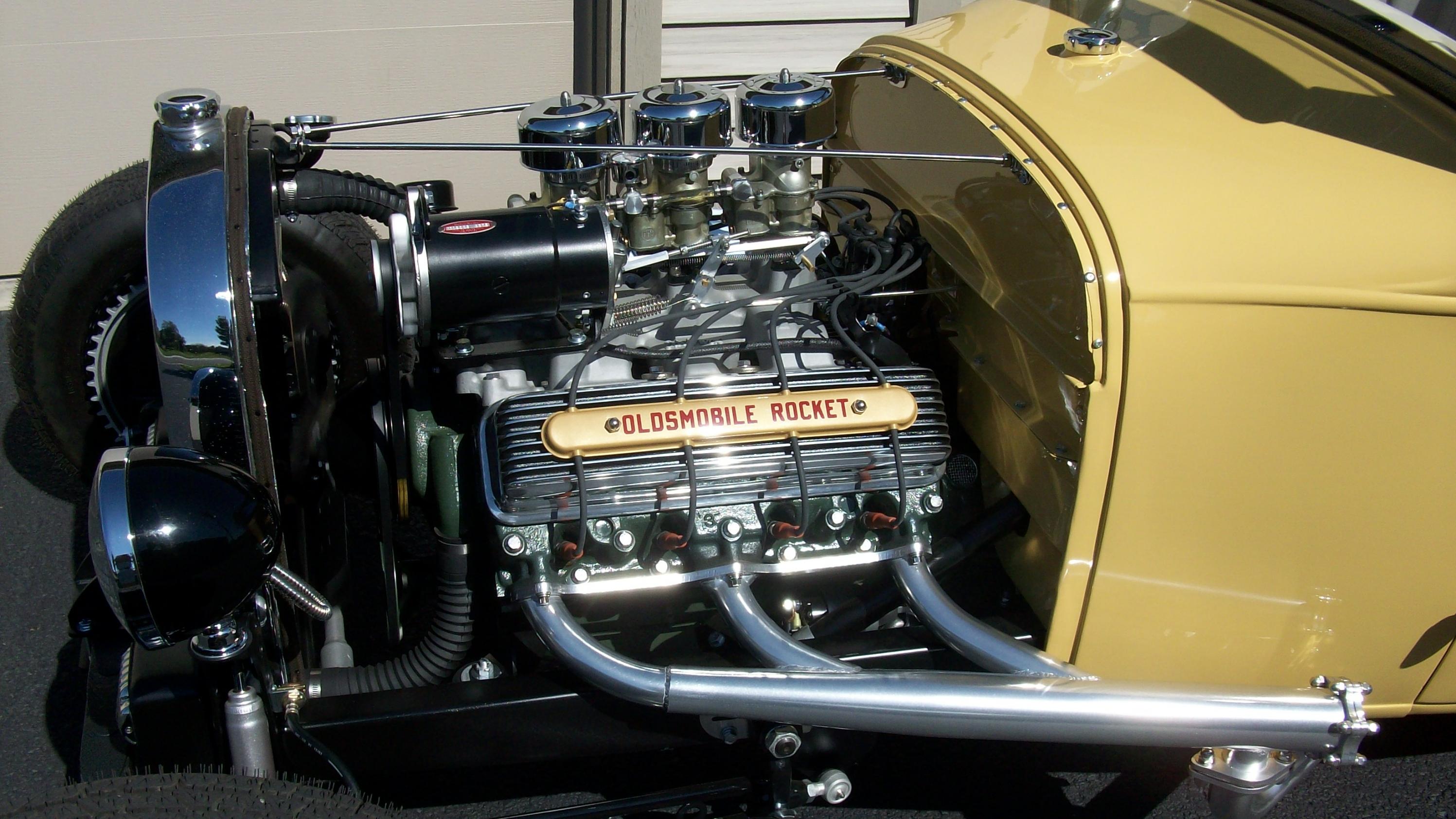

  9. Actual torque tubes are rather heavy. They could be used as side straight pipes with the proper support. I have never seen actual torque tubes used to make lakes style headers. However, the tubular drive shafts that Ford used (inside the torque tubes) in 35-36 have been traditional hot rod header material from way back in the day. Pictures show a set that Salt Flat Matt here on the HAMB built for me.

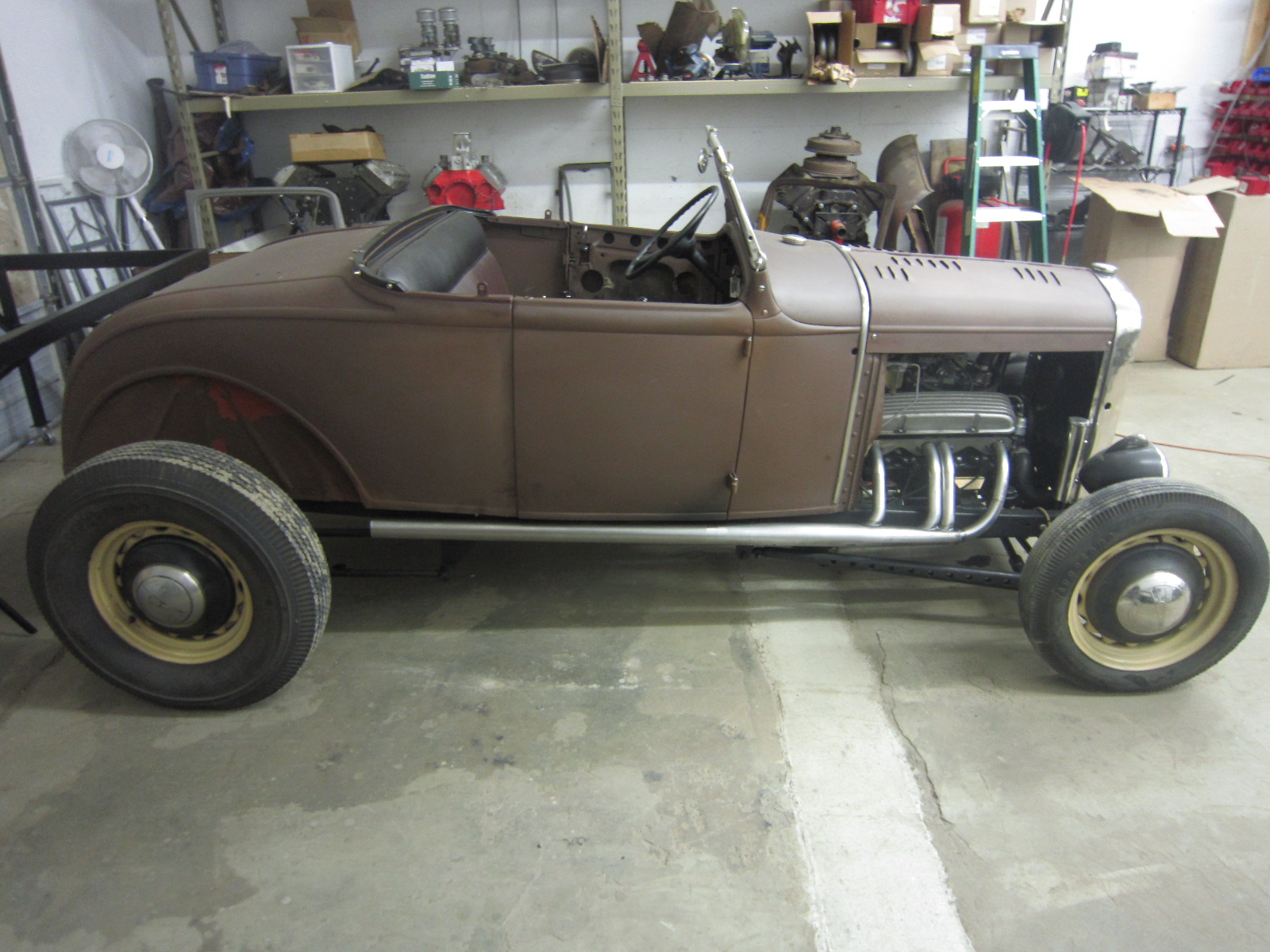

    [​IMG]williams bros. roadster used late style torque tubes.
