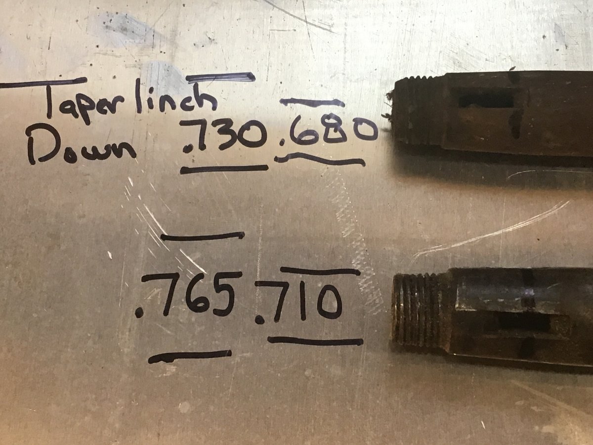

    As said the taper is larger because it’s higher up the shaft so different but the same. The picture will explain.
    You can change to a later box like @rusty valley recommended like a 1932 to 1934 box is almost a bolt in. The mounting snout of the 32-34 boxes come off and can be replaced with a model a 30-31 mounting snout. This way you can retain the horn button and use a later wheel 32-42 has the same taper on most applications.

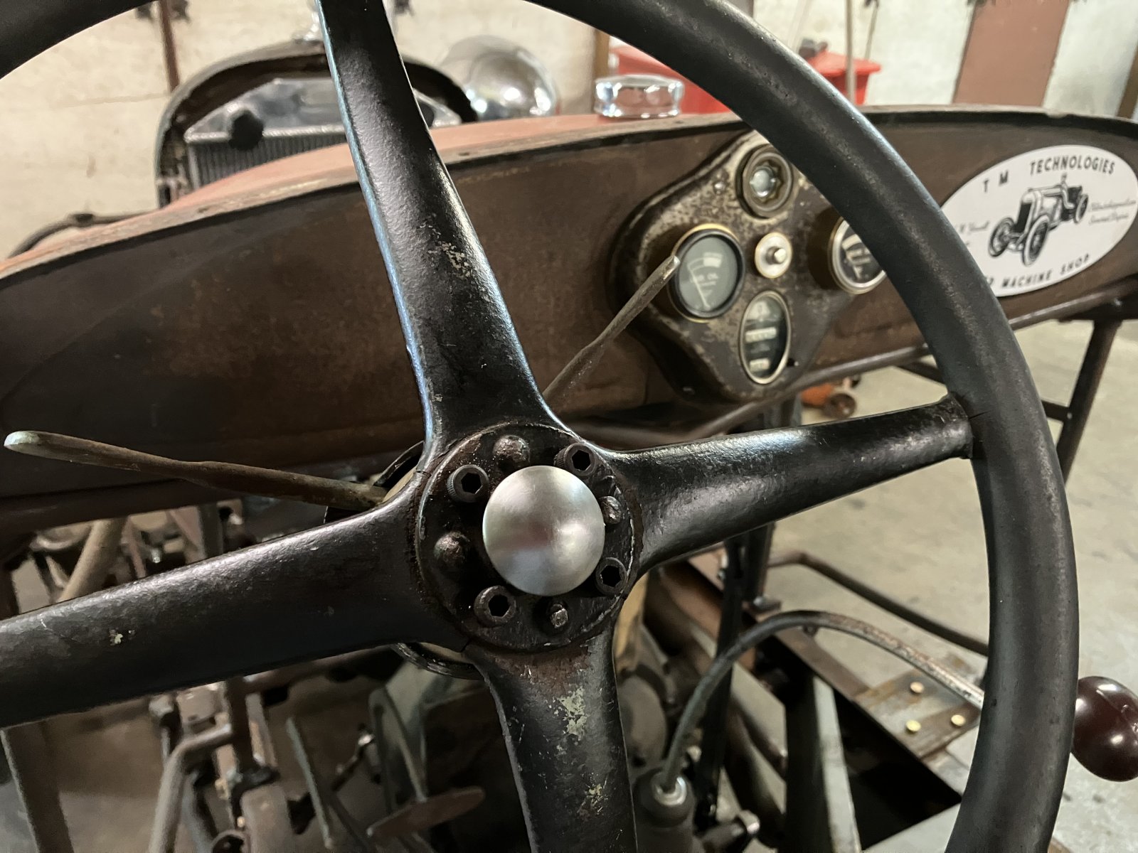

  9. If you have an old A steering wheel the center hub is easy to remove
    I went backwards and fitted a T steering wheel to my A shaft 175176F3-0ADE-4517-BFD1-FBD372BA8B11.jpeg 75373B83-DFD5-4CF9-A4E8-C79D924F9DC5.jpeg 799E84BB-722E-4ADD-B766-07296F6D462B.jpeg
