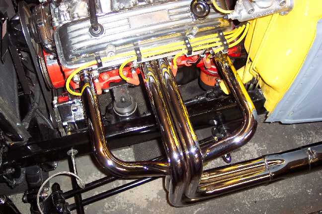

  10. Toqwik
    Joined: Feb 1, 2003
    Posts: 1,311
    Toqwik
    here's mine
  11. Thirtycoup
    Joined: Jul 21, 2002
    Posts: 1,197
    Thirtycoup
    hey scott, sorry but the guy i bought it from at the swapmeet couldn't give me any info about it but i am guessing early 80s chev, the horn bar did say chevrolet on it. thats about the best i can do for you. nice pic, that thing is going to be a cool ride, keep up the good work man. mike
