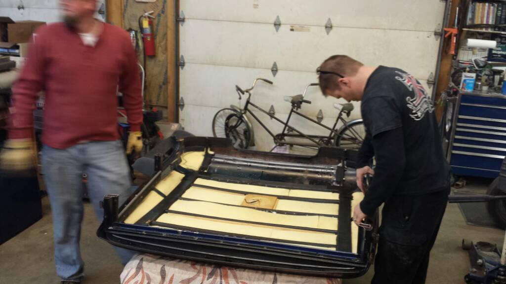

Brought my '30 down to the shop and we are getting ready to give her a haircut. More pics coming... Posted using the Full Custom H.A.M.B. App!
What a great way to start a hot rod project! Start with a restored car! Going to be a kick ass build. Posted using the Full Custom H.A.M.B. App!
Anyone can restore a car. It takes real men to cut them up. Looks Great Fellas. Looks like a nice healthy cut too. Keep up the good work!

After a late start this afternoon we got the doors and the roof off. Had some fun with the hinge pins if you know what I mean! Anyway more pictures. ... Posted using the Full Custom H.A.M.B. App!
Someone tell him its too low before he hacks 4 more inches out of it! Posted using the Full Custom H.A.M.B. App!
Now THAT is what I'm talkin' about...!!!!! A hard chop like that looks SO damn fine on an A coupe! Nice work fellas! Scott Posted using two Dixie cups and a medium length piece of string.
