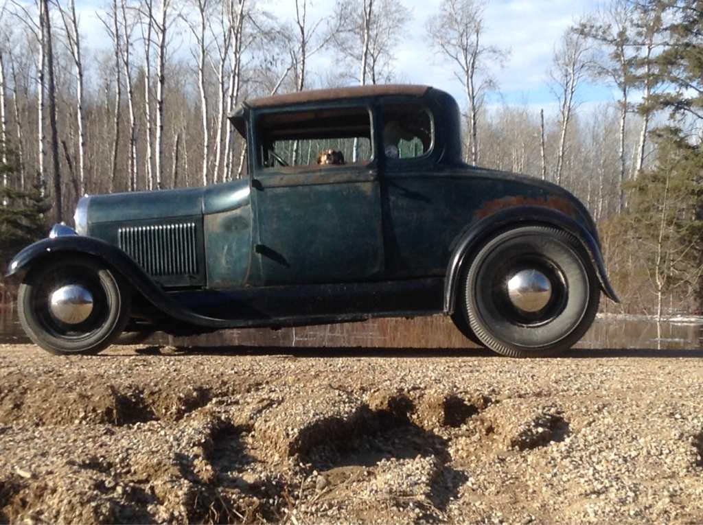

    Yes,sorta,my rear cross member is moved back 7.5 " the axle is a 38 banjo,spring behind not on top,basically the same as a 3" kickup ImageUploadedByH.A.M.B.1413693120.355555.jpg

  7. That looks great !!

    Bader2 man that is one cool looking car, great stance and awesome patina

    Thanks,old Henry painted it!
