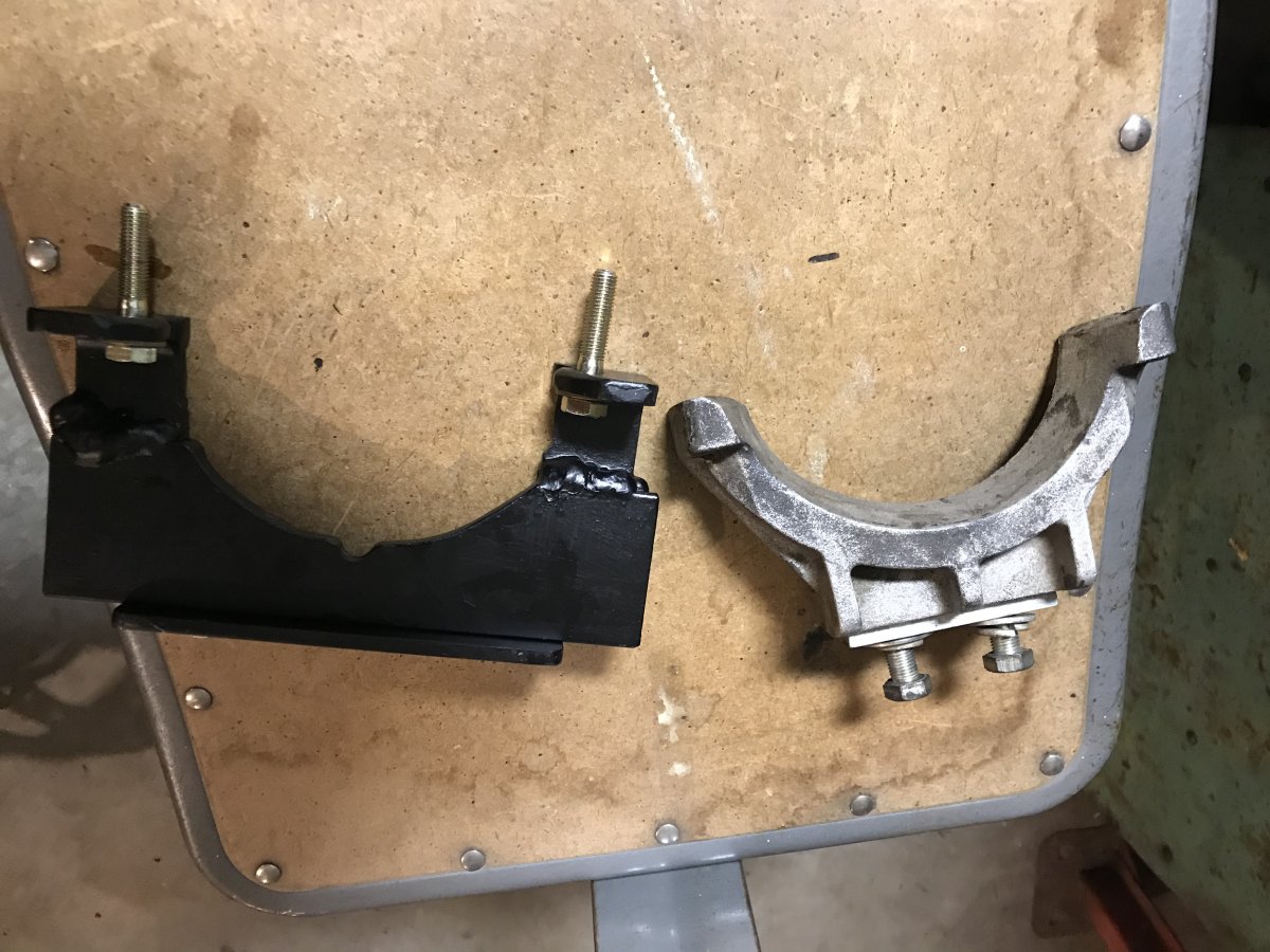

    Hey @Kiwi 4d - The Model A float-a-motor rear trans mount will NOT fit the V-8 universal joint housing. I tried like crazy to find one that fits (I know they exist because a buddy has one), but it appears they are not made anymore. I wound up making my own, as seen here (float-a-motor on right and my crude but effective version on the left). trans-brackets.jpg

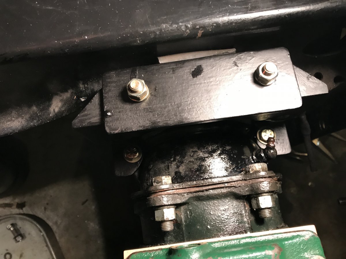

    Here it is installed, although you really can't see much:
    It's not really a mount. More of a support/stop to keep the trans from dipping down. I'm not an expert, but I think it's primary purpose is to prevent clutch chatter.

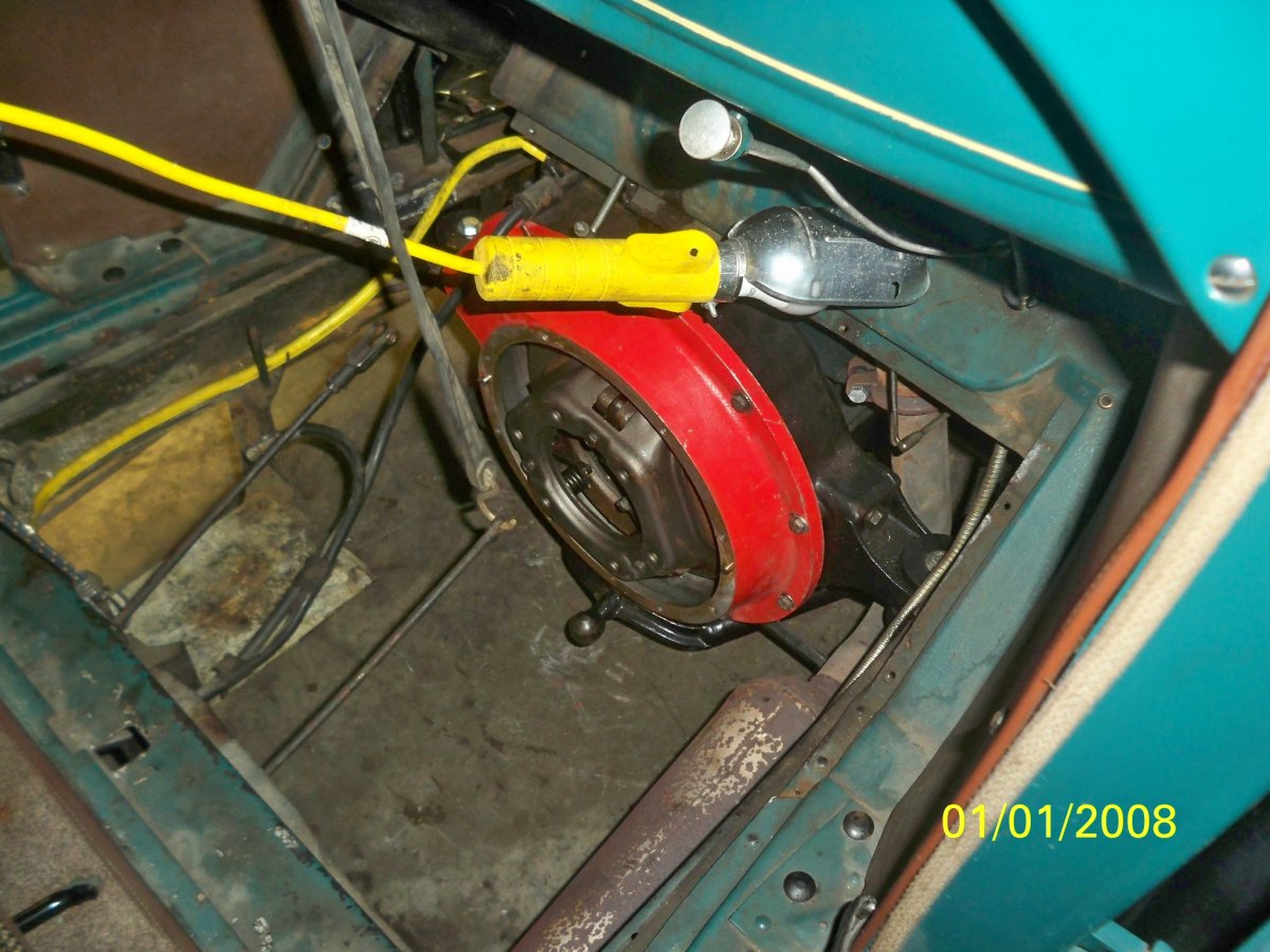

  17. received_10212443796558604.jpeg Running a clings adapter with a 35 trans. Both purchased from hamb/ford barn. The Clings kit didn't come with instructions so I missed the part about drilling through the bottom of the bellhousing for the wishbone bracket. Out with the rear end and trans!

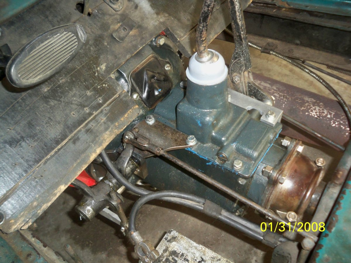

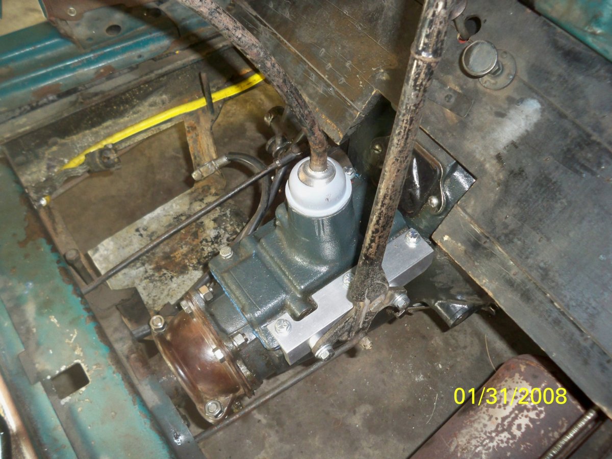

    77 - 1939 V8 transmission with Clings adapter.jpg 103.JPG 105.JPG 106.JPG 107.JPG

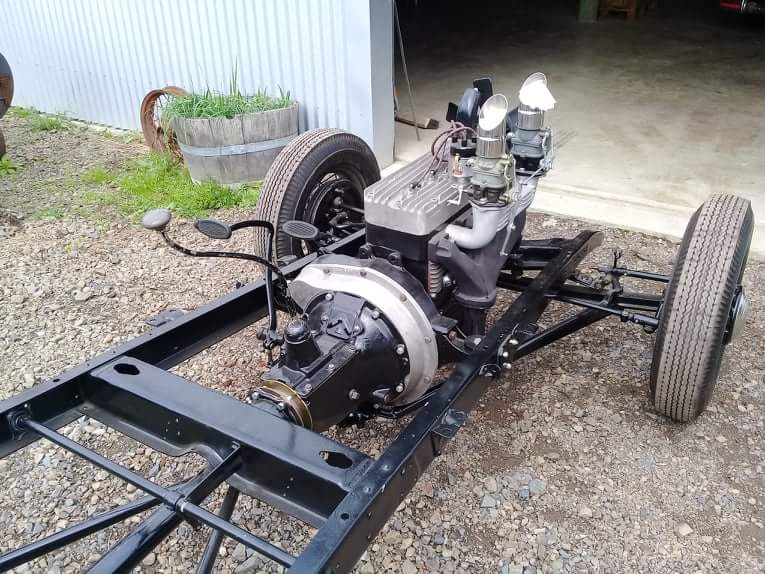

  25. burnzy...
    Sorry, I never thought to get any pictures of the wishbone attached. Here's the link to Clings, good people and very helpful, www.clingsaftermaket.com
    The mount is a simple install, mounts to 2 of the lower adapter bolts and a hole needs to be drilled in the bottom of the bellhousing. I used the original style caps but not the rubber ball.
