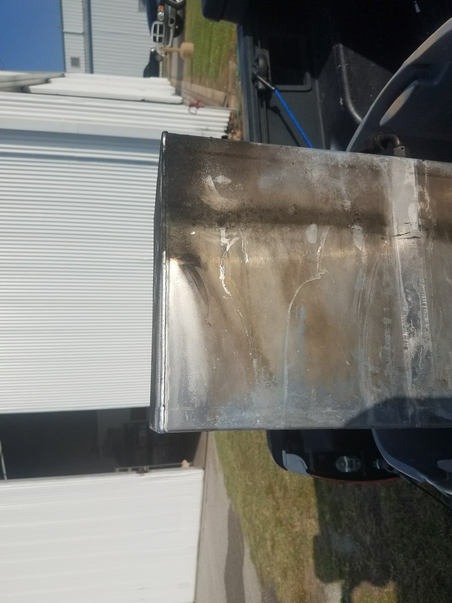

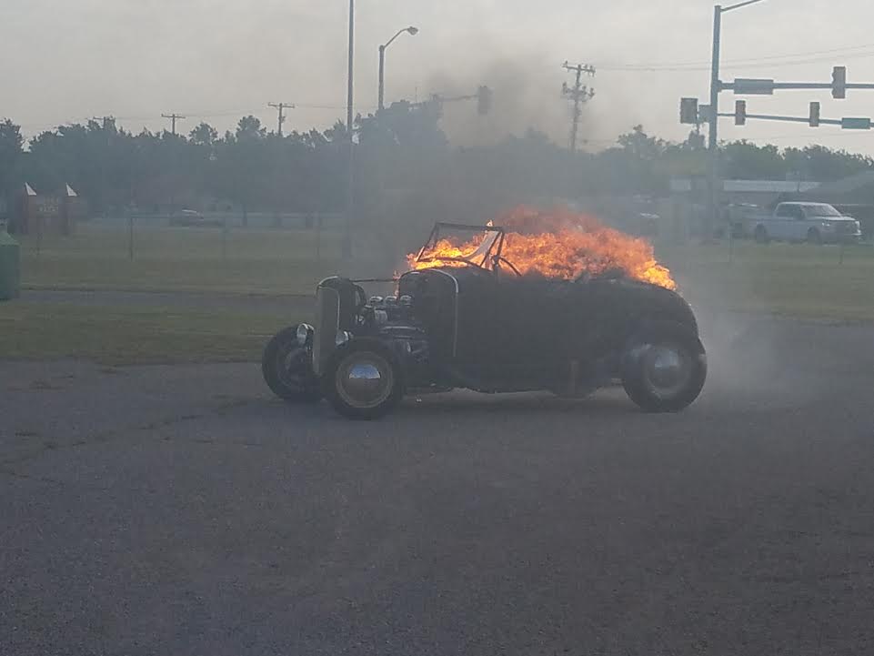

    I know, I know, Im going to die in a horrible fire if I use the stock tank. Well I tried the other way and still had a fire, So the next one gets a stock cowl tank. 06 14 2017 (1).jpg

    Tell us more. What caused the fire? Doesn't look like engine problem.
  4. holy crap. did any body get hurt?
  5. I ran stock A tank for years and never had that happen! Is everyone ok? How bad is the car? We need the rest of the story for educational purposes.

    Cause was a bad weld on an aftermarket fuel tank. The shiny part is where the liqud fuel was leaking during the fire. The smoke line is where the fuel level was. There was a firewall between the tank and passenger compartment. No one was hurt , just ten years of building down the drain.

    I filled it up the day before and no leak. The weld must have cracked on the trip. Exhaust is the best guess for ignition source.

    Two large extinguishers were used and had no effect, the liquid fuel coming from the trunk had to stop before the fire could be put out. Lucky the tank was a siphon style instead of a bottom feeder, when the hoses burned off the fuel stopped. Still had 3/4 of a tank after the fire.
