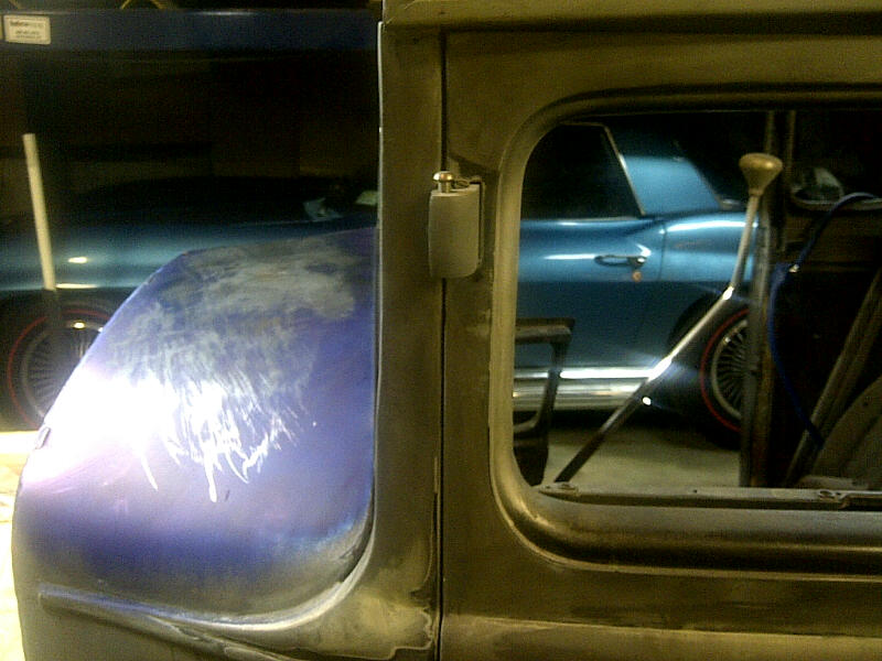

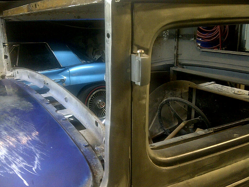

    They matched up quite nicely, not perfect but pretty damn good. I had to pie cut the pillar to get the different widths to match up, but not a big deal.
    I will snap some pics of what they look like now and post them.
    I did a lot of research before on how and where to cut before I dove in....Shitty thing is when I cut it, I took the 4" section from the center all the way around like most people do....wasn't until later that I found out all the pros cut it lower all the way around...so the chop is less noticeable and easier to finish.
  10. ModelEh1931
    Joined: Oct 28, 2009
    Posts: 90
    ModelEh1931
    Here are some pics....I'm most likely going to use lead as filler in the A pillars to add some strength.

    That looks pretty good, I will have a closer look at it tomorrow when I am back at the shop. Did you have any issues with the doors binding when opening and closing? I am assuming at some point the three hinge pin centers are not lined up perfectly now, but maybe its off small enough it doesn't matter. Thank you for some pics.
    Did you line up the posts so the track for the glass is straight and make everything go inline with that? Or line up the outside edge and then pie cut everything else?

    I replaced all of the hinges, doors do not bind, open and close nicely, gaps are pretty nice. The pins take a slight bit of elbow grease to get in, but after that, its all good. I lined up the outside edges and then pie cut...the chop on the doors turned out very nice.
