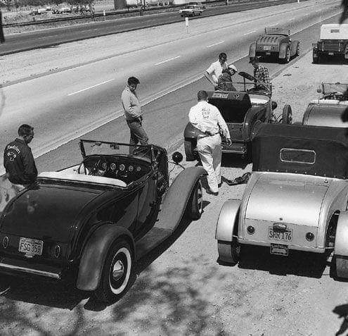

    Inspiration interlude
    I am posting these to just apprieciate minimalism...
    When I saw this my jaw dropped...a fair bit...this May even be a new build
    Not sure...
    The Body was it seemed pretty cherry which yours will be...
    The engine had the balance of Shiny stuff...1-4 Barrel, note the headers...
    Love the way the Nerf/Bumper support mounts into the frame...
    Chassis was mostly paint but far less perfect than the body...but very complimentary and fitting...
    It was Not eat off the frame perfect...
    It was Just Perfect & Driven...

    Nice to see so many full-fendered hot rods. Where do you find these pics?

    I just image search and if its historical I investigate...amazing pic it is...

    Riff one of the interesting things about differences between a 60's Hotrod from the late 40s for example might be just Hubcaps a couple of gauges and the Engine and Tranny and slotted chrome rims...
    What I'm saying is I pegged that pic of the A's at 60-65 and I'm curious now what is the year on those plates.

    That car coming the other way on the highway looks to be late ‘50s/early ‘60s

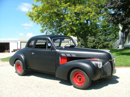

    Riff, here is a picture of my 40 Pontiac. It has been driven with a 55 Pontiac v8 and a 4 speed that I put in and was driving it 8 months after I picked it up. The stock rear end had pretty low gears and a lot of slop in the pinion. I figured it was not long for this word ever time I rowed that 4 speed. The first update was a 9" rear end and s 10 pickup leaf springs it made the car a lot smoother. Then the next winter we changed the front suspension and put in a 1963 421 Pontiac super duty engine. So The point is get it safe and running then update as you go! I have all the trim for my Pontiac and it will be red to match the firewall, and You can not see the hood strip real well in this picture but it is somewhat pitted. I cleaned it as best as I could and cleared it. It will stay that way after the shinny paint. I am fine with that! Enjoy your car, Gary:) FABB1BADA1.jpg

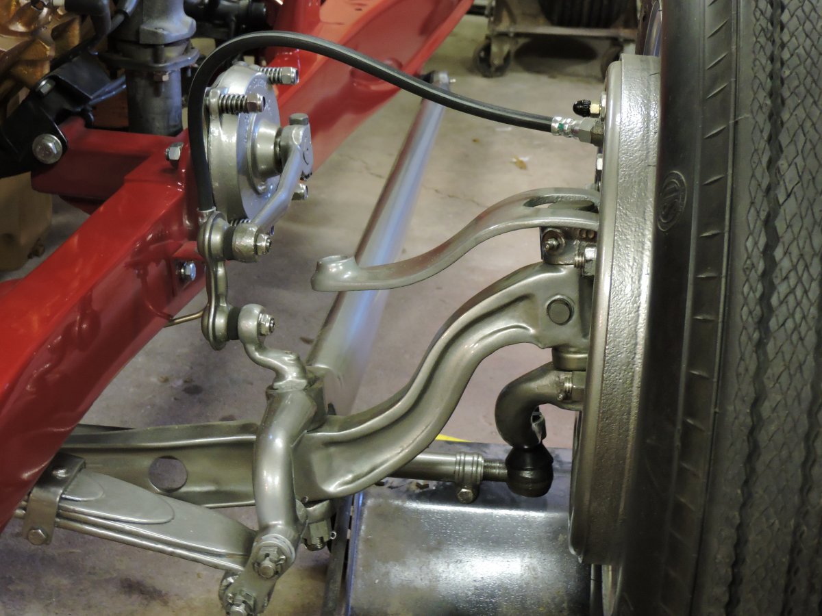

    Man, you guys did get after it, didn't you? Crap, you got the motor & even the rear axle torn down.
    Re the intake, multiple carbs blows away single 4 barrel in the looks dept, though probably not any better performing. But it's a hot rod, and multiple carbs look the part. Dual 4's are cool, and would be period correct, but good luck finding a period correct dual 4 set up that won't break the bank. The carbs would be Carter WCFB small base 4's, and the Corvette guys have pushed the price on those through the roof, several grand at least. You could also go with dual Rochester 4G carbs, but they are harder to locate. Either way there will be some tuning issues. Sticking a modern dual 4 intake with a pair of Eldelbrock carbs will NOT be period correct, not even close. A 283 doesn't need the flow of dual 4's anyway, just not enough cubic inches. I went with dual Rochester 2G's and adapted them to a 2 x 4 intake, gives me a more unique intake system that draws a lot of looks, because dual 2's are just not a common arrangement. Dual 2's flow plenty of air/fuel for a little ol' 283, it runs very nice. But probably not strictly period correct. Looks better than dual Edelbrocks, IMO. The easiest multi-carb setup would be triple dueces, than you can be just like everybody else. Shop around and you can find a triple deuce setup for less than dual WCFB's. I'd check in with @dickster27 if I were you; he runs Dicks Hot Rod Carbs, he can offer excellent advice and set you up with a complete system, excellent workmanship too. He's somewhere in TX too, but it's a big state, I don't recall where he is.
    Here is a shot from his website of the same system I have, this is not mine, but it's close:
    Check out his webpage: http://dickshotrodcarbs.com/home.html
    Re the rear suspension. Part of the problem you have with handling is the split wishbones. That style of suspension is totally period correct, but it does not offer individual real wheel movement without suspension binding. There's lot's of info on this here on the HAMB, you can do a search and find lot's of threads and discussion. Also, the wishbones are prone to failure because they are being loaded with forces they were never designed to cope with. Some guys add some bracing to prevent failure at the worst possible moment, which could be catastrophic. Some guys add a torque arm to take the stress under acceleration. At the least you should consider relocating the leading pivot points inboard of the frame rails as far as possible. The original design allowed total free movement of the suspension, so you want to try to get the split wishbones as close together where they mount to the chassis as you can, that will get you back some free movement. Together with a torque arm you'll be good to go. Or plan on bracing those split wishbones. They already have who knows how many miles on them, all inducing stresses, there may already be cracks forming in the grain structure of the steel. This is a safety item.

    Nice looking ride Gary!

    When you say reposition the pivot points of the wishbones as far inboard as possible, is that both front and rear bones? Also, since we cant change where they connect to the axles, does that mean we may have to lengthen them on the other end to change frame pivot points? Will we need new, longer ones? Sorry-I’m still figuring out how all of this works.

    Blues-look at this photo of the split wishbones with the body off. Can you comment on the leading pivot point location?

    I think I understand what you mean now when you say mount them inboard. You mean connect them to something closer to the centerline of chassis instead of frame rails?
