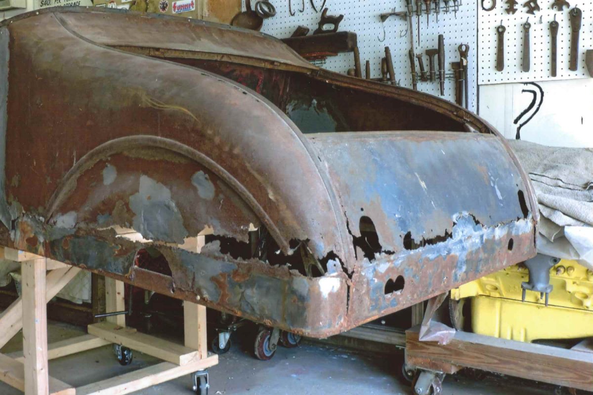

    Here's a picture of my car as it was in 53. Not built by a craftsman but a 17 year old kid and good enough to have been a two page feature in a mag. The other picture is how I found it. Note how the cutouts were made for the 39 taillights. filename-1 (1).jpg DSCN1256.JPG

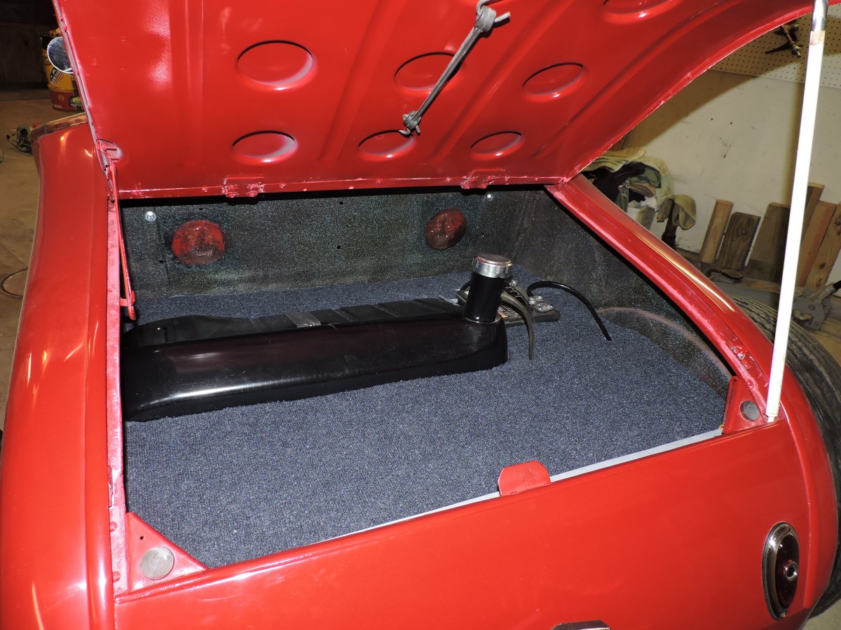

    Well I did replace that panel. I couldn't save it. I was showing what was ok in the early 50's when this car was built. I left the two round spots on the back panel where the straps that held the gas tank were brazed on just for this reason. They also have a little bit of original paint in them. I now have a little magnetic sign back there that says "not fake patina"Maybe I should add another one saying don't do it like this. DSCN1182.JPG
