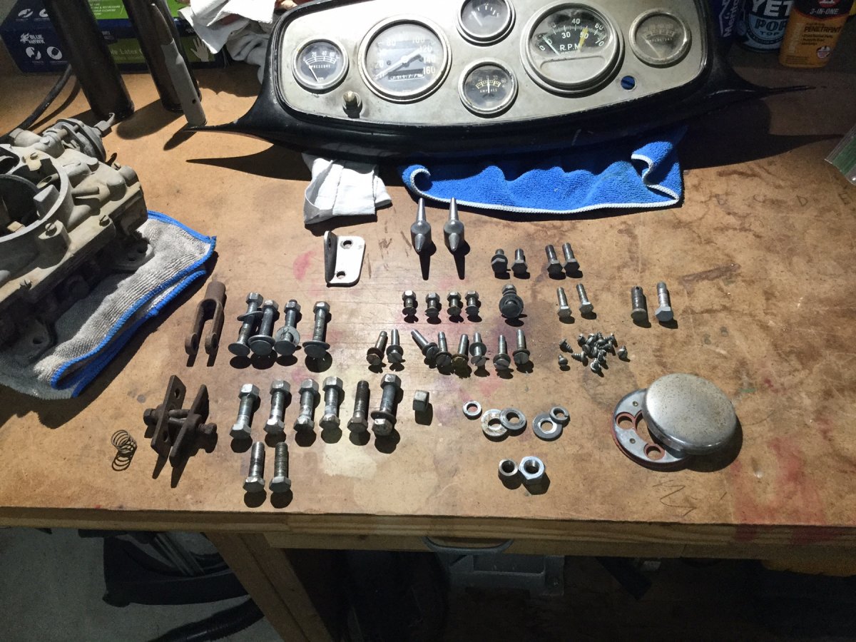

    Thanks Phoneman-I laid out a lot of the fasteners the last shop took out of the car and most looked like regular galvanized nuts and carriage bolts you would pick up at an old Ace Hardware. Should I use those to put the car back together or research the correct hardware and go find/buy it?

    Hang on Dick-I’m going to lay some out and post some photos...

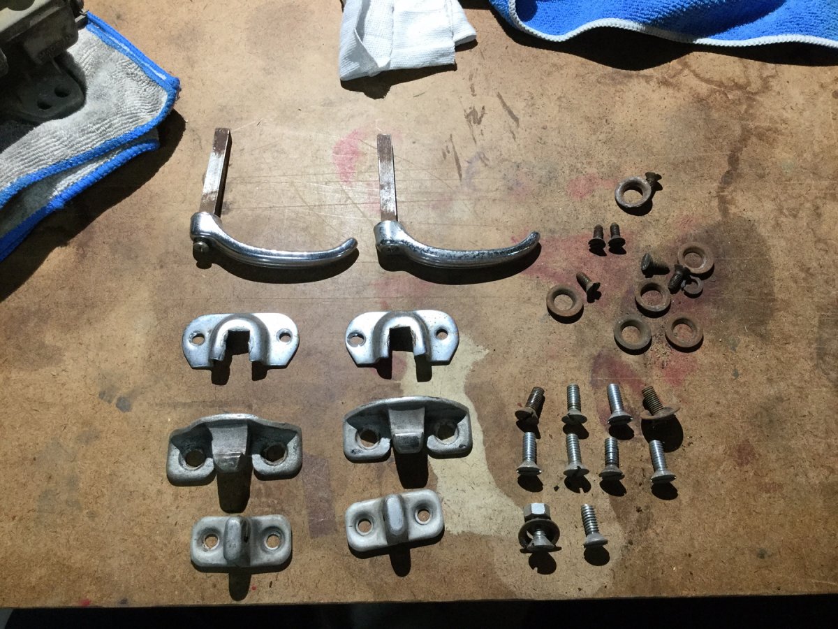

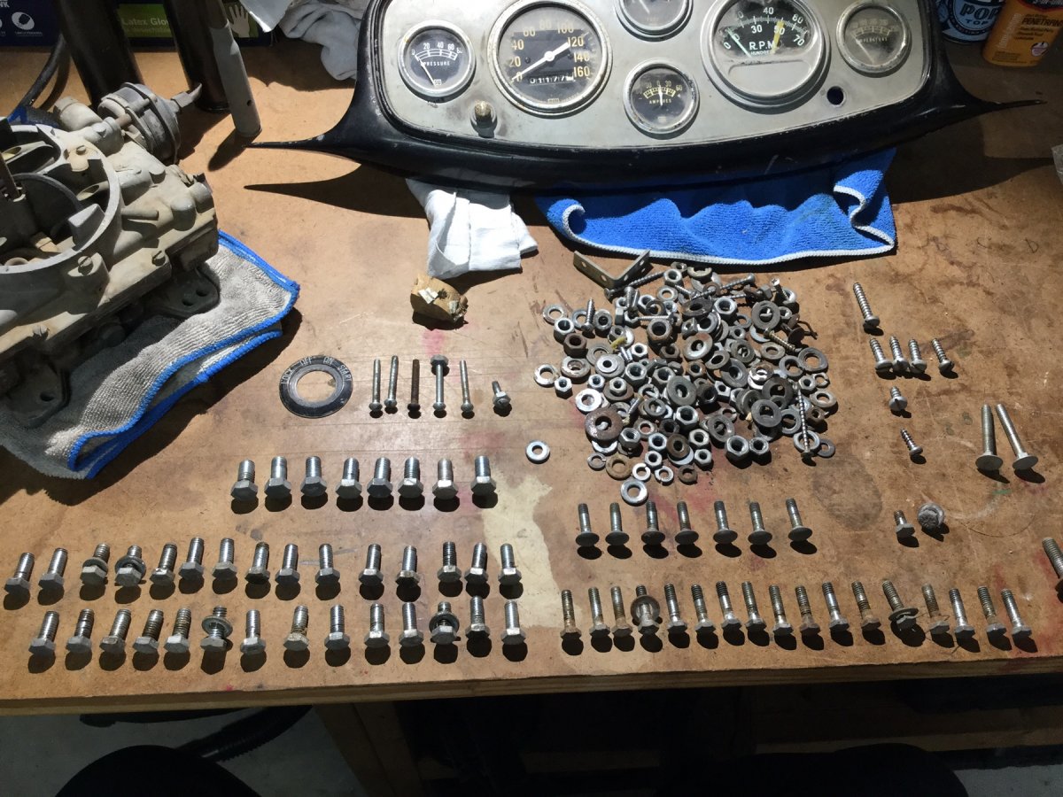

    Ok-what’s the diff between grade 2 and grade 5?

  19. I wouldn't think twice about using them, they look fine.
    slv63, flatford39 and Stogy like this.
  20. raven
    Joined: Aug 19, 2002
    Posts: 4,705
    raven
    Look at the top of the bolt. Correct me if I’m wrong, but I think grade 2 bolts have nothing on the top, smooth. Grade 5 bolts have three lines emanating from the middle out.

  22. Dick Stevens
    Joined: Aug 7, 2012
    Posts: 4,041
    Dick Stevens
    Stogy and oliver westlund like this.
  23. Dick Stevens
    Joined: Aug 7, 2012
    Posts: 4,041
    Dick Stevens
    Gr 2 bolts are very easy to get at any hardware store, they are the cheap shit that too many people buy because they are cheaper! And yes the markings are industry standard markings

  25. Redrodguy
    Joined: Nov 18, 2016
    Posts: 116
    Redrodguy
    From what I can see in your pics, the bolts and screws were used to fasten brackets, latches and body parts. Some may be OEM and will generally fit the part it's holding in place better than new hardware. Keep and reuse these.
    Engine hardware (head bolts, crank and rod bolts and nuts, etc.) are specialty hardware. Use ARP or similar quality brand to replace these. Suspension attachment or items bolted to the frame is where you want to use the higher grade bolts and nuts. Tractor Supply has a pretty good selection of course thread Grade 5 and Grade 8 bolts which are sold by the pound in bulk quantities. Fine thread bolts can also be bought in quantity online from McMaster-Carr or Grainger. If I'm needing only one or two of anything, I can usually get it from Westlake (Ace) Hardware. They usually have what you need, but it's pricey. You can spend a small fortune in hardware, but it's not something you want to go cheap on.
