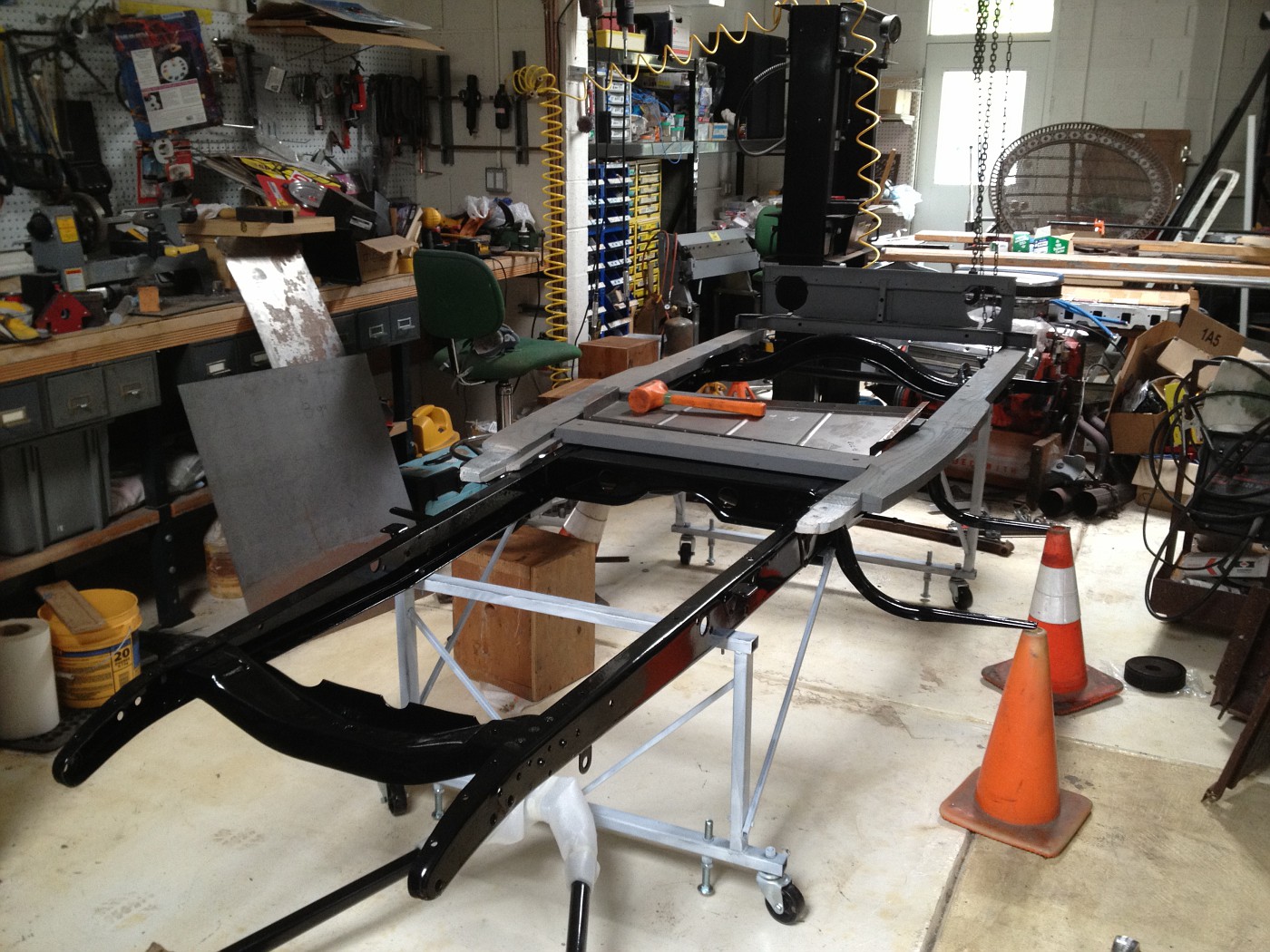

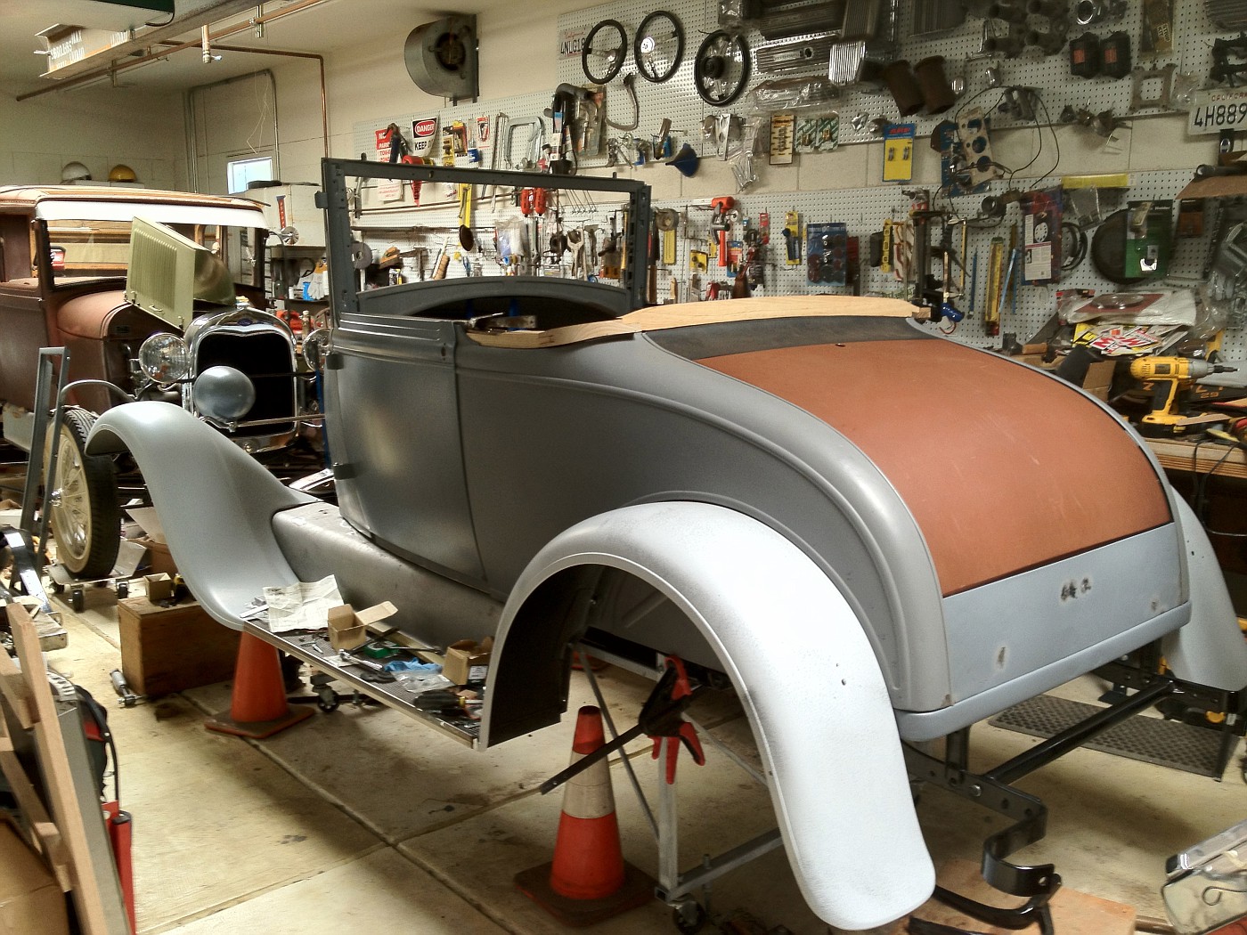

  3. I built the stand seen in the following series of photos which are in chronological order. I used it with the frame and without the frame. The car went together and was blown apart a hundred times on the stand. The build took six years and the stand was essential. ...even at the painter’s shop.
    Hope the photos help.

  10. In the first shots front and rear wheeled assemblies are bolted directly to the frame with diagonal braces, using existing holes on the frame’s bottom. ...and it has no wood on top. The last four photos have the wood planks and mortised cross rails as the platform, bolted on top of the wheel assemblies. Platform size was fixed. It was mostly built from stuff I had around, so was cheap. I added a couple wood pieces on top of the platform to keep the body centered. I was able to slide the body around a bit to get better access for awkward bottom panel work. It was flexible for many uses.
    Many more photos of the build: http://public.fotki.com/RussB/my_cars/1929-ford-cabriolet/body-build/
    ...most are not that relevant to your needs, but feel free to browse.
