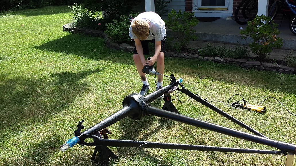

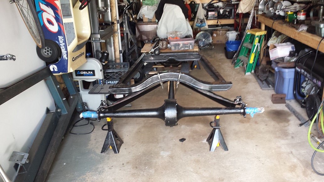

    Found a couple pics I forgot to uploa
    After painting the rear assembly and his shins my main mechanic is cleaning out the spring bushing bores with a wire brush mounted on a drill.
    After rebuilding the rear spring which consisted of reversing the main leaf and removing a couple leaves the rear is mounted back up in the chassis.
