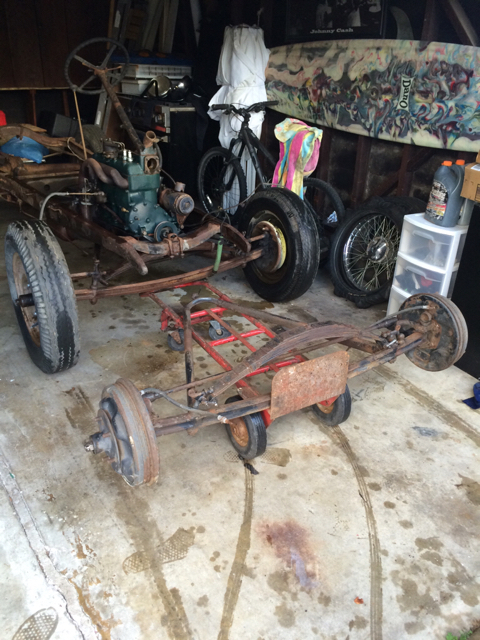

    Did a little cleaning today. Prepping everything for the snyders high compression head, downdraft weber carb, Wagner alternator and B distributor. ImageUploadedByH.A.M.B.1425179722.006399.jpg ImageUploadedByH.A.M.B.1425179738.223701.jpg
    How many springs and which ones can I take out to lower the front end? I bought a complete frontend with juice brakes for a screamin deal.

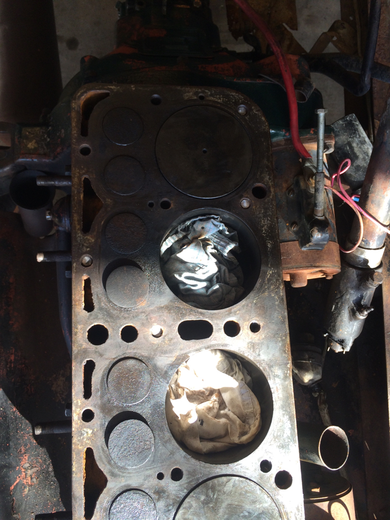

    Started taking the banger apart. The head could not have came off easier. Removed the bolts, put the plugs back in, turned it over and it popped. Stood on top of it and lifted that heavy sucker right off. Now to clean the water jackets and vacuum the crud out of there. Cylinders look nice and clean with no scoring. ImageUploadedByH.A.M.B.1425254891.217206.jpg
