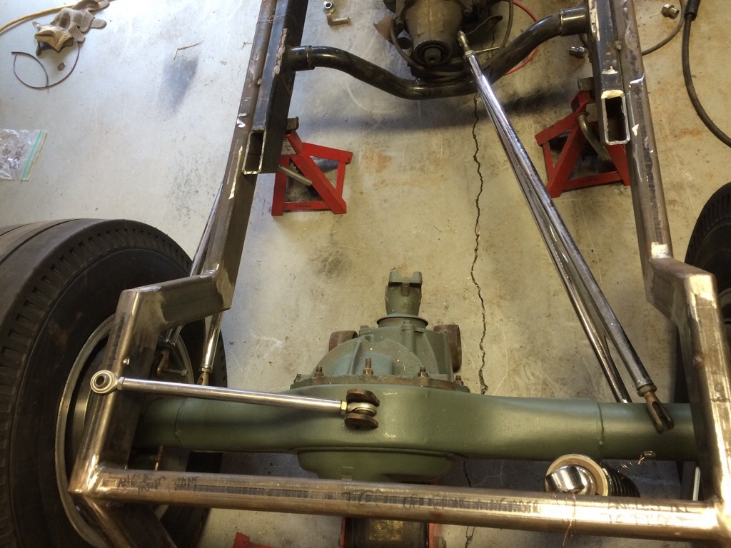

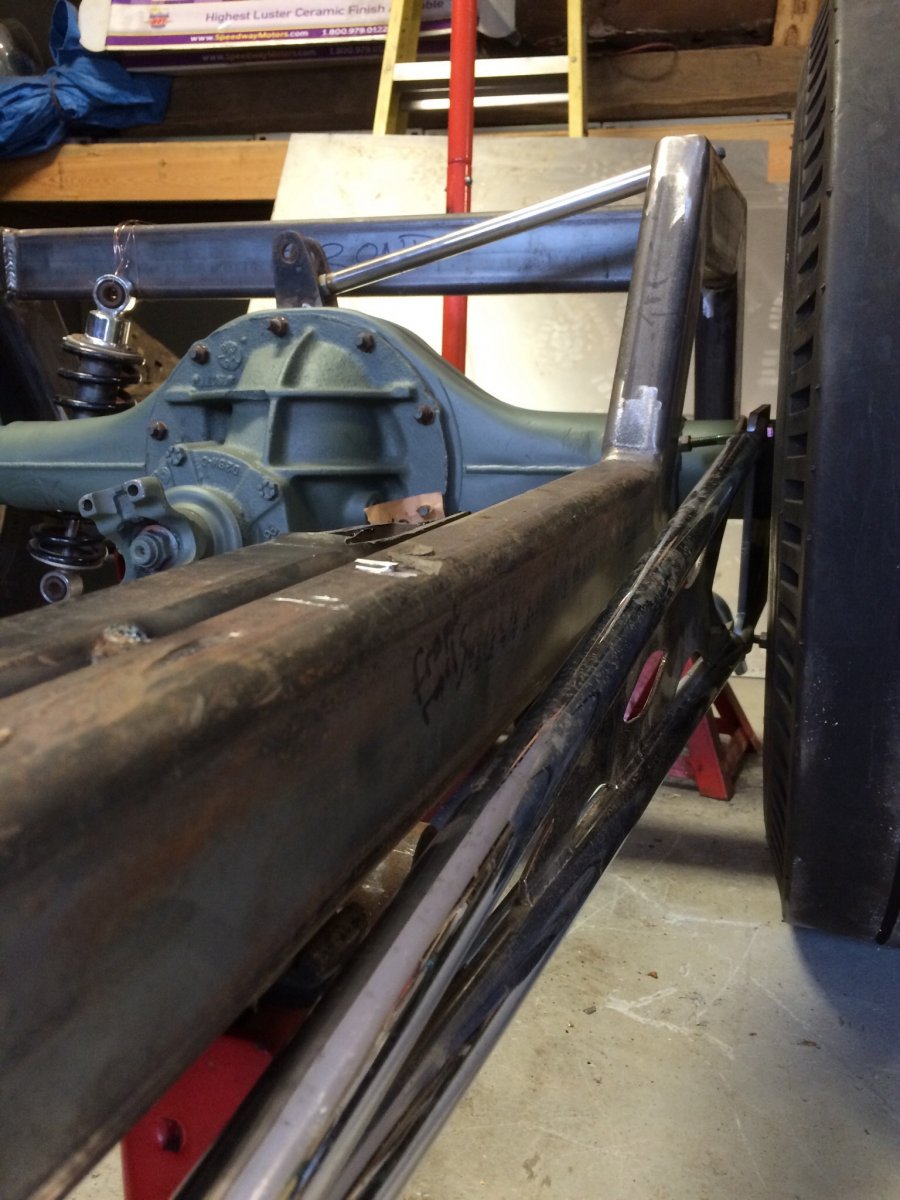

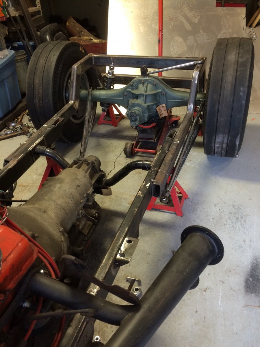

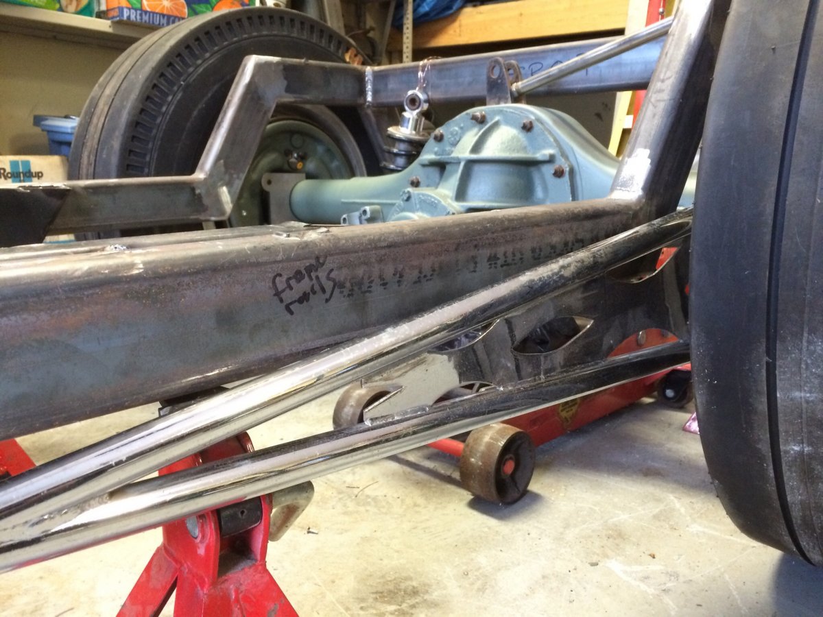

    I am mocking up my rear suspension for my Bantam roadster project. I am currently planning to use ladder bars with helms at both ends, coil overs and a panhard bar to connect my narrowed nine inch to my chassis.
    Bantam's are small cars and my seat will be only a few inches forward of the pinion. Thus no room to move up into the passenger compartment and use a tri-link or triangulated four bar. With a regular four bar (parallel to frame rails) the top link would only be a few inches long. So, all of those options are out at least in my humble opinion.

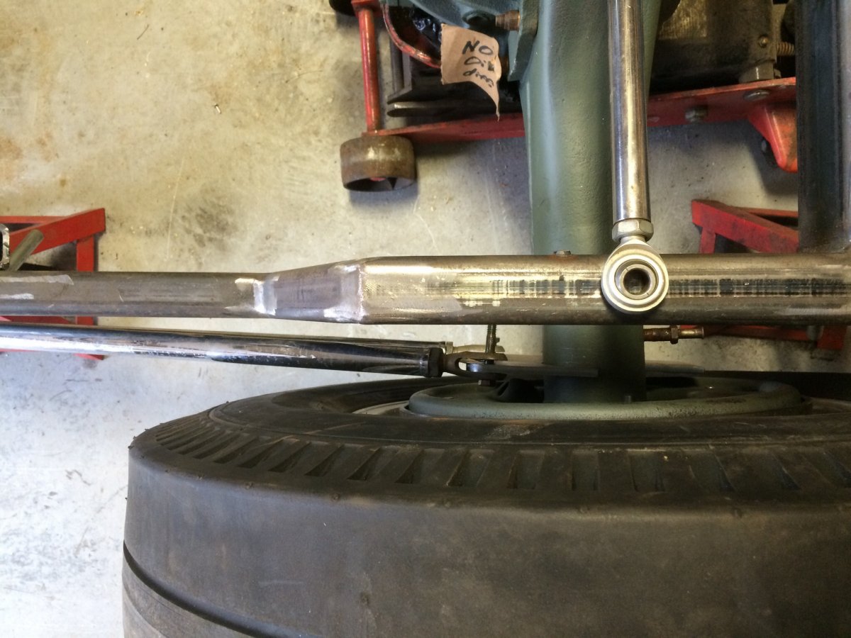

    Here is where I could use the input from the HAMB. I would prefer to put the ladder bars parallel to the frame to keep out of the passenger compartment. See pics below with driver side ladder bar mocked up.
    Or, should I angle the ladder bars to the tranny tail shaft like in this photo? Note that the bantam is such a short wheelbase car that my current ladder bars actually extend past the tranny tail shaft. Also note that I will intrude into the passenger compartment a little to make this angle work.
    Lastly, here is a photo shooing the two different ladder bar placements:
    Appreciate your thoughts and thanks in advance for your help on this.

  2. Shorten the bars and mount them to the back side of the trans crossmember. Run your track bar (panhard) parallel to the ground.
  3. To give yourself some room inside I'd mount the bars outside the rails.
    I would shorten the bars (in fact I'd go 4 link) so they pivot flush with the rear of the trans.
    As stated panhard parallel with the ground.
    Do some Googling to get anti-squat in the rear correct or you may start doing wheelies.

    Three things
    1. The ladder bars should be close to parallel to the ground..."at finished ride height" (fully loaded/finished car). Make the front mount with at least two fastener locations, three would be better if you can.
    2. The Panhard bar should be parallel to the ground at "finished ride height".
    3. The Panhard bar should be as long as it can be made, not the little 18" ones as sold to unsuspecting builders. The car will be MUCH more controllable under power with a longer the bar.
    I've built /rebuilt several chassis and in ALL cases, the Panhard bar goes from the frame rail on one side to...as far as it will go on the other side of the car. Like bracketed on the axle right against the frame rail on the other side.
    Make yourself a "paper doll" layout with pins and cardboard to see how much the rear axle moves...side to side.
    This assumes that you have more than 2" of axle travel..!
    Mike
  5. Looks like the ladder bars are chromed and the threaded insert is welded in. Any modification to them throws the chrome out the window.
    Sell the chrome ones and make some that fit. Running on the outside will give you more trouble geometrically than triangulating towards the center.
    You didn't ask but the Trans mount is welded in and that's likely to give you an ass ache eventually. You could move it toward the front and get your chrome bars working. The top of the bar should be about centered in the axle and the lower bar close to level with the ground.

    Tight little buggers back there, aren't Bantams ? I had fits trying to get all the suspension tucked back there on the project drag altered I have sitting around. Funny as it seems, T buckets have so much more room back there.

    I would go with ladder bar by frame rails and like said above - longer panhard bar. Panhard laid on frame rail for pictures - you are going to stand it up right??? not flat on frame rail. Heim joint move few degrees up and down or if stood on top of frame would move - allow few degrees fore and aft like ladder bars need. Hard to explain in words. Also like idea of "paper doll" lay out and try moving rear end as you want it to move.

    Consider eliminating panhard bar and running a diagonal from right rear lower ladder bar bolt to front left bar attachment point? This would pass under driveshaft. More of a drag configuration ,but should work on a light car.

    Don - I was following your build as you tackled the same problem. I am making mine a two seater (wife is more supportive of the hobby when I put in a seat for her;) which only makes it more challenging to make everything fit.

    With the ladder bars installed parallel you will have no roll compliance in the rear (unless the frame twists) as you have a truss configuration. With the bars triangulated and mounted to the trans crossmember (street rod style) you can get some roll compliance if you use urethane bushes or such at the front mounting point. If you use the heims you will be putting some bending load on them while cornering as the frame tries to roll (the same applies to the parallel installation but more so). If you do use the triangulated configuration keep the forward mounts as close together as possible.
    As stated, the longer the panhard bar the better so a standoff mount on the right axle tube would be better than the tabs on the center of the housing. If you have limited rear suspension travel this becomes less critical--if the bar is parallel to the ground a 12" center to center bar will only move the housing 1/8" or so laterally through 3" of vertical travel.
    The suggestion to use a diagonal locator between the parallel ladder bars will work but the brackets to mount it need to be stout for a street application as compared to its more normal use on a drag strip where (hopefully) there is minimal lateral loading.
    Finally---please try to build it with some sore of compliant bushes at least where the bars mount to the frame. Heims are OK on race cars but pretty harsh on the street. Remember that (paved) race tracks usually do not have chuck holes, manholes, abrupt surface transitions etc like the average streets.

  19. First thing I would do on a narrow car is get the coil overs as far apart as possible. If it were mine I would put them outside of the frame rail and do whatever I needed to do to the frame rails to make it happen. (notch them or step them in). If you can picture in your mind the coil overs right next to each other in the center of the car it would just be a pivot point, so the farther apart you get them the more stable the car will be (less body roll).

    I personally would go with the Pete and Jakes style triangulated ladder bar deal with compliant front mounts, a long panhard bar and the shocks spaced as wide a possible and as close to vertical as you can get them as suggested by Kev. The Watts link would be a good idea except for the fact that there is nowhere to put it and clear the rest of the components/frame.

    I would run locater bars with heims on both ends outside the rails. I would run a torque arm next to the driveshaft to take all the wind up loads. It would need a shackle at the front. It needs a long, low panhard bar instead of that short high one. Think Camero. You will need a really strong sway bar to stabilize the rear with the short mounting span of the shocks.
