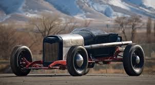

  5. volvobrynk
    Joined: Jan 30, 2011
    Posts: 3,587
    volvobrynk
    from Denmark
    In talking like this
    [​IMG][​IMG]
