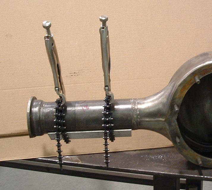

    My oldest kid recently helped me narrow a 9" Ford housing (Okay - he did the whole thing himself, while I drank coffee and snapped a few photos - LOL).
    I've seen a few threads here about narrowing rear end housings, and it always looked like a major undertaking. I understand that someone doing this for a living would probably be able to justify a jig, etc,. But I thought this method was a pretty slick deal for a once-in-a-while thing.
    It only took about forty-five minutes, and everything came out straight as a string. Absolutely no warpage. I guess sometimes it pays not to over-think things.
    Once the pieces were cut to length, he used a scrap piece of angle and chain clamps to quickly get perfect alignment, then tacked it in four places as shown.
    Next, I used the edge of an abrasive wheel to "vee" the gaps between the spot welds to assure good weld penetration.
    Then came the really cool part. He simply tacked four scrap pieces across the gap to keep things steady. They may not look very heavy-duty, but there was really no place for the housing to move, and it worked like a charm. Once the main welds were made and had cooled down, I knocked the plates off and welded in the small remaining gaps.
    After that, it was just a matter of smoothing things off with a grinder. Like I said, quick and easy.
    We then inserted the axles, and clamped the ends together inside the empty housing (again using a piece of angle and the chain clamps) to assure they were in alignment. That made it easy to install the brake hats and rotors, then position the calipers over the rotors (with their mounting brackets bolted onto them in advance) and tack them in place on the housing. Again, everything came out square and straight with no hassle.
    The chain clamps were extra convenient, but most any type clamp would work. The key was using the chunk of angle for alignment.

    Duh! Screwed my first tech post up, of course.
    Here are the photos.

    Not to rain on your parade but what you've done is a decent job of cutting down the housing tubes and welding them back together in a straight line. What if the housing was warped before you started or the centerline of the 4 points (left wheel bearing, left carrier bearing, right carrier bearing, and right wheel bearing) were out of alignment? Your method would result in a shorter housing with the centerline of these points still out of alignment. This would make wheel bearing life short and the rearend prone to run hot in use.
    I'm afraid a proper alignment bar and proper sized donut spacers is THE only way to insure the entire housing is straight.
    After doing this for over 20 years I've NEVER found a straight housing right out of a doner car. You would never know if it were straight or not without a fixture. Some of them are so far out of alignment that the ends wont mate back together without the ends mismatched the thickness of the tubes or worse. Remember most of these came out of wrecked cars and who knows what the history of use and abuse was before that.
    Just another segment of car crafting that a lot of people "get away with" and think they've really acomplished something when in reality it's just a cobble job waiting to bite you in the ass. There is a right and wrong way of doing everything, your call.

    I did basically the same method, but I put the rear end housing in the mill to ensure prefectly square cut off of the tubes, and the "bearing cups" (the outter peice you cut off and welded back on) in the lathe and I used the lathe to cut a deep , really deep "V" groove to lay weld into as I knew I was going to totally smooth my welds over.
    I used an Alignemnt Bar:
    Then, instead of the peices of flat plate detemining straightness of my axel housing, I took a peice of Solid Steel Rod with outside diamater a little bigger than the bearing, and I used the lathe to cut down to where it fit perfectly into the bearigns on each end (similar to a solid axle straight through) and bolts to the where the third member bearings bolt to....... Basically, a one-time application-specific Alignment bar.
    Put the Alignemnt bar in. Put the "Bearing Cups" back on, Put the bearings on my alignment bar, clocked the Backing plate brackets to stock location. I did this as I figured Ford did enough research to wether the brakes need to go on top or bottom, so; why mess up a good thing?. Then welded on high heat as possible in little short welds. High heat to get good penetration on the parent material, and short welds to minimize warpage when cooling.
    Then, I just beat the Alignemt bar out from one side, thus destorying the old bearings.....which was intential, cause they only cost $12-14 for a set and the bearing seals.
    I sent my axels off to Moser Engineering, Moser, IA for shortening and Re-splining. They only needed how much to take off them, and a check to cover shipping back to me. It took less than two weeks to not just get the Axels there, but to get them shortened, and re-spined, and shipped back to me!!!! If you use anyone but these guys,...... well, I hope they are you friend in real life! These guys Rock! He called me on the phone to make sure what I wanted, and said they would go out the same day he called! Kudos to Moser Engineering! A+ Service and work!
    I still plan to take it to the local Drive Line Specialities (shop does Big Rig and Indistrual Axels and Drives shafts) to get re-squared and aligned.
    Other than that, you got the housing down. I hope you didnt smooth your welds.

    We took pains to make sure our housing was in good shape before we began - including checking the end plates to ensure they were parallel (and of course, we did this again after the welding was completed), as well as some other measurements. Like any job, it's not gonna turn out any better than the degree of forethought and preparation that went into it.
    I mentioned early in the post that this wasn't something that was going to forever eliminate use of alignment bars, etc. If we were gonna go into the rear-end narrowing business, this wouldn't be the way to go for sure.
    Our rear-end is going in a nostalgia drag car that will see a handful of quarter-mile passes throughout the year. If I were building a Bonneville racer, I'm sure I'd want more precise alignment. As it is, we got just what we wanted. I'm confident we'll get by just fine - and frankly, I'd feel perfectly comfortable using this same technique for a street-driven car.
    Here's the bottom line. This deal worked well for us - in our particular situation. Everyone needs to use common sense and good judgement. Like most of the tech posts here, this is a "for-what-its-worth tip. If its "wrong" for you, so be it.
    If a better method redily available, by all means, take advantage of it. If this (or any) technique looks shaky - or if you're uncertain of your ability - have the job done by a pro. Those considerations are no-brainers.
    BTW - I thought your points were well taken until the last paragraph. I have to say I thought your comments there were unecessary. My intent was to pass on a couple tips that might be of help to someone. I've already responded to a couple of guys by e-mail with some additional information and photos - and will be glad to do so for anyone else who might have questions.
    In any case, I don't think any of the info in my post deserves to be put in the "cobble job" category.
