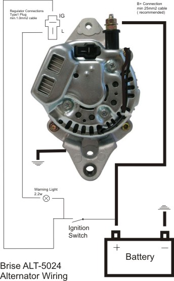

    I bought a 35 amp Chevy mini Denso 1 wire alternator. But I see it also has 2 terminals besides
    the large battery terminal. Do I need to hook anything to these other 2 terminals?? I think one of them is for a idiot light on the dash, which I do not have. I only have an ammeter which I figure the alternator to feed on one side and the battery on the other.

  2. You need to hook one of those wires to a 12 volt power source that is hot with the key on .

    One wire regulators are available for that alternator , they still have the plug in for ign and light function but they are not needed to make it kick in and charge. The OP should ignore the plug and hook up a 12v wire back to battery positive.

    Can you please post a schematic for this same 35 amp denso to show an ammeter included in the wiring?

  20. no diagram , but i will tell you how to wire an ammeter
    the wire from the output of the alternator goes to the + (plus)side of the ammeter , then a wire comes from the - (negative) side of the ammeter to the + (plus) side of the battery. then all power for the entire electrical system is from a wire attached to the + (plus) side of the ammeter
    wired this way the ammeter will show how much power is flowing into or out of the battery , and not necessarily what the alternator is putting out

    i use a similar Mitsubishi alternator. it's used on fork trucks and some 70's japanese cars. it too has a built-in regulator.
    most internal-regulator alts need a current source to tell it when to turn revolutions into power. usually that's the idiot light itself. i too don't run a lamp, i use a 100 ohm (10 watt) resistor, under the hood near the alt. you could put a lamp for it under the hood! it'll be lit only when the engine's not running.
    wiring for the idiot light is ignition (switched 12V) --> lamp pin, other lamp pin --> alt.
    (mine's got *two* connections, 1/4" fast-ons. i dont know what the other is for on my mitsu. usually the 3rd wire is a "sense" line, connected to the battery compensates for voltage drop in cables etc.)

    Brand new alternator. I've seen wiring diagrams showing wires connected to the two terminal blades. Do I need to do that, or is it truly just one 10 gauge wire to positive?

    It is not a 1 wire unit, you will need to hook up the small terminals. If you don't know which terminal is what ground the case and touch a hot wire to a terminal and turn the pulley at the same time if you feel a drag that is the field current wire. You can use a light or a resistor from the ign. sw. Run the other wire to the pos. bat. cable. Was this sold as a 1 wire alt.? They look the same.

    Yep, described as a one wire, but it is identical to the alternator pictured in the previous comments. I'll try connecting the two spade terminals and see if that will get things going. Car is sold, and I'd like to make right, but the buyer said he'd figure it out if not.
    Thanks for your advice. I was afraid I'd cook the alternator if I messed with more than one wire.
